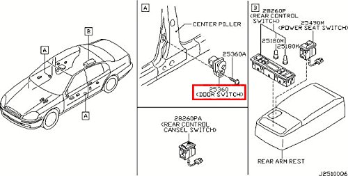

I see the door jamb switch, part number 25360-AD000, costs about $15. Does it sound like this might be the issue? Hopefully this is it, would be a cheap fix.
Diagram of the part:
Anyone ever experienced this before? How did you fix it?
