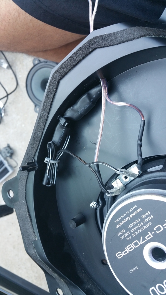

I cut off the large connector that split the wires between the woofer and tweeter, why have an unused connector anyway? The thing is for the Blows(Bose) system anyway.

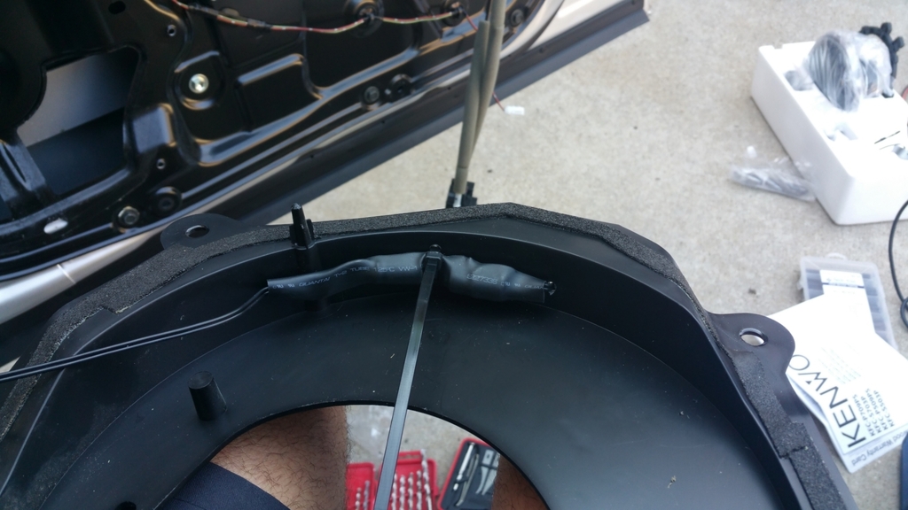

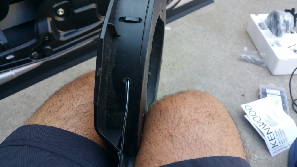

Drilled a small hole for the wires and just put butyl putty on it to make it waterproof. Please excuse the hairy ape legs.
Also, tucked the crossover up against the top and ziptied it up there.

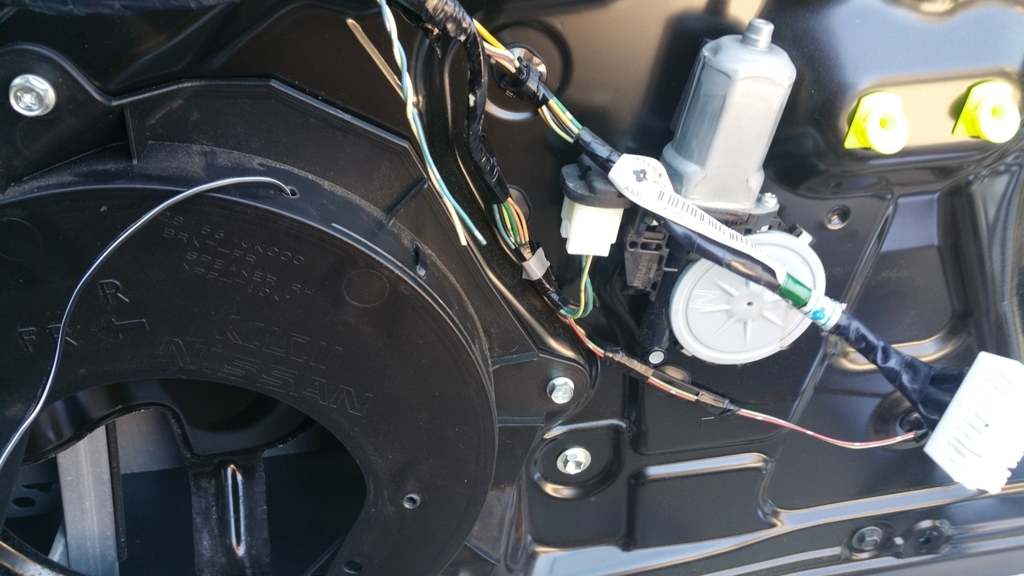

Everything all hooked up. I solder when I can.

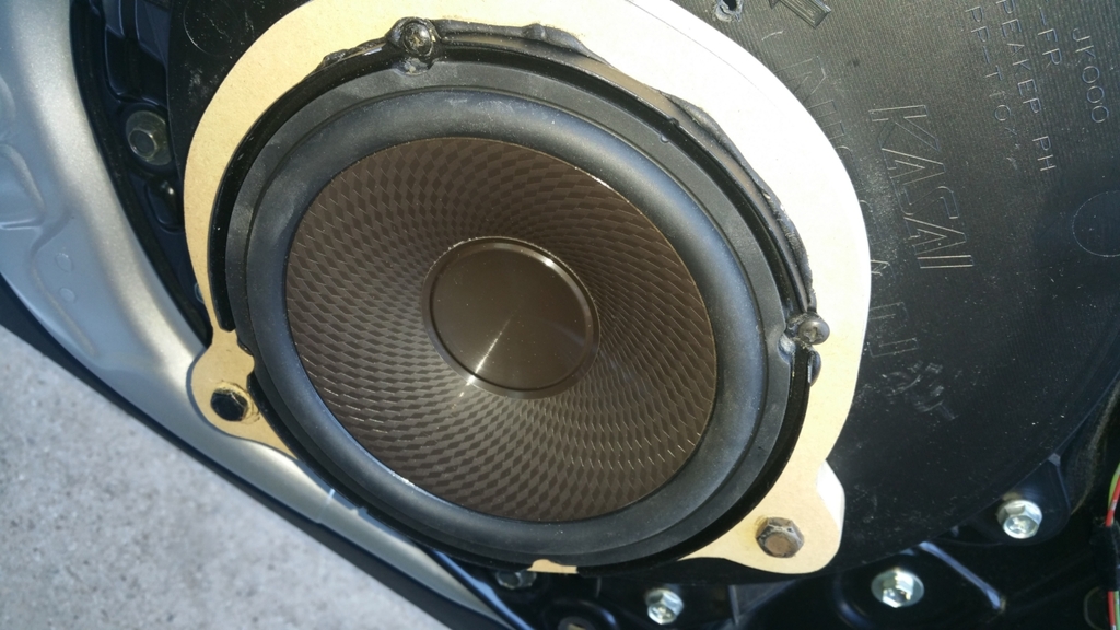

I made my own spacers and used butyl tape behind the speaker and the spacer in order to seal it all up.

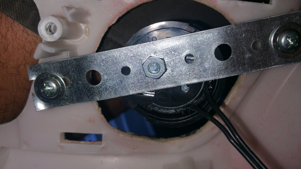

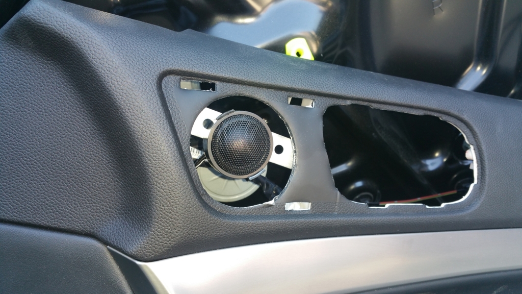

Had to mount the tweeter using a little ingenuity:
Old Sep 14, 2015 | 06:31 PM
flyng_fool's Avatar
flyng_fool
Joined: Jul 2015
Posts: 67
From: Frisco, TX
All closed up it looks stock. The sound is quite a bit better. The highs are much more detailed and the bass is a lot cleaner and punchier. It doesn't seem to hit any harder but it does dig a bit lower. The system badly needs a sub. I'm going to do the rears with a set of coaxials and put a very small 10" or 12" sub in the back with the smallest enclosure I can get away with.
I don't need to go boom, boom, boom down the street like some kid. Just want a little nice system that doesn't sound like hammered dog ****.

Are your stock door speakers the 10' sub? If so how did you mount the aftermarket speakers? I saw that you have a spacer, did you make that or you bought it?
Old Sep 17, 2015 | 08:58 AM
flyng_fool's Avatar
flyng_fool
Joined: Jul 2015
Posts: 67
From: Frisco, TX
The 10" speakers are for the Bose system. The stock system has 6 1/2" speakers. I made the spacers myself, it was pretty easy. I tore the original speaker apart and traced the outside, then I took the template for the cut out for the new speaker and cut out the middle. Easy peasy.
