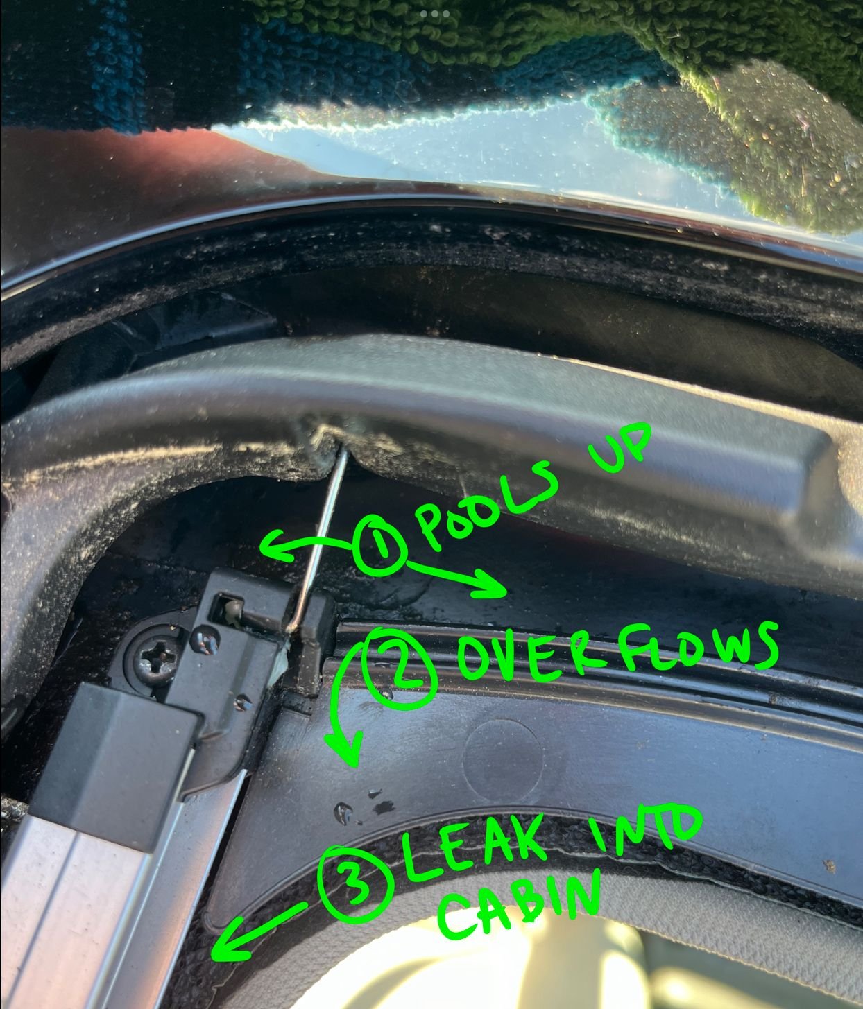

Ok got to taking things apart today, but ran outta time.
TL;DR: I think my front driver drain is totally blocked somehow (near the inlet/within the channel that surrounds the sunroof), which with enough rain, causes water to pool and overflow into the top of the headliner (and subsequently down the drivers A pillar).
Does this theory hold water (pun intended)? If so, anyone have tips on how to resolve??
Evidence as follows:
Exhibit C I poured water into the sunroof channel, and the water did not drain down into the A pillar (it did so on the passenger side, and went all the down down thru the passenger footwell)!! I also noticed that the foam between the channel and the headliner was damp !
Exhibit D what I believe is going on to cause the cabin leak (which runs down the A pillar and all the way down to the driver footwell). Could this be possible? Any thoughts on fixes ?.
Update on this (in case anyone else runs into a wet A pillar): I tested all 4 drains along the sunroof drain “channel” and I found that the front-driver side drain was clogged entirely. So that was pretty conclusively the culprit. So pretty sure I nailed it with the diagrams above.
How did I clear said clog? I just unbent a heavy-duty paper clip, and poked around in the corner of the sunroof channel, until I felt the paper lip sliding down into an inlet/drain hole. Really had no idea what I was doing, it’s difficult to see how the water drains out of that channel. But once the paper clip found a hole, I jostled it a bit and now that inlet properly drains (was able to confirm by watching water run down thru drain tube within the A pillar).
So one more battle won against the sunroof drainage system…
So the difficult to see metal/plastic nipple that is located on the top left under the sunroof assembly which connects to the hose is what was clogged?
Yep! I was able to drop the headliner to see how and where the drain tube connects to the sunroof assembly. But for the life of me, I couldn’t get a visual on how the water actually makes it to that connect.
So I basically just poked around til I felt something. And when I did, I gave it a few swirls to clear out whatever gunk was in there that was causing water to pool up. After that, I poured some water down that side of the sunroof assembly and it successfully drained
The black hole is somewhere down here

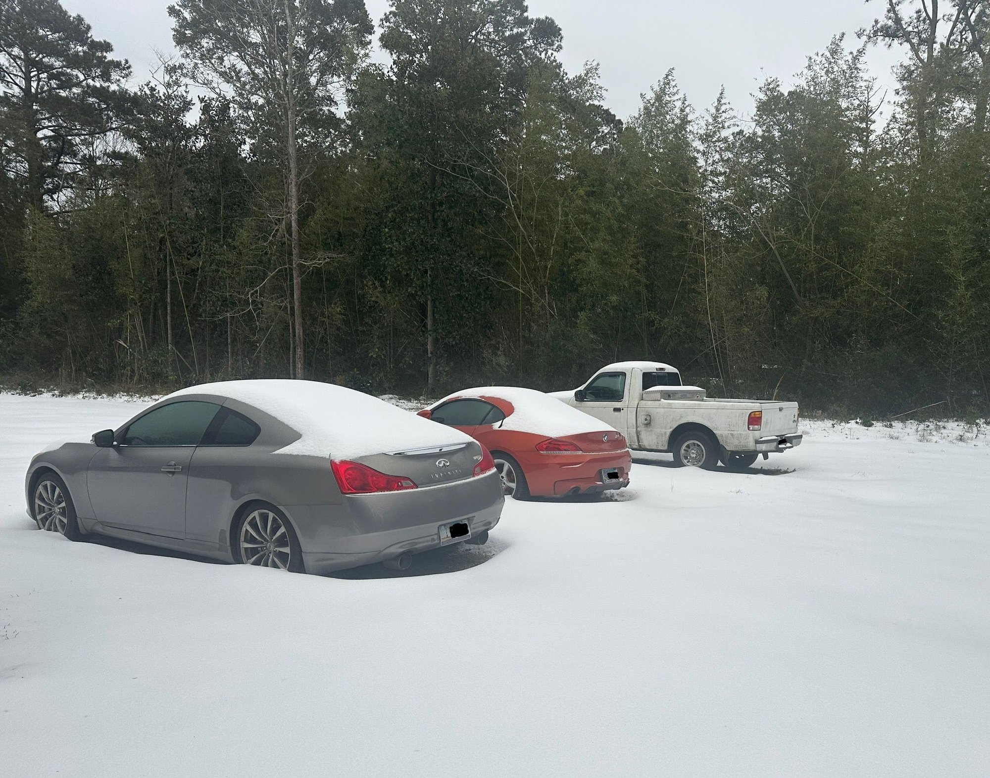

^^^That's a cool pic.

My inlaws live in a pocket valley in North Carolina. It has its own weather patterns LOL - it can be just cold outside the vale and snow inside, or vice versa. We evac there for hurricanes because even when the outside is getting historic rainfall and winds, they get nothing.
Here's yesterday. I'm still in PJs today working from home (oops left webcam at work, can't have video feed)...
