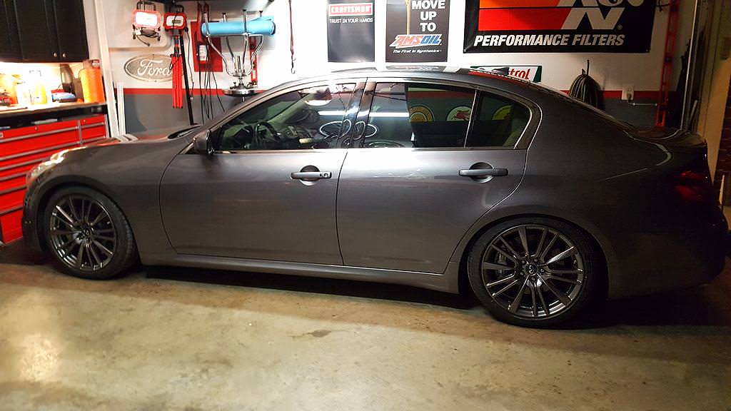

Originally Posted by AARONHL
Anyone runnin the 2017 19x9 q60 wheels on the sedan?
I realize this was asked a few months ago...I just strapped a set of 19x9 Q60RS wheels on my sedan. Tires are 245/40/19 all around. Offset is +37.
