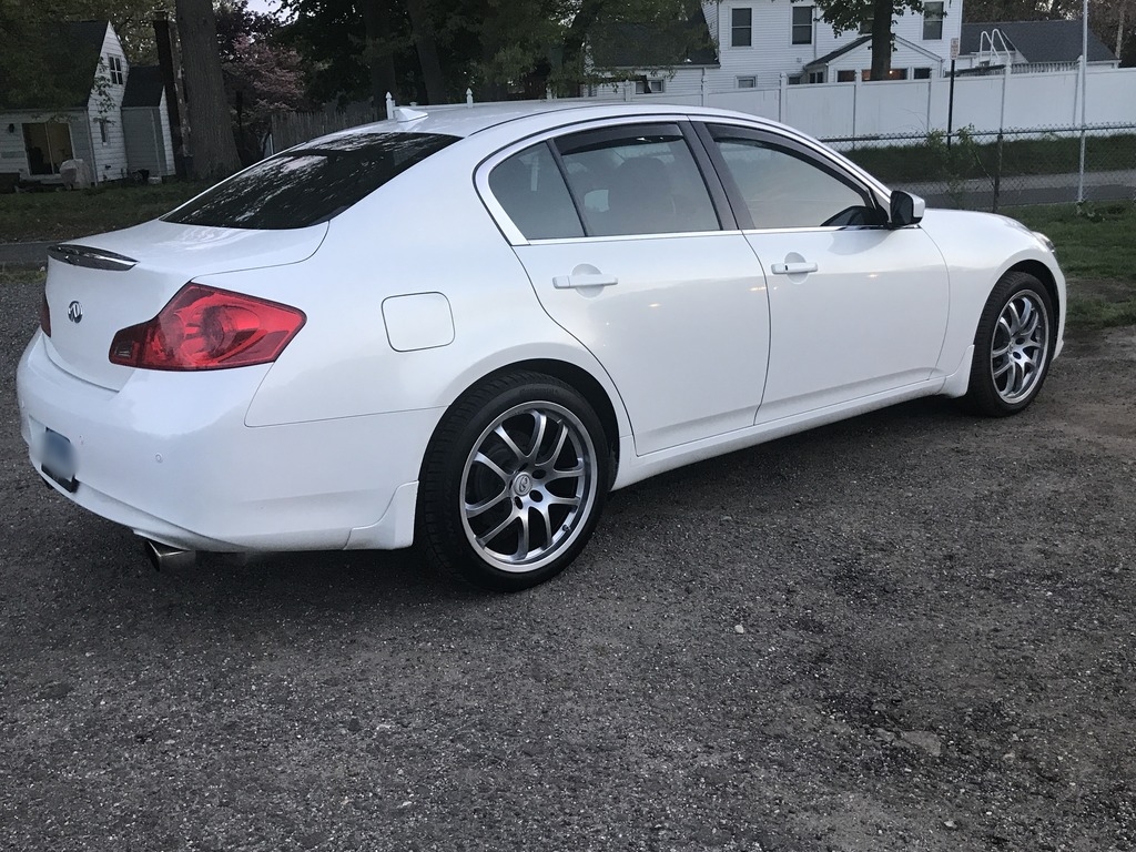

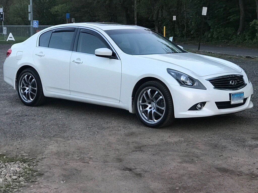

pix with G35 19" Rays
Old May 13, 2017 | 06:28 PM

Just like Campbell's soup -- mmm good.
that's classic Thank you!
