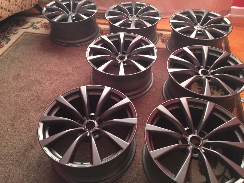

One vert wheel away from another set. I have a full matte gun mental set with vert rears and coupe rears and the other is a gloss gunmetal with coupe fronts and one vert rear
You can really see the deeper offset of the vert wheel with the gloss.

So one front vert wheel away from a full set of verts & a full set of standard coupes, glad you're situation is almost resolved. Wheel finishes look great BTW.
One wheel away from finally getting a full nights sleep, bet you can't wait

One rear vert wheel away from having 4 vert rears I have a full standard coupe set, then I'll paint and sell it to recoup some of the spent money.
Unfortunately the tires I want are still back ordered. And the coilovers are just screaming to be installed for the last few weeks.
Yes I'll be soo releaved when the ordeal is over.
