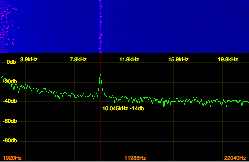

Old Nov 11, 2009 | 07:36 PM
  #204
punker's Avatar
punker
Posts: 6
technical info
After taking my brand new g37x to the dealer (who could not hear the noise) I pulled out my own equipment to get some specifics. Take a look at the pic below, the baseline is the engine noise at 1200 rpm. The peak is around 10kHz (10.045 kHz on the graph, but I didnt nudge the pointer right to the middle.) -14dB is pretty loud, considering I was parked.
Attached Thumbnails High-Pitch/Frequency Noise Poll-carnoise.jpg
That is beyond sweet and exactly what I expected based on the test sound I used from the signal generator that I downloaded from the web. So what the chart shows is that the baseline noise is fairly low, but the 10kHz frequency is much louder in comparison...right? Can you do two things....a) explain what the -14db means in layman's terms in comparison to the baseline - loudness, etc. (also remind me why there is a negative there), and b) can you possibly take a reading while the car is at a higher speed with no radio or ventilation system blowing? Mine seems to get louder with speed up to a point.
Have you shown the chart to your dealer? Maybe the CEO of Nissan/Infiniti needs to see your test chart.
Old Nov 11, 2009 | 09:37 PM
  #206
punker's Avatar
punker
Posts: 6
technical info
As a first swag, what you can read off of it is that there is about a 20dB difference between the 'normal' noise that the car should make, and the noise this tone makes. Thats a big difference. Dont worry about the -14dB reading, thats relative to a bunch of variables. Tommorow I'll get some real data - i.e. car turned off, car turned on, car driving. I'll also get a more accurate +-5 Hz (not that it really matters) freq. How fast do switching power supplies 'switch'?
Old Nov 11, 2009 | 10:38 PM
  #207
Silver37's Avatar
Silver37
Joined: Mar 2009
Posts: 381
Awesome....look forward to seeing your results. Is there any way to determine the approximate db level of that frequency like you'd see in car reviews where they measure noise at highway cruising and wide-open throttle? In other words, if our cars normally produce 70 db at highway speeds, what would the db level of the 10K frequency be...I really hope it's not a +20 db gain like you've seen on your initial test or else all of us with good hearing will be in trouble.
Old Nov 12, 2009 | 01:20 AM
  #208
Riley's Avatar
Riley
Joined: Jan 2009
Posts: 178
...snip... How fast do switching power supplies 'switch'?
10KHz is about at the bottom end of where a switching power supply would operate. The lower the frequency, the larger (and more expensive) the components.
From Wikipedia:
A switched-mode power supply (SMPS) works on a different principle. AC mains input is directly rectified without the use of a transformer, to obtain a DC voltage. This voltage is then sliced into small pieces by a high-speed electronic switch. The size of these slices grows larger as power output requirements increase.
The input power slicing occurs at a very high speed (typically 10 kHz — 1 MHz). High frequency and high voltages in this first stage permit much smaller step down transformers than are in a linear power supply. After the transformer secondary, the AC is again rectified to DC. To keep output voltage constant, the power supply needs a sophisticated feedback controller to monitor current draw by the load.
Who knows if this noise is from a "switcher", it's just a guess. they are very common in modern electronic designs.

Punker...
When you do your next test, could you also record some sound clips and post to the forum? That may help others identify or confirm the same noise in their cars. It may also help others realize they can't hear those frequencies, which may help explain why many of the Infiniti techs can't hear it.
