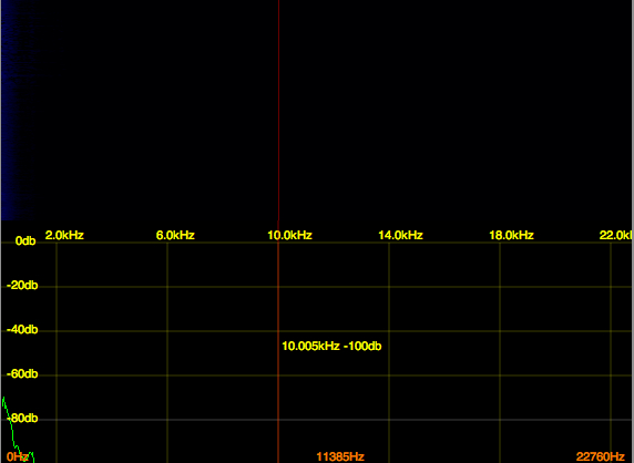

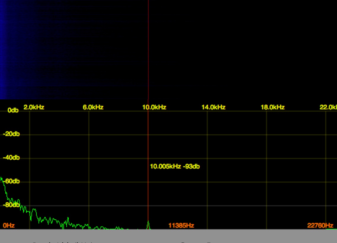

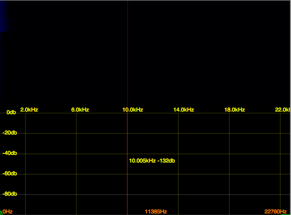

As promised -
The method I took this time was more rigorous, so it can be duplicated again exactly by someone with the same setup:
laptop - MacBook Pro c. Feb 2009
Software - Garageband for the audio sample, and iSpectrum for the graphs/data
microphone - blue snowflake USB mic. (pretty cool little mic)
I do have an audio sample, but the limit on size doesn't allow me to post.
As for the rest, each thumbnail is labeled.
The takeaway is that 1. yes, there is an anomaly 2. the level does increase slightly with RPM, but not by much. 3. we have some pretty quiet cars, other than at 10 kHz.

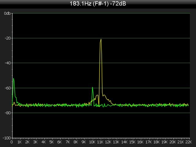

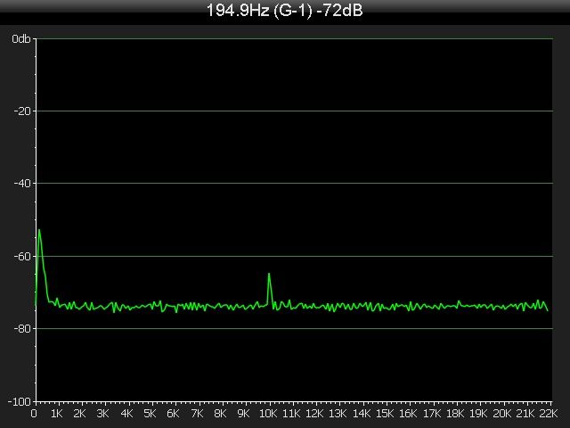

Okay here are my audio tests. Both images are from car at rest, engine revved to 1200 rpm. Gain set to +20 db. You can clearly see the peak at 9,905/9,9115 hz The light-colored peak in one of the images is a reference tone at 11,000 hz. The lower frequency peaks are the engine and exhaust noise, with a peak at 183-194 hz.
My thoughts:
1. As per the other poster, there is CLEARLY a narrow-band audio anomaly at right around 10 k hz.
2. The anomaly is essentially a sine wave.
3. The anomaly is clearly **almost** as loud as the exhaust/engine rumble.
4. The anomaly is high enough in the frequency spectrum to appear much quieter than it actually is (as per the SPL readings) and may appear inconsequential to older individuals or those with hearing loss.
5. This is bull**** that I have to ride around listening to this GD noise.
6. I found that my gym bag, in the footwell of the passenger side of the car, significantly decreased the perceived (and possibly the actual) noise level.
Attached Thumbnails High-Pitch/Frequency Noise Poll-img_0376.jpg   High-Pitch/Frequency Noise Poll-img_0377.jpg

Looks like you've duplicated the results of the earlier test and proven that those of us complaining are not crazy and that there's definitely an issue. Need to send these results to Carlos Ghosn - CEO of Nissan. He's definitely a car guy and will jump their technical department to get this fixed. A real soundclip would be the trick since they could analyze and reproduce your results. Any way to record the sound on your app?
