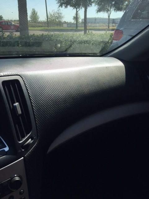

So... I was going to remove the dash and install a vinyl wrap to hide my melting dash. But I didn't want to create more problem than as is so I just installed it and this is how it turned out. It still has many bubbles and many edges for touch up but I am really happy with the result.
This was my first time experiencing with wraps and it was fairly easy to use. I just needed to be patient with wraps sticking to each other and blehhhhh.....

Not bad at all! Would like to see more. Does your car sit outside during the day? If so, I'd recommend stopping by a tint shop and getting a clear film applied to your windshield. Its perfectly legal and will block a great deal of heat and UV rays. Your interior will thank you. 3m crystalline is a common film. I've been in Dallas during the summer, its brutal.
