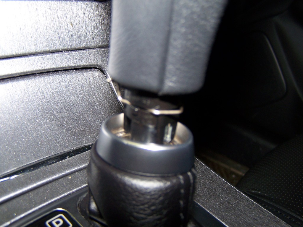

To remove the OEM ****, just hold the collar on both sides and firmly press down, the collar will snap off and you can slide the boot down to expose the "U" clip.
Just pull the 2 outward prongs out and slide the clip back, then just pull up on the **** to remove, then replace that clip back on the **** since it's very small (and probably costly to replace).

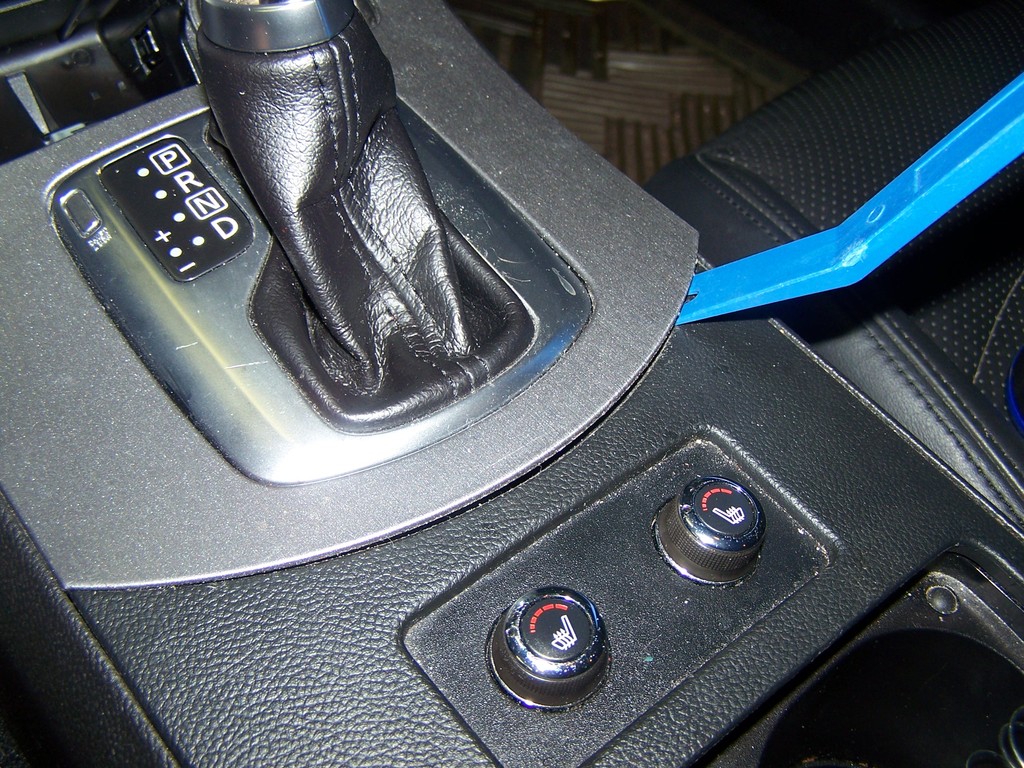

Once you get the **** off you need to remove the shift console cover, this is simple but you MUST use a plastic pry tool of some sort, I have a variety of these cheap Harbor Freight body panel tools that I use. If all you have is a small screwdriver try to protect the panels by using a couple thin credit cards on the outside of the screwdriver head. You then just pry up in each rear corner to release the pawls.

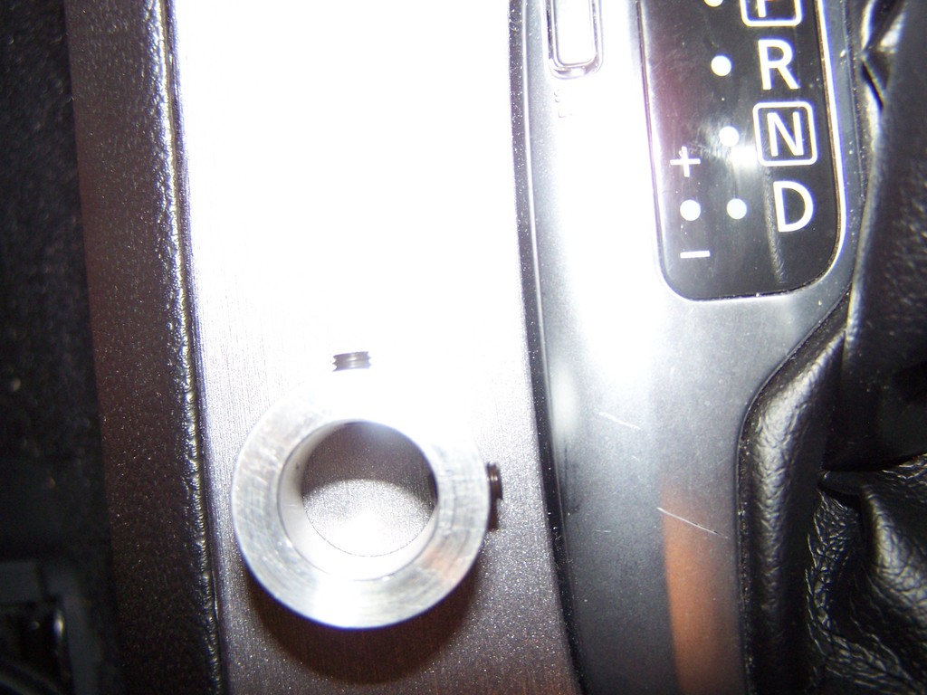

After you cut the zip tie you can decide what you want to do w/ the mating of the boot. After some trial & error I decided to remove the OEM collar and pull the boot up to the straight section of the shift ****. This setup allows the boot to be in the best place without interfering w/ shifting.
The black plastic sleeve goes inside the collar w/ the 2 set screws. This is a very tight fit, which is good, but you need to get it down just far enough, otherwise you'll have to use a gear puller to get the collar back up (don't ask me how I know )
Once you decide on your boot setup, put the boot back over the shift rod, then put the panel loosely back in place
Put threaded lower tapered piece on first
You set it up so the LONG set screws are at 12 o'clock and 3 o'clock when looking straight down the shift rod. You place the plastic sleeve just barely on the rod w/ the full cutout at 12 and the half cutout at 3, the cutout MUST be on top w/ the closed section facing downward, this will allow the sleeve to slide down w/ the collar when the set screw is inserted and tightened down just enough to contact the shift rod, hopefully this makes sense.

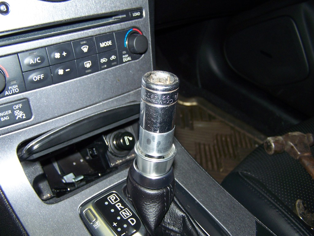

Use a extended socket to careful hammer the collar down, be sure the plastic sleeve is lined up properly and the 3 oclock set scre is in far enough to hold the sleeve as you hammer it down.

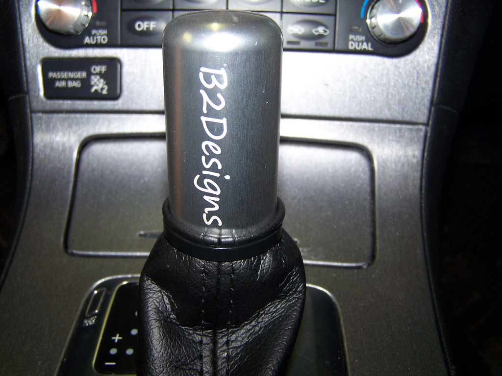

You then install spring and thread the **** on, pull the boot up, and presto! The zip tie is temporary FWIW, I think I'll be using a thin amount of the boot and put it right above the tapered piece and just clamp it down by threading the **** down on it.

How did you manage to hammer the collar down the shift rod with the black plastic sleeve inside it? I tried really hard but still couldn't do it. When I tried to push the black plastic sleeve through the rod by itself, it expanded a little bit, which was too big to be inside the collar.

Third: I had to use my tool to pry the trim off in a different location. I think this is because I have an X, hence a snow switch:
By trying to pry further forward on the trim this happened:
Not a big deal. I just took the 6 screws out of the back of the panel and glued it back together.
Fourth: I also had to use my tool to remove the trim in front of the ashtray to make it easier to pull my unit out of the trim:

I just barely put the plastic sleeve atop the shift rod, just enough to get it started, I then got the collar lined up w/ the set screw (the one at 3 oclock) w/ the set screw out just enough to fully extend into the slot of the plastic sleeve, but not any further. Once I hammered the collar down it eventually got to the point where the set screw was against the bottom of that half slot, and it pushed the collar down flush w/ the sleeve as I hammered it down.

how did you remove the center trim? I have an X as well. Please let me know asap.

It's pretty straight forward. You just have to pry it open. Then pry the piece above the ashtray and remove it before you remove the center trim. See step 3 and 4 in VIVID post and make sure you do not pry the center piece at the location where VIVID broke the plastic piece. This black piece and the shifter piece are screwed together from the bottom.

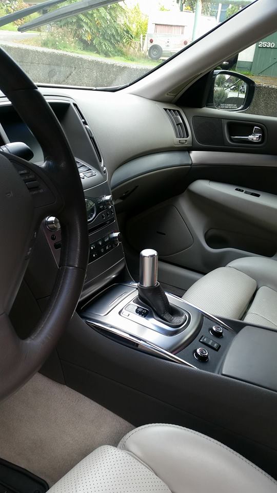

Does your guys' **** spin?
Attached Thumbnails DIY AT shift knob replacement (B2Autodesign model)-12080898_10208170161438266_1406832280_n.jpg
