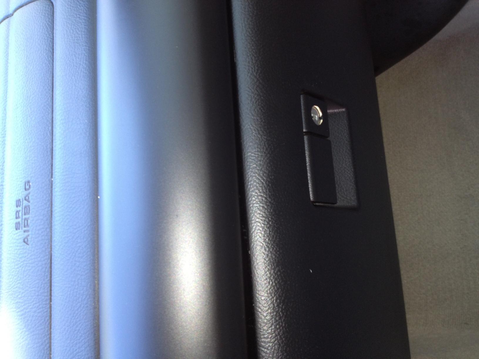

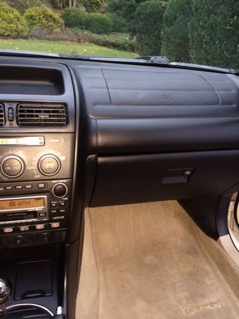

So I realize this is for a different car, but my 2003 Lexus IS300 had the "melting dash" syndrome too. Its caused by the type of paint coating used in those cars. Areas where heat and humidity exist will cause the dash to eventually melt and get all over the fabric and interior of the car.
Only fix was to take out the dash, use carb and brake cleaner to strip it all off, prime it and then paint it with duplicolor vinyl spray paint. Needless to say, it came out awesome! That spray is great stuff.
Here's some pictures of my adventure I took on over 2 years ago. Also, it took about 2 hours to fully remove the dash and 1.5 hours to put it back. Honestly its a simple process (take off bolt here, pull out clip there,...) but keeping track of things is the hardest part.
