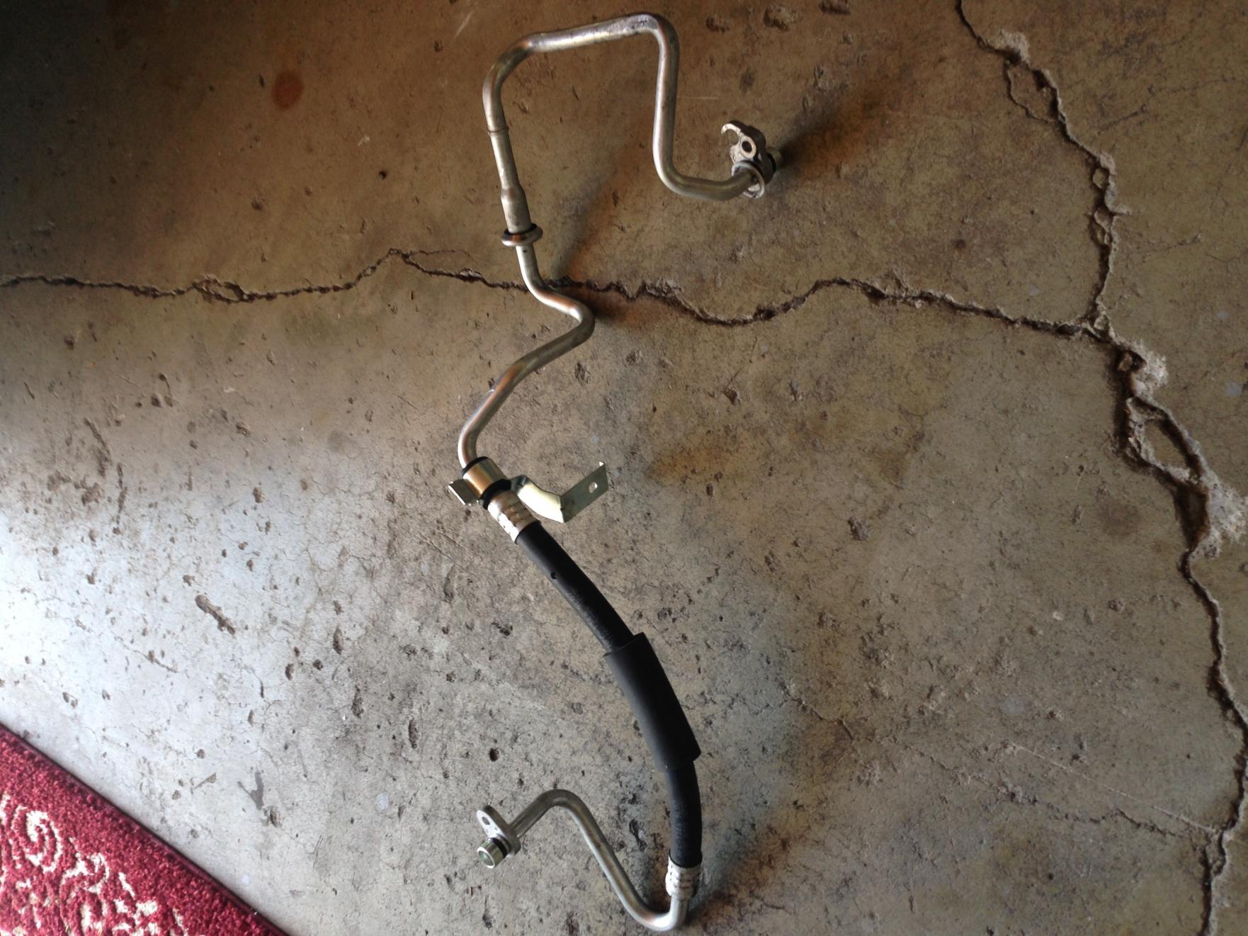

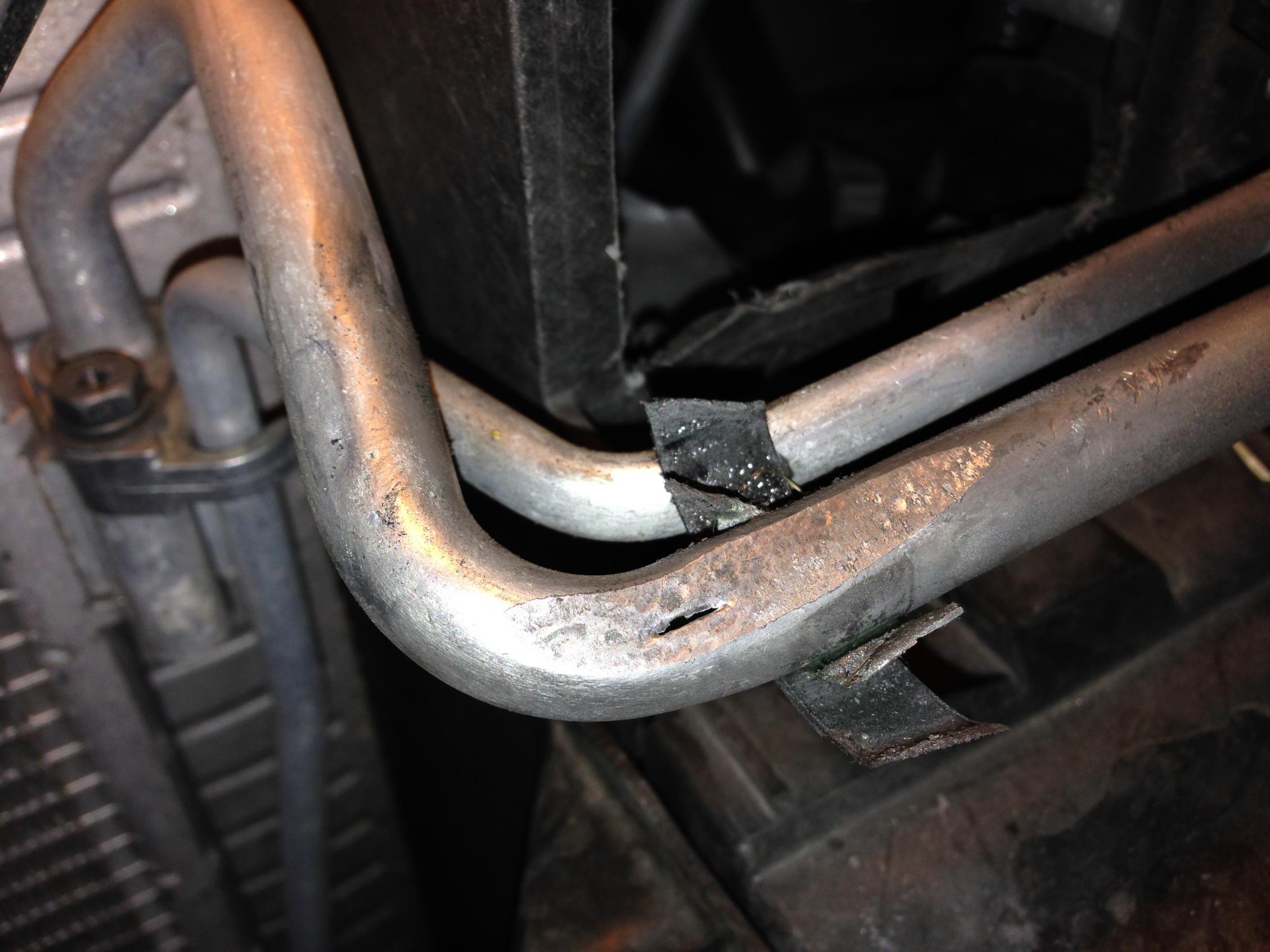

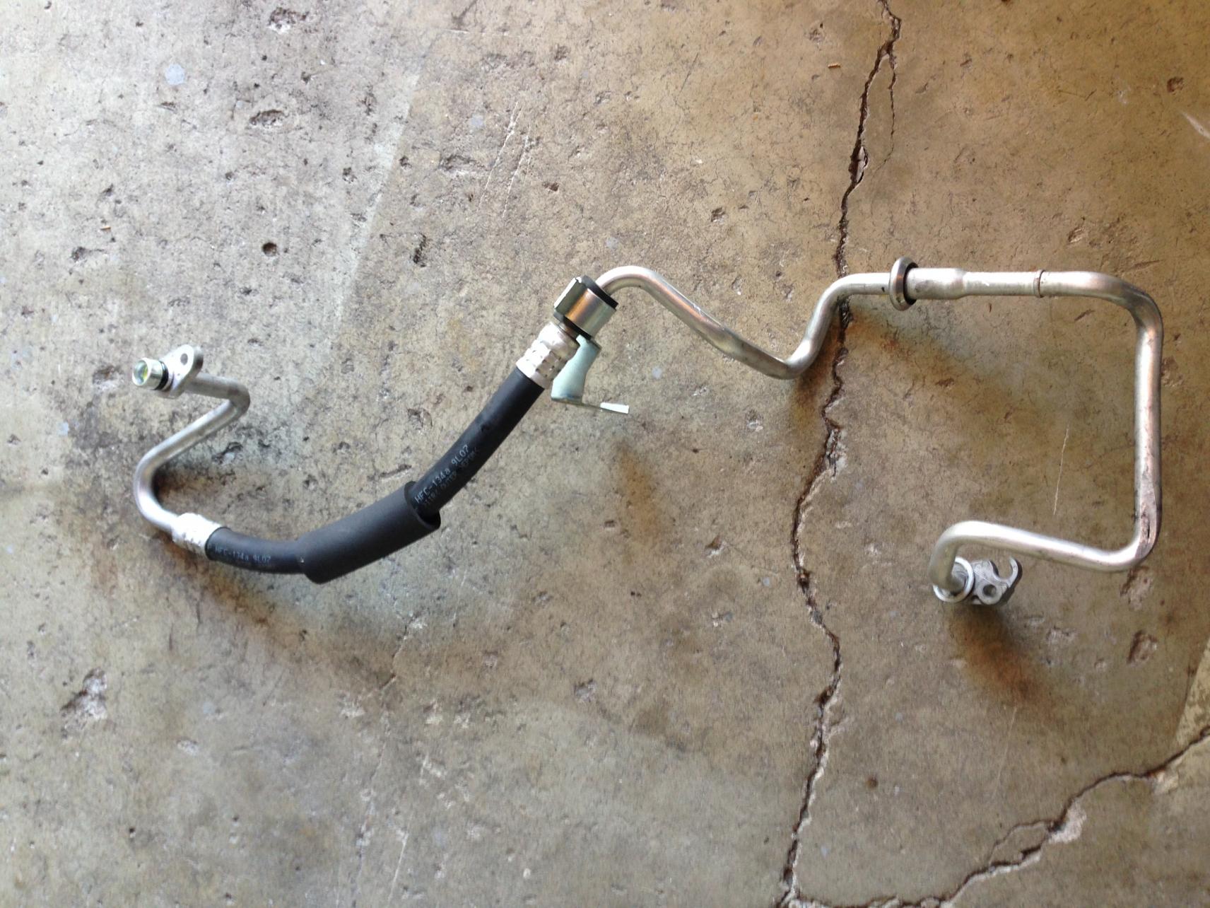

I just ran into the same exact problem and Infiniti quoted me $850 to replace this!
So what I did was took out my Gen 3 intake, took out the line (super easy), and replaced it. I bought the replacement part for 60 bucks on ebay. The part number for this specific pipe is 924403WK0A.
924403WK0A | eBay
Let me know if you have any questions, this is a super easy DIY fix!
Attached Thumbnails Anyone with A/C problems??  I'm already dry.  Possible leak?-img_5104.jpg   Anyone with A/C problems??  I'm already dry.  Possible leak?-img_5115.jpg   Anyone with A/C problems??  I'm already dry.  Possible leak?-img_5116.jpg
924403WK0A | eBay
Good move!
Yeah, A/C plumbing really is just plumbing; it only takes special equipment to do the evacuation and recharge.

Yes my STILLEN cold air intake ribbed a hole in the ac line. Same issue here i got a 370Z by the way.

I am running into the same issue on my coupe. But although I can see how the line is beat up. I do not see a hole after cleaning it. Any ideas? Working on it now. Any help is appreciate it!
