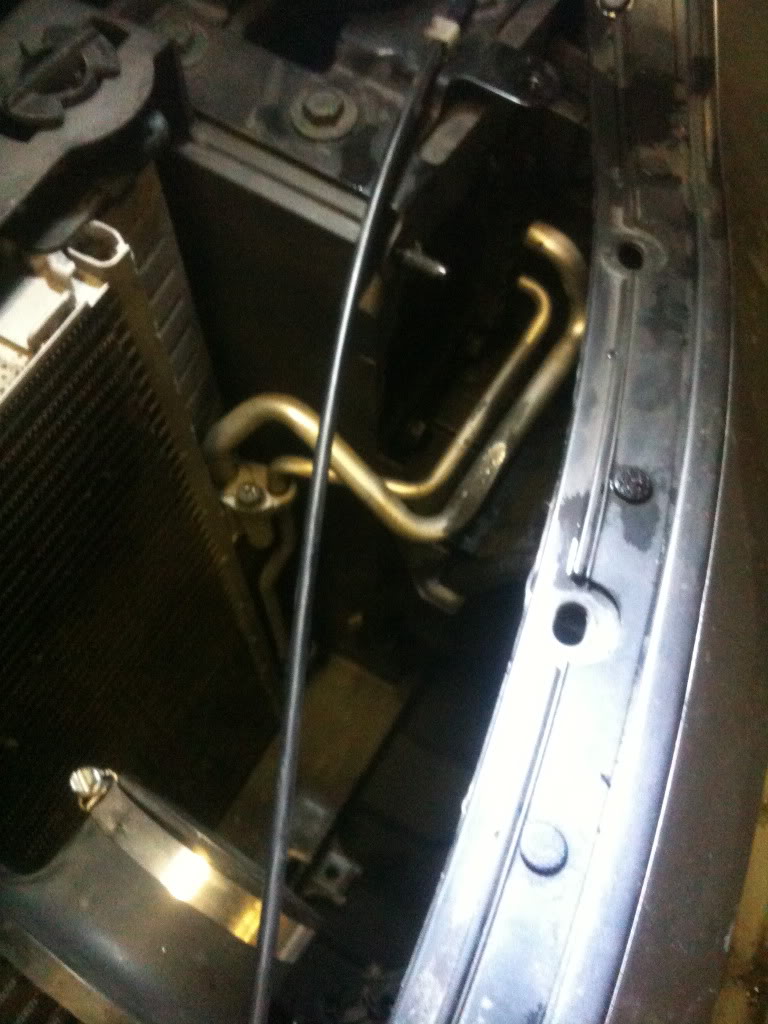

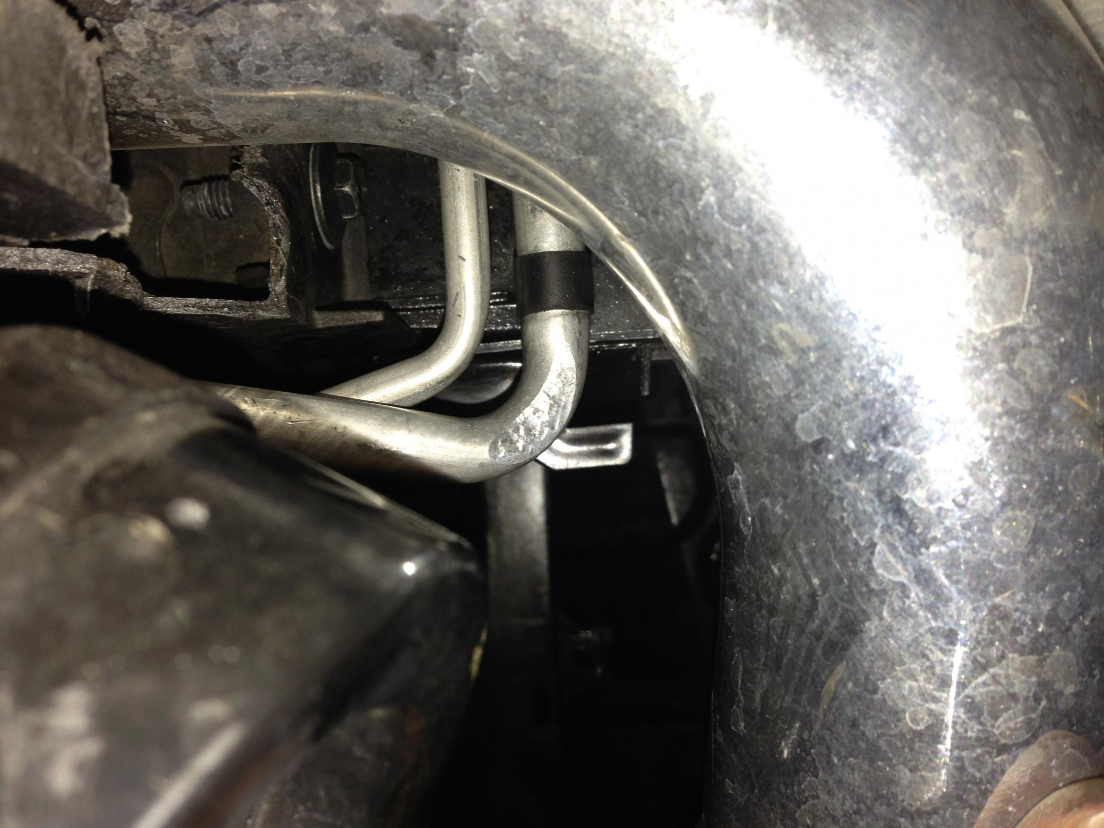

Definitely a serious leak.... Anyone with Stillen gen III's be careful if they rub your ac lines. I even tried to bring them higher on their mounts but it still rests on the line. I am going to have to get a new line and tweak it a little and wrap it in tubing to make sure it doesn't rub through again

I have the gen 3 and mine tore right through my line TWICE. The intake is a POS, i had to cut a wider opening in my frame and zip-tie the pipe to sit higher up to prevent rubbing on the line again. Line + labor = $400 a pop

To keep it from rubbing your AC line and causing a leak, buy $1 worth of rubber heater hose in the appropriate diameter and slit it down the side. Wrap it around the AC line to insulate it from the abrasion. Volila!

Yep, i was gonna wrap it in some rubber hose exactly like blackbetty described. Should take care of it then

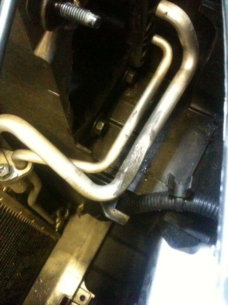

Have the same issue by any chance do you know the name of that line
