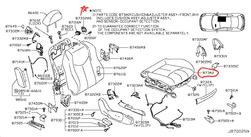

I did some checking and the Occupant Detection Sensor (passenger) can not be purchased separately. A whole new seat bottom is needed to the tune of roughly $5500-$6700.
Unreal.
According to parts.infinitiusa.com's website and the FSM, the bottom cushion, adjuster assembly, occupant sensor, and frame are one (1) complete unit.
Might be able to just find the seat bottom off eBay rather than the whole seat.
Hope some of this helps.
