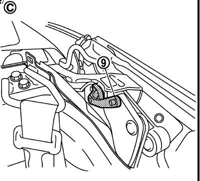

Daryl, Hopefully your FSM shows this picture on location of the sensor.
Roof state sensor
Roof state sensor
This looks to me to be the roof linkage on the drivers side. The roundish head just forward from the highlighted part is the forward portion of the roof main lift cylinder. I recall seeing this during my recent cylinder replacement project. All of these components are held in place by pins with 'E' clips on one side. I suspect this one is as well.
However, to expose the mechanical parts of the roof linkage, you will need to remove the drivers side rear seat panel. I suppose it may be able to be done without removing the seats - however, I took out the back seat (bottom and back) to avoid damaging the panel due to the tight quarters(note that there are two plastic rivets, one is hiding a 10mm bolt so be careful with your panel tool) . This panel also covers and protects the Roof Control Module. And, from the photo from a following post, it looks like that lead connector may plug directly into the RCM. This is annoying but achievable - I followed Klaus' videos on www.tophydraulics.com on the disassembly procedure.
I am in the re-learn portion of my project and the techs at Infiniti are unable to sense the motor functioning. I was able to power-probe the motor and it spins - so I need to look elsewhere and this sensor may be a contributor to my pain. If anyone has other thoughts - please share. I will update this thread with results.
