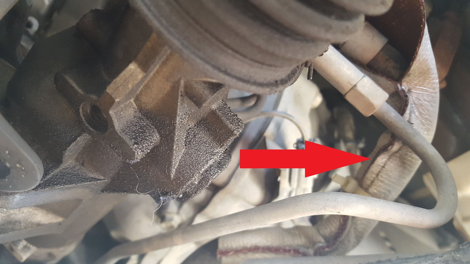

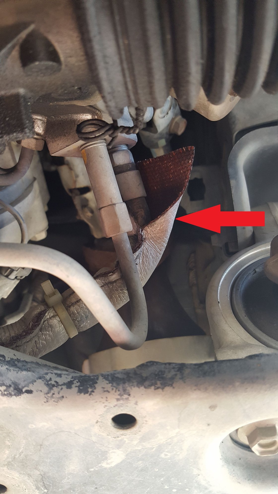

Pics
Hope everyone had an awesome weekend.
I apologize for the delay. Lots going on. Here are some pics of the hose. It attaches to the upper coolant port on the transmission. The lower is a pipe, not a hose. Hope this helps. If anyone could get a P/N that would be awesome. I've looked through infinitipartsonline and others and everything shows a pipe direct to the tranny.
Thank you.

If you have a coolant leak behind the engine, one possible source could be below:
I don't think that's it. On my transmission cooler manifold, both input and output are about 2" apart. Looks like yours are quite a bit apart. I'm going to look closer at the routing on that and see if it matches the turns on my hose.
