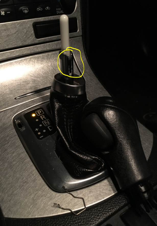

Originally Posted by macdog1997
still no luck. the white pin that goes into the shifter seems to be working correctly. It locks into park and won't let me go into reverse. but still indicates the light on gauge cluster, and constant beeping.
IDK if you fixed it or not but im having the same problem and its becasuse my car was broken into and they broke the shifter off and broke 2 pins which i see you are also missing this is the problem and lmk if you saw it by now an how you fixed it
