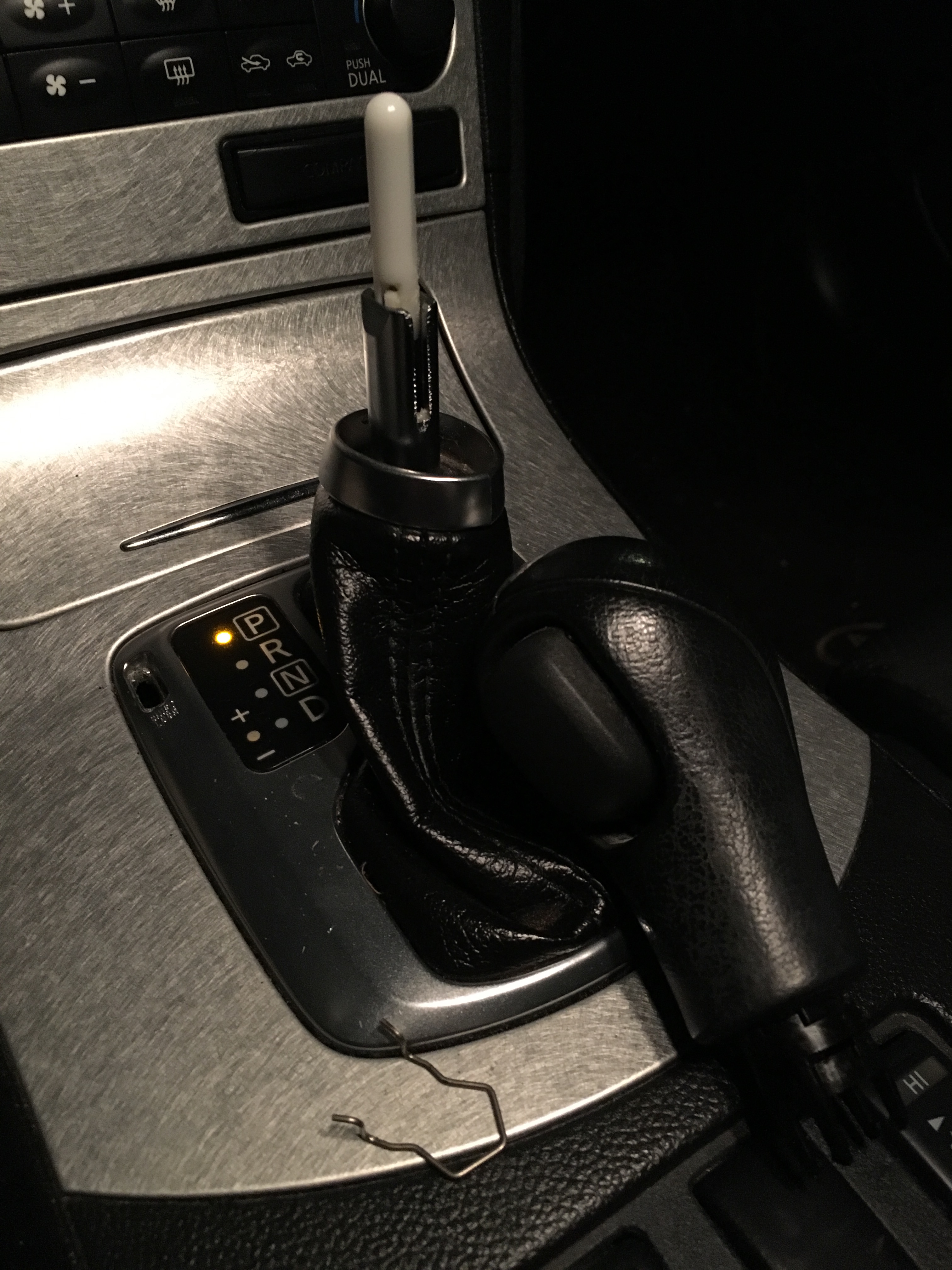

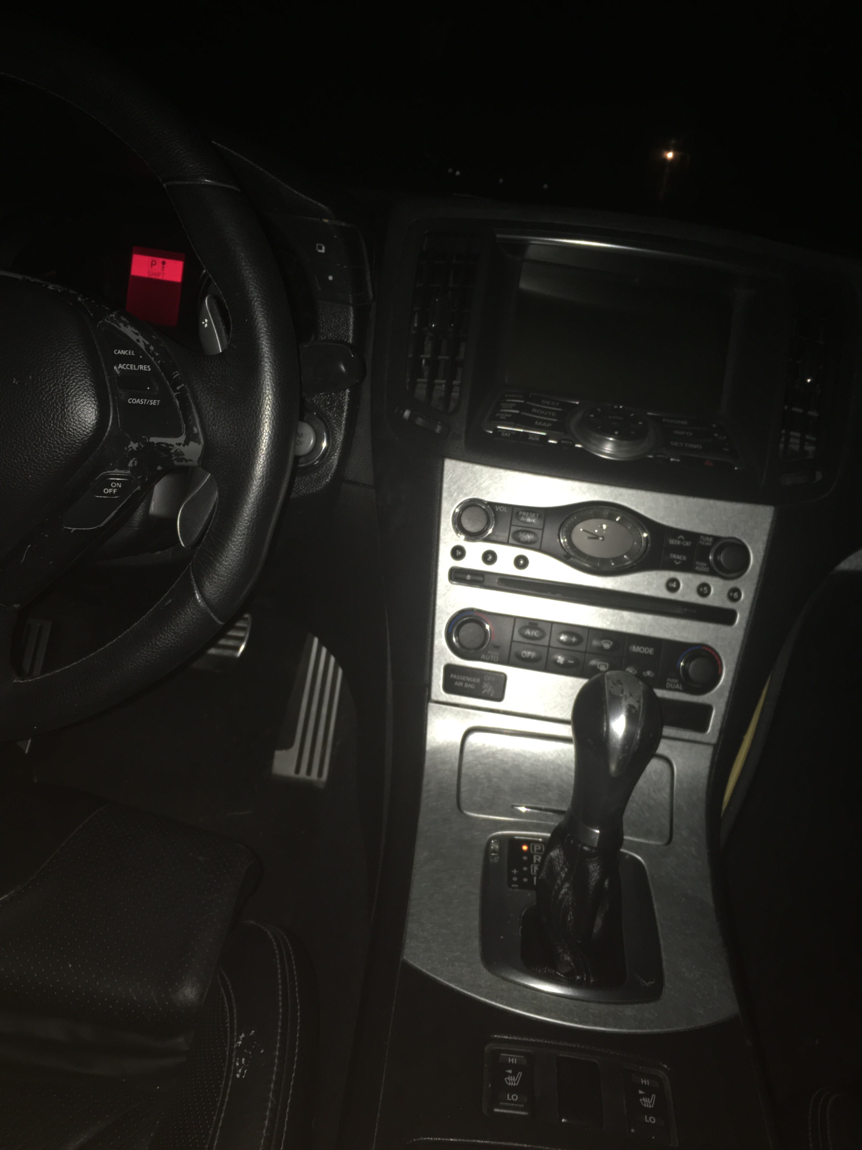

still no luck. the white pin that goes into the shifter seems to be working correctly. It locks into park and won't let me go into reverse. but still indicates the light on gauge cluster, and constant beeping.

Have you tried pulling up on the white pin? Mine will engage in park even if the pun isn't all the way up

I'll try that today. is there a how to, on taking off that interior plastic surrounding the shifter? I'd like to get underneath it to further diagnose if this isn't the problem.
