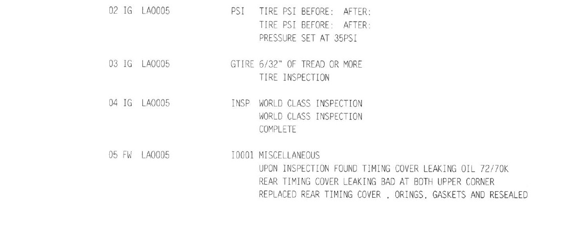

Sorry to resurrect an old thread, but I bought my g used with 77k miles. It's got 86k now.
I had my local infiniti dealer fax me the service records and found this. Does it look like they replaced the internal gaskets too, or do you think they just replaced the gaskets for the outer cover?
Do you think its possible I could get the dealership that did this service to fax or email me an itemized invoice with all the work performed?
thanks!!
Attached Thumbnails Timing chain gasket blown, need help with part info-untitle.jpg
thanks!!
It says the rear cover was resealed, so you should be good to go as that would be all the internal seals that are affected by that bad timing gasket.

Yup you're definitely good, the dealer replaces the entire rear cover which includes the two gaskets that go bad so you won't encounter this problem since you had that done, I'm sure you'll sleep a bit better now
