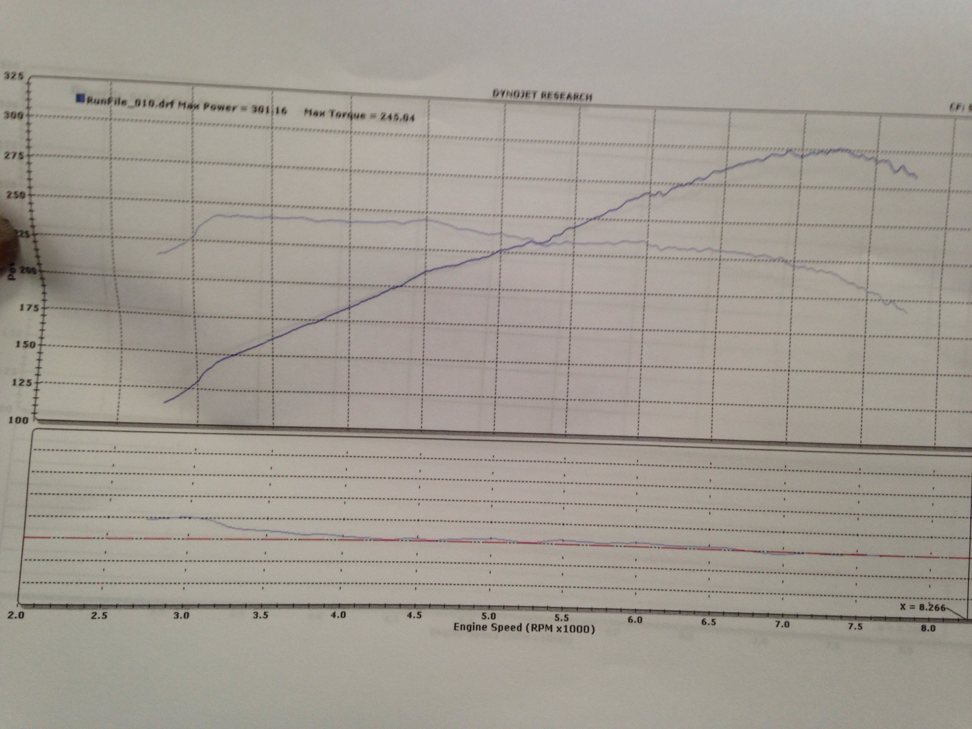

There is no power past 7500. I drag race a lot so the higher rev limit lets me shift at 7500 without hitting the rev limiter due to the auto's delay shifting.
My latest dyno from last week

I'm not at that rpm long anyway or do it everyday I don't road race. I have a 35 also and with the kinetix my power held to 7500. Now that I have the Z1 manifold I thought it would carry it further, but after last weeks dyno that is not the case.

Well my ecutek tune has been confirmed for next sat the 15th. John Visconti will be doing the tune himself.
Car will do 3 pulls on my uprev protune, remove uprev (I have a tuner cable), retune with ecutek and let the numbers speak for themselves for a same day, same dyno comparison of both software.
If I can pull 10+ over the protune I got last week I will be happy and feel that the switch was worth it (hopefully).
