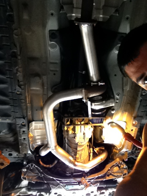

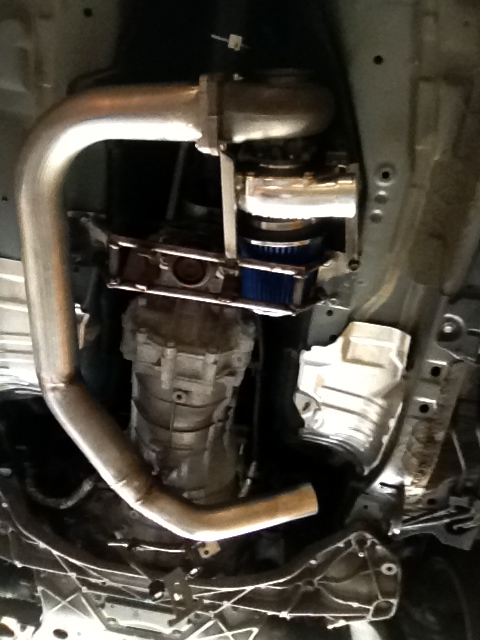

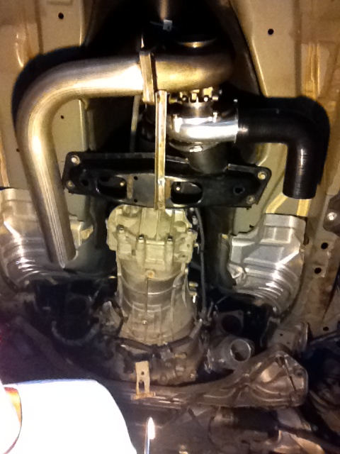

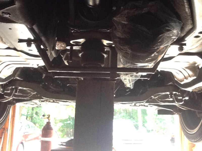

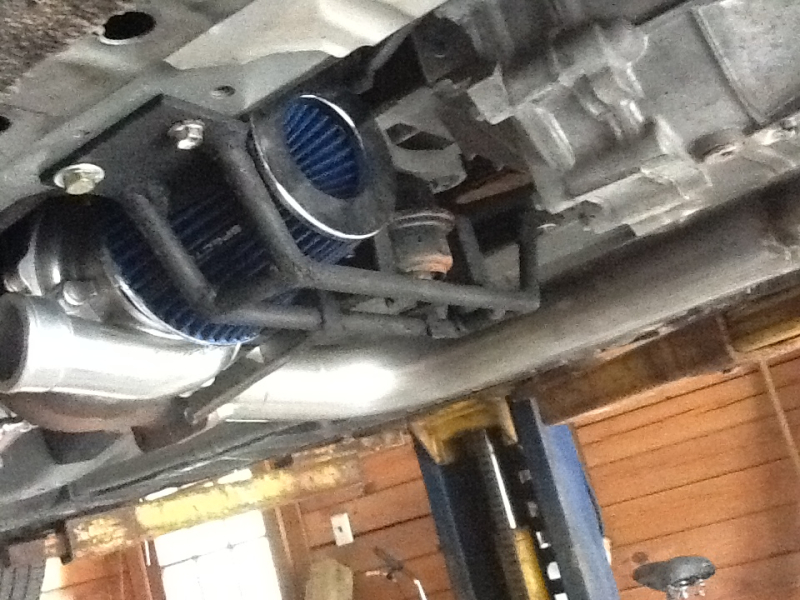

So I've been holding out on showing progress of this build because I was kicking around the idea of mass producing the kit, but it's just plain to much work to sell it cheap enough for people to buy a kit not made by gtm greddy hks ect. Anways here's my 2009 g37s 6 speed 50k miles I'm using a ball bearing billet wheel 67mm turbo from on 3 performance along with their 44 mm Wastegate. I fabricated a custom transmisson crossmember to mount the turbo and fit the air filter right on the turbo. I'm building a aluminum air box around the filter to protect from water and dirt. Here's pics so far please feel free to comment ask questions make suggestions or criticism.
I would have loved to make a top mount turbo like S&R, or a twin setup tucked up where the factory cats were. My goal was to boost the G for as little time and money as possible. I have only around 3000$ invested in this build and I have everything I need to finish and drive the car aside from a basetune. I still need to find someone local to make me a basemap so I can street tune it. If anyone has a suggestions please let me know.

That being said I wanted to make the routing of the piping as simple as possible to save money on material and time. Im a college student I go back to school in september, I can't begin guess the crazy hours that went into S&R kit. My car would still be in pieces trying to feed two 2.5 pipes through a very small opening between the firewall and headers, on top of mounting the turbo in engine bay with the tight clearance all around the engine. This is why they can charge 10k for their kit, they literally made a miracle. Although id find it hard the believe their kit can be modified to accommodate a huge turbo. I can fit my neighbors s372 with a full race cover on my bracket with space to go even bigger, So I have unlimited power capabilities and that's a lot of heat to be housing in the engine bay. I'm directing all the heat out of the engine bay.
I have around 18 hours of solid labor time so far. All that's left is intercooler piping, oil pluming, and a two peice belly pan that secures to zeus fastners secured to stock bolts under car. Zeus fastener for quick access, will cost about 30$ and a sheet of aluminum not sure yet, but this will solve all problems with water and dirt and make the car even more aero dynamic and cool a little better.

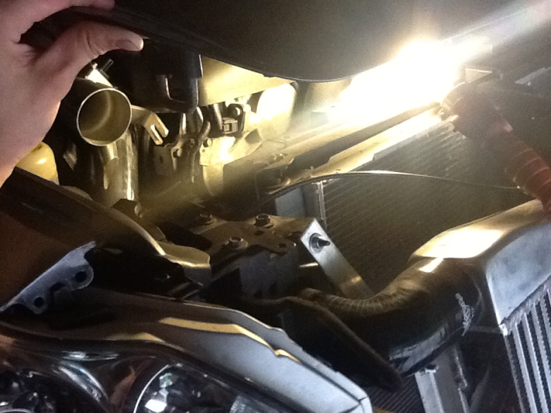

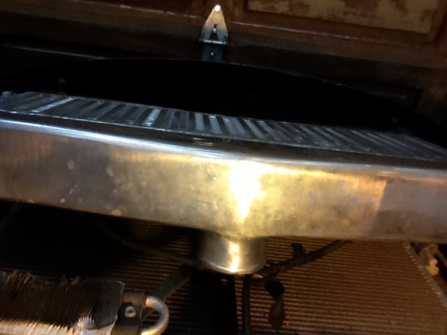

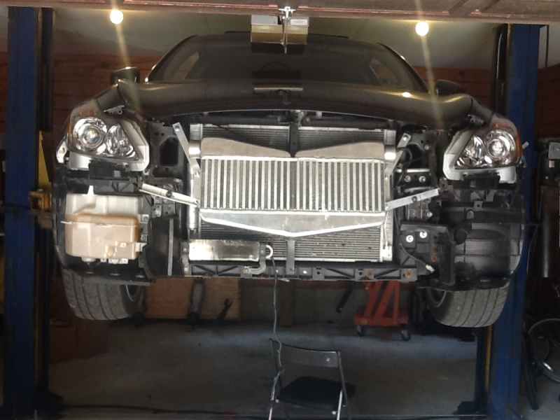

How many inlet or outlet does your intercooler has? To my understanding you should have one from turbo going in and 2 going out to each throttle body. I can only see 2 on the picture unless you're planning on splitting the intake from on outlet.

Well there not the best pics but you can see the silicone 90 goes right through the cold air intake openings and the 45 brings it right to my cold air intakes that I'll be keeping for the maf housings. All I need to do is cut it back and add a 45 degree coupler. There's a 3 inch inlet on the bottom of the tank that I'll be welding a 90 degree elbow on for Clarence issues.

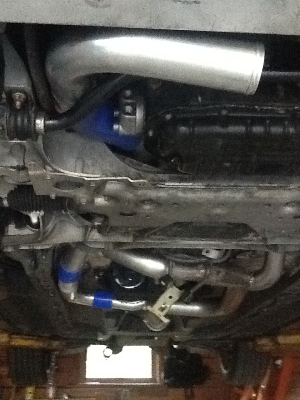

I finished more then half of the intercooler piping today. The oil filter relocation didn't give me as much clearance as I'd hoped, was like threading a needle but, I don't have to take off intercooler piping every time I change the oil
