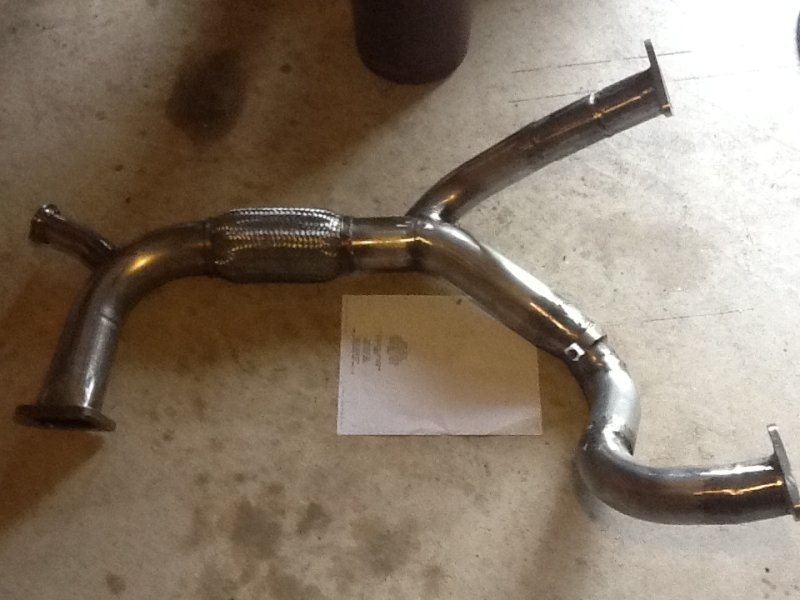

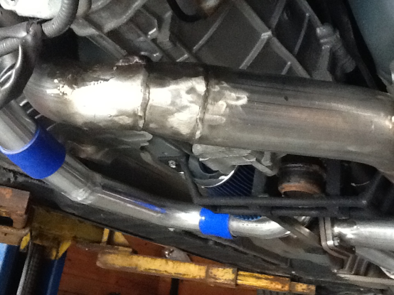

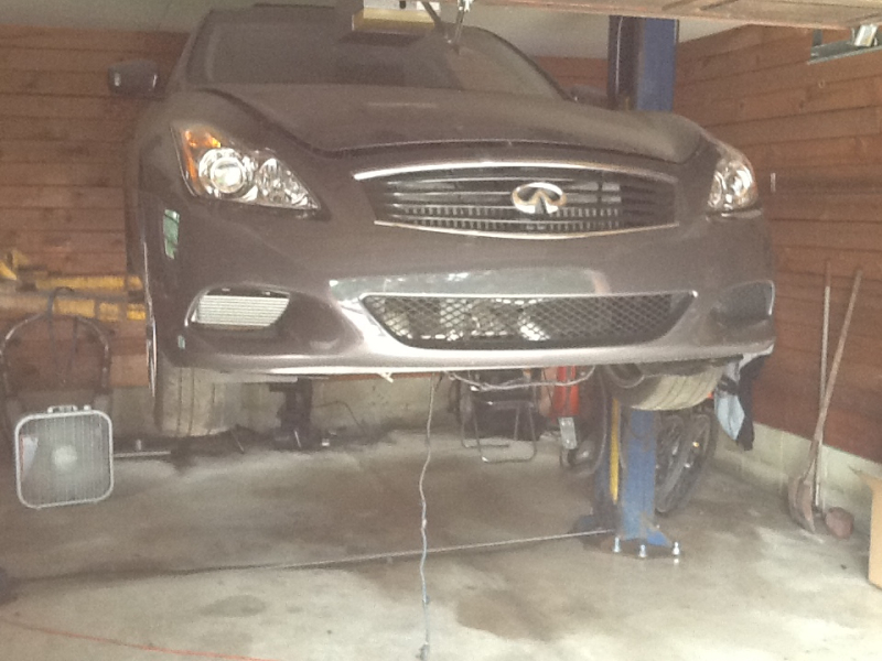

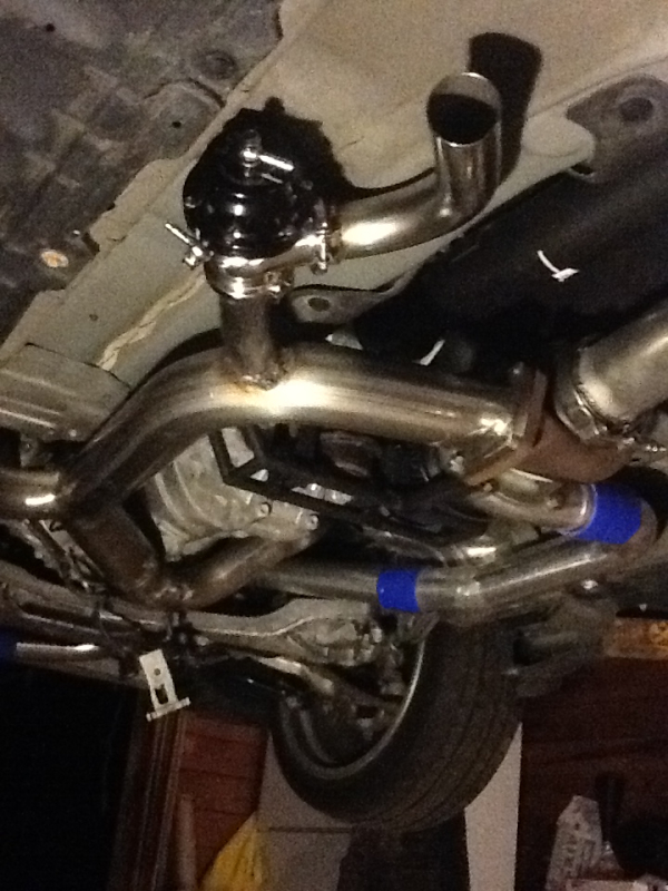

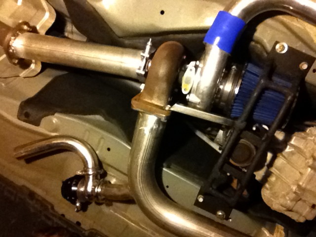

I mounted the Wastegate dumped but facing my exhaust so if I get annoyed I can send a straight pipe into the exhaust to reroute it.

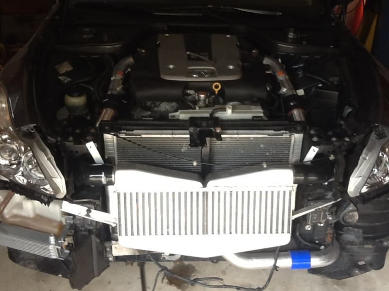

I only have about 3000$ in parts for this build. plus I bought a welder with aluminum spool gun for 500$ a lift for 400$ metal chop saw 100$ drill press 75$ and bench grinder/belt sander for 100$. so I have about 4000$ invested to have a bad *** car and garage. Can't go wrong.
Was gonna paint intercooler and oil cooler black for sleeper look but I kind of like them polished with the bumper on

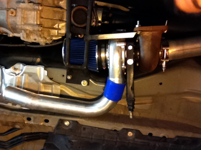

Made a simple version of oil drain system boosted performance uses.

You've got basketballs, I'll give you that! Props for hanging it out there.
That said, be careful with your weld grinding... you may be taking off too much of the penetrated zone and weakening the weld. Sometimes pretty ain't a good thing.

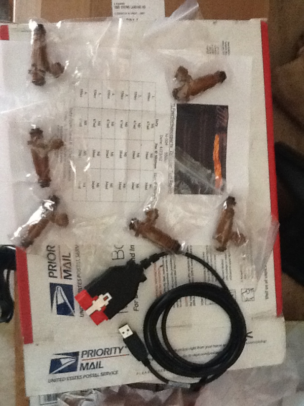

Included in the 3000$ in parts are 550cc drop in injectors and a osirus tuner cable.
my local tuning shop has a sale on aem wideband plus boost gauge for 200$
I got a basemap for 100$, and I'm going to street tune it from there. My local dyno charges 200$ an hour so if I get the tune pretty close I should be able to get a nice tune in an hour.
I hope to be under 4500$ said and done. Maybe I can use my new garage to make back some of this money back I just dumped into the g coupe.
