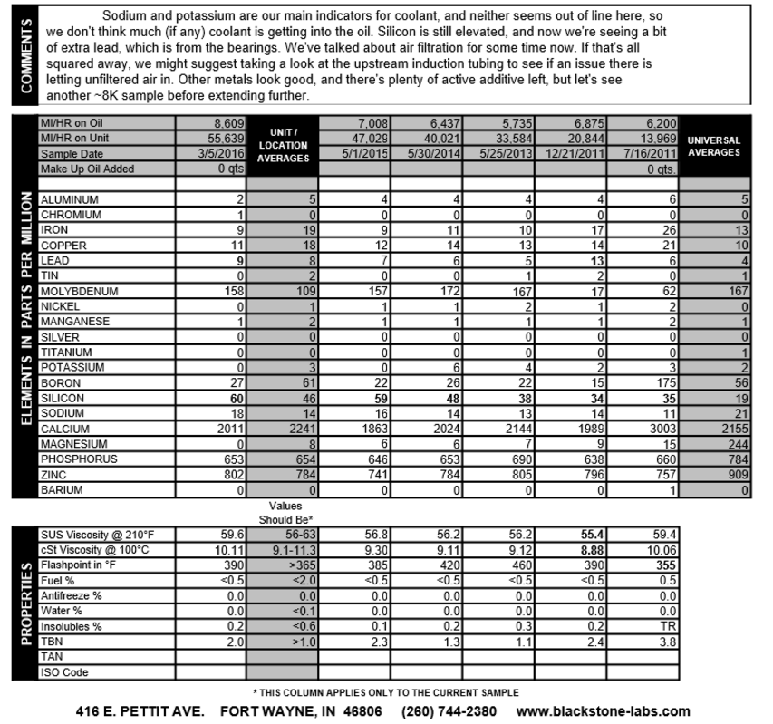

Hi everyone,
here's my contribution to the thread.
Oil's used starting from left to right
Eneos 5w30 Gf-5
Same ^
Eneos 5w30 Gf-4
Same ^
Same ^
Penzoil Ultra 5w30 (Gf-4 I belive)
I moved to Eneos because PU became unavailable at local walmarts. I tried Eneos and stuck with it ever since.
Since my 4th run, I was told to note of my silicon levels and to inspect my air filtration system (specifically the air filters). Wear levels has since been going in the wrong direction. I'm beginning to worry that there is a leak somewhere causing unfiltered air to get it. I supposed that this is starting to cause the bearings to wear (see increase in lead).
Does anyone know how I should begin addressing this issue? It's worth noting that I'm using k&n filters on and OEM intake with OEM accordian MAF tubes. I once swapped to tubes out for the HPS high flow smooth post MAF tubes (for less than 5k miles) a logn time ago and have revert to OEM.
Also, i discovered a small external coolant leak this past oil change and blackstone confirmed that it was not internal.

K&N filters are terrible at removing fine silicone particles (this has been studied before) - the best to keep your levels down is to use oiled paper and replace annually.
Thanks for your suggestion, it's definitely something I should be looking out for. I was thinking about doing a OCI run with different air filters. Could you possibly suggest a product?

Originally Posted by jujubii
Thanks for your suggestion, it was what I was looking for. I was thinking about doing a OCI run with different air filters. Could you possibly suggest a product?
Also, i keep on getting cut out in my last post. I mean to end it with "I ran the HPS high flow post MAF tubes for
Genuine Nissan/Infiniti filters are the only ones I know that are a proper oiled paper product. Every other filter I've seen is dry paper. The only exception being a few DENSO filters I've used, but those are not available for this model or are hard to find.
