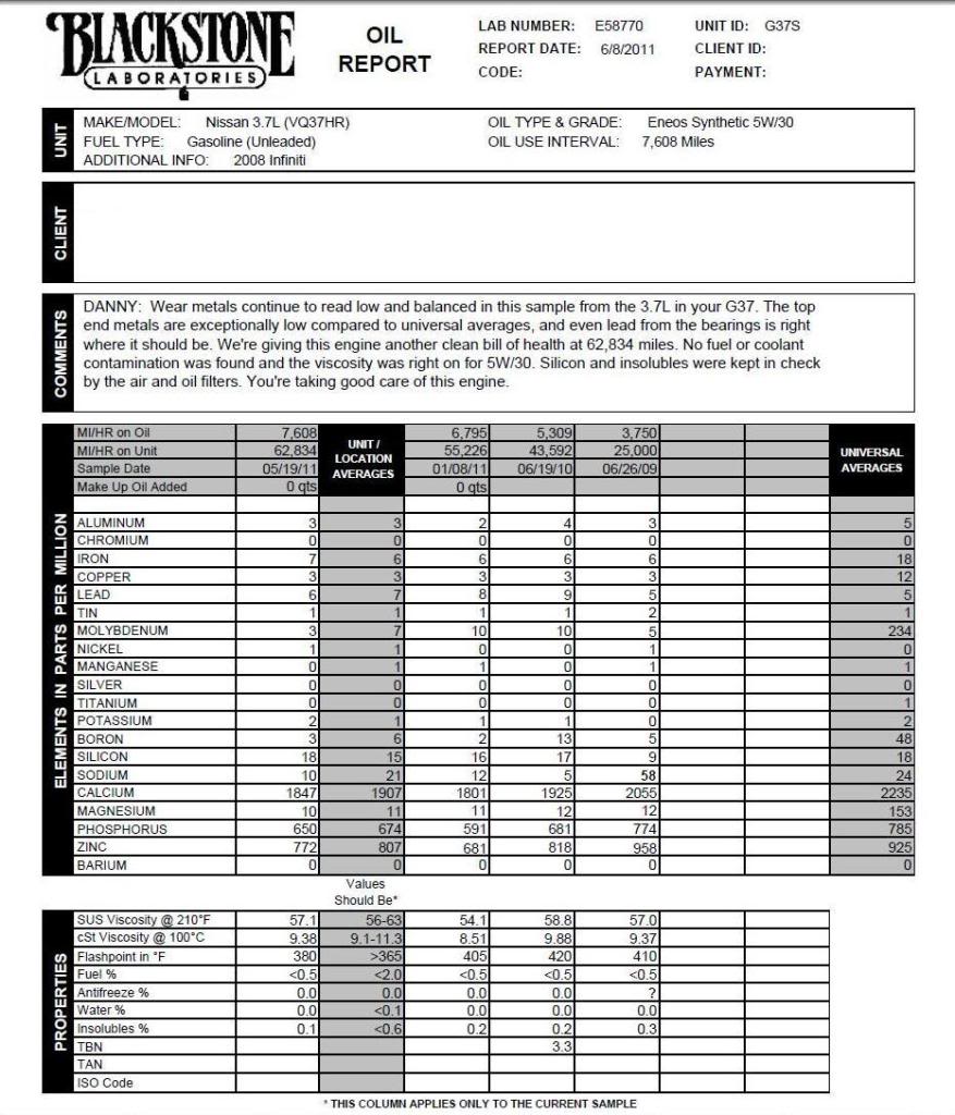

Good results with ENENOS on 7600mi interval change at 62000mi.

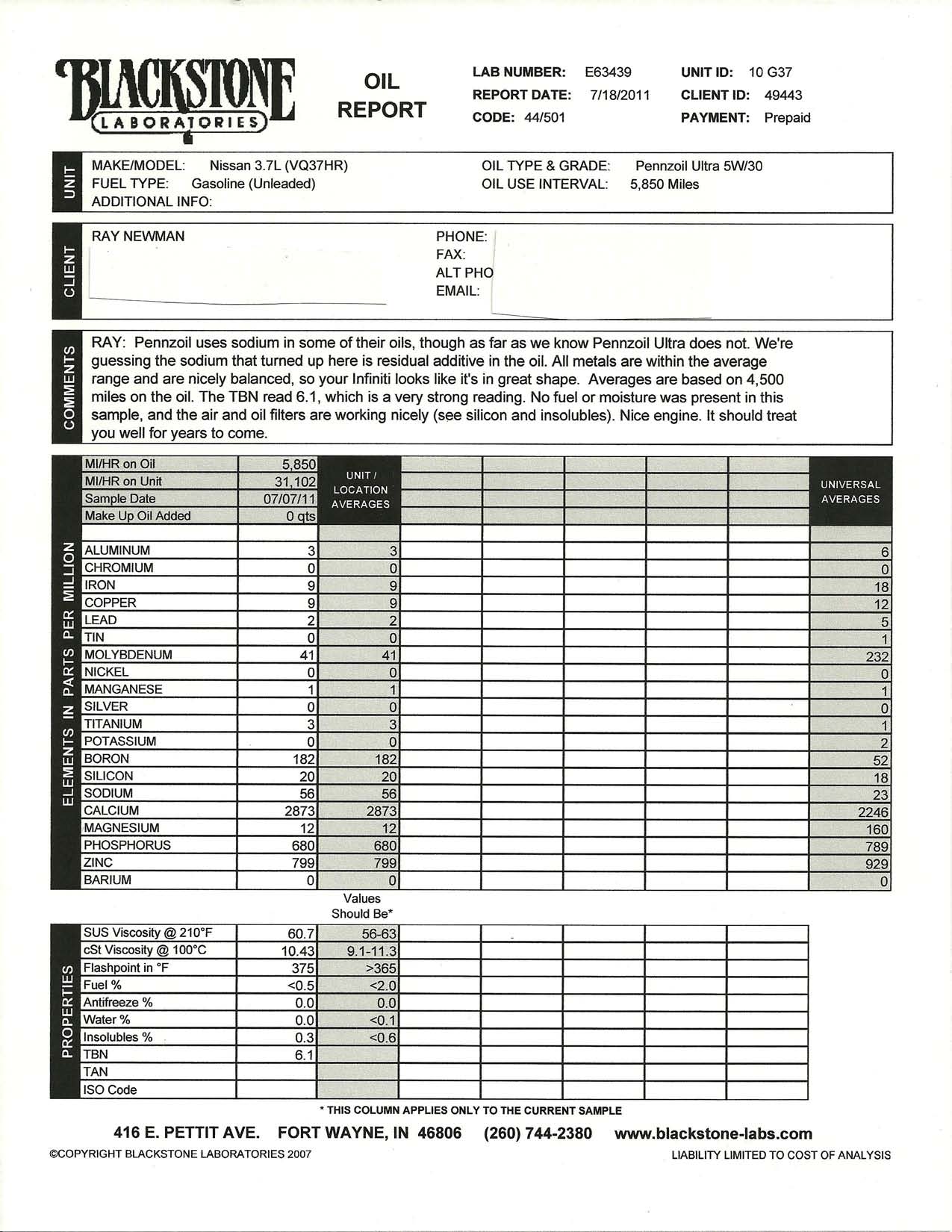

First Oil Analsysis on 2010 G Sedan - Pennzoil Ultra
Decided to give Blackstone a try. Wanted some reassurance on engine condition, and pushing my oil change interval to 6K miles, which is almost quarterly with my long work commute.
<O
</O
I picked up my 2010 G Sedan for a good price last Feb with about 20K miles on it. I've got 32K now already so it's broken in. I'm pretty certain it was a Hertz rental in former life, but you could never tell by the condition. I guess 1 year was not long enough for the joy riders who “drove it like they stole it” to dog it out. I live in the New Olreans area. Nice hot ambient temps. I drive somewhat aggressively, but my G can handle a lot more than I put on it.<O
></O
<O
></O
So I did my first change at 25K miles to get the Dino oil out. Put the PU in and ran for 5,850 miles before recent change and pulling sample. I used a Mobil 1 oil filter last time, and a K&N on my recent change. Air filters are stock Nissan.<O
></O
<O
> </O
Very happy with the results on my PU 5W30 oil. Metals low; TBN still surpisingly strong. The Infiniti stealership did the oil change before selling at 20K and that's probably where the residual sodium comes from. I read somewhere that they use Mobil Dino oil; and sure enough I checked a VOA and there’s plenty of sodium in the Mobil.<O
></O
<O
> </O
Maybe I’ll send another sample next year to see how clean the PU has my engine.<O
></O
<O
> </O
For all those critics out there who like to read oil threads and complain about oil threads… I already know. Your oil is great, and mine sucks. All API oil is the same. Oil analysis doesn’t matter… and (insert Charlie Brown noises here)<O

yo so at the end of the day what the best oil for our cars. i guess mobil 1 is out. too much sodium. my car needs a diet. which oils better for the car and boasts hp. pm me or post up. thanks.
Well, I'm a mechanical engineer, but not an auto expert. I've read and used many oil analysis reports in my day though. Mobil 1 is good oil, and I used it for years on my last car, but had no oil analysis done. Mobil 1 does not have any sodium to speak of, and sodium isn't really a concern, just something Blackstone picked up that didn't belong in the Pennzoil.
There are so many variables when choosing an oil. But for an average shlub like me, not racing, synthetic user, change oil at least 4 times per year, going over 5K between changes... When comparing used oil reports for our engines with similar total mileage Pennzoil Ultra and Pennzoil Platinum results are consistently looking good.....and better than Mobil 1 IMHO.
Then again, for guys who like to change their oil every 3K miles and often, the benefit from synthetic is questionable.
Nice report!
Since you have a long commute (24K miles a year), most of your driving is done on at highway speeds, right?
I've yet to see a G37 owner who puts a bunch of highway miles on a broken-in engine post anything but an excellent UOA.
Schedule 2 (highway only) says change the oil every 7500 miles. I bet you can find an oil + filter combination that will serve you well for 9-10K miles if you were interested in pushing it that far.

Probably all true. I'm only in stop n go traffic for about 25 - 30% of the time. Also getting 25 mpg overall, which is better than I expected. I'll stick within the Schedule 2 limits since the warranty is in effect. Not to mention - I love my G.
