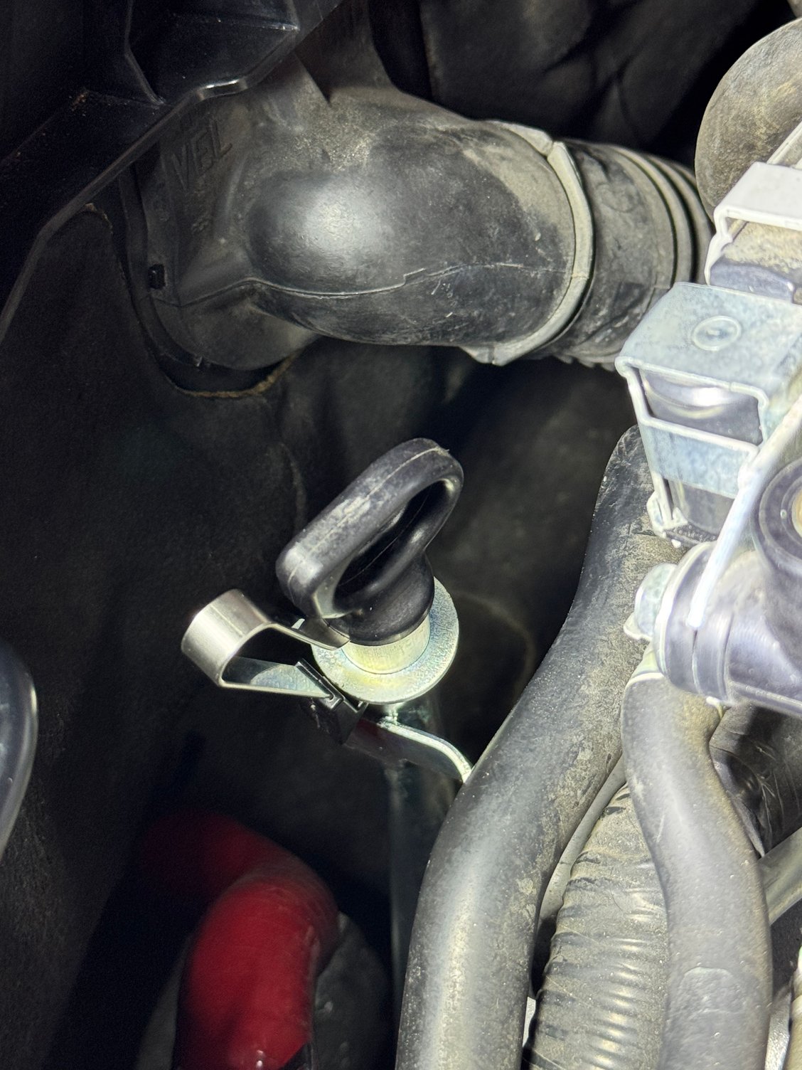

see those two little nubs that are 2/3 the way down the dipstick tube? My car had wires in the way that I didn't want to move, because they would lose slack in them, so i hacksawed those off and also sanded down the sawn edges. the bottom and top bolt were plenty to hold the tube in place.
and eyepro. a lot of crud came down as i was tetrising up the tube from below (much easier than trying to go down from above.
good luck and have fun!
