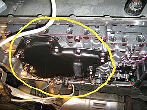

Exclamation Dropped the pan. Do I clean the inside of tranny too?
Do i have to clean the yellow circled area? I got alot of metalic shavings there
Attached Thumbnails G37 Automatic Transmission Fluid Change, Pan Drop/Clean-20171201_130511.jpg
Old Dec 1, 2017 | 05:47 PM
  #179
Victory's Avatar
Victory
Joined: Apr 2015
Posts: 1,062
Likes: 158
thats the filter housing. It's not user serviceable, so just leave it be
