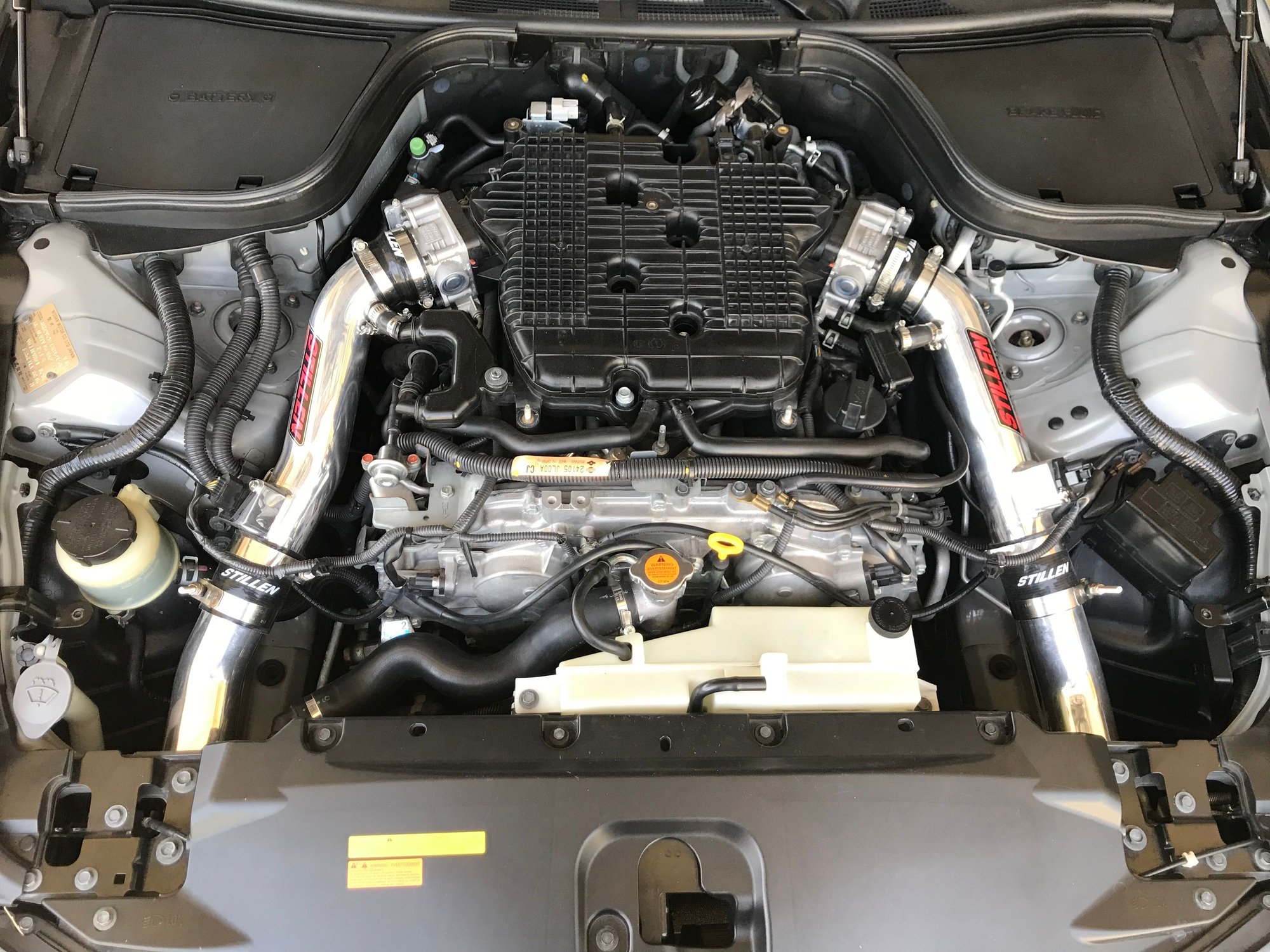

Originally Posted by RMB5190
^Perfect^
Awesome thanks again! Time to twist both wires together and crimp them to the 4 Guage lug and im all done! Thanks for all the help!
One more question. I noticed when I stripped the wire some of the copper went with the insulation. Is that normal?
Some copper got cut in the process even with an 8 Guage stranded wire stripper.

You're fine. Losing a couple strands along the way isn't going to do anything. Hell, I've taken mine off and re-applied about 3 times now. I lose a couple each time. Idea, (in theory) is to have whatever 'load' be equally distributed. You aren't really introducing any current, but rather, giving the signals more 'highways' to travel on so the signals are a bit quicker; and not as delayed. No way to confirm whether or not this works but some guys swear by it while others swear it's snake oil. Either way, for $30, no risk, and only benefits to gain....why not? I also think it's a good little mod to introduce yourself to the platform.
My personal experience, I applied a grounding kit within the first two weeks I had the car; the exact set-up that is in this DIY. I read about the stuttering/bucking, harsh shifts, delays, etc... guys were having and could count on one hand (twice?) where I noticed a odd shift in over a year.
Anyways, drove with the kit for 13 months. I took the kit off in February, 2018 on a Sunday when I installed my Strut bar....just because I wanted to see if it all was placebo. I didn't drive my car until Tuesday of the following week and I noticed immediately that the car was carrying on differently by the time I reached the end of my road. Mind you, this was at 4:30am on my way to work so my first thoughts weren't directed to the shifting characteristics of my car...Shifts were much harsher; 3-4 was brutally noticeable and 2-1 would lock the seat belt when coming to a stop...It wasn't just in traffic either. 'Easy' stops were jarring and highway accelerations were noticeably delayed when stomping the throttle. It got to the point I couldn't handle leaving it in 'D' and took over in 'Manual' mode. Didn't seem to help, as the delays in downshift/upshift and actual gear change were severely disconnected. For example, I'd downshift from 2-1 and you could count a solid 'One Mississippi' before the RPMS would jump to signal I was in 1st.
I reinstalled the kit a week ago and haven't noticed a harsh/odd characteristic since. Shifts seem to have smoothed out and stopping and accelerating are more predictable. I'm not saying it's DCT quick, but when I stomp the throttle it acts like a normal automatic vs me questioning if I actually stepped on the throttle or not before it drops 2 gears, hangs for a second as it decides the best choice, chooses (chooses wrong), and then we're moving....

Just did this DIY and I thought it was just overhyped. But the difference was incredible! The audio and shifting improvements were amazing!
Wish I did this DIY a long time ago. Thanks again for this guide and all the members who helped!

So just got done with this 2 weeks ago, fairly easy job to be honest. Well, since I have a 6mt, I wasn’t able to see any improvement with the shifting as so many of the 7at drivers claim. I went ahead and skipped connecting a wire to the negative terminal on the battery (didn’t want to risk bypassing any of sensor or what not) but everything else I connected the same. Not sure if this is my imagination, but music seems a bit louder now. Who knows, maybe it’s just me.

So I just installed my own grounding kit. Followed the instructions OP posted and found, sadly, not much had changed. I noticed shifts were a tiny bit quicker, however that whine from the speakers still remains. I decided, hey, it only seems to whine when I have the throttle applied, so maybe it's my tb signals! Just grounded my tb's twenty minutes ago and the whine is still there. Maybe theres something I did wrong?
I need to point out that I broke one of the bolts that had a ground already on it on the passenger side, so I was forced to run those wires off the bolt for the ps fluid reservoir. Not sure if that's a killer, but I checked for continuity from my battery all the way to the other side of the car with those cables and everything comes up green.
Any guidance would be awesome!

Whine in audio? I’d search through the audio forum for advice especially if you have aftermarket components introducing noise.
