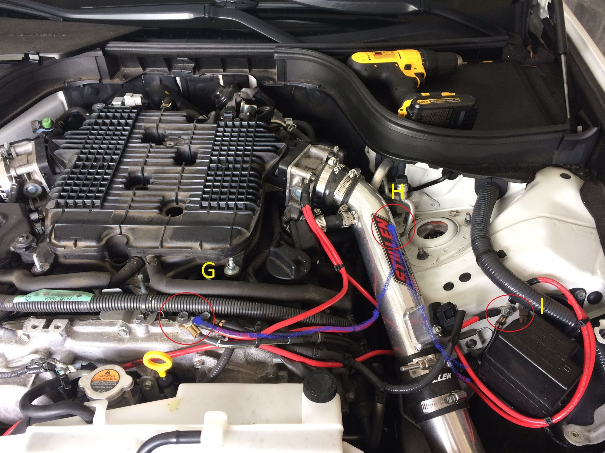

Sorry this took so long!!
My apologies on getting this up everyone. Here is the way the kit is supposed to be set up. All points are circled and labeled. Blue 'mist' is there to show you how it is ran. I've added some additional connection to my TB and plan to re-do everything this winter in order to clean it up a bit. I'll make a new DIY if one hasn't been posted by then. If anyone has any questions in reference to the pics below - please don't hesitate to ask.
**Not a word on how dirty my bay is**
Connections A-B-C
Closer of pic of Connection C
Connection C leading to Connection D
Location of connection D
Singe wire. Connections E-F
Connections G-H-I
Closeup of Connection H

How does your kit differ from the one in the sticky? Getting ready to build my setup and would rather include the TB grounding like yours. Just curious on the additional lengths and connections that are needed.
Old Sep 11, 2017 | 11:29 AM
  #200
RMB5190's Avatar
RMB5190
Joined: Dec 2016
Posts: 3,105
Likes: 504
For mine, I just included the TBs. Basically the only difference. I'm going to re-do mine this winter so I'll post a full walk through with everything you'll need in the next 2-3 months.

Where did you all buy your Copper wires? Also does it matter what color it is?
Old Feb 23, 2018 | 10:03 AM
  #208
RMB5190's Avatar
RMB5190
Joined: Dec 2016
Posts: 3,105
Likes: 504
https://www.genuinedealz.com/
No, you can get whatever colored sleeve you desire.
Old Feb 23, 2018 | 02:00 PM
  #209
Dan G37's Avatar
Dan G37
Joined: Jul 2017
Posts: 207
Awesome thank you!
So get something like this http://www.genuinedealz.com/8-awg-ga...ck-by-the-foot
And I should be good to go?
Old Feb 23, 2018 | 02:57 PM
  #210
RMB5190's Avatar
RMB5190
Joined: Dec 2016
Posts: 3,105
Likes: 504
Yup! 16/17 Ft. was more than enough for me when I incorporated the throttle bodies. 13 ft. when I didn't.
Just make sure you get the correct gauged connectors with 5/16 IDs
