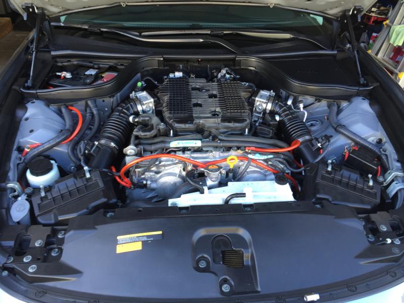

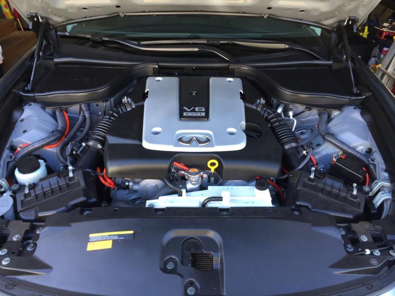

Got my grounding kit added today. Test drive show better paddle shifter response. Thanks AZg37 I followed your DIY to get this done.
Attached Thumbnails Grounding kits made simple, step by step guide to making your own!-bolt00-362108-albums-garage-my-bolt-6850-picture-grounding-kit-2-23647.jpg   Grounding kits made simple, step by step guide to making your own!-bolt00-362108-albums-garage-my-bolt-6850-picture-grounding-kit-1-23646.jpg
