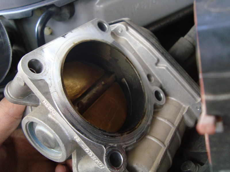

Once you have removed your intake, you can see the TB and the butterfly valve inside (golden). You shouldn't see much dirt yet, as most of it loads up behind the valve. To take off the TB, you'll need to remove four hex bolts as shown below with a 5mm allen key. use the star configuration when removing and installing these bolts. They will be tight since they have thread lock applied to them.
