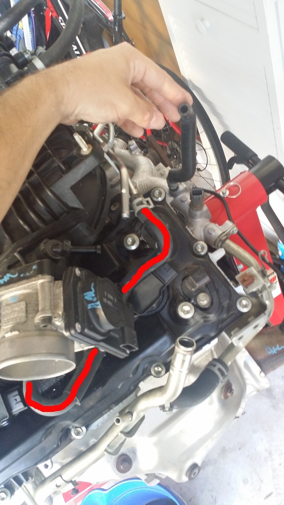

First thing you'll want to do is remove your intake tubes.
Next completely remove the lines in red on the passenger side connecting to the throttle body.

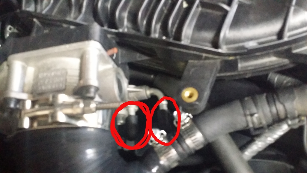

Add caps to the connectors on the throttle body and on the tubes the lines connected to.

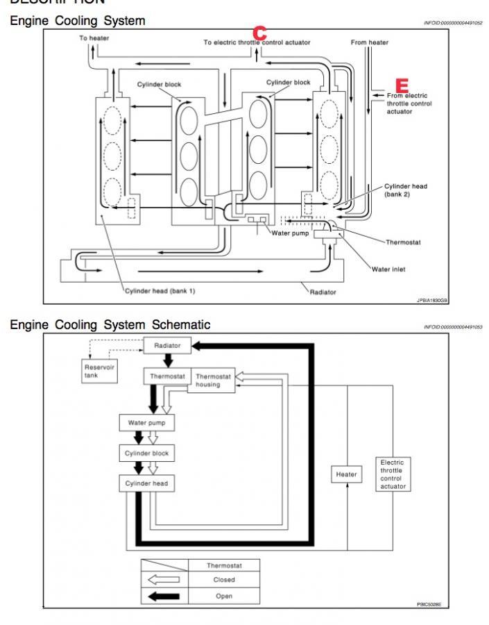

Connect coolant line C by spinning the bottom of the hose around and facing it towards the coolant hose on E after removing it from the throttle body. Use a connector such as the one pictured below.

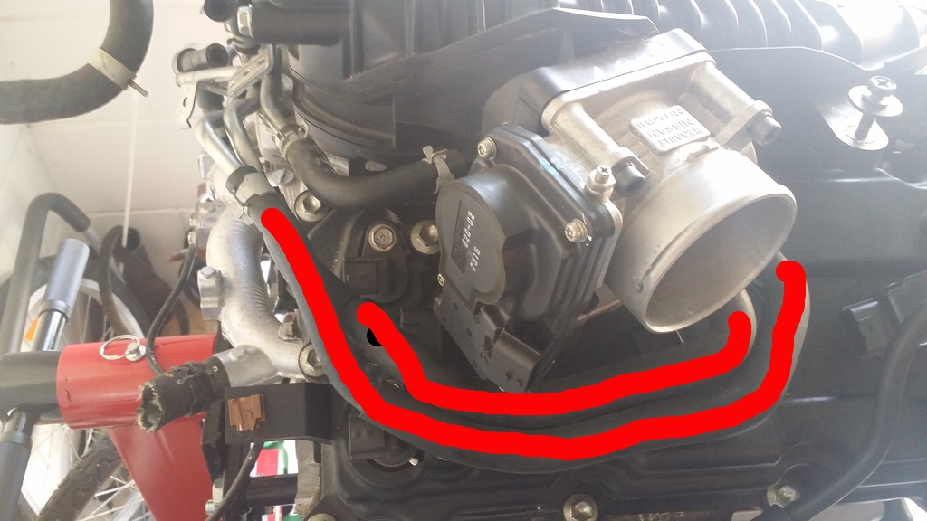

Completely remove the line in red and cap the throttle body and line it connected to.

The barb fitting is not needed. As you can see on the images, the feed for these is coming out of the "Hot" side of the coolant neck goes to throttle and goes back in the cold side.
The system has this this way so coolant can circulate and not stay stagnant, this is not a crucial part of the cooling system and can perform without it.
Two caps with a hose clamp will achieve the same result with a cleaner look.
