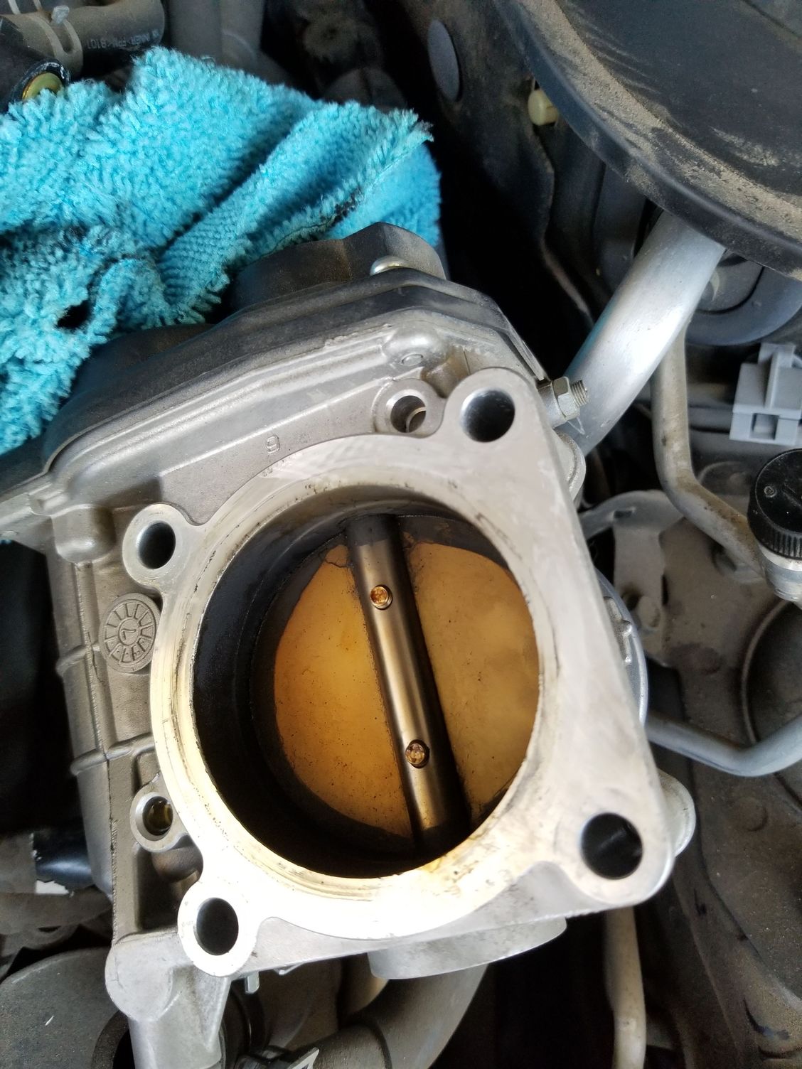

Wow. Worse than I thought. Moved butterflies a tiny bit. Car idles better and throttle response is smoother. No longer have to floor it to pick up nominal speed. Very happy man. No codes. Didnt go crazy with cleaner only sprayed on towel and q tips and wiped. Also wiped inside plenum as best I could. No codes no weird issues.
Thanks! Glad you wrote this and not me. This should be re-written to include this from the start. Once I read this from the top of this page and heard that there was surging I knew it was due to air leaks. I am a launch manager for a company that makes intake manifolds for Honda. Their manifolds and TB are the same. Nylon manifolds with heat inserted nuts, same gaskets, and drive by wire TB. I can't stress enough that the proper torque sequence be applied or you will strip the inserts and it will leak or gasket will "bunch" at the 4th bolt and leak. If you take the gasket out (or knock it out with a rag or whatever) you MUST put it back in with the tongue (witness tab) first and sliding two fingers around to install the rest of the gasket at the same time. If not that tongue may cause a leak due to improper install. It happens at our leak test every time we get someone new installs them without this method. As for "touching/moving" the butterfly valve, it make no difference, go ahead and move it just don't disconnect the TB or the learned home position must be relearned by the ECU - in all cars. I have seen people in my mechanic days use a rag with straggling bits or terry cloth to clean and leave chunks of the rag in between the TB and valve and it cause high idle also.

Pulled mine apart yesterday, didn't disconnect the battery. The throttle bodies themselves were quite dirty, as I believe its the first time its ever been cleaned(2011 63.5K miles) I cleaned everything up nice, put it all back together, no CEL. car seems to be idling and shifter smoother
I just cleaned my TB’s and MAF sensors and now my Service Engine Soon light is on. I disconnected the battery sprayed the MAF’s let them dry and plugged them back in then took TB’s off (only disconnecting the one hose on each air tube) cleaned them good and bolted them back on and reconnected everything. Started it up it stayed around 2k for a couple seconds them came down to 1k I dove it about 10 min and idle bounced around between 900-1500 when I would press clutch in and/or stop. I turned it off then back on and SES light came on. It idles right around 650 when I start it but still around 900 when I drive it and press clutch in when slowing to a stop. What went wrong? I only have 41k miles TB’s were a little dirty but now I wish I didn’t mess with them never knew they would be so sensitive. Any suggestions? Thanks.

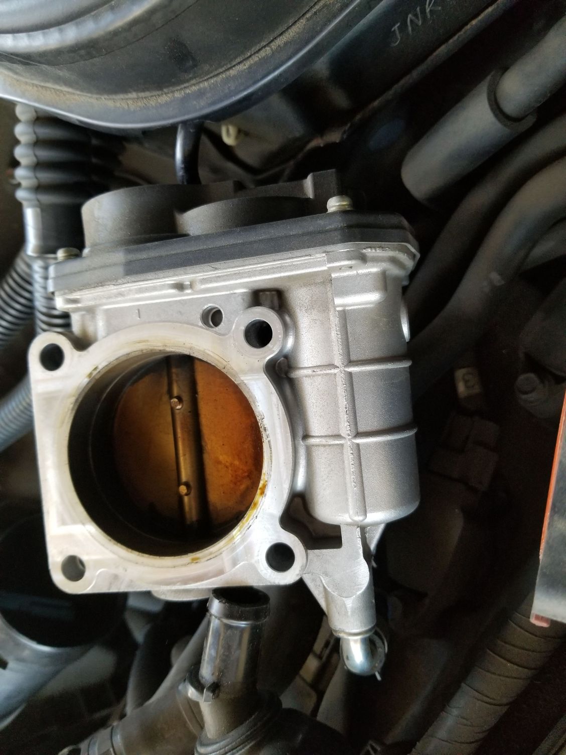

My car was idling rough at times so I went ahead and popped off both TBs and they looked pretty damn bad. From the looks of it, it's never been cleaned. Had extra TB cleaner and cleaned it. Didn't feel the need to disconnect the battery and I moved the butterfly valve carefully. I sprayed TB cleaner onto a rag and cleaned it. I heard spraying it directly onto the TB could damage them. Did the whole 3 step relearning process and now she runs SMOOOOOOTH. Looks like I'm going to be doing this every so often.
Did this today. Did NOT disconnect batteries. Did NOT disconnect wiring to TB. Removed hose, removed TB and cleaned both sides. Opened up butterfly to thoroughly clean. Also sprayed rag and wiped down intake area. Did NOT spray inside of it though. Put back together and started car. Started right up, idled high for about 2 mins, then dropped right where its supposed to be. No check engine light. What a difference. Car has 67k on it. Prob never been done. Seems like more power w/o hesitation. Throttle seems less sticky or hesitant. Couldnt be happier.....
