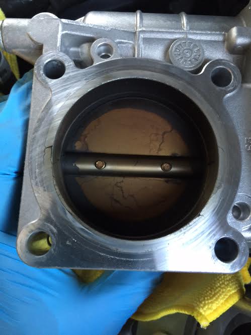

Been meaning to tackle this job for awhile. I am running the Stillen Gen 3 intakes on my 2010 sedan. Going to replace those filters soon. Ordered a pair of AEM replacements (Yeah, K&N filters too... would just rather swap out instead of clean the originals). If I can do this and not have any issues afterwards, anyone else can. The only issue really, is removing those hex bolts from the throttle bodies. The two lower ones on each side are a pain in the BUTT. Tight space, very difficult to get leverage, but I improvised and managed, somehow. Putting everything back together was much easier.
But it was all worth it. Went out on the highway and damn. Must have regained 10hp. (half kidding, kinda)
Attached is the before of the driver's side. The passenger's side was a little worse. And the lip of the plenum? Wow. That's where I got most of the gunk off with a rag sprayed with TB cleaner. I used the Valvoline heavy duty since it was on sale recently for $3-4.

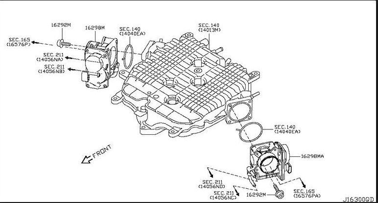

Replacement hex screws.
I tried to do this but stripped one of the screws. I want to replace the screws with new ones. Anyone know what screws they are. Any info helps.
Thanks!
Old Sep 1, 2015 | 01:18 AM
  #262
Gio37's Avatar
Gio37
Posts: 1,397
Likes: 245
From: Happiest Place on Earth
Thanks!
16292M
$1.13 EA
LINK
