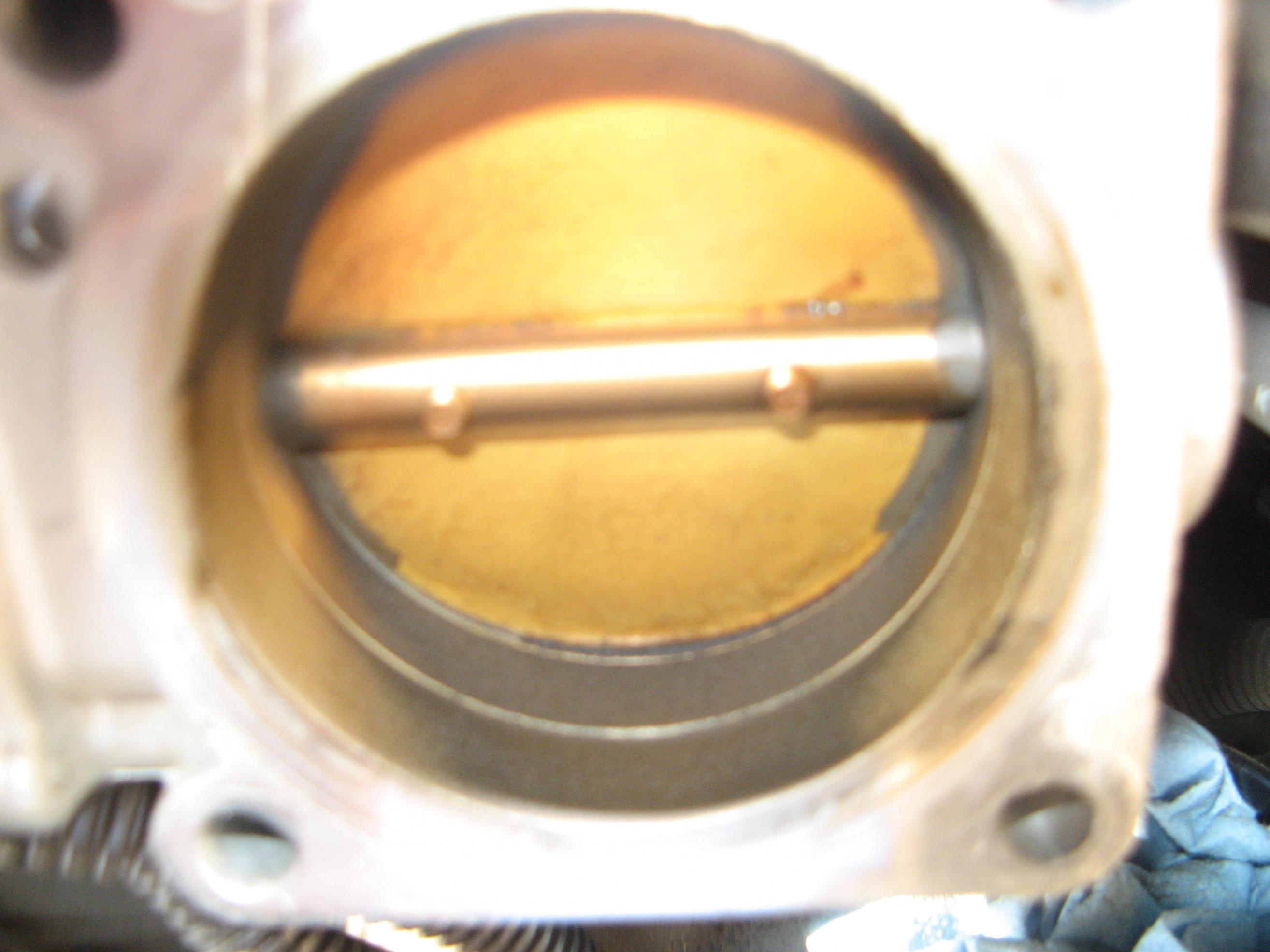

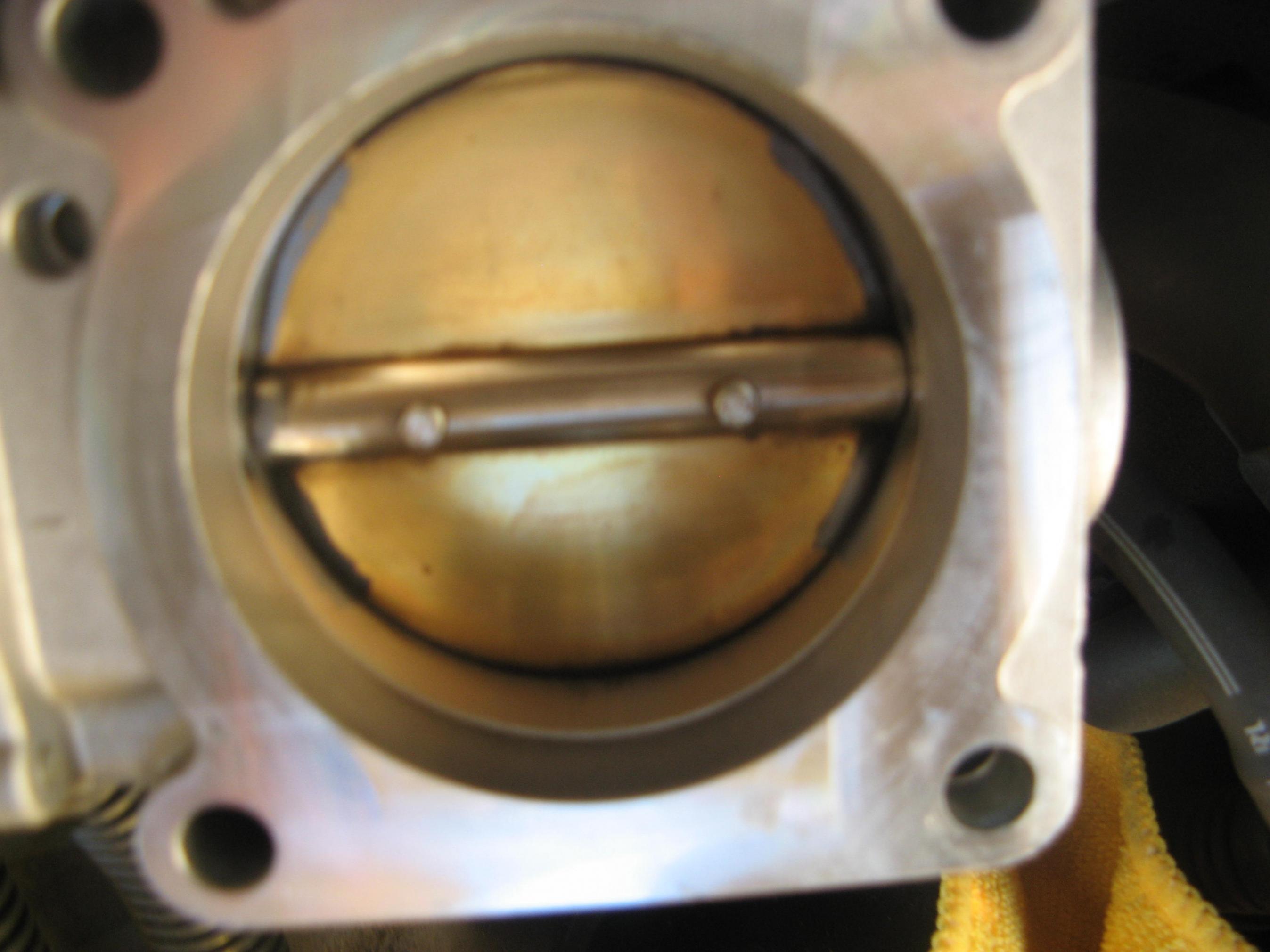

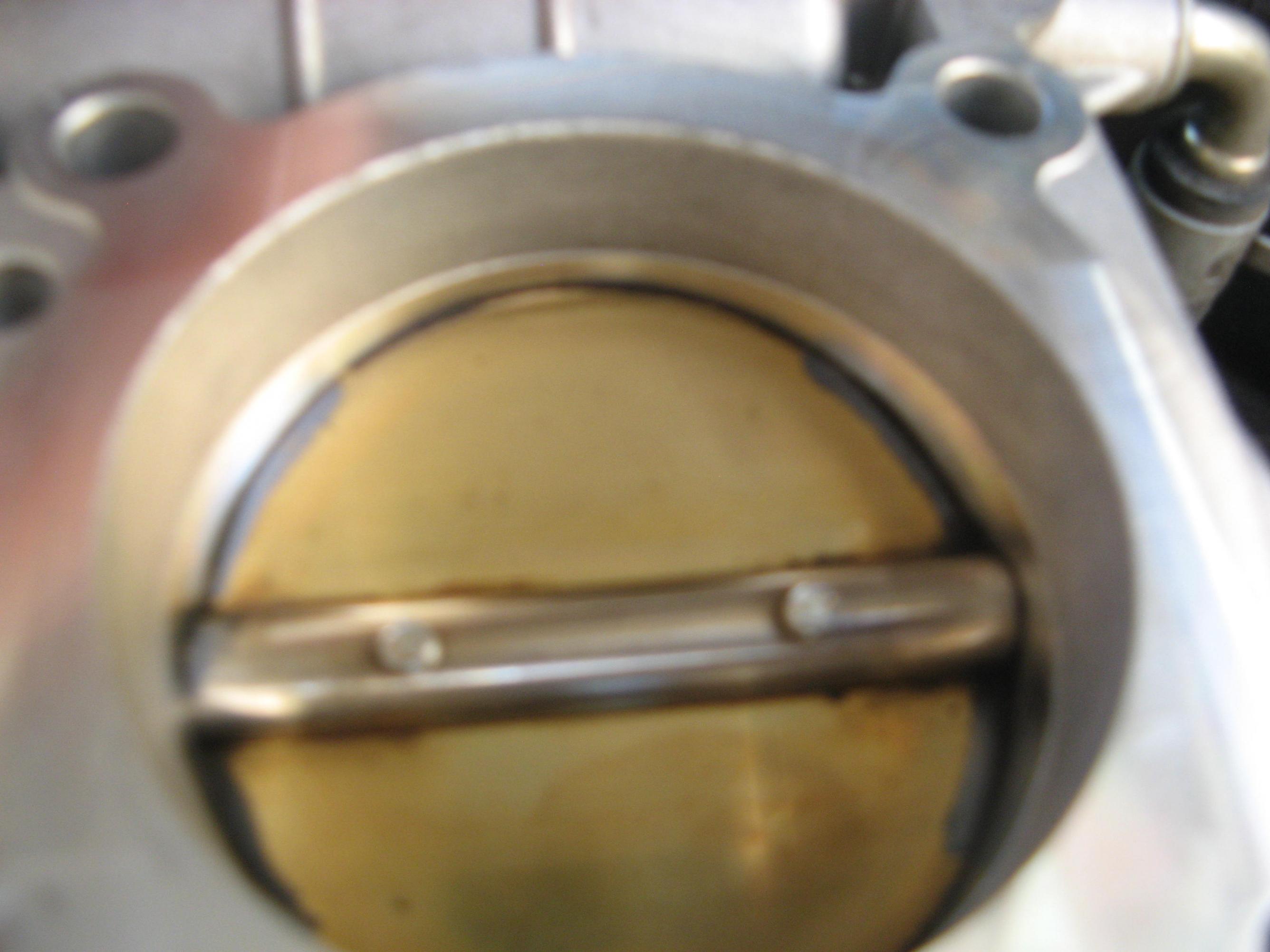

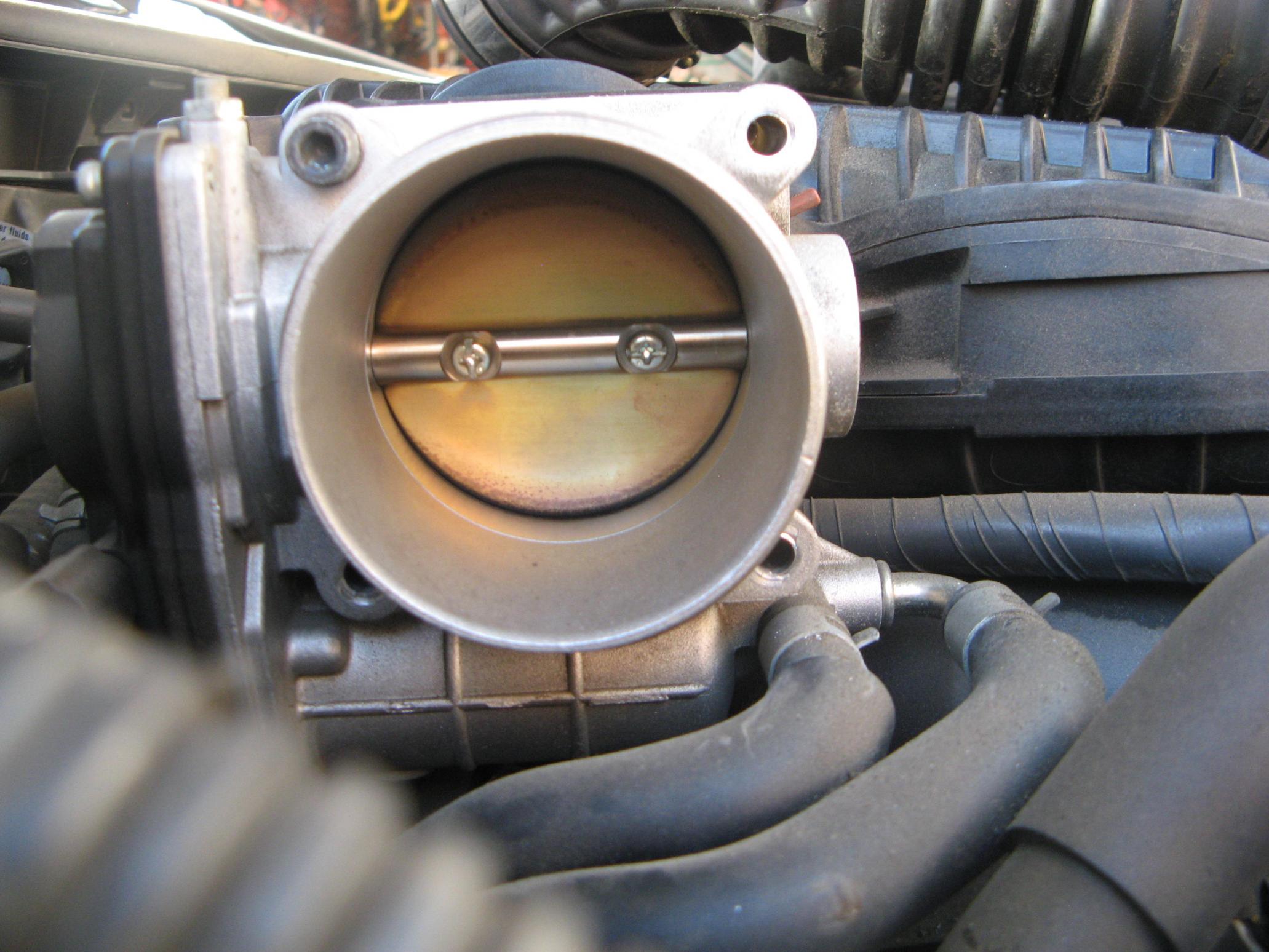

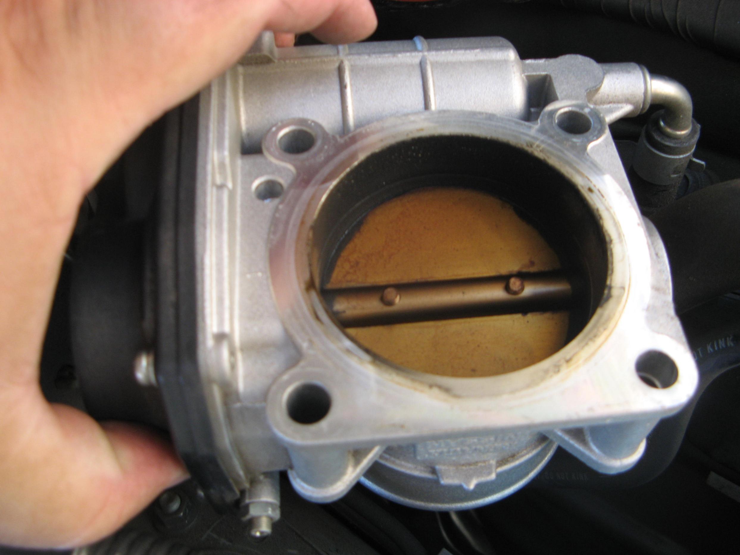

Just did my 08 with 51,981 miles on it and boy what a difference
It started to pulsate at idle real hard.
And now its smoother and better power also wasn't that hard to clean.
Hear are some before and after pictures.
Passenger side before and after.
Attached Thumbnails Clean your Throttle Bodies-img_1084.jpg   Clean your Throttle Bodies-img_1085.jpg   Clean your Throttle Bodies-img_1088.jpg   Clean your Throttle Bodies-img_1090.jpg   Clean your Throttle Bodies-img_1091.jpg

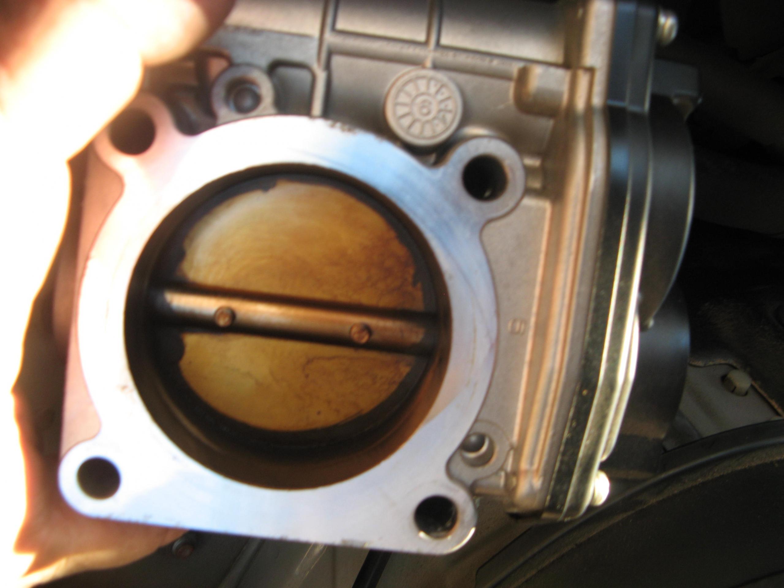

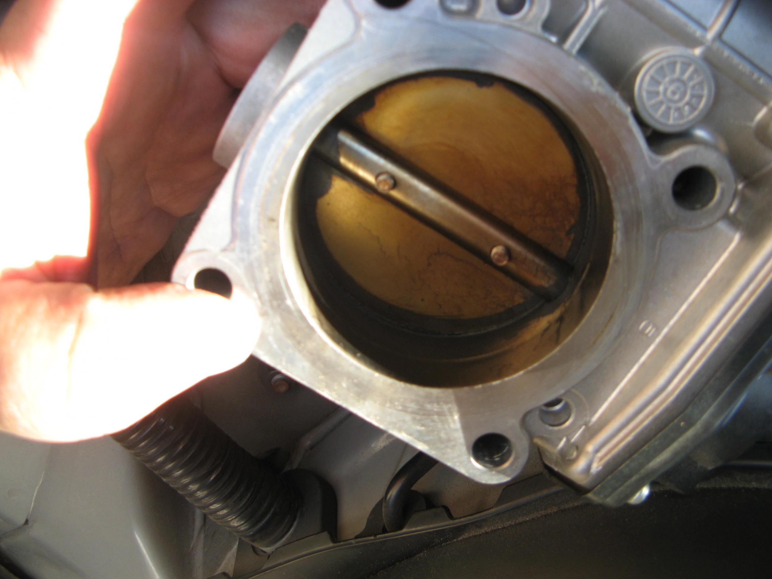

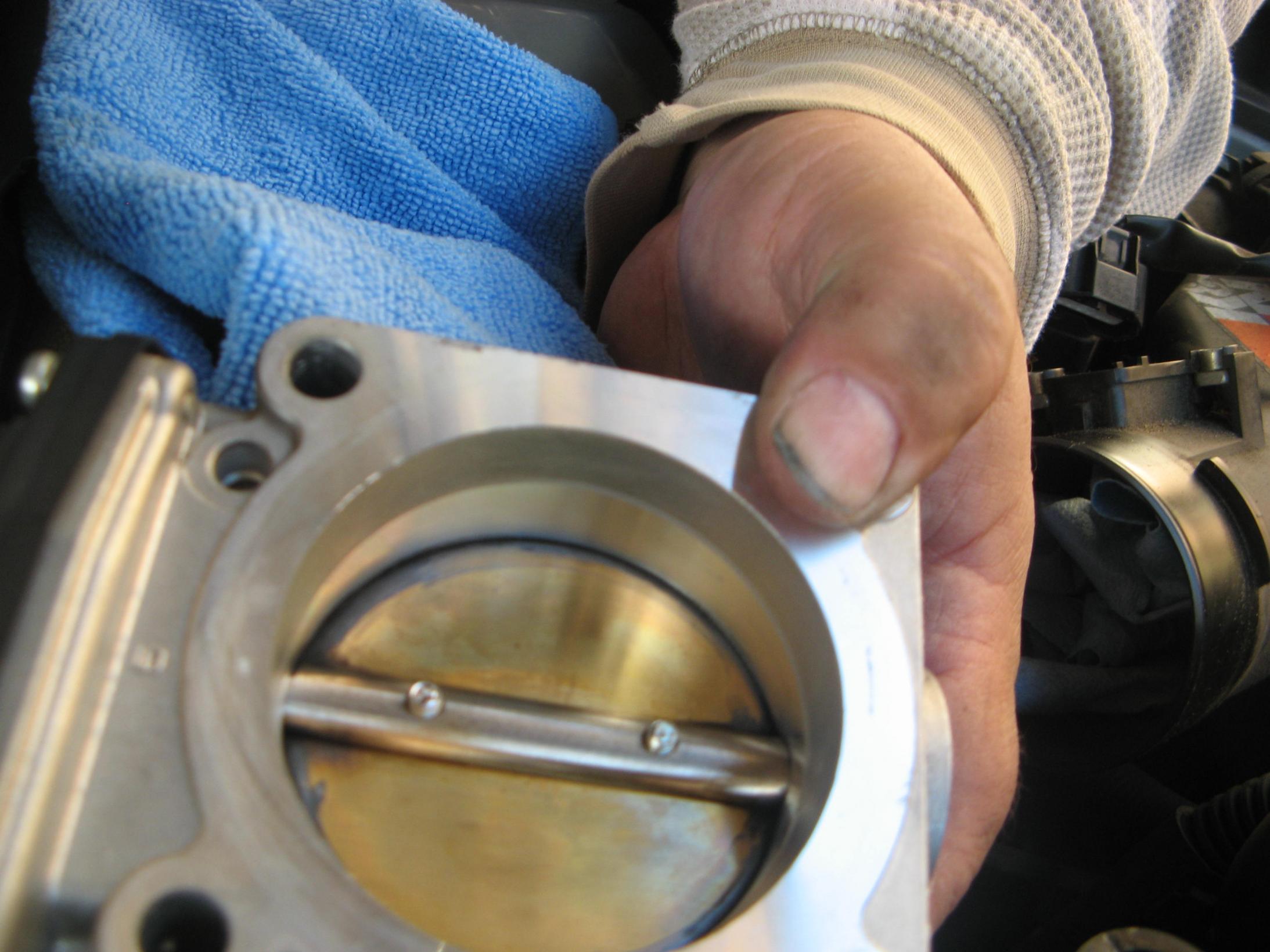

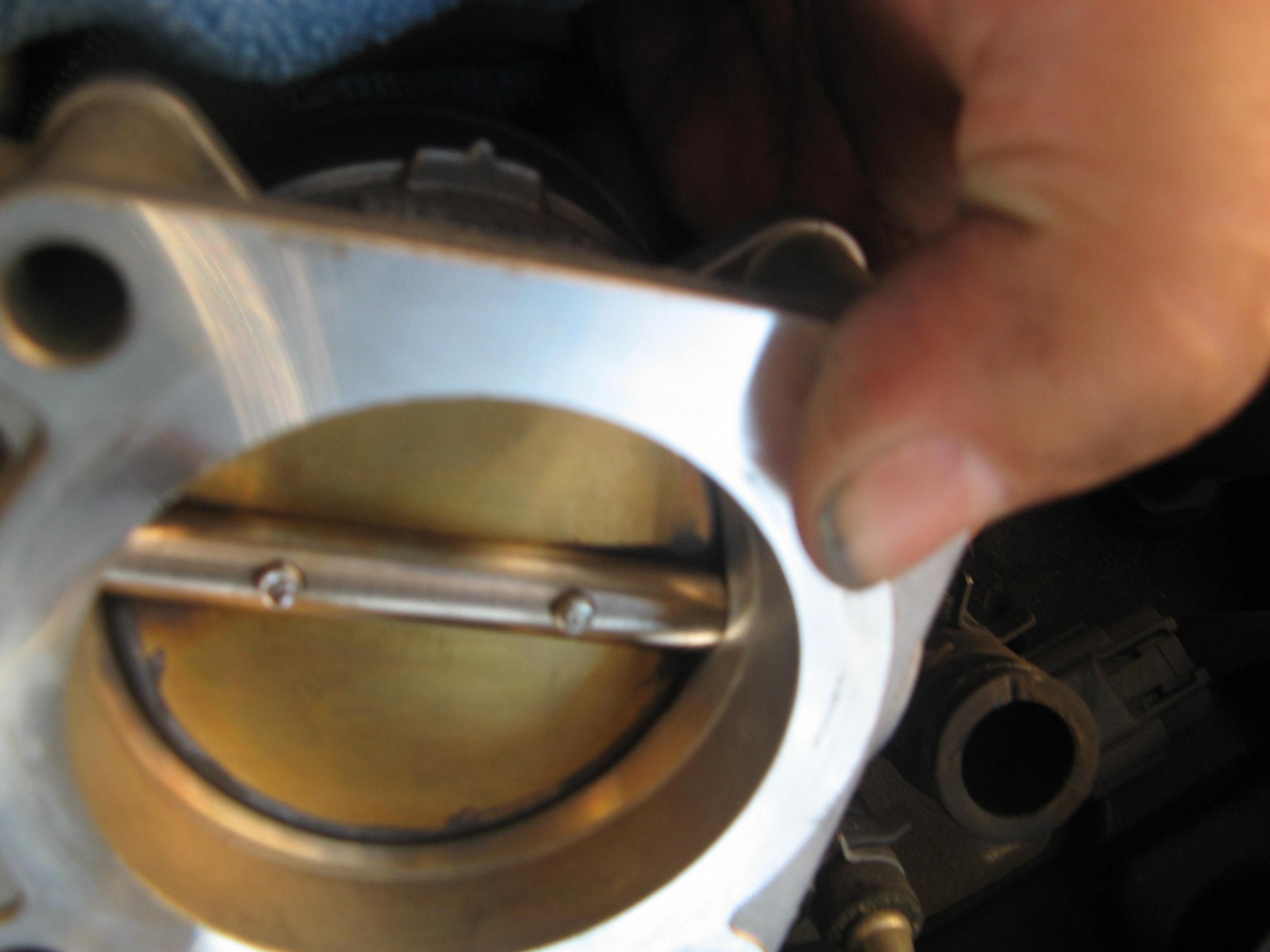

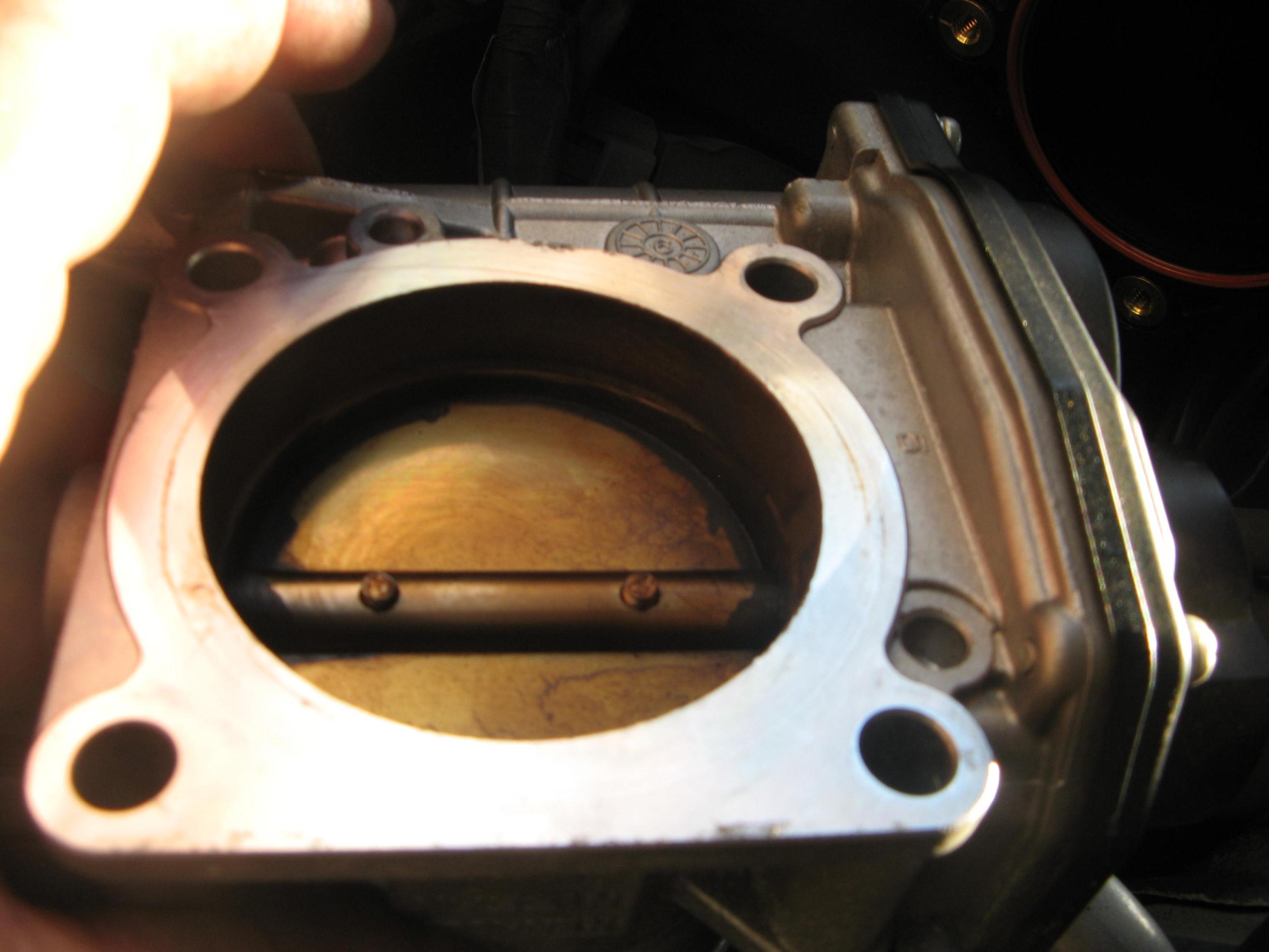

And here on the driver side before and after.
Attached Thumbnails Clean your Throttle Bodies-img_1096.jpg   Clean your Throttle Bodies-img_1097.jpg   Clean your Throttle Bodies-img_1098.jpg   Clean your Throttle Bodies-img_1100.jpg   Clean your Throttle Bodies-img_1101.jpg
