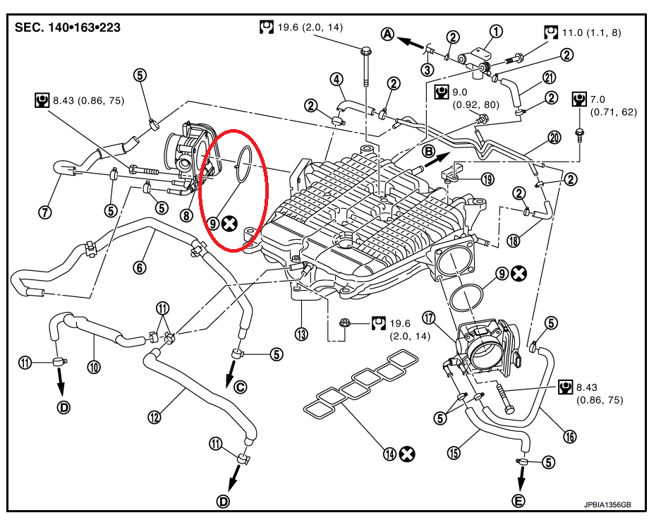

Originally Posted by Jsolo
^^What shape were your orings in? Or did you replace them?
I didnt replace the o ring after the process. I just took a microfiber and cleaned out the inside manifold and the o rings.. That was about it! Was I suppose to replace the o rings?!
Old Apr 2, 2016 | 06:27 PM
  #280
JSolo's Avatar
JSolo
Just say no!!!!!
iTrader: (14)
Joined: Oct 2011
Posts: 6,103
Likes: 593
From: People's Republic of IL
If they're still sealing then no. But I imagine after 6 years they'd be somewhat deformed. FSM suggests replacement any time it's removed.
The oring is there to provide an air tight seal between the two surfaces. After time, heat cycles, etc, the oring deforms and may not seal properly.
Btw, torque on those bolts is 75 in lb (6.25 ft lb).
