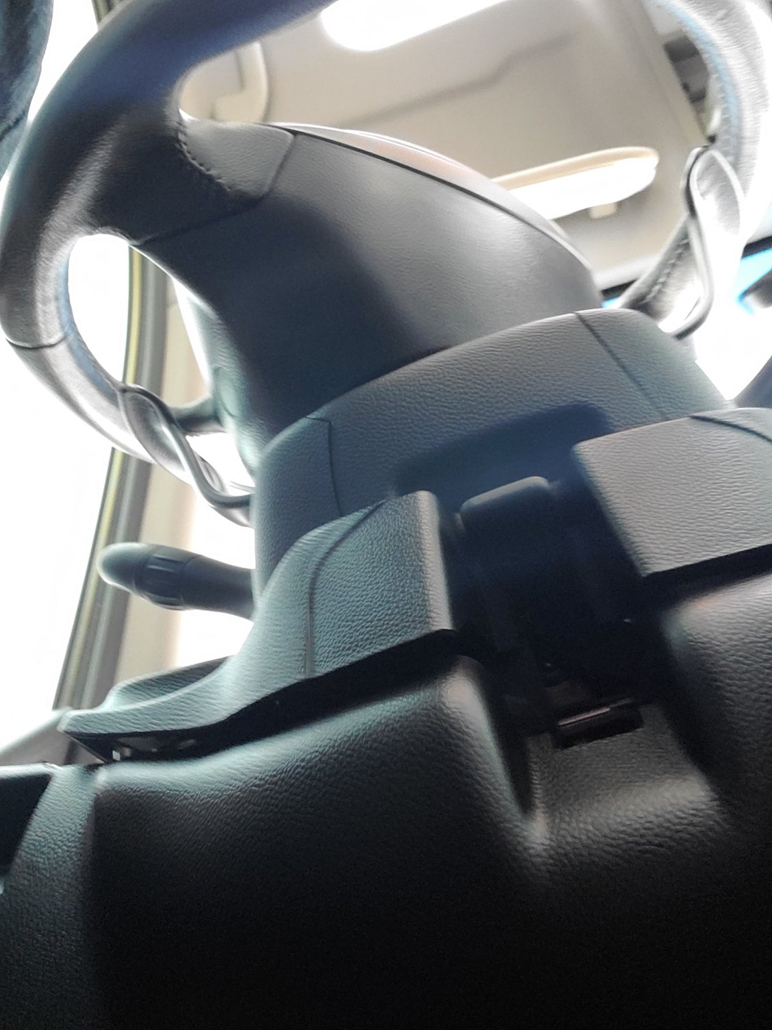

Installed paddle shifters.
I was on the fence about spending money to do this but a member had a pristine set so I jumped on it.
Unfortunately finding the correct steering column shroud proved to be quite a project.
Ultimately, after trying fruitlessly to determine which part number was correct and after the dealer shipping me 4 separate units to try, Austin Infiniti ended up ordering it from Japan.
They were amazing to work with. They could not determine the correct part number either so they shipped me a handful free of charge to try.
The problem is finding the unit, in black, that has the mechanical adjustment and the paddle slots.
The part numbering is vague on Infiniti sites.
Ive got spare shrouds I should list on the classifieds.
If you need help identifying the proper shroud for this application see link below.
For my Q40, Black Interior, Mechanical Tilt, w/ Paddle Shifter Holes
the part number is 48470-JK60A
https://www.myg37.com/forums/g37-sed...ml#post4295703

Waiting patiently to see what you do next lol. Thank you again for the shroud part number I ordered it and just waiting for it to arrive from god knows where.
