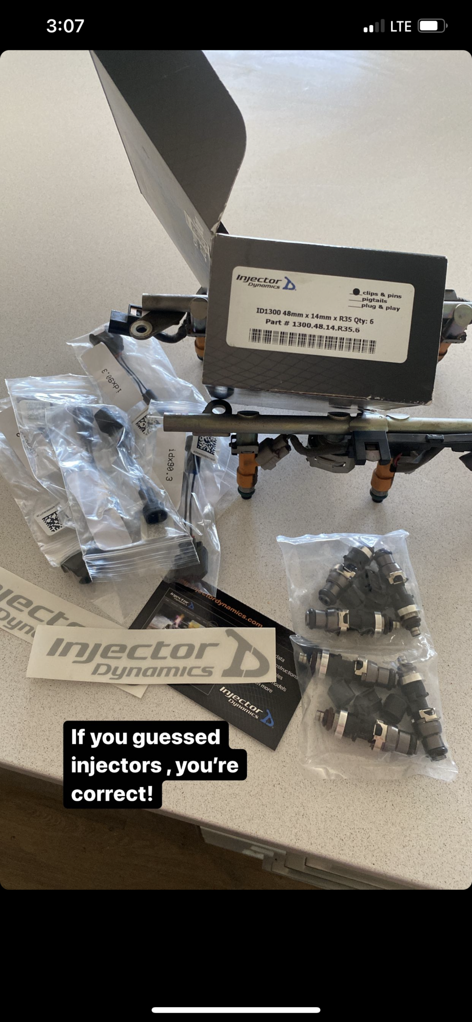

Injectors: ID 1300CC injectors (with ID injector adapters)

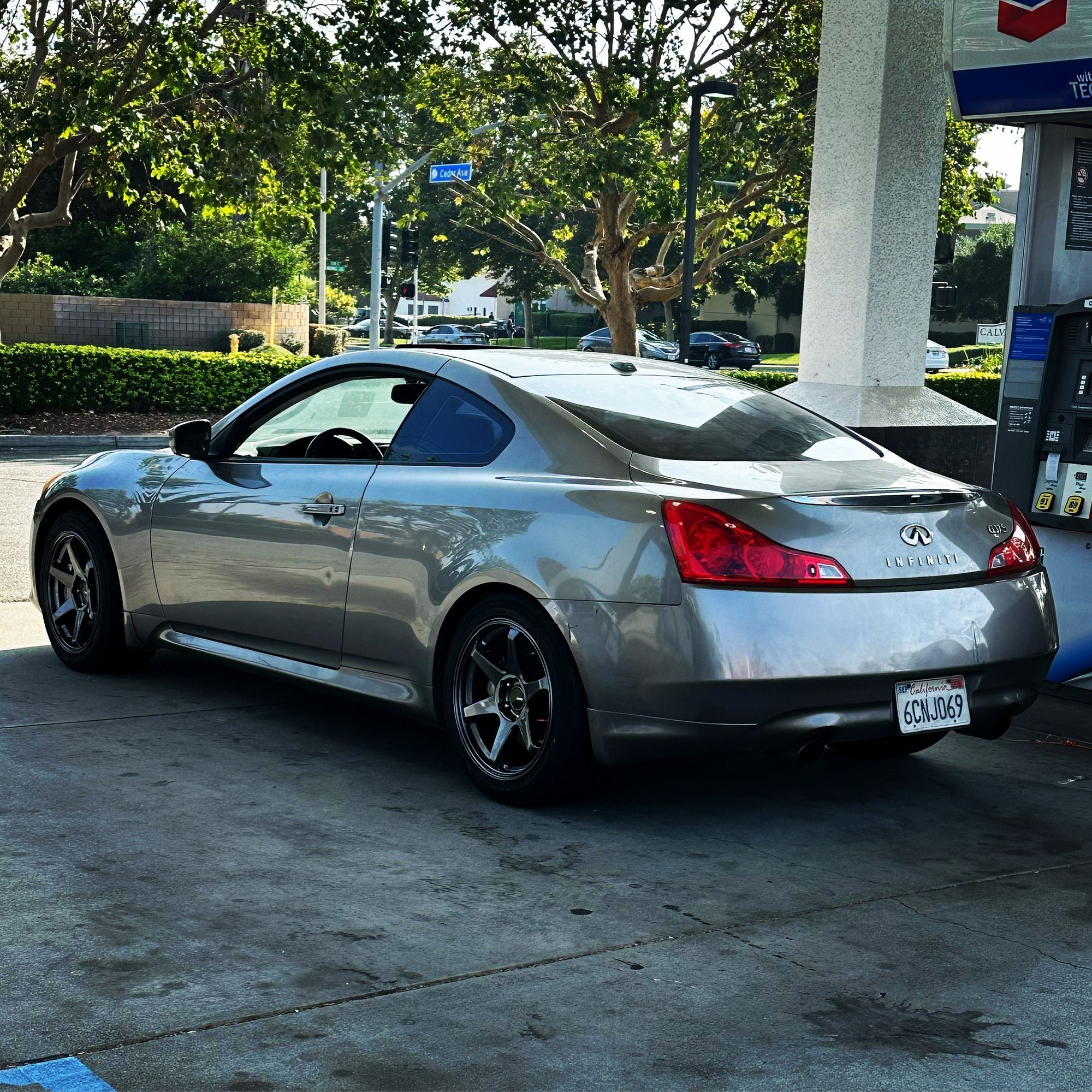

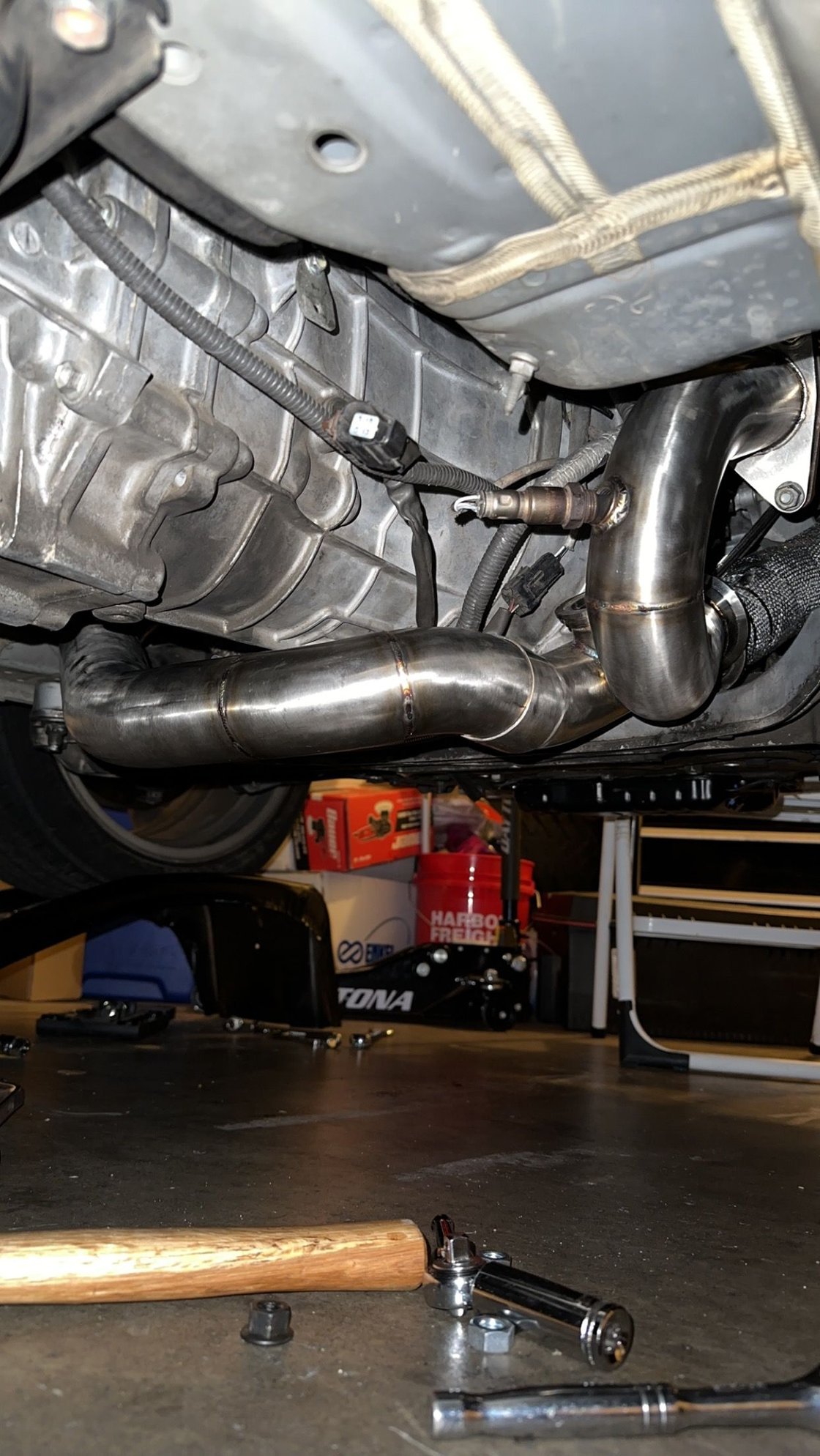

Long time no see lol.... sleeper build back on track ... learned so much in past two years lol
GTR NGK spark plugs - installed
Deatschwerks Fuel pump hard wiring kit - installed
Innovative psb-1 AFR/BOOST guage - installed

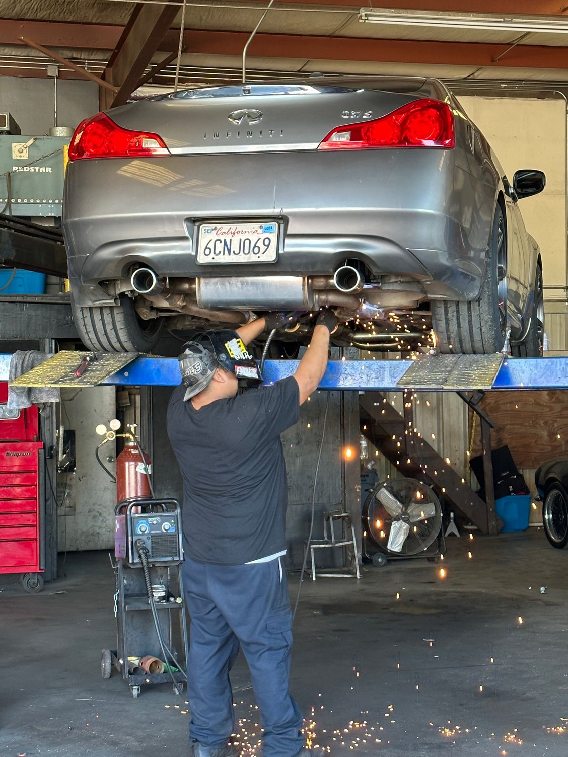

Stillen Exhaust (off of 350Z) - installed

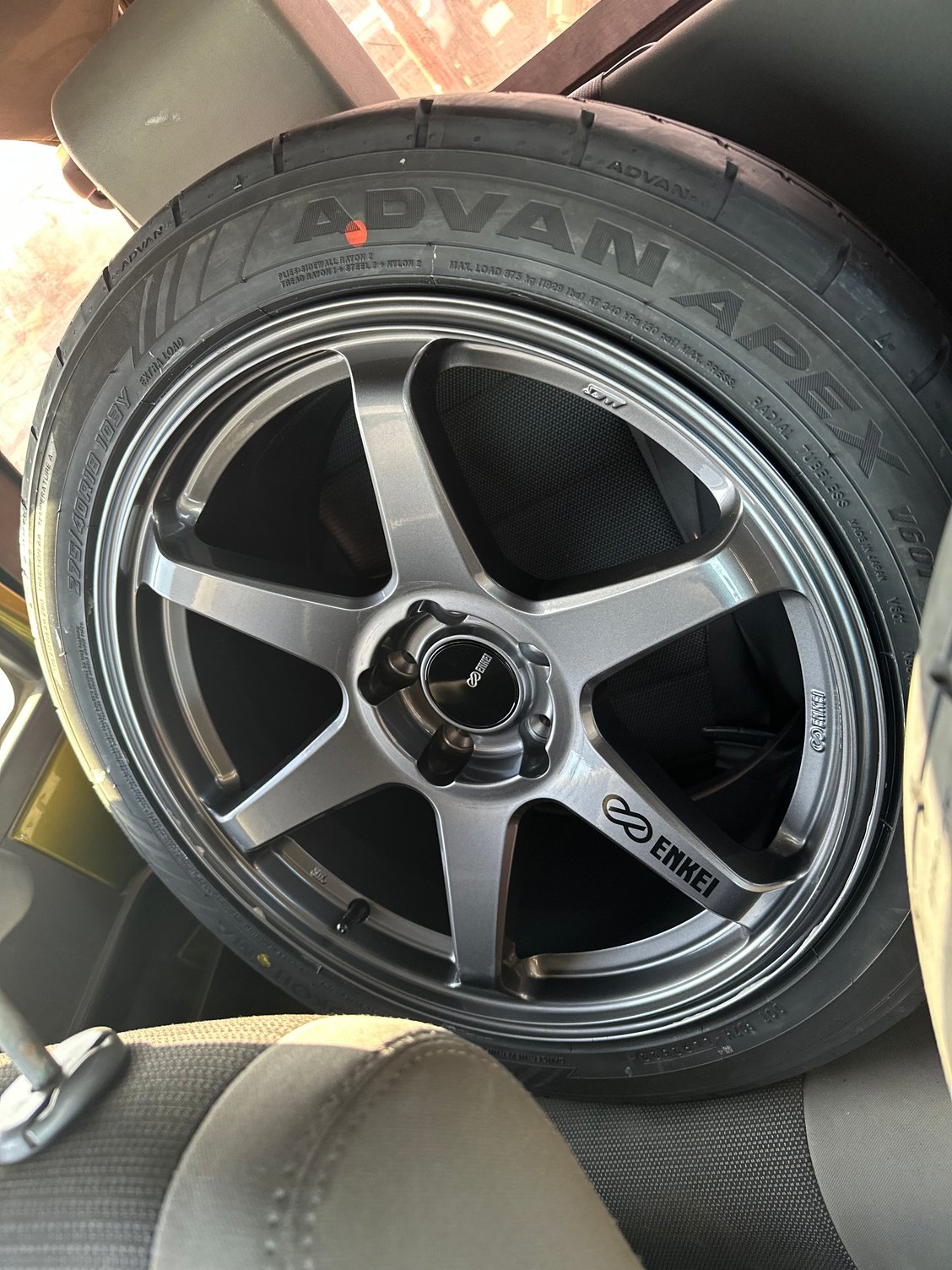

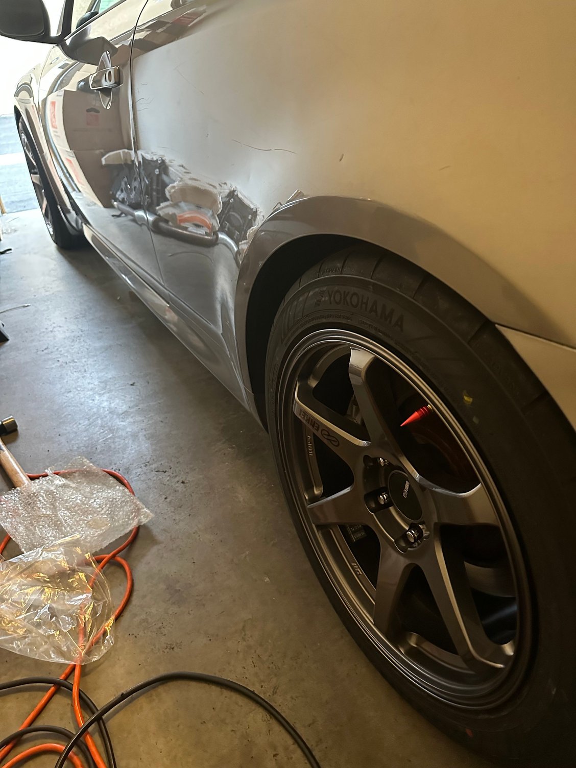

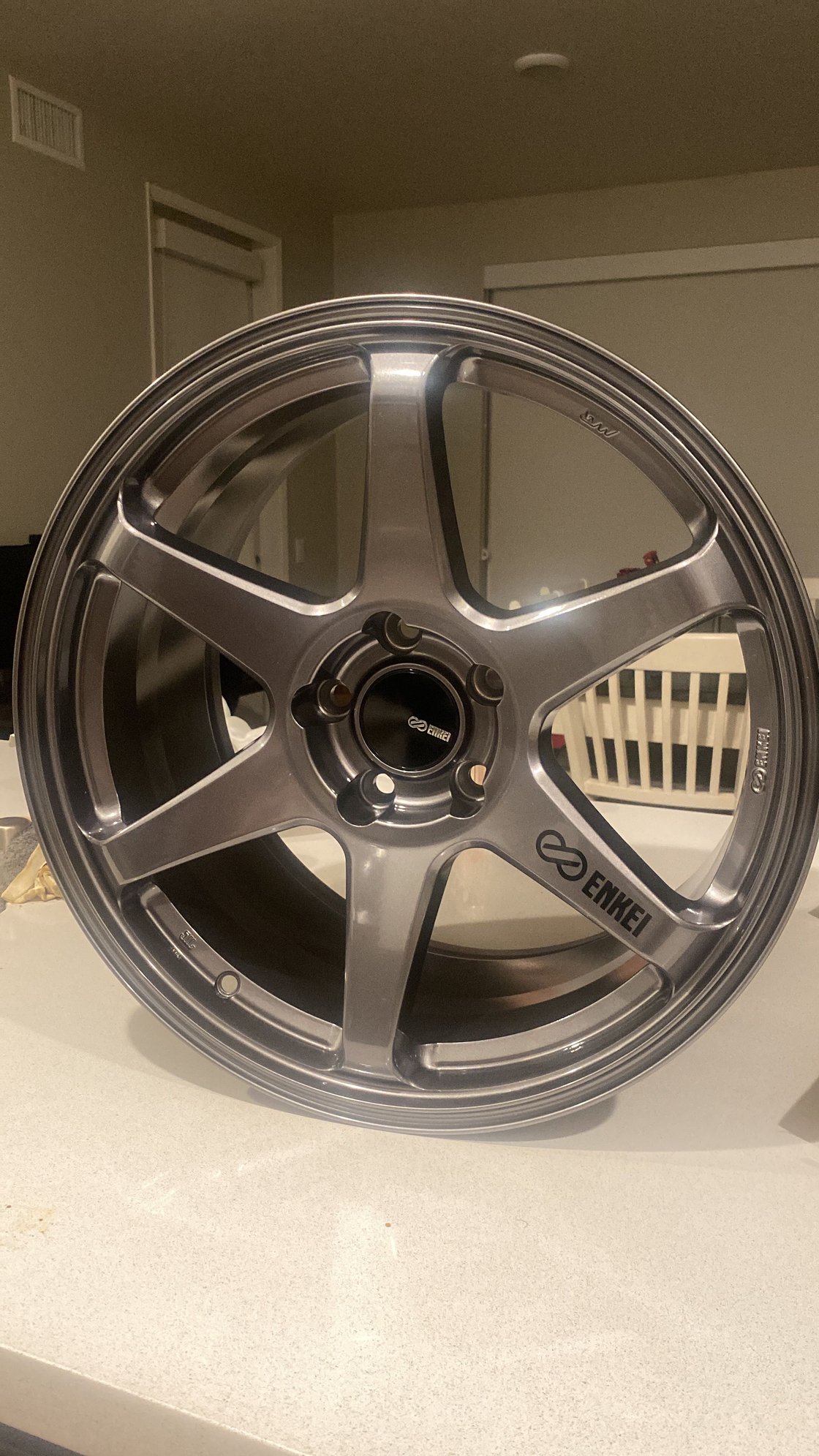

Enkei T6R 18 inch wheels with yokahama advan 285's - installed

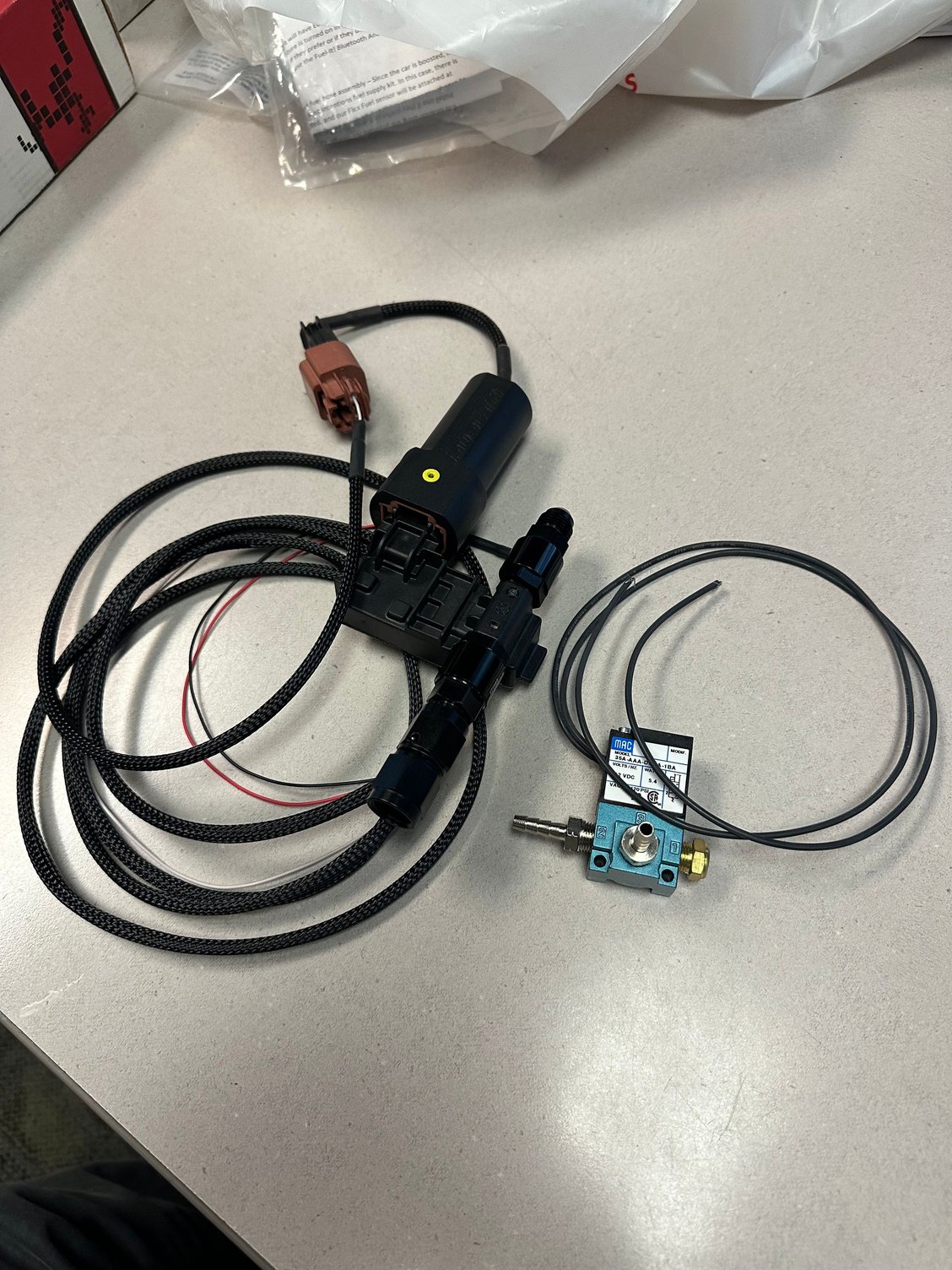

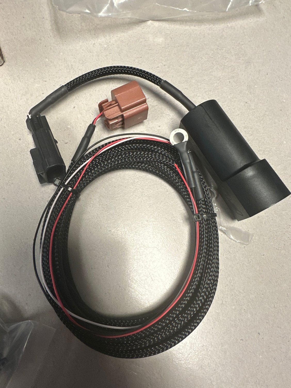

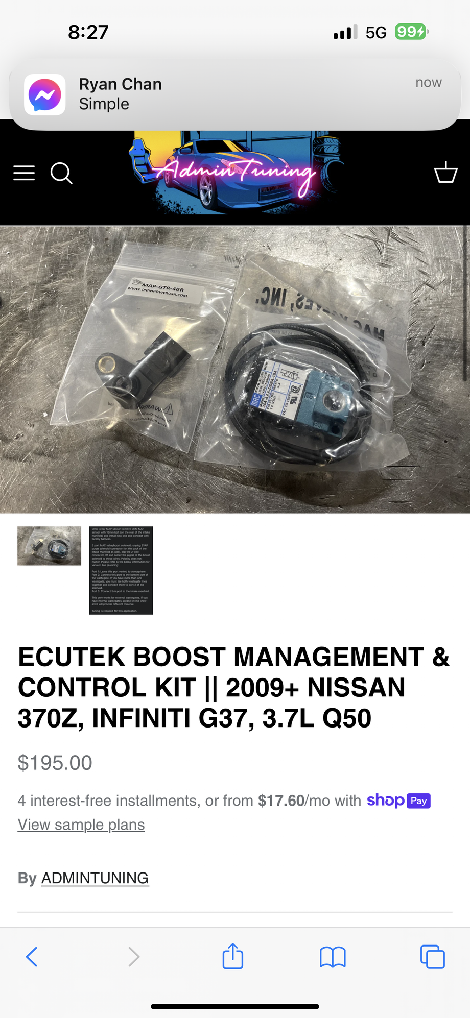

Admin Tuning Mac solenoid - installed
Admin Tuning flex fuel kit - installed
zspeed stage 3 race clutch w/cmak delete - installed
getting tuned this weekend!

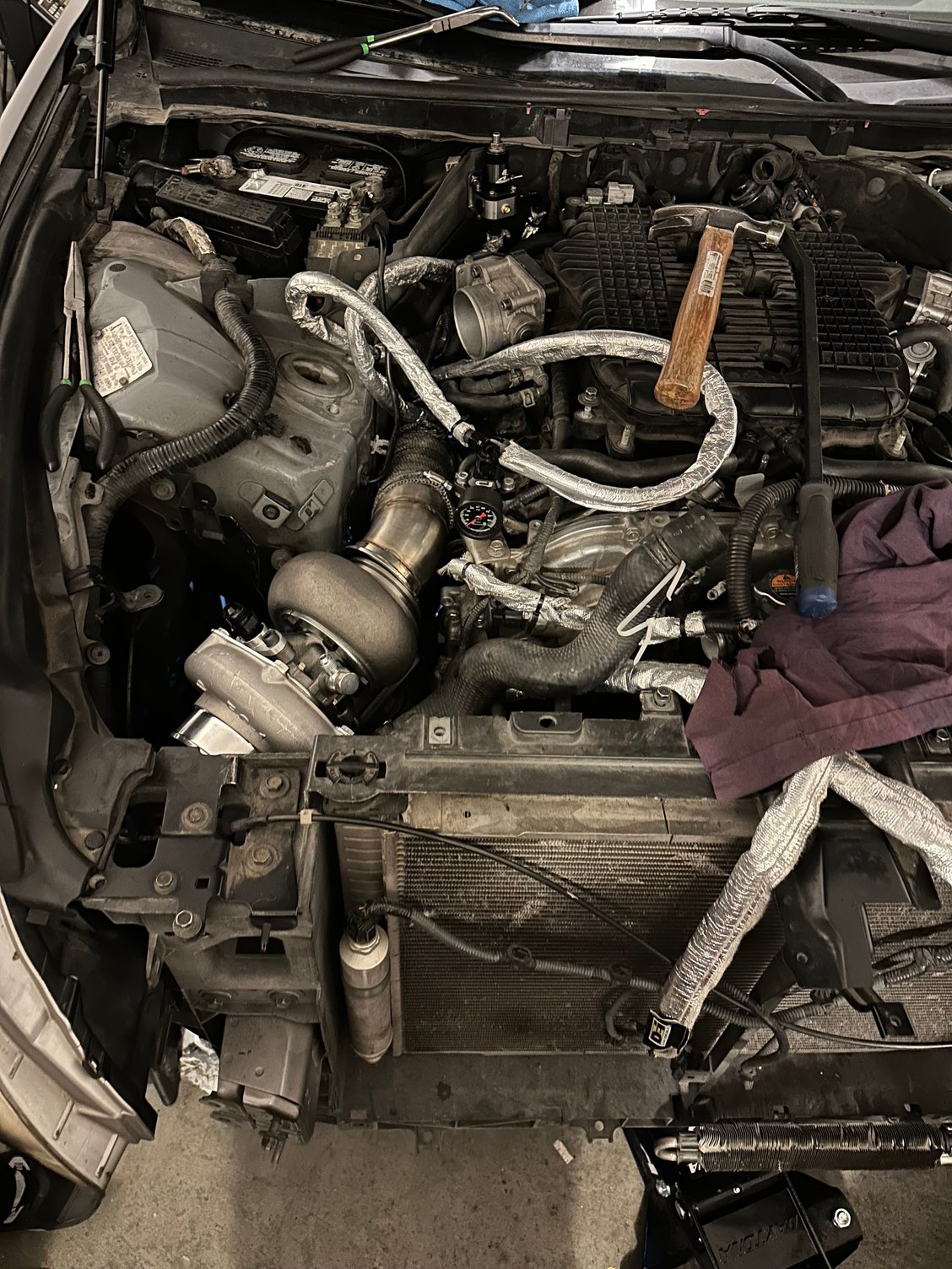

Old Oct 26, 2023 | 04:17 PM
Broken_2008_G37's Avatar
Broken_2008_G37
Joined: Dec 2015
Posts: 201
Likes: 25
From: Rancho Cucamonga, California

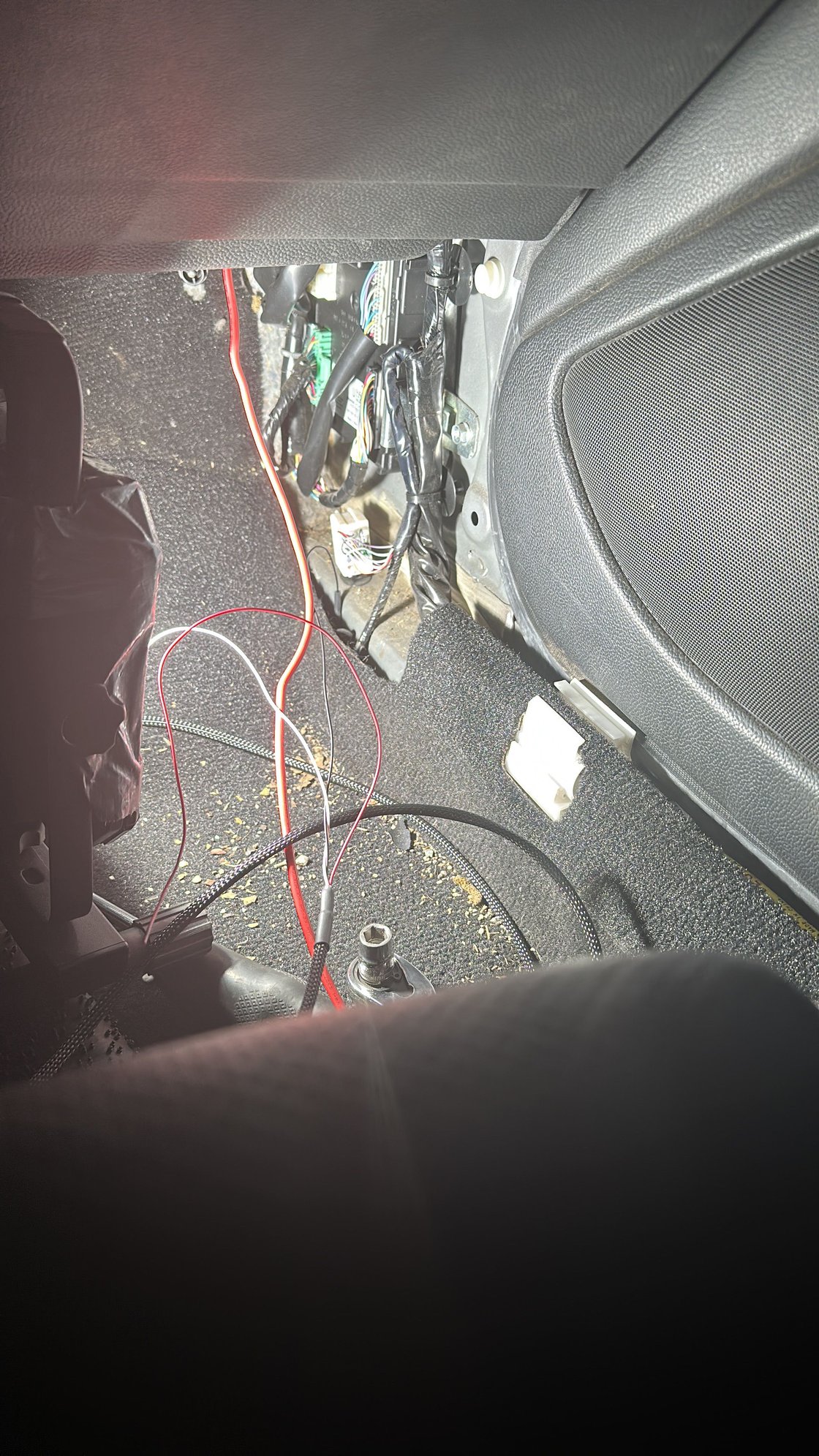

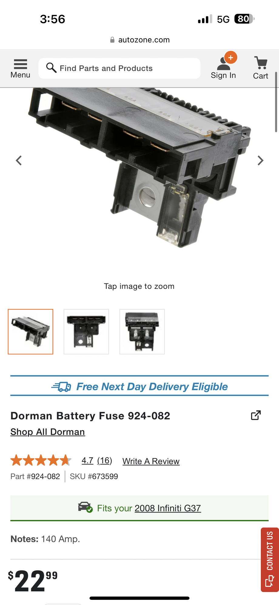

Alternator nut fell off and the wire grounded out . Has to buy this
Installed this bad boy

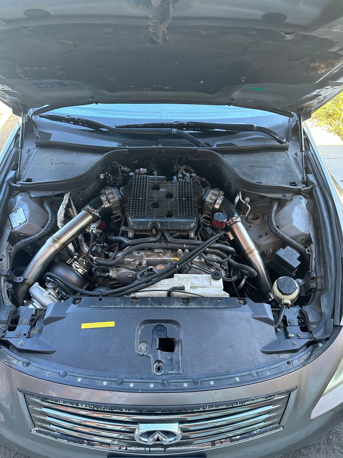

Coming together in the engine area
Mistakes were made

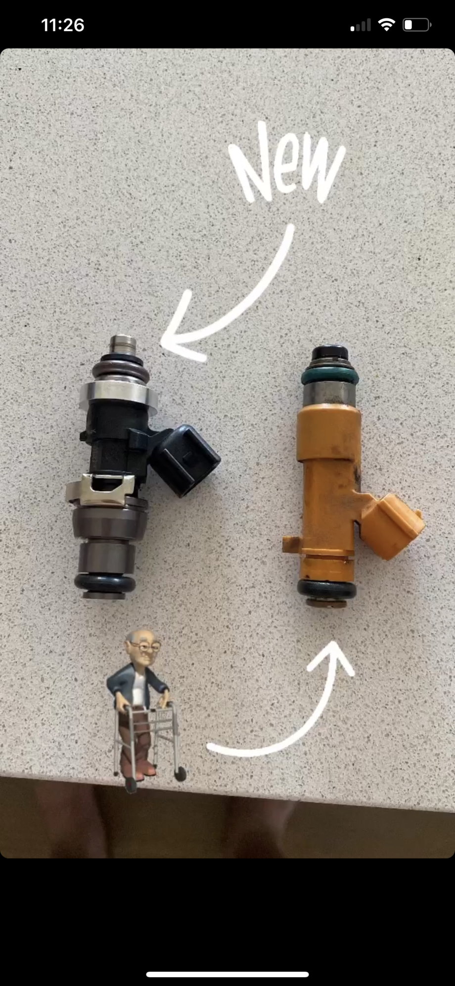

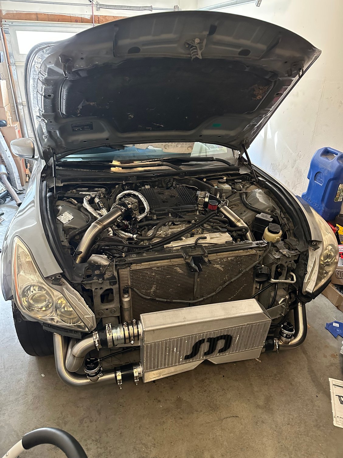

Comparing the old bulbs with the new. You can hardly see the intercooler (sleeper style)
Ready to get my e85 for this weekend (will purchase day of)

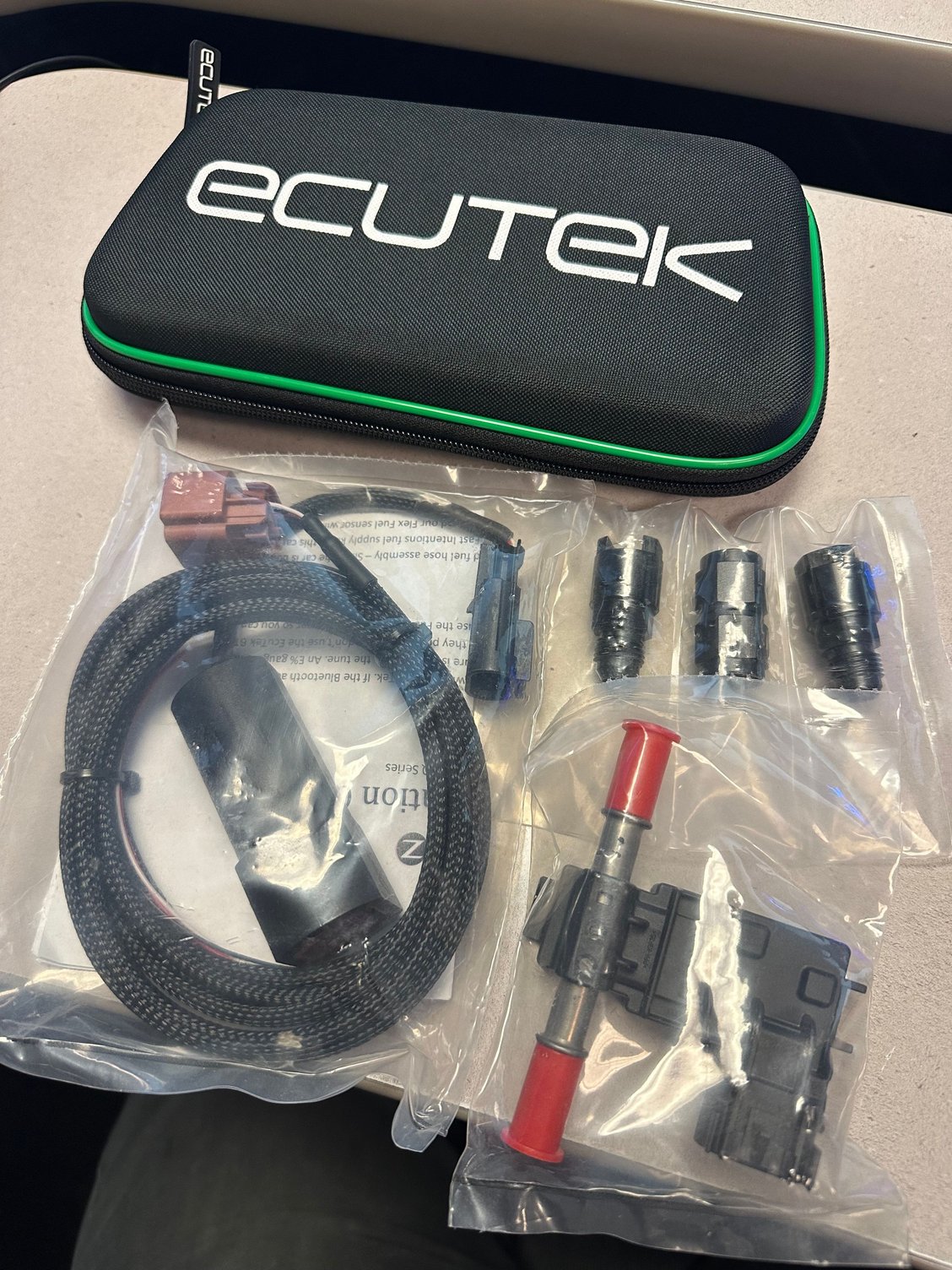

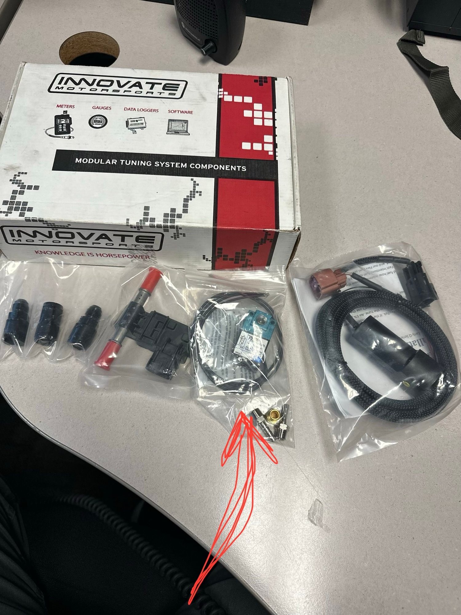

Wiring up the flex fuel kit

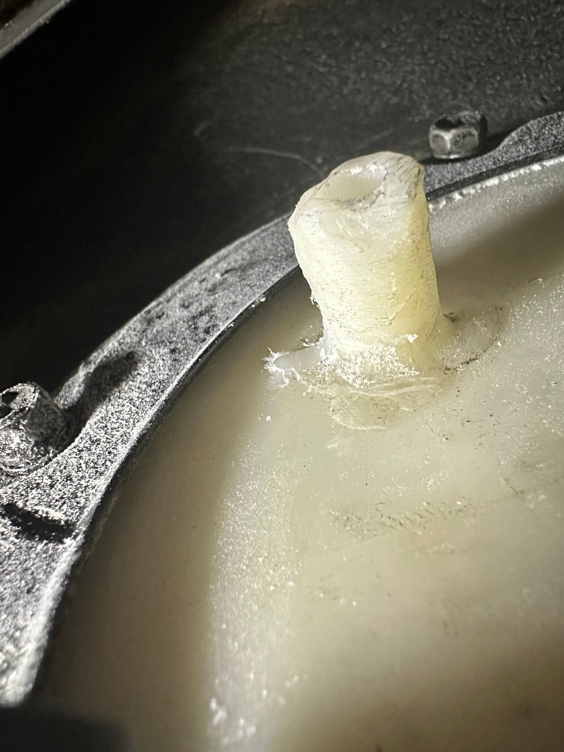

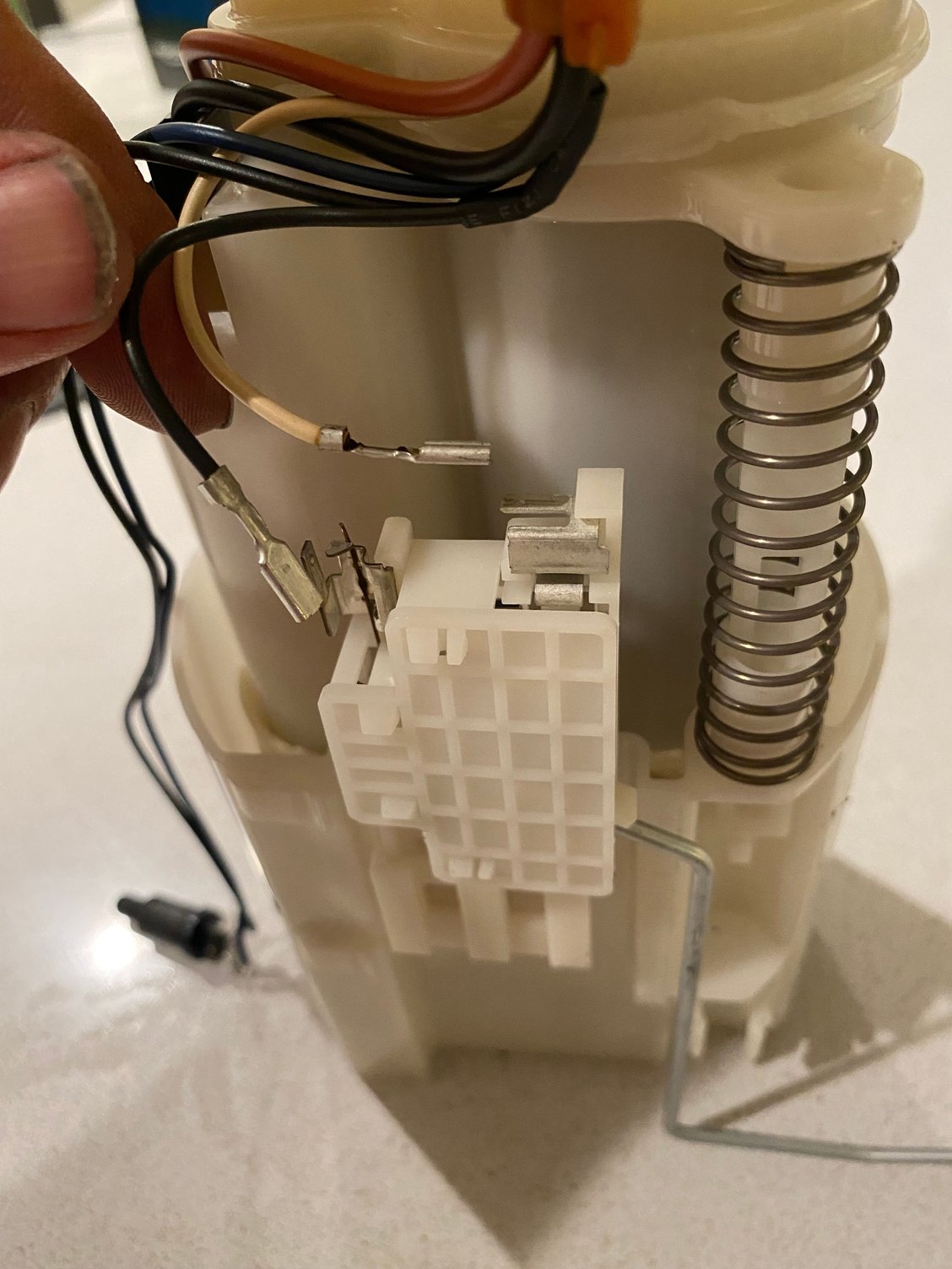

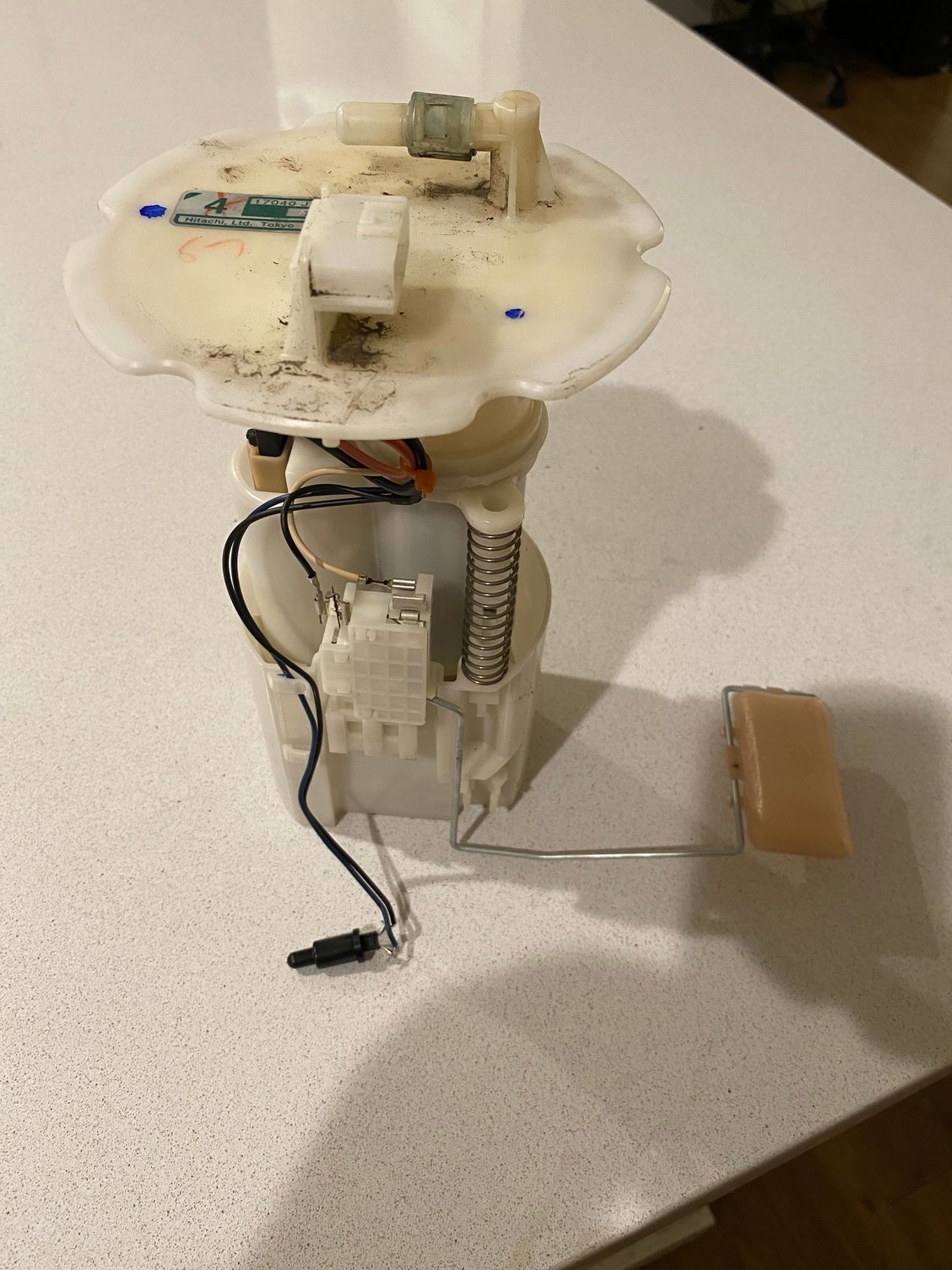

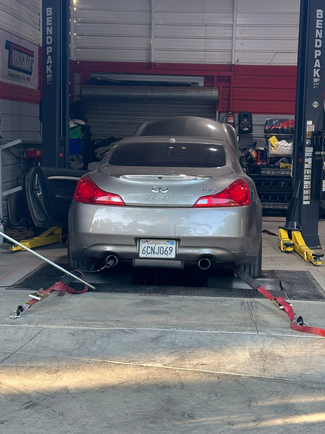

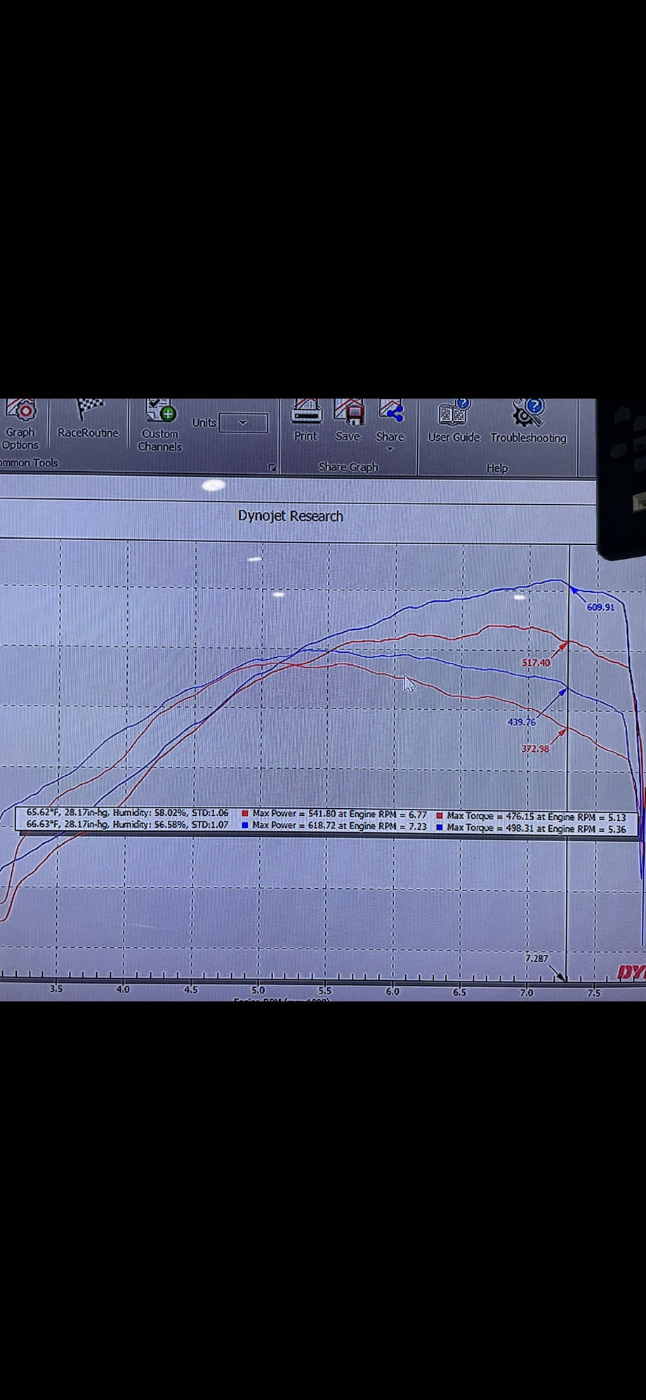

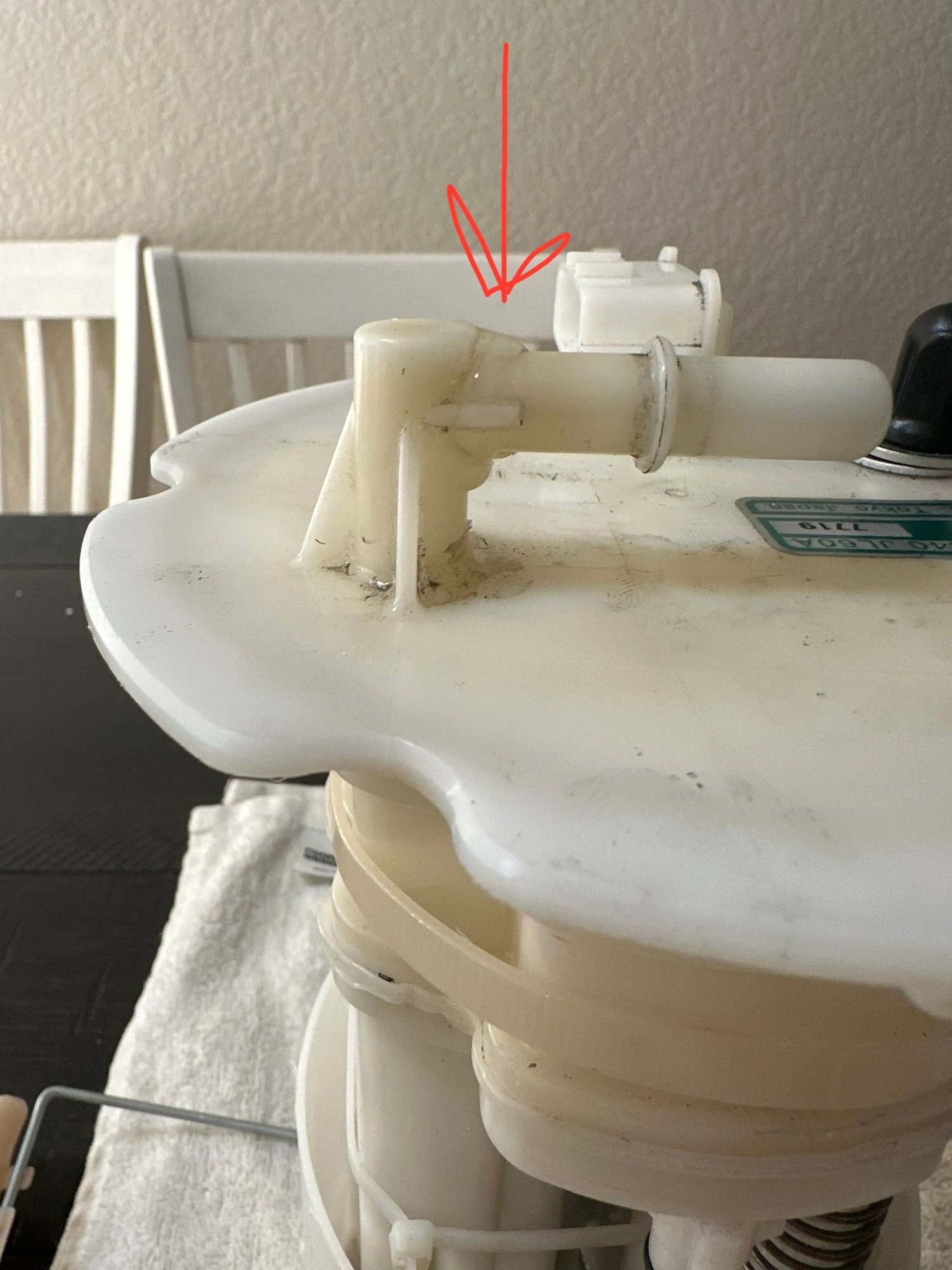

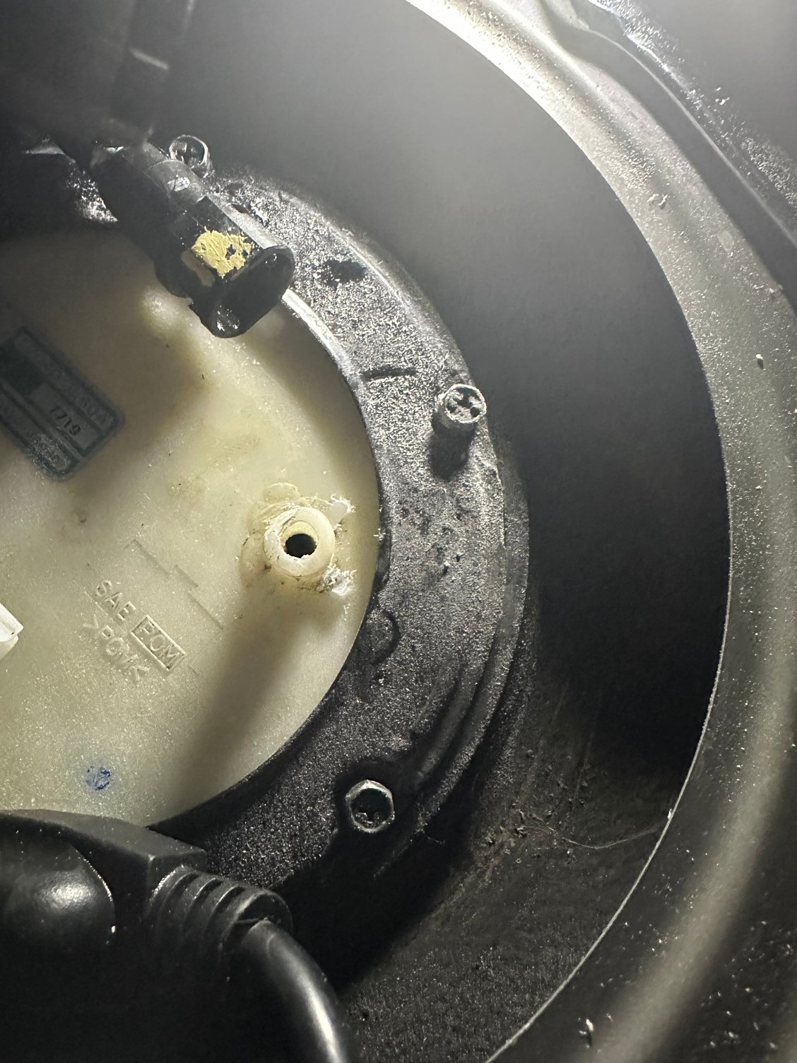

Was having fuel pressure issues on the dyno. When I would go into boost I’d lose pressure. I took my fuel pump out and showed the tuner. I guess when you modify the fuel pump you have to trim the top…. There are 3 barbs. I cut it just under the last barb leaving no barbs. I guess when you trim it you’re supposed to keep one barb in there. So my 450 was tossed and I got a hellcat 525. On an e60 blend I made 618. Will make more on full e85. But my car def a sleeper

I havent seen anyone with the t6r's . i really like them. i wanted something low key.. something i dont see very often either. i feel like they mesh well with the sleeper look.
