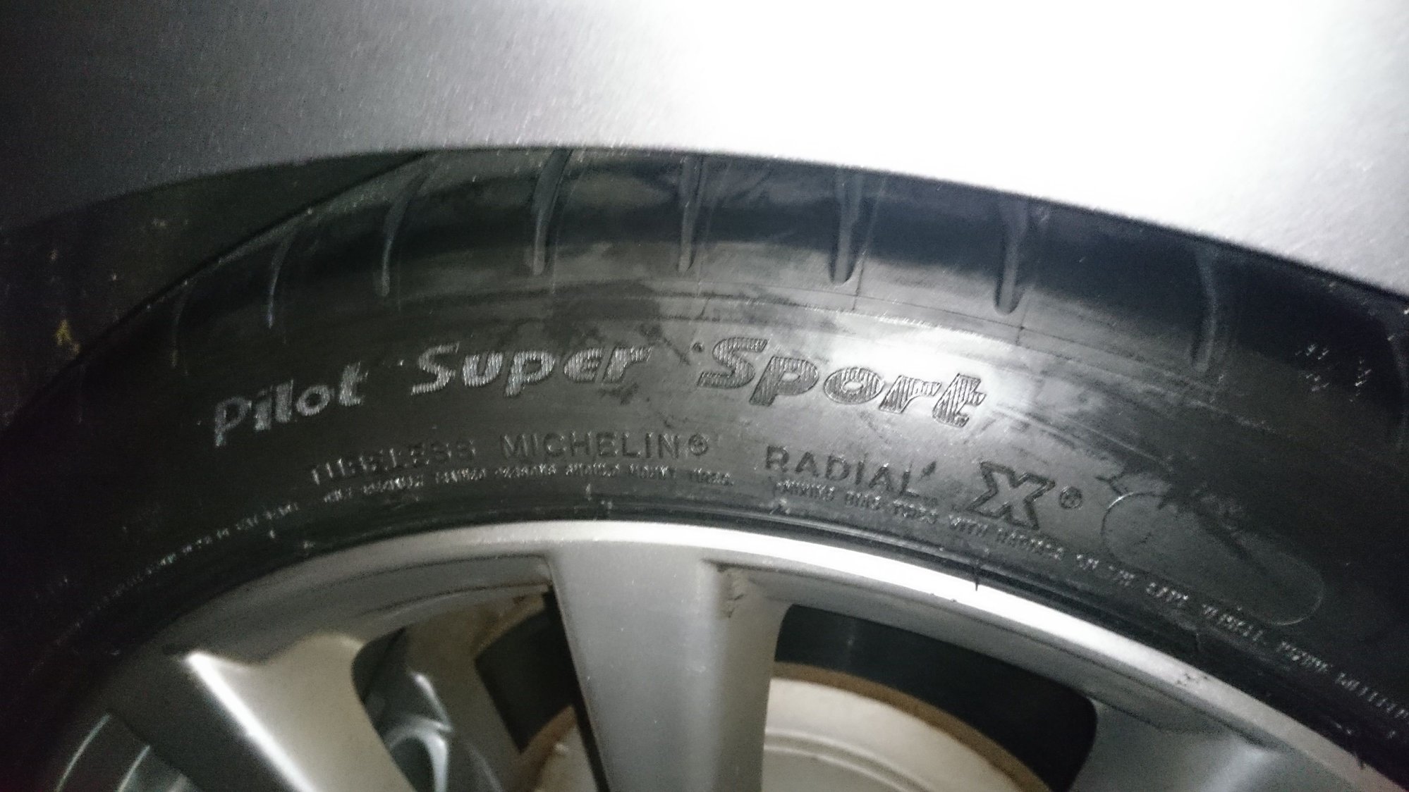

Driving to Atlanta from Indiana, I got to know the car and immediately knew there was something lacking. The first thing I did was get rid of the crappy Falkans that were wrapping the rears. I bought Michelin Pilot Super Sports. These are amazing tires. On the street, they grip endlessly.

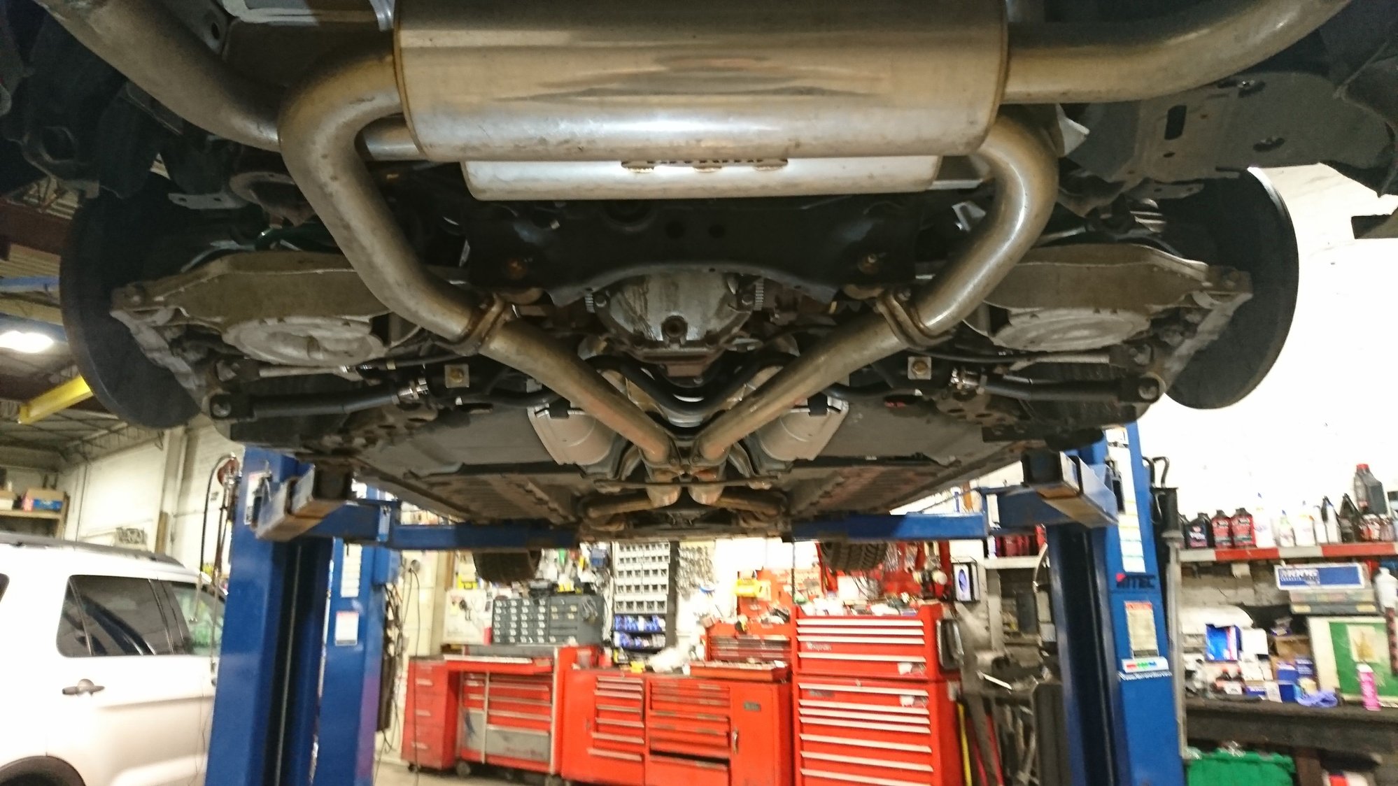

Mini guide to remove rear endlinks:
1. Remove old endlinks. Each application is different, but it might require the endlink bolt to be kept from rotating by holding it with a wrench and torquing off the nut.
2. The lower connection is easily accessible from under the car.
3. The top mount nut is accessible easiest from the spring area while slipping a wrench from underneath to hold the endlink bolt.
Installation is the reverse going from 3 - 1.
The SPL endliks are very stout which the picture illustrates. You will need a 15mm socket or ratcheting wrench for the nut and a 17mm wrench to hold the bolt for the install. I also added some washers in between the retention collar and mounting frame for more surface area and holding strength.
Finished product.

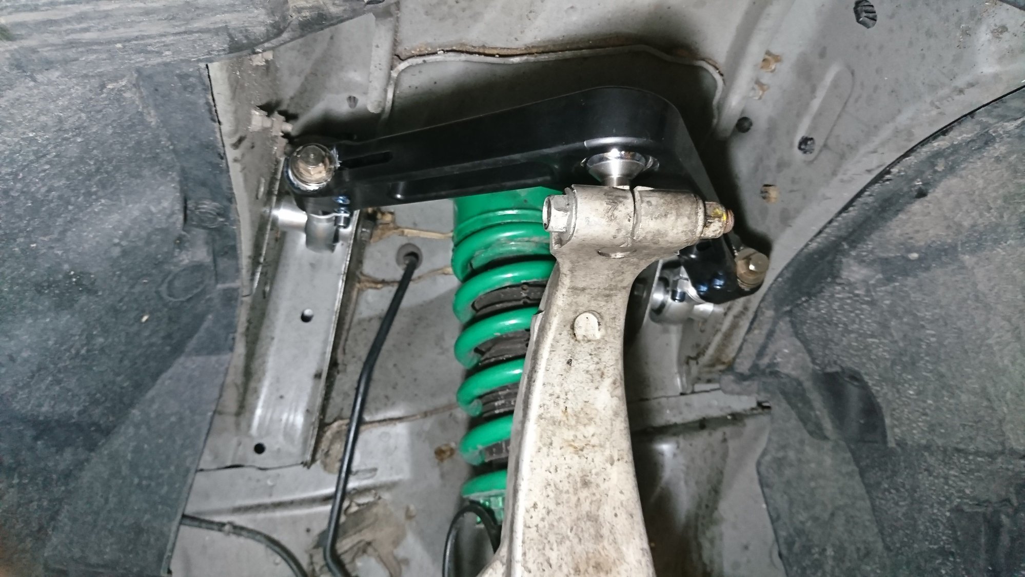

SPL front camber arms are in.

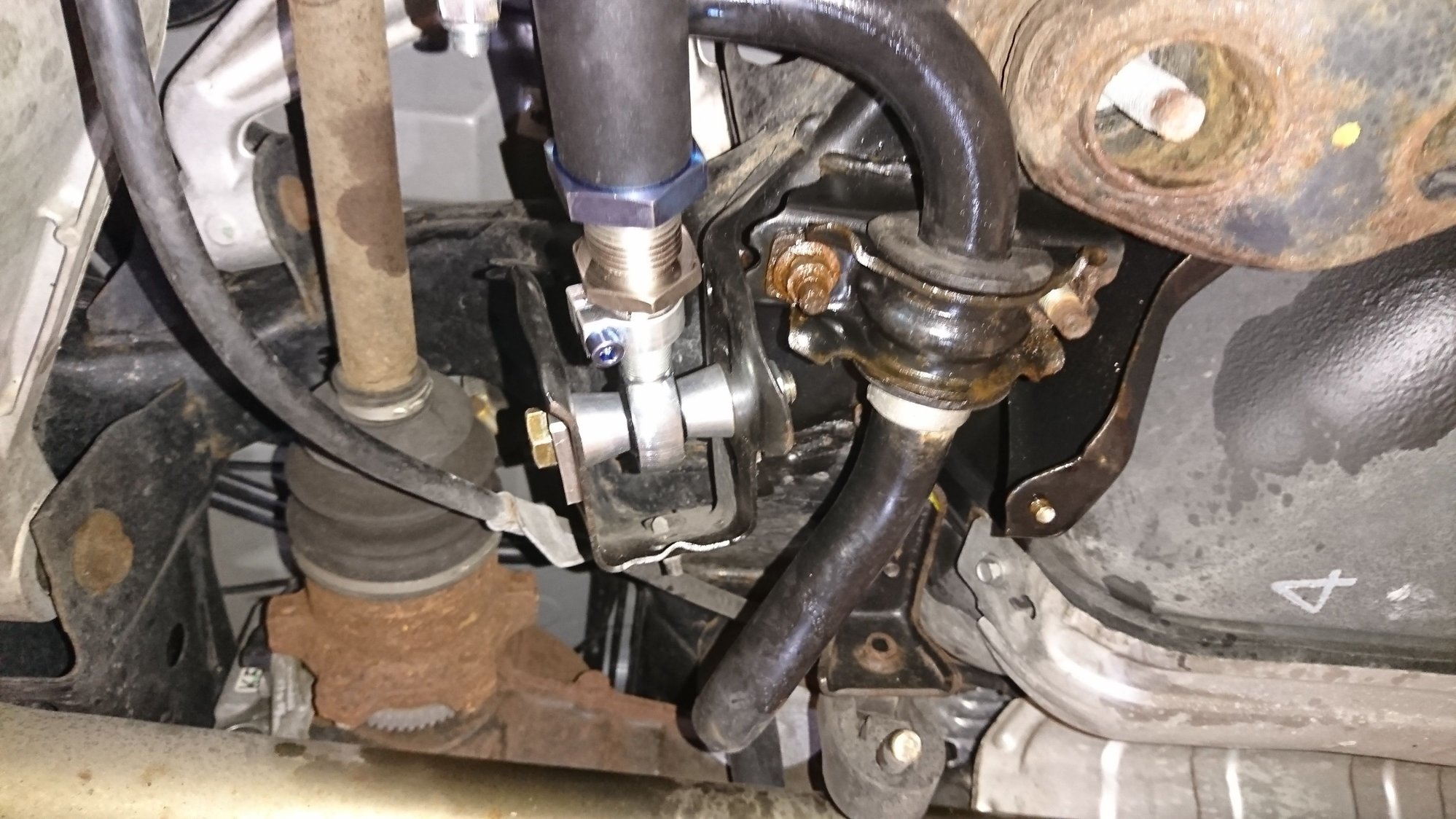

SPL front endlink:
