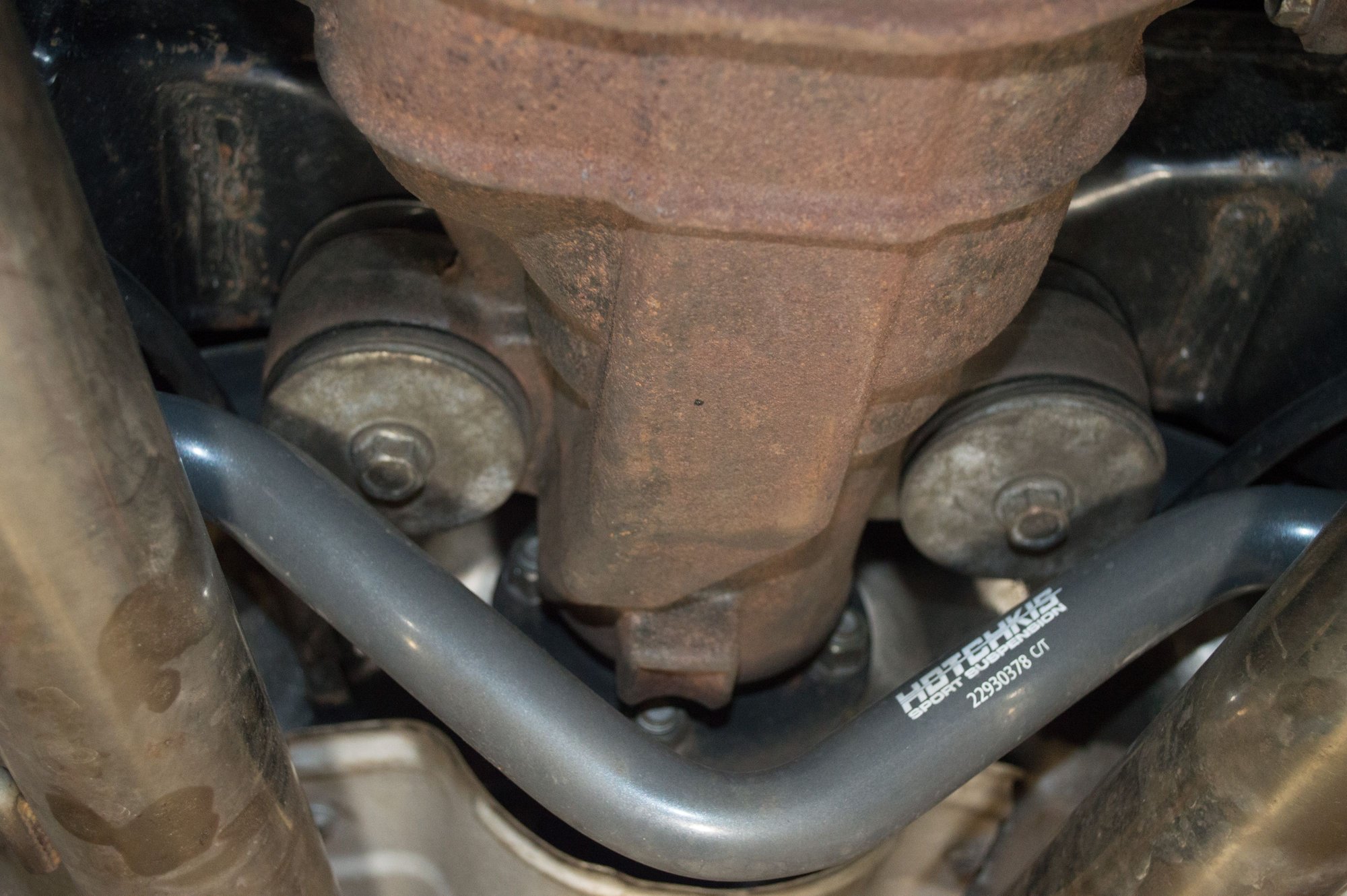

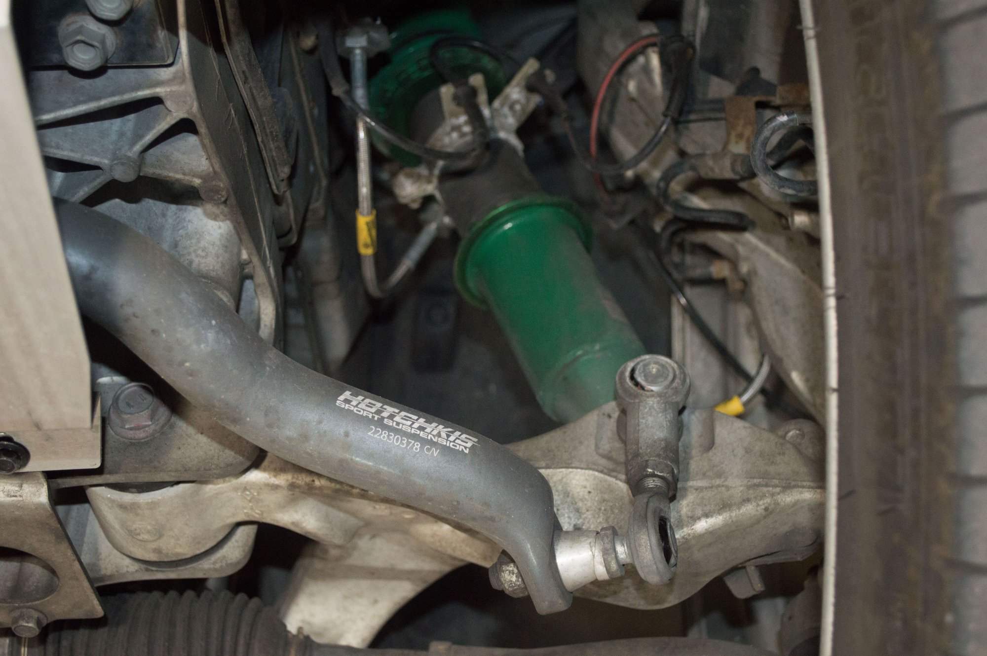

Hotchkis Sway Bars
Hotchkis sway bar went in.

Sway bar mod is by far the most rewarding in terms of handling. Enjoy!

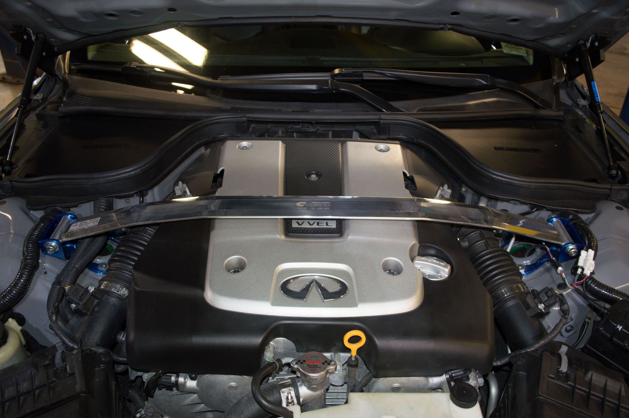

Cusco Strut Tower Bar
Threw on a strut tower bar because race car or something.

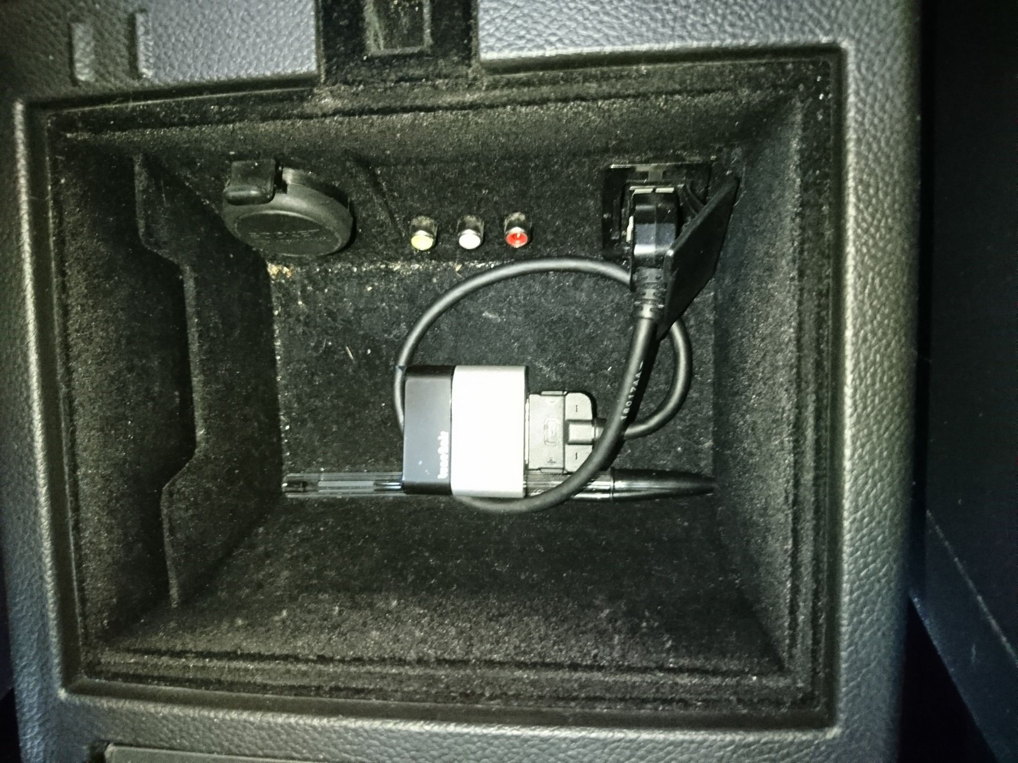

Tune2Air
'08 Bluetooth music streaming solved. Bought the Tune2Air adapter the day I bought the car. Can't imagine life without it.
It has it's quirks like sometimes taking very long to power on but, that is due to the power spec for the factory iPod adapter.
Quick update: Since the factory iPod interface port was based on the firewire specification, it did not provide sufficient power to my Tune2Air bluetooth adapter. The result was unreliable activation, anywhere from instant to 30mins to start-up and connect. In order to solve this, I finally got around to buying the CableJive dockStubz+ 30-pin charge converter. It fits in between the iPod cable and the Tune2Air adapter.
What can I say, it's a cheap fix and works 100%. The Tune2Air starts up with the car every time all the time.
You can grab this thing
here here

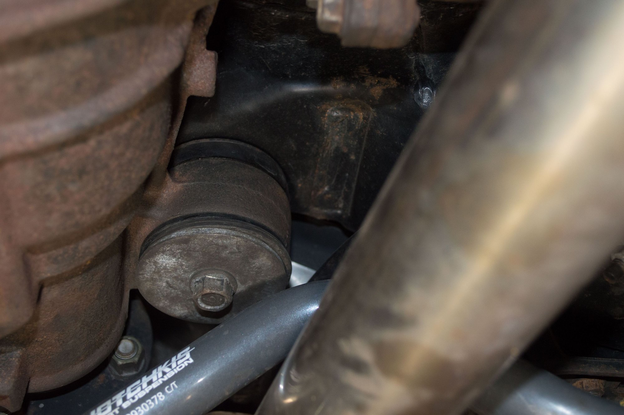

Whiteline Diff Bushing
Spent a few hours with a hole bore, sawzall, and hammer but got the my Whiteline poly bushing installed. Like everyone's experience, it was a complete ***** to remove the stock bushing. Now that that whining is done, I can happily say it was worth the pain.
I don't know for how long my OEM bushing had leaked out its guts but, it appeared it was from before I owned the car. I guess ignorance is bliss because I was happy with the performance previously but, the difference after the poly bushing was staggering. The hook up is strong and immediate. One of the top mods for this car.

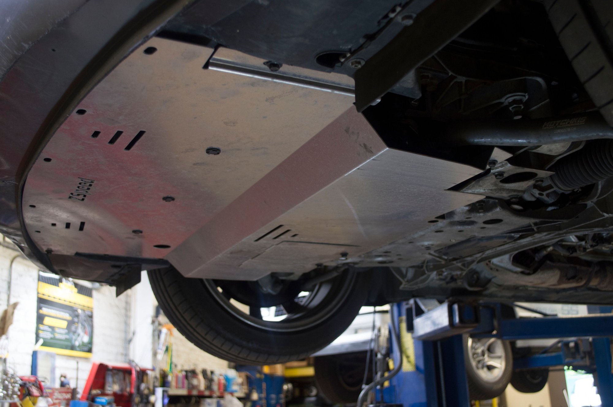

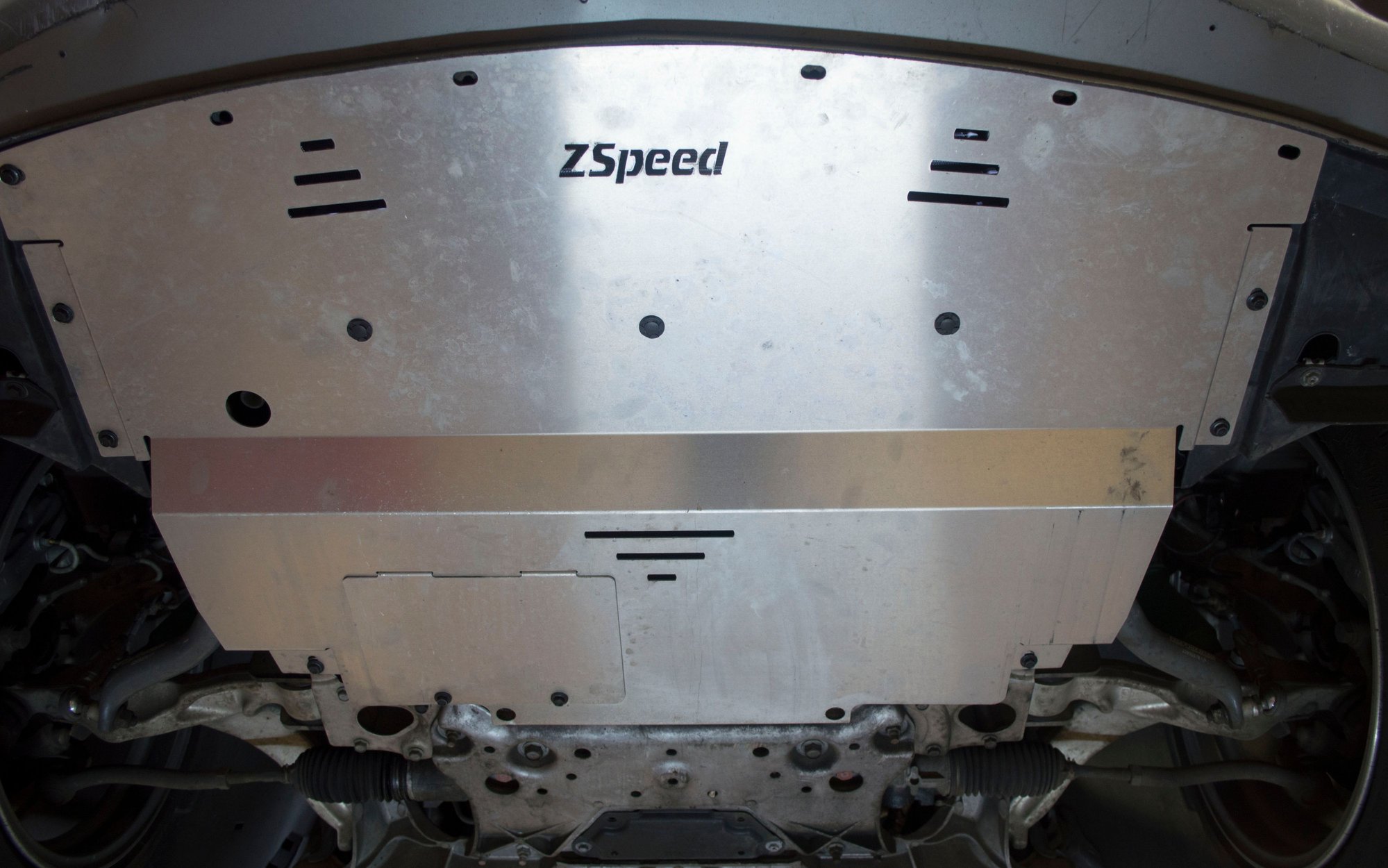

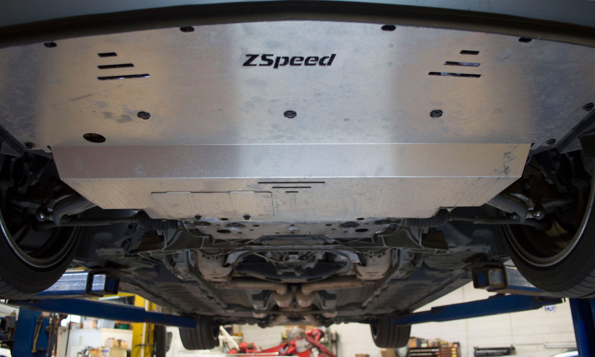

ZSpeed Performance Splash Shield
Upgraded the splash shield to a ZSpeed Performance part to accommodate beefier sway bar brackets. Plus, the mounting holes perfectly line up with the factory holes. This is a quality made part.

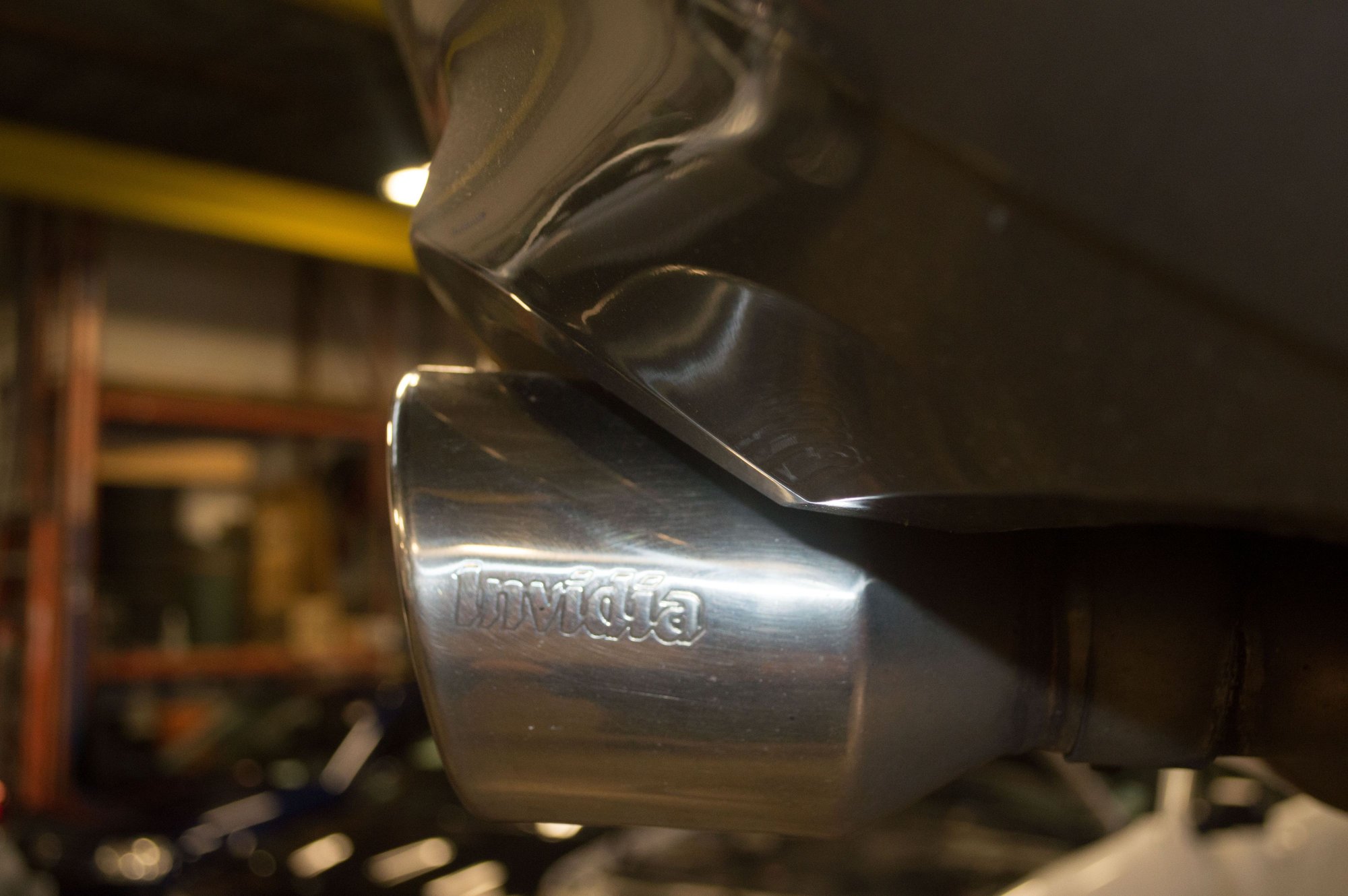

Invidia Gemini Catback Exhaust

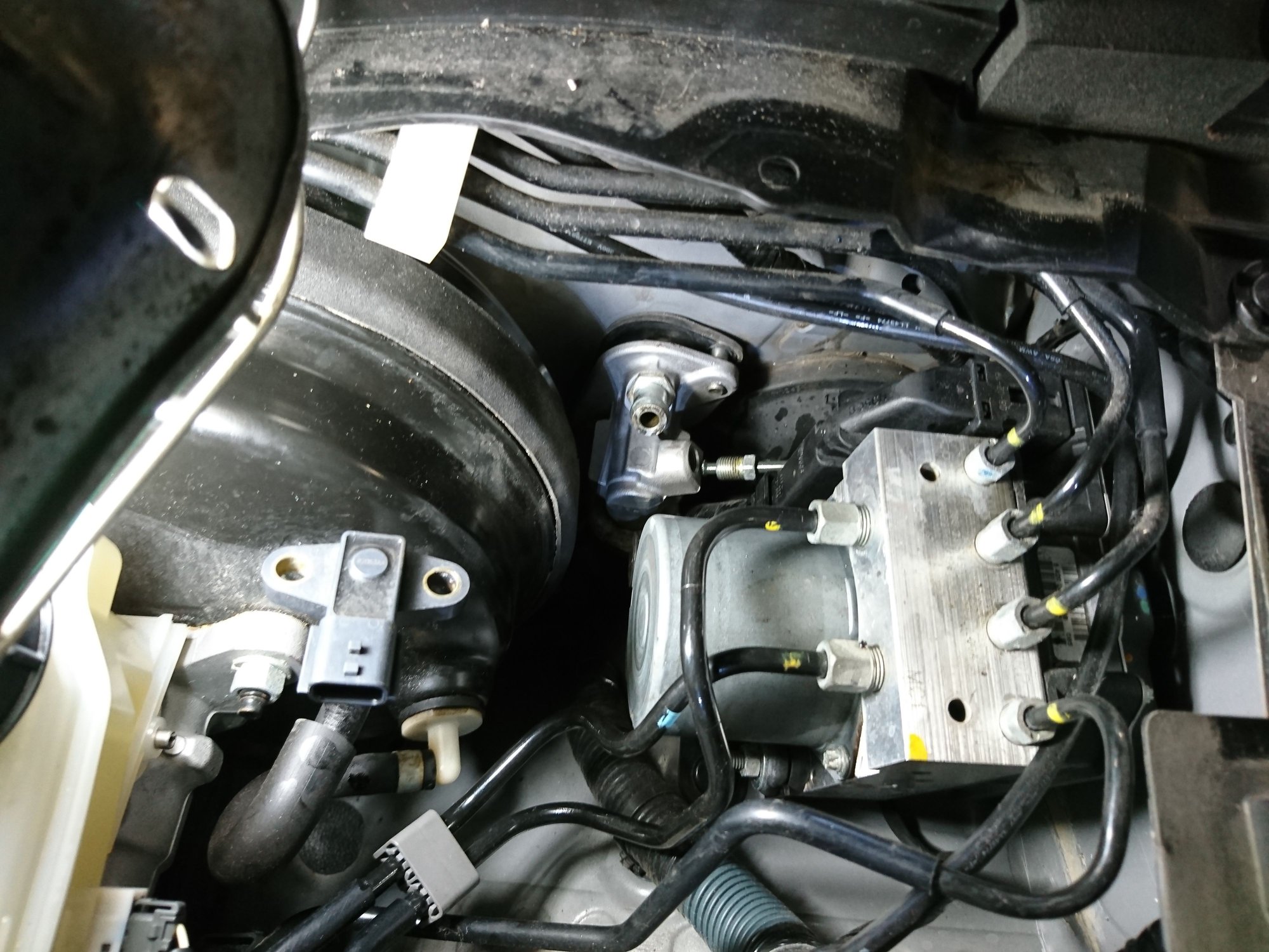

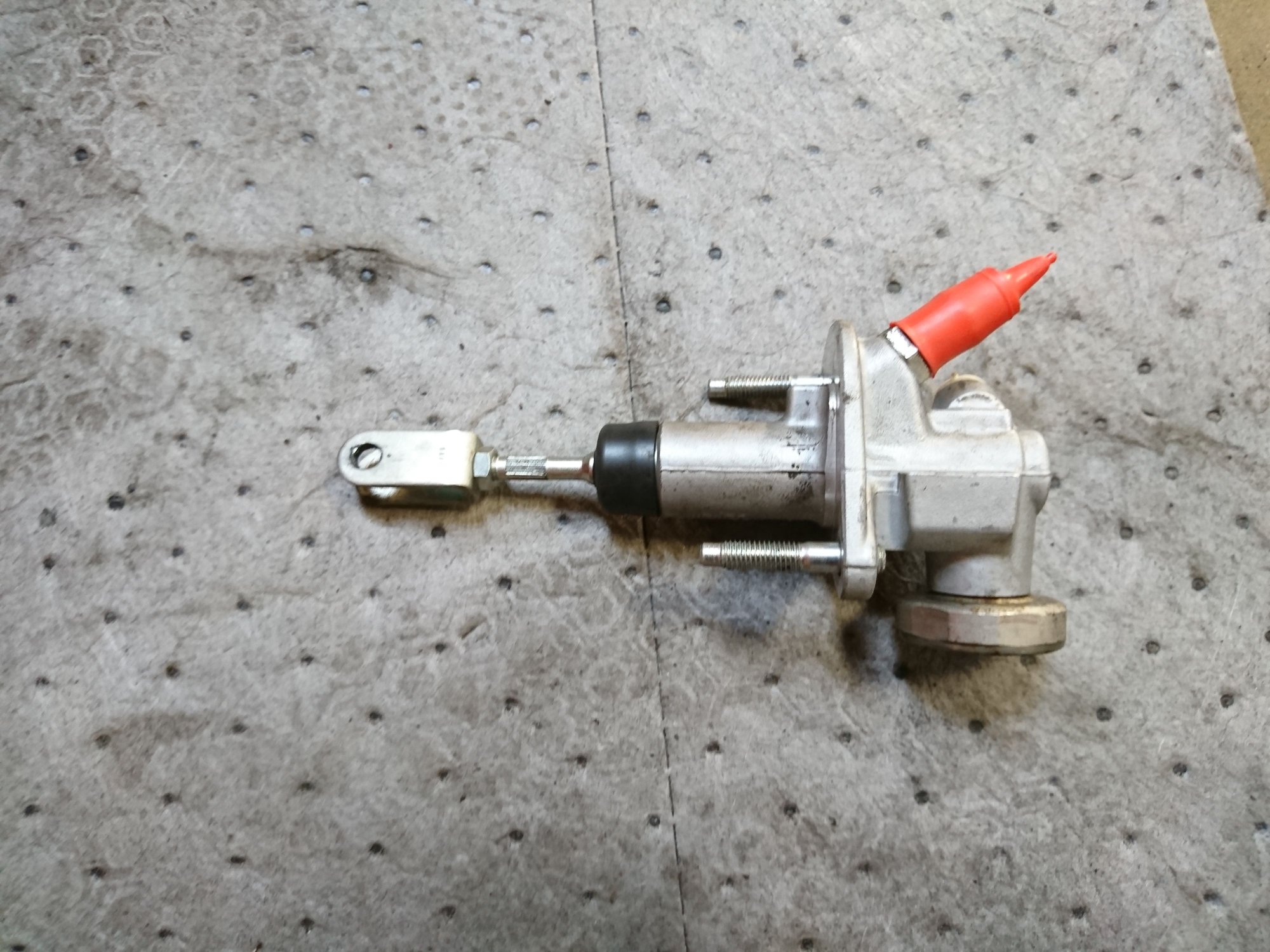

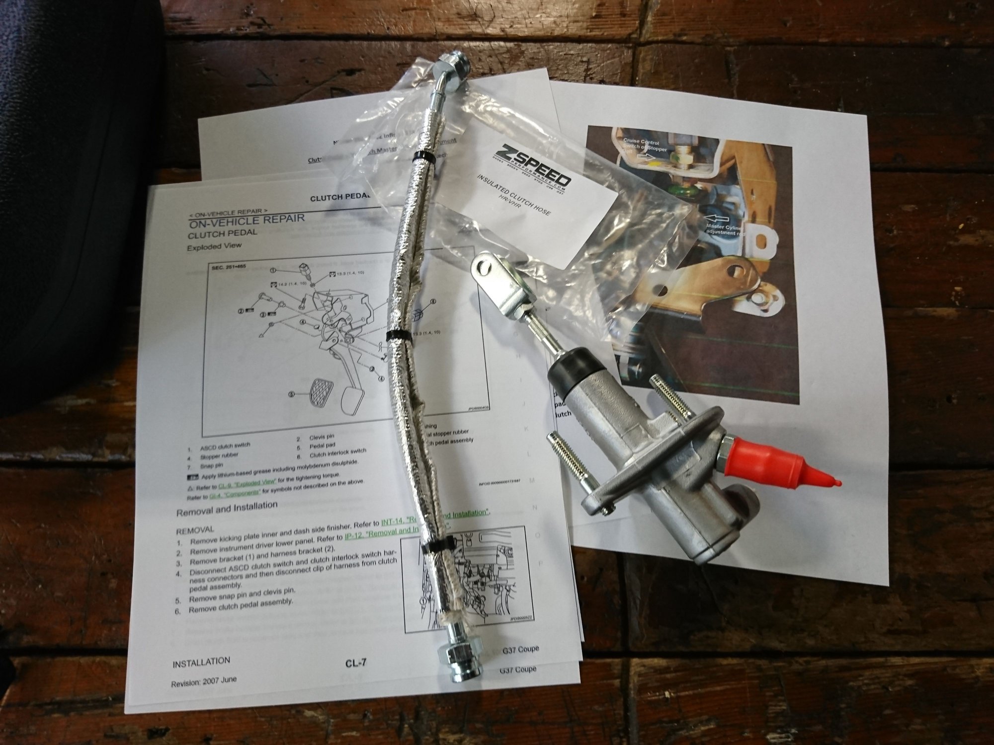

Clutch Master Cylinder
With a track day coming up, I decided it was time to install the OEM 370z clutch master cylinder (CMC) that I bought but, never got around to installing. It's been a while since I bled the clutch fluid so it was horrendously black. Put in some Motul DOT 5.1.
The old CMC has a damper at its base to lessen the vibrations coming from the clutch. It's nice and adds to the luxurious feeling of the car. However, the byproduct of this is a sloppy pedal and being difficult to bleed.
The 370z CMC deletes this. My initial impression is that I can feel the clutch vibrations and a more direct and linear engagement. In short, I love it. Highly encourage people do this swap if you have not already done so.
OEM 370z clutch master cylinder and ZSpeed insulated SS clutch line.
Remember to remove the side sill trim and fuse cover trim.
Get your 12mm swivel out.
Do yourself a favor and remove the ABS module. While you're at it, getting the left hood strut out of the way helps.
3x12mm nuts and 6 hard lines (2x12mm flare nut and 4x10mm flare nut). You will have freedom to work and not damage anything.
See ya old POS CMC with a damper.

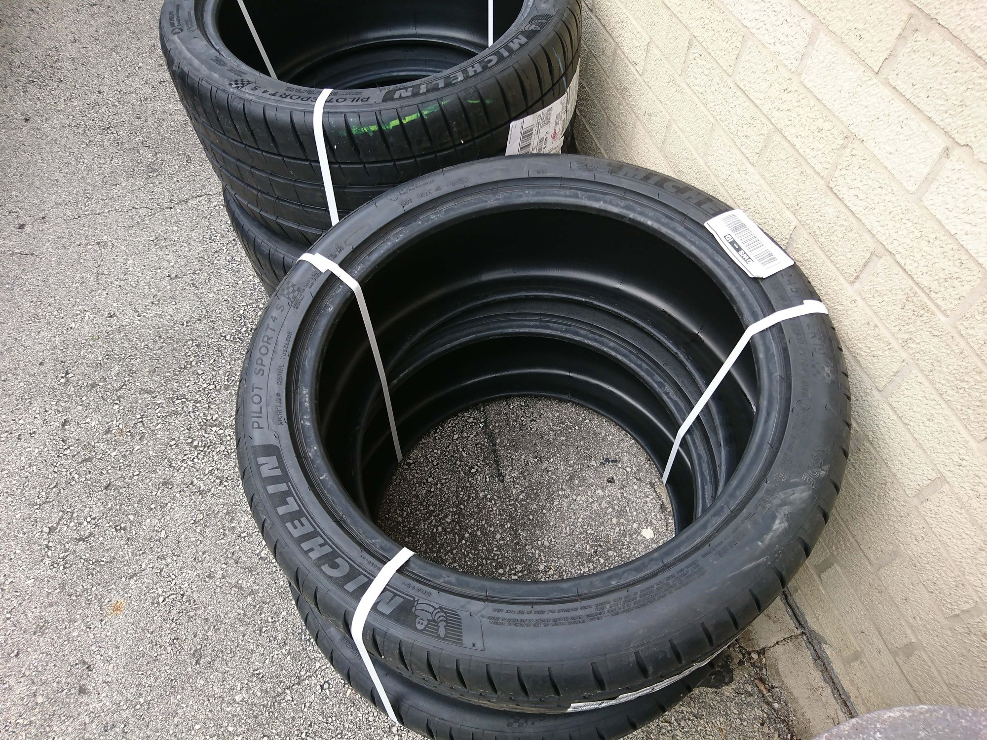

New Shoes
UPS came by and dropped off some goodies.
Took advantage of DiscountTire's 4th of July sale with rebates and bought a set of tires. It was perfect timing since I've worn by rear tires close to the wear bars.
