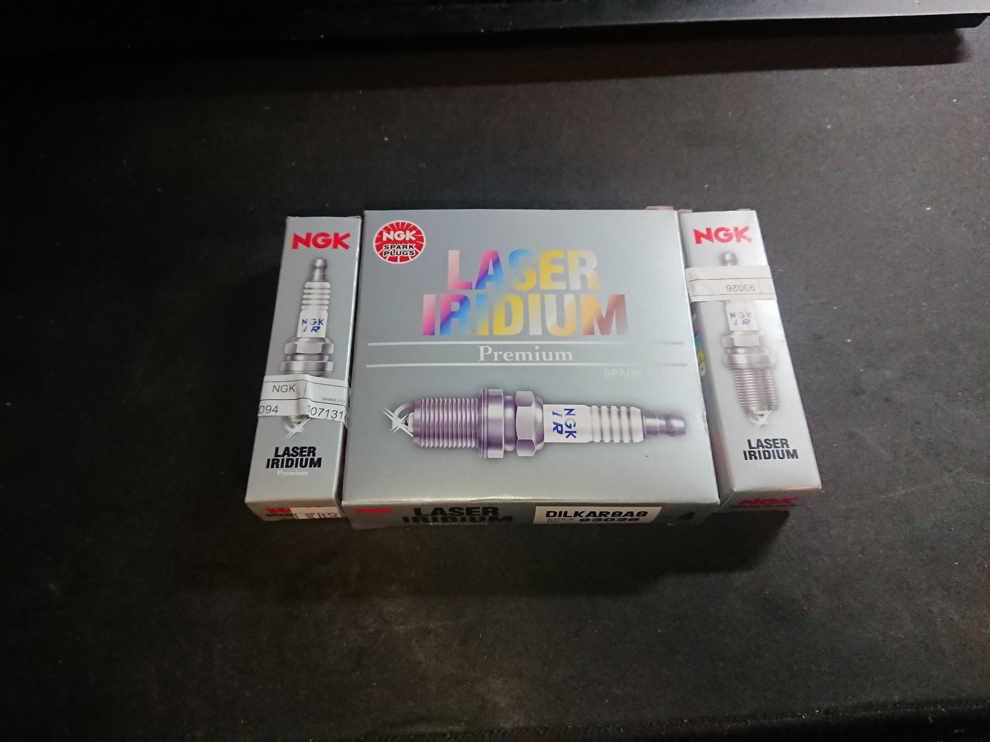

NGK DILKAR8A8 spark plugs (AKA GT-R plugs) came in the mail. Same heat range (NGK 8) as the OEM Denso (24) in the G/Z. The gap on the GT-R plugs are smaller at 0.032" vs 0.044" on the VQ37VHR.
