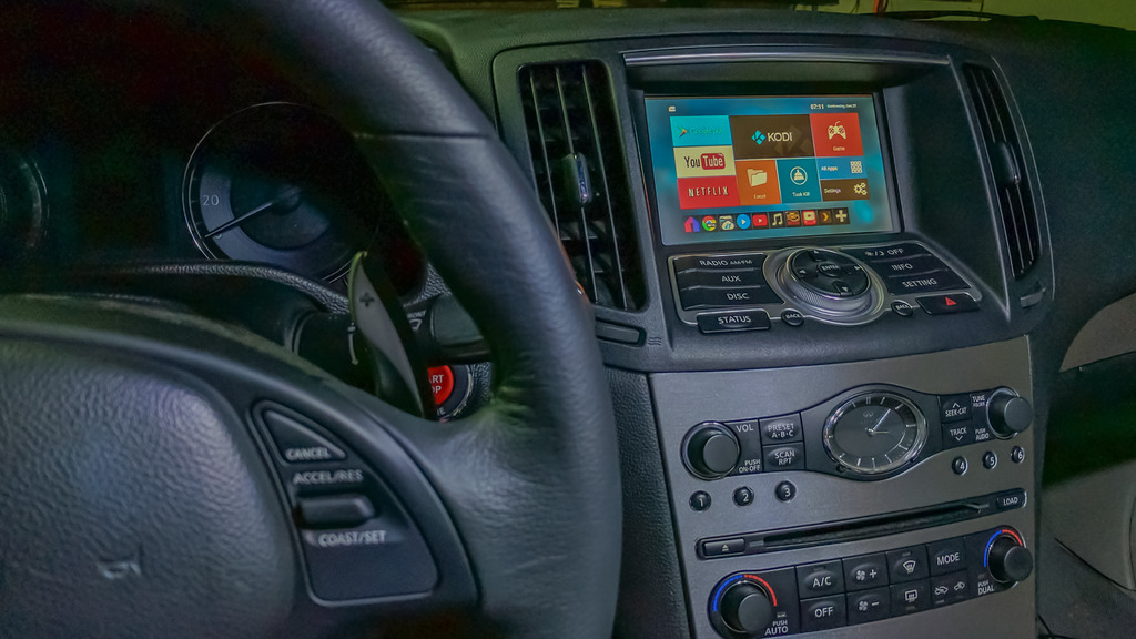

I took some time today to do more work on my multimedia setup. I have gone through several iterations in the past, and I think I've arrived at the best solution for my needs. I don't think I'll do a dedicated DIY for it unless there's enough interest.

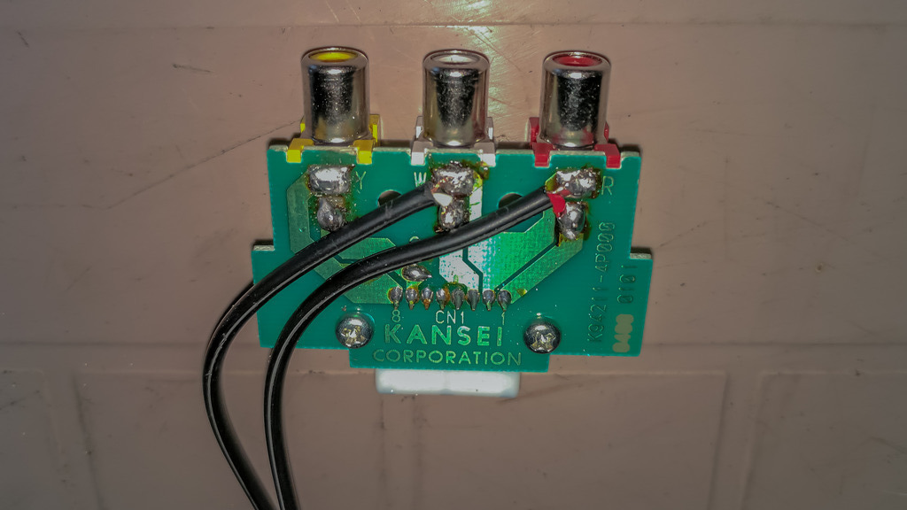

I opened up the box that contains the RCA jacks and soldered short RCA cables onto the pads of the PCB.

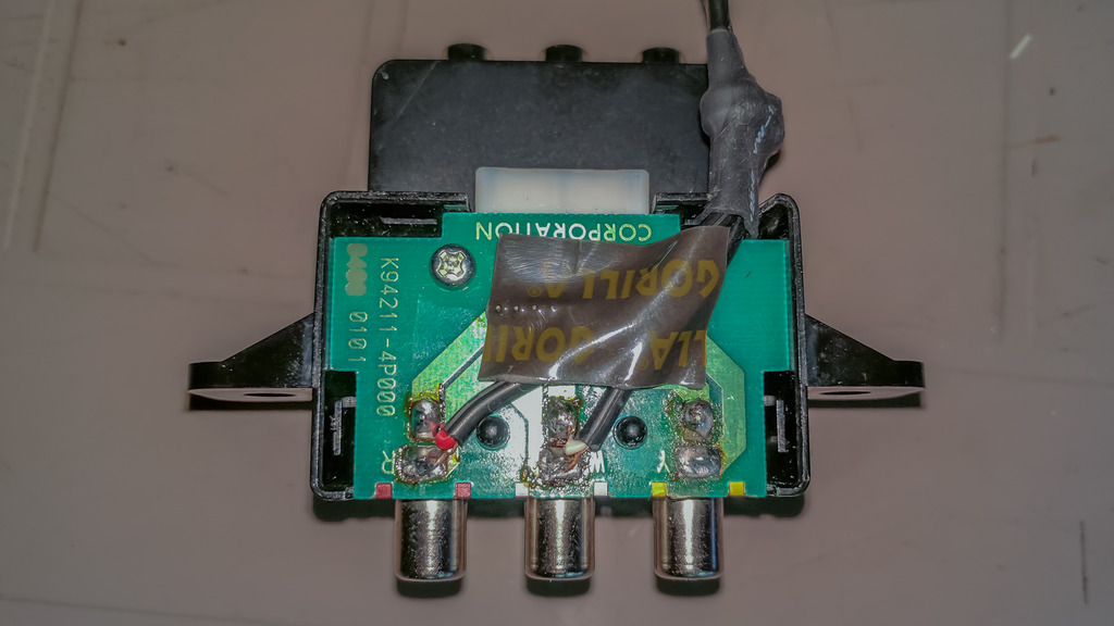

Secured the wires. I also removed part of the housing to make room for the wires.

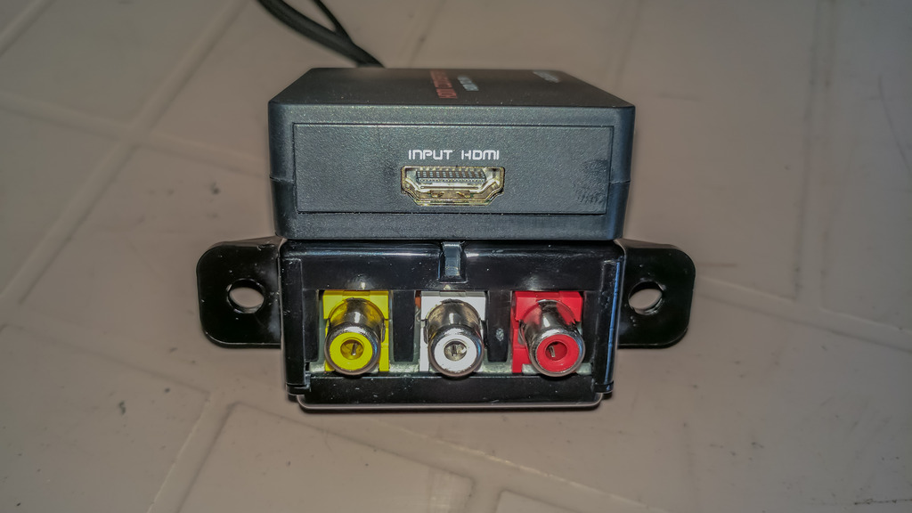

I used epoxy to attach an HDMI to RCA converter box to the top of the RCA module.

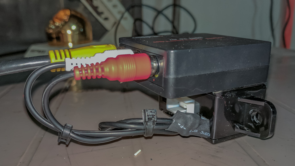

RCA cables attached to HDMI converter, showing where the audio components go into the RCA module.
I removed the iPod connector since I never used it, and mounted the combined modules back on to the console.

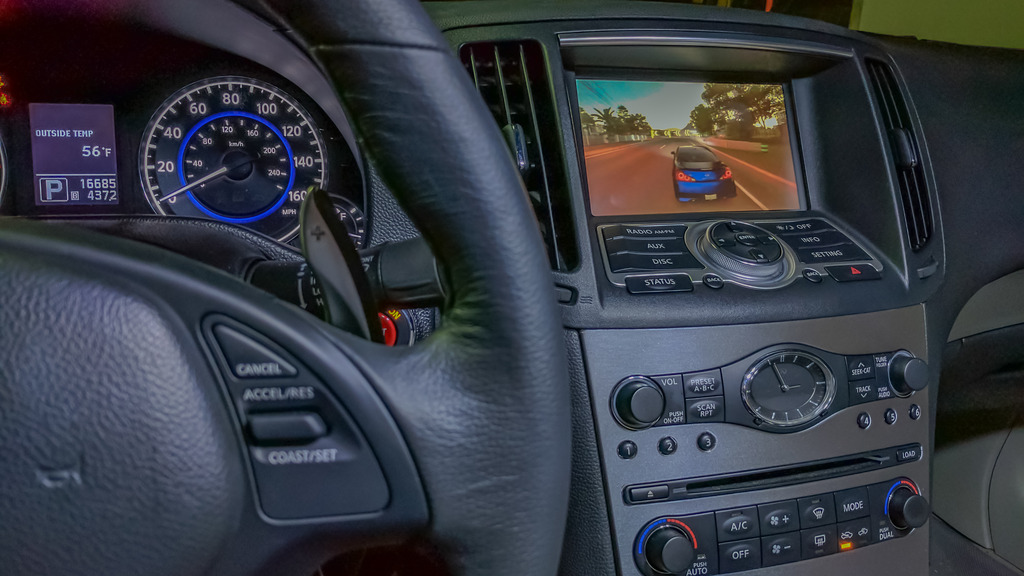

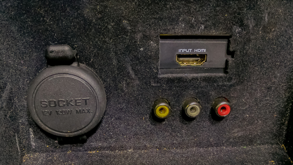

The yellow cable from the HDMI box goes to the NavTool Video 1 input. The white and red cables go directly to the PCB that routes the audio to the speakers. It's not the prettiest setup, but it works.
