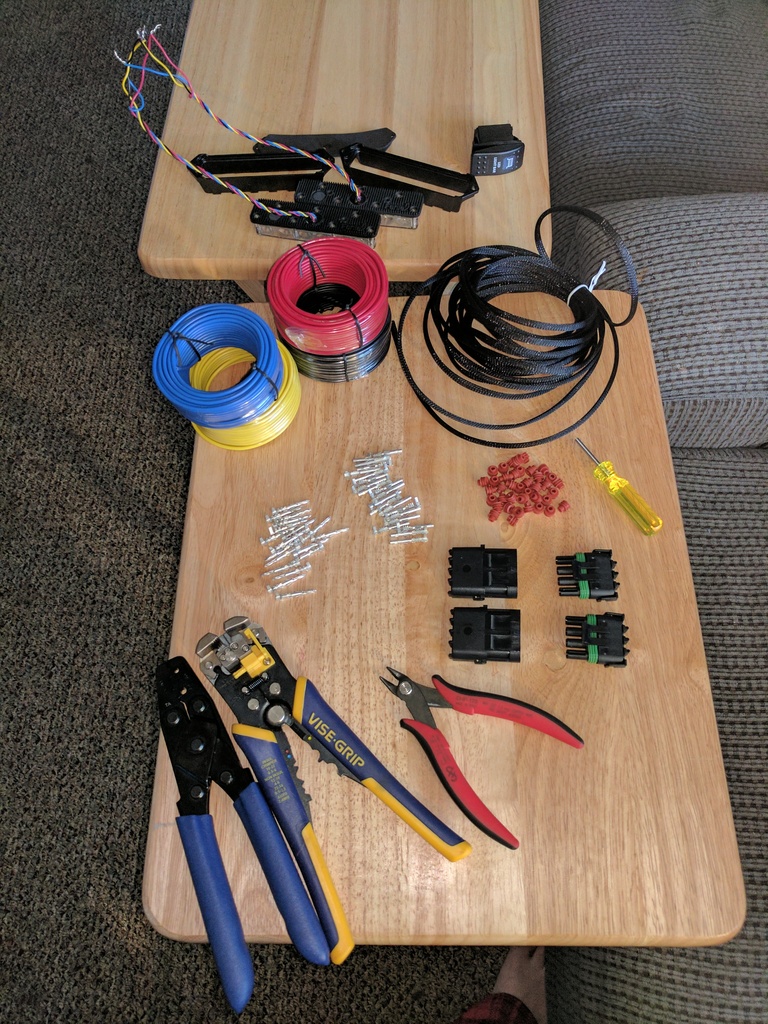

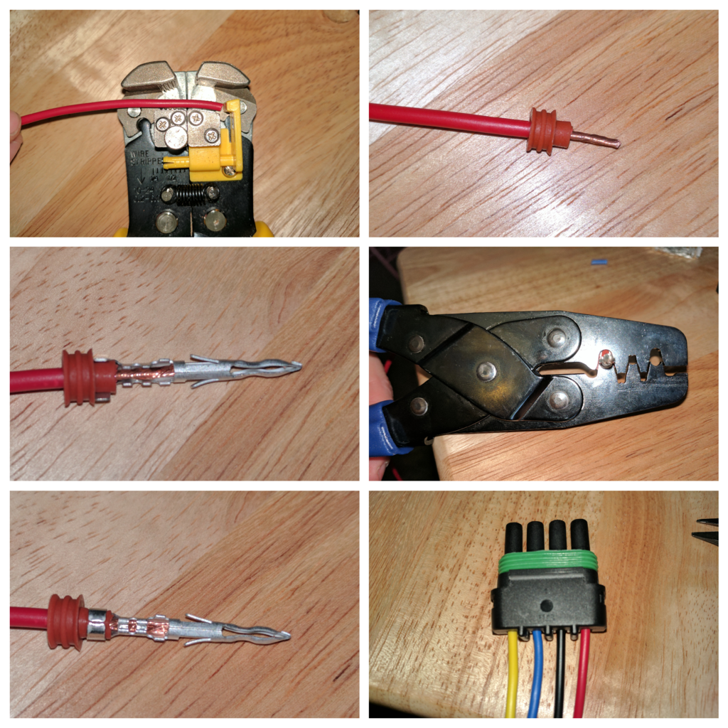

Since I was off today I decided to work on the wiring harnesses for my blue lights. I had ordered some supplies off Amazon since mine were running low. I decided to go with a Weatherpack connector setup.
Here's the goodies:

Assembly process for the connectors:

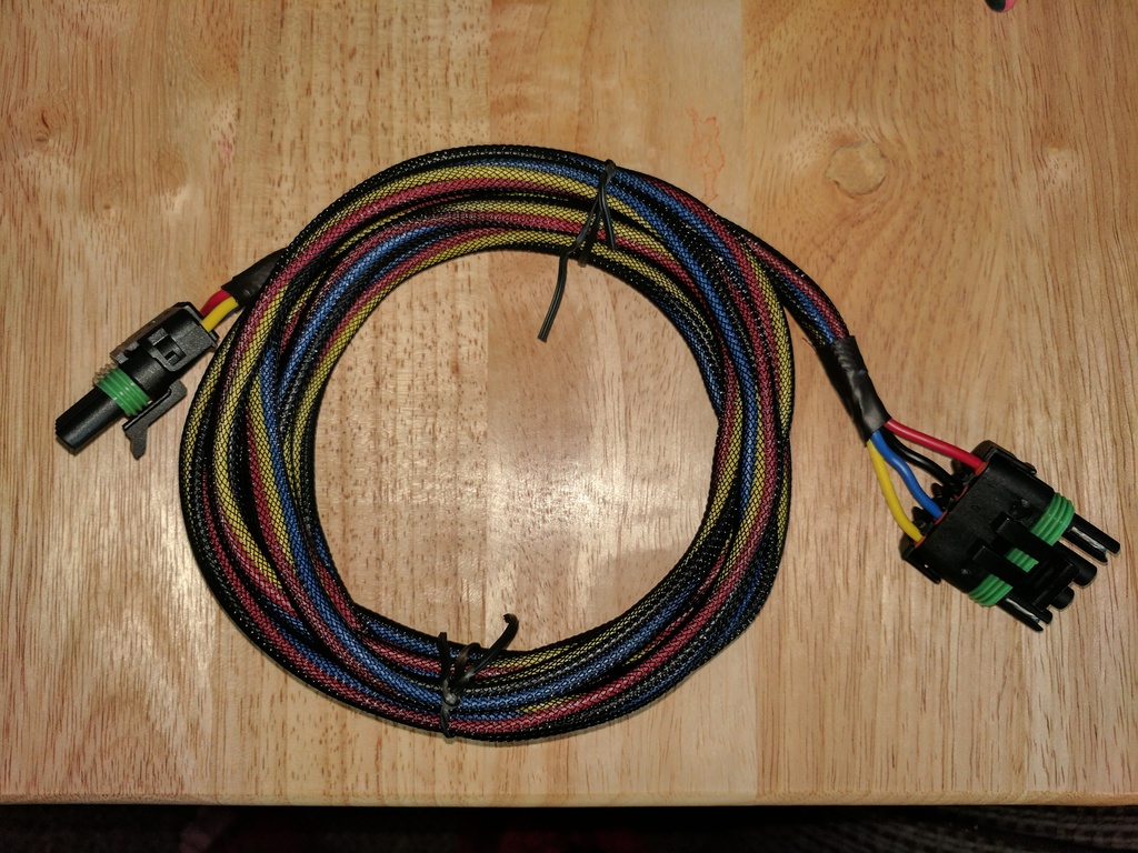

Front harness finished up:

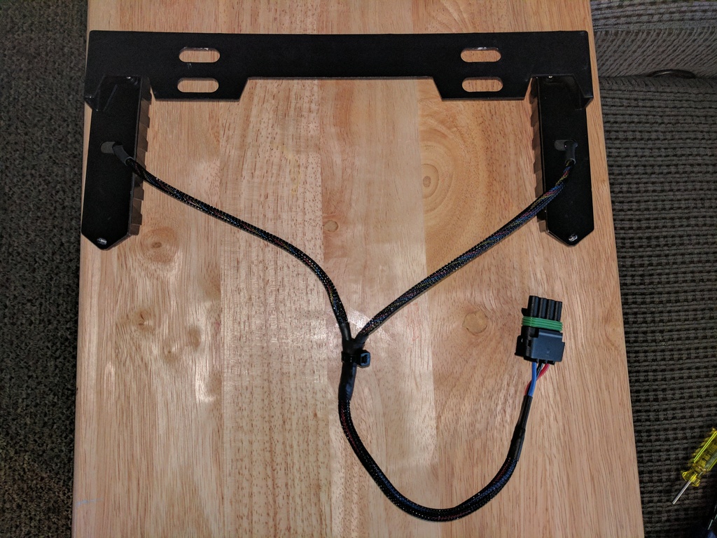

License plate light harness:

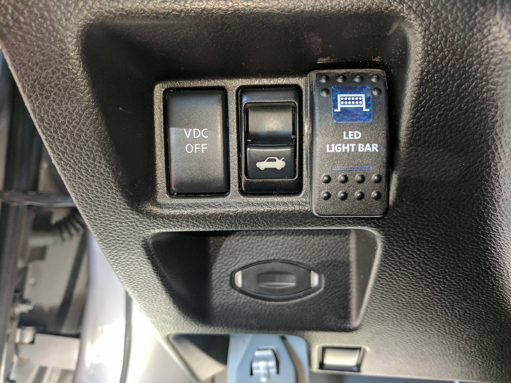

Here's where I put the switch:

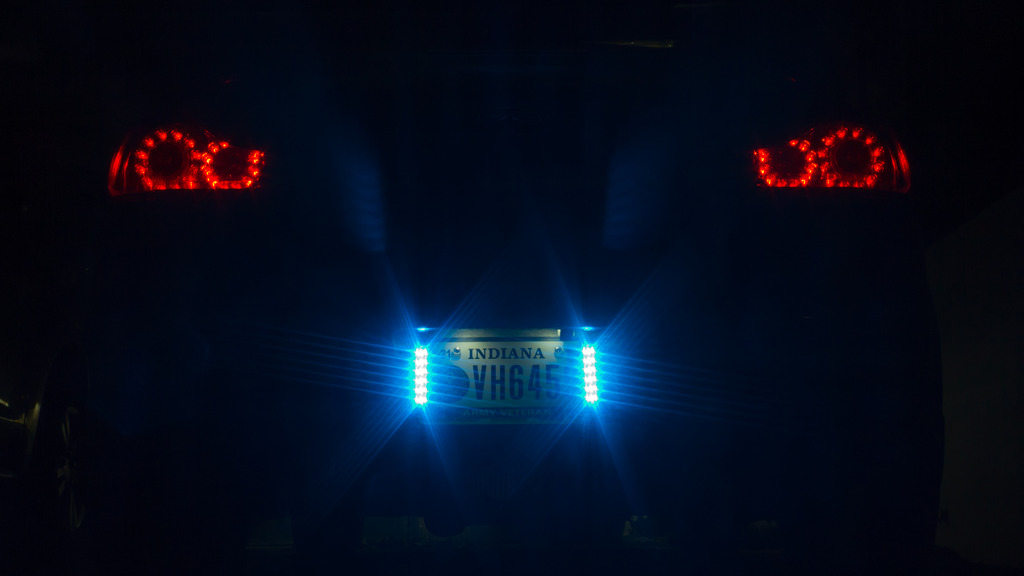

Here's a nice shot of the lights at night. They're stupid bright, I had to dial the exposure way down to get it right:

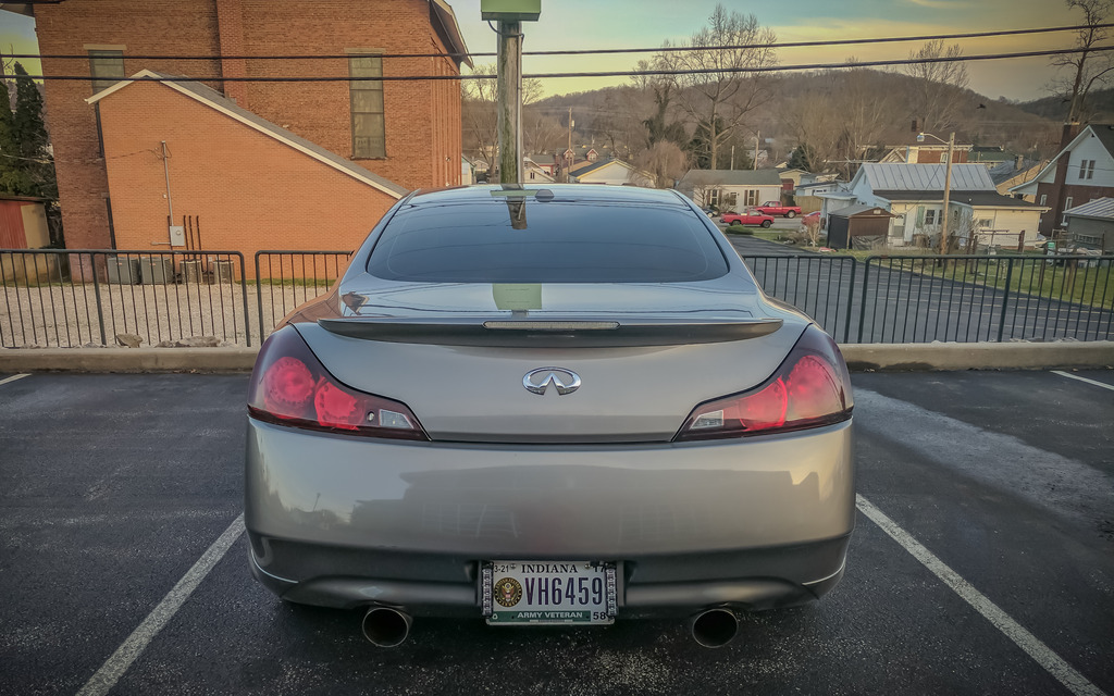

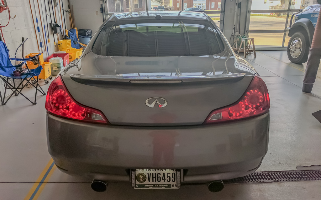

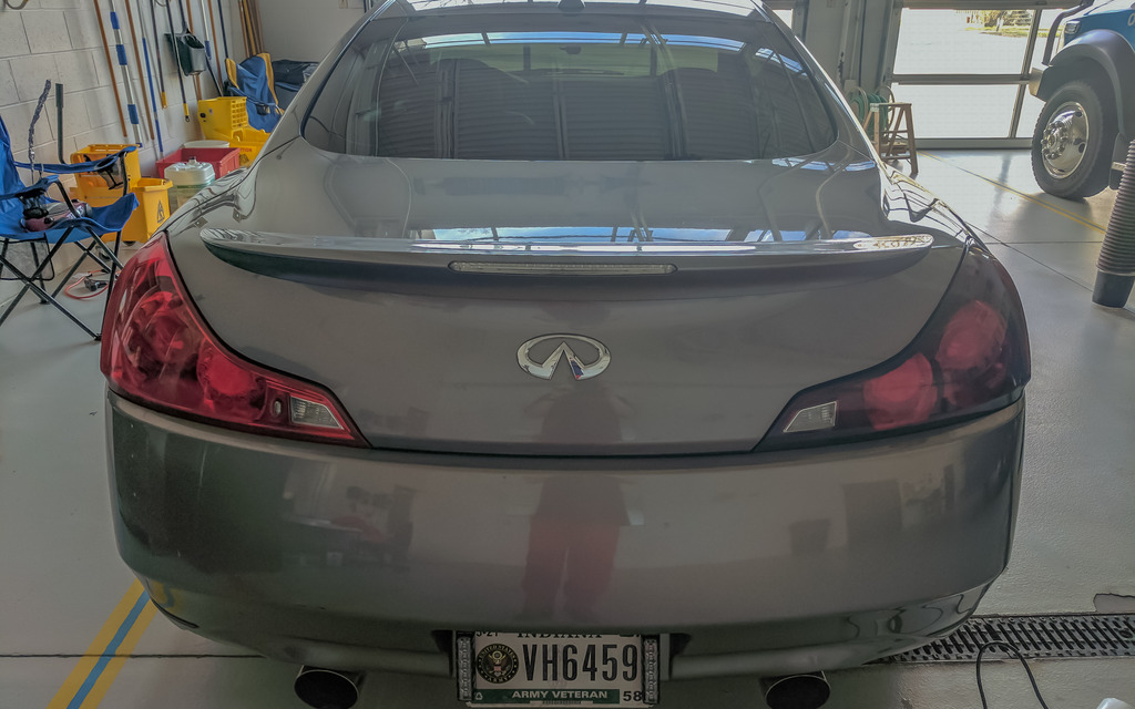

I ordered some of Blue Batmobile's GT-R style tail light overlays the other day, and I put them on today.
Before:

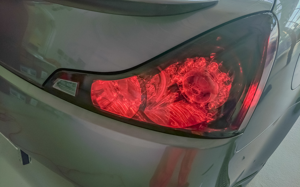

Close up:

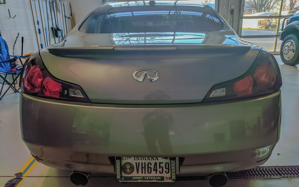

Finished:

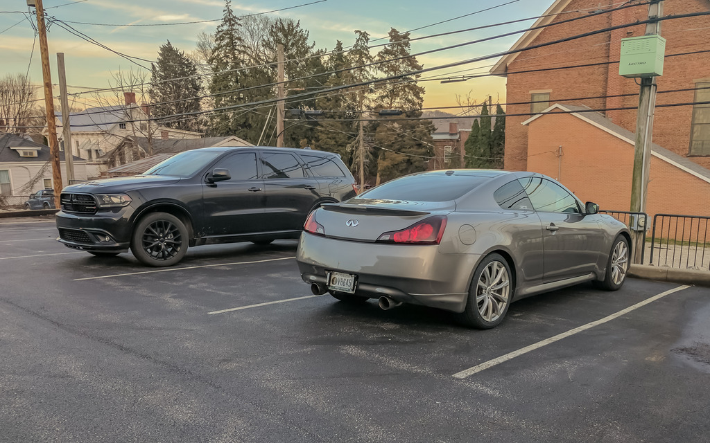

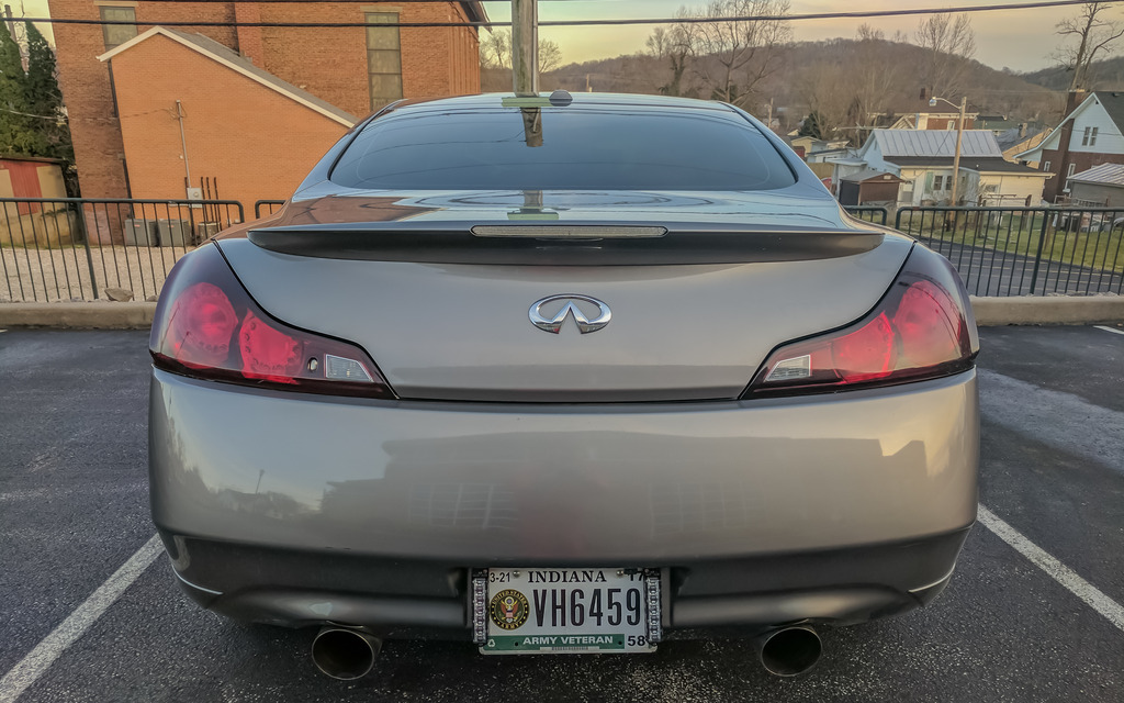

I took it outside in some better light for a few more pics:

Overall they came out OK. I'm definitely no pro when it comes to tinting and wraps, and it shows. These look great from a few feet away, but up close you can see little bubbles and wrinkles. It's not the fault of the material, rather the installer (me). I may just go with it, for now, then either have a new set professionally installed or get a set of tail lights done from OneEighty if they still do them.

Looks great! You can pop any bubbles with a needle and apply pressure. Also, give it a couple days to cure .

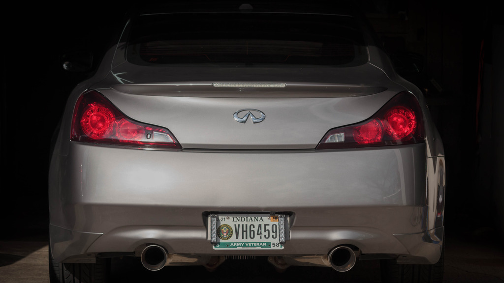

I got a pic of the BlueBatmobile overlays with my DSLR today:
This is how these tail lights should have looked from the factory. Much better!
