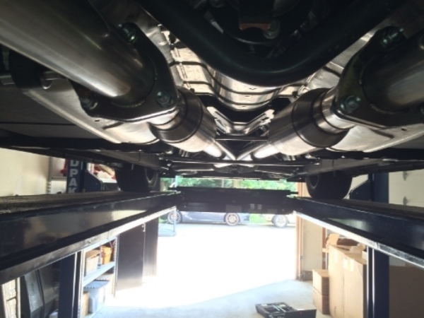

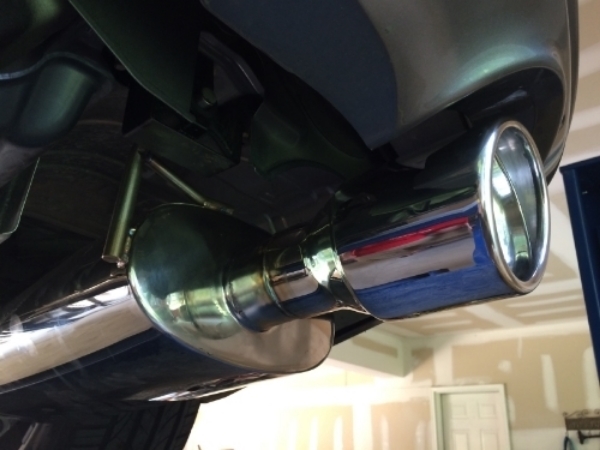

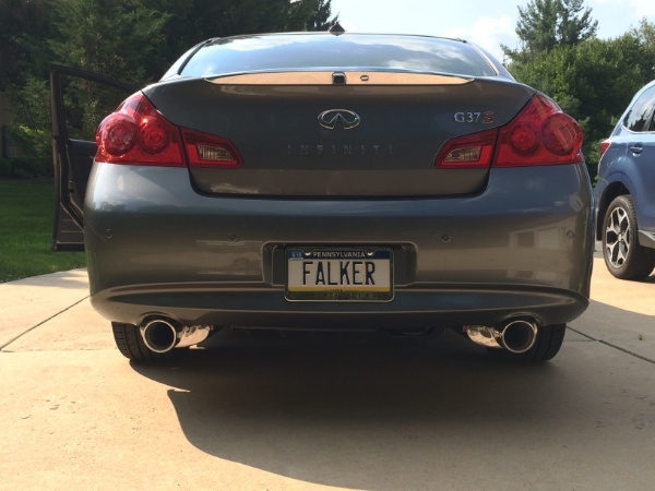

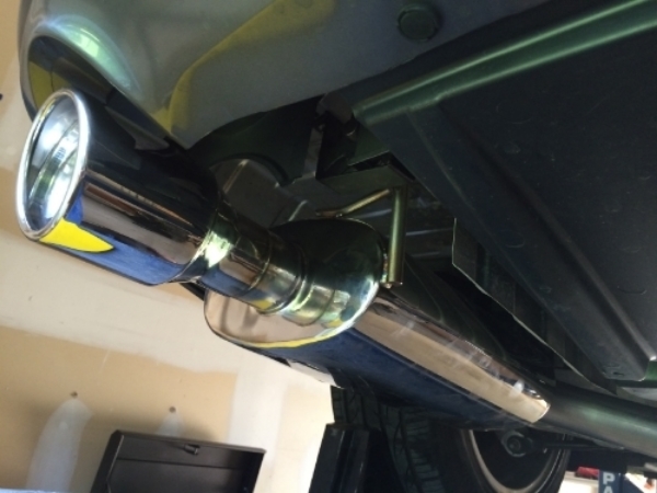

Installed my FI catback with 12 inch resonators on my Sedan this past Sunday.
First things first, drove up onto my buddies’ lift then enjoyed a nice cigar while we let the car cool off.
Install was very straightforward and that’s even with my friend and I being pretty n00bish when it comes to exhaust…he’s done 1 (on his BRZ) and I’ve never done one before. The stock exhaust all came down in one piece. Removing the hangers from stock exhaust was a piece of cake with some WD40. Being up on the lift certainly made things very easy – all the bolts came off with no issues at all.
The FI catback went up: front then mufflers, then X pipe. I used the hardware that was already on the back end of the stock cat because FI didn’t provide a gasket for that connection and I didn’t have replacements. I’ll see if I have any leaks and if I do I’ll replace those gaskets. Then the mufflers went up with utilizing 2 of the 3 stock hangers. Lastly the xpipe bolted up. Everything fit great and torqued everything down front to back. Re-installed my center brace since it did just clear the bottom of the xpipe (more on this later).
Here are some photos of the finished install showing that great FI fitment:

Starting it up for the first time made me giddy. Just the right volume I was looking for. The tone is nice and deep on a cold start and the tone raises up nicely as you rev the engine. Inside the cabin with the windows closed you can definitely hear the difference under load and hard acceleration but at cruising speeds and idle you’d never know it’s aftermarket…very good! There is definitely a drone though under light acceleration in 5th and 6th gear that I’ll have to get used to or adjust my shifting patterns to compensate for.
On my drive home from my friend’s I was definitely smiling the whole way. Everything seemed to be installed correctly and sounded great.
Then I took the car out this morning to get some breakfast. I started noticing a clunking sound…it sounded like it was coming from the passenger side muffler but I wasn’t sure exactly…it’s hard to pinpoint these noises. I parked back at home and worked for the morning, hoping it was just break in from heating/cooling cycles but was pretty doubtful that was the issue. Later in the afternoon when I took my son on some errands I definitely heard it again. It seemed to happen mostly when going over bumps.
Got back up on my friend’s lift tonight and noticed the passenger rearmost muffler hanger had a bit of play to it…the bolts were nice and tight to the frame but the rubber part definitely seemed to move up and down more than the driver side one did. It would move up enough to make contact with the bottom of the car frame when I pushed it hard enough so figured this would be the issue. We uninstalled the hanger and rotated it 180 degrees to see if maybe that would make a difference…It did make the hanger have less movement upward so thought this would probably solve the issue…drove around but still heard the clunking.
Then my friend suggested removing the center brace…So I did and voila! No more clunking! I was pretty surprised this was the issue for a couple reasons. 1- it did fit under the xpipe without touching it. And when I tried to move the pipes up and down it did not appear to make contact with the brace. 2-FI install instructions say you don’t need to remove it unless you have the 2.5” piping.
Anyway this seems to have fixed the issue so I am just running without that brace for now. I did reinstall the bolts since they hold some sort of metal shield to the underside of the frame. Thinking about buying some spacers of some kind, maybe washers to move the brace down a little bit. Anyone know the purpose of this brace and if it’s worth it to figure out a way to reinstall it?
Anyway thanks for sticking with me through the long-winded review. I am ecstatic with this exhaust now that I am clunk free! I’ll do a follow up review in time once it’s been broken in and on the car for a bit.

Excellent post, Falker. FI always gets reviews like this, and for good reason.
That cross-member might look flimsy and pointless, but sometimes it doesn't take much material to provide adequate bracing. With the bolts loose, my mechanic bent that bar (by literally hanging from it) then tightened it back up with a pair of SS washers between the bracket and frame. It doesn't bang or hit AFAIK, although I wouldn't be surprised if it's really, really close. My pipes are 2.5".
I think you should put it back on.
