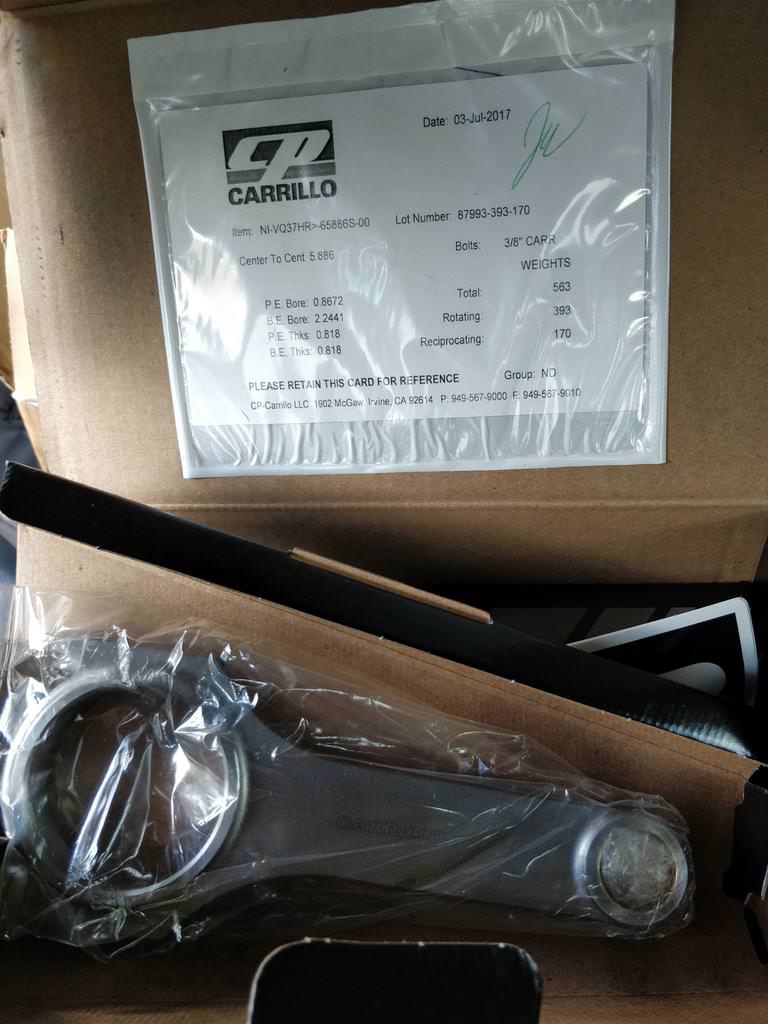

Rods

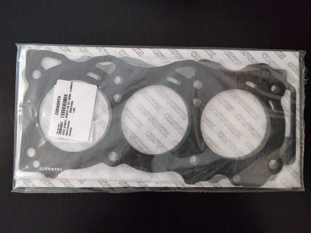

Head Gaskets

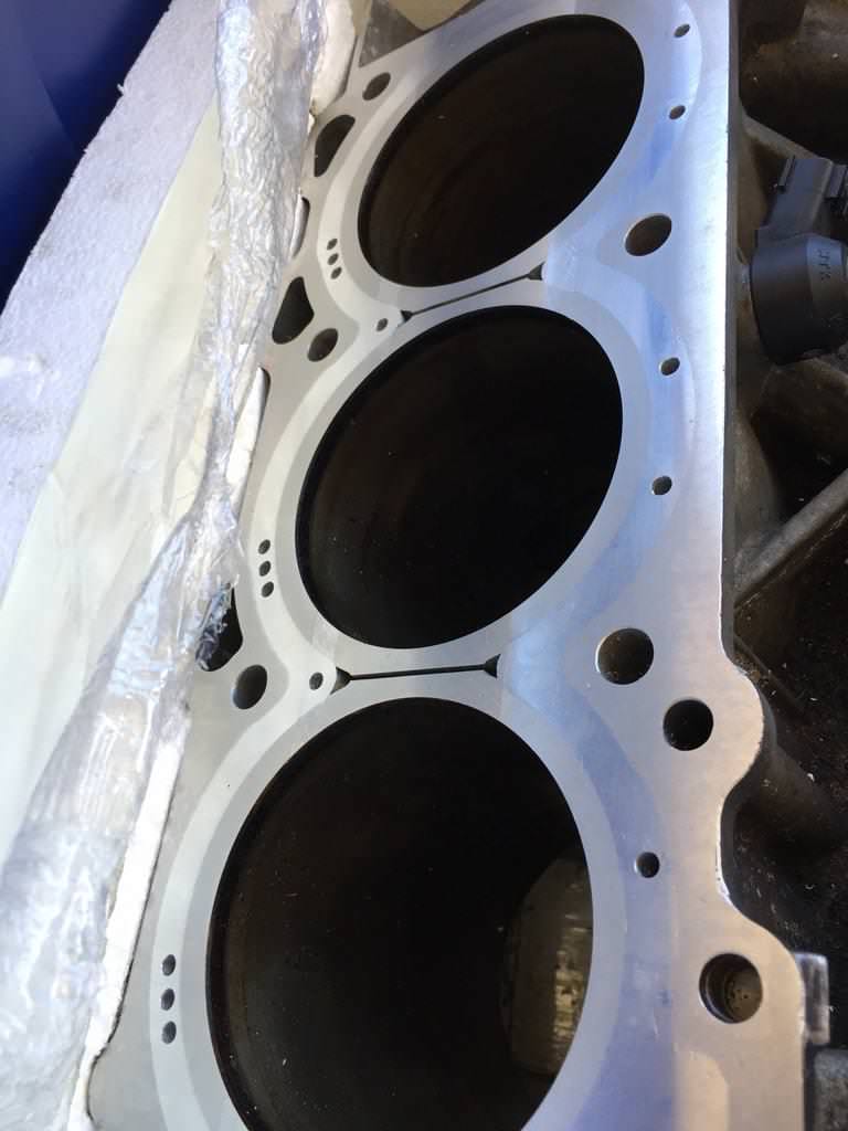

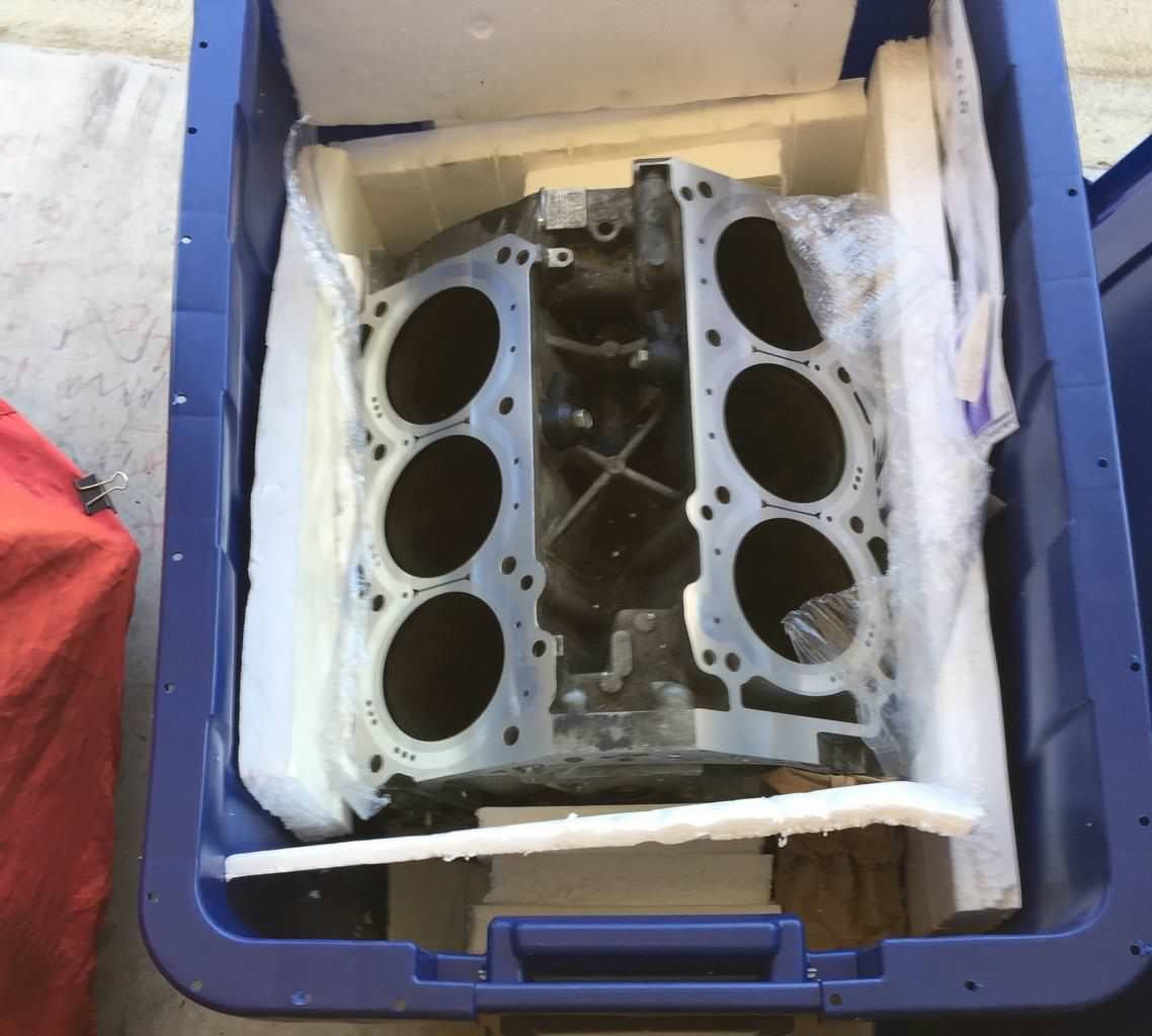

RJ Manufacturing Closed Deck is in, will probably start building this outside the car and do the swap sometime later this year.

Ok...so I've not done a lot of research on closed vs. open deck with this particular engine design. Are there any drawbacks to a closed deck block driven on the street? Do they run hotter?
Assuming RJM presses a machined insert into a stock block, correct? And the main reason is it keeps the bores more stable in the block?
Rods/pistons...are you able to keep the weight the same as the stock components or lighter? Speaking of which, what pistons are you running? What are the specs on those?
Cams. Why Tomei over JWT's cams?
Any porting happening to the heads? How bout crank work other than rebalancing? Is any additional work even necessary on our cranks? I've never looked at one in person.
Apologies for all the questions, just really curious about the thought process and component selection.
On the street I highly doubt temperature differences will be noticed. I do wonder how it will perform on the track after a few hotlap sessions, but I feel that the benefit of the design will outweigh any temperature concerns. I guess I will be a guinea pig as I have yet to see any of these closed deck blocks running in that scenario. I was told that Forsberg is running a block guard, but for this season it is not an RJM product. However, it seems like he most likely will be running one next season.
Yeah from what I understand the block and deck are machined and the block guard is pressed in, but for IP reasons they do not disclose the exact methods used in the process. Yes the theory is to keep the sleeves stable at the top, afaik the major difference between VQ HR/VHR blocks and VR38 blocks is that they are closed deck from the factory and those blocks are holding 1500+ with no modifications.
I don't know about the weight differences between the Carrillo rods and the stock rods. The main aspect of switching to forged internals would be for strength, but usually forged materials also weigh less as well. As far as the pistons I would be reusing my Arias 10.5:1 HR pistons.

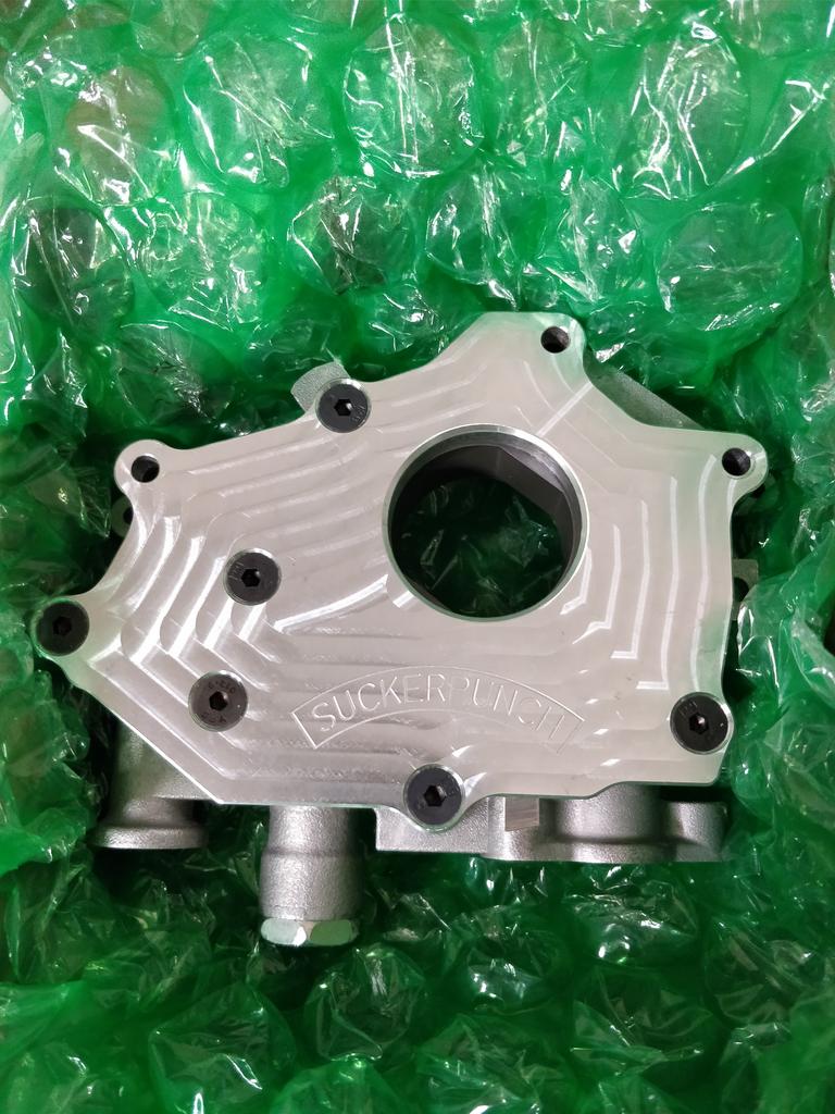

That means this is one of the final pieces of the puzzle - a Suckerpunch Motorsports Oil Pump! This combined with the Tomei cams and ATI Super Damper should allow me to safely raise the redline to 8500rpm and possibly even 9000rpm (if we are daring enough to try).
The only thing I'm waiting on now is for a new set of custom pistons which have been ordered and should be 3-4 weeks out, after which the rebuild will begin.
