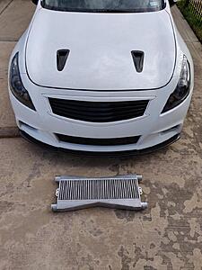

Originally Posted by ttv36

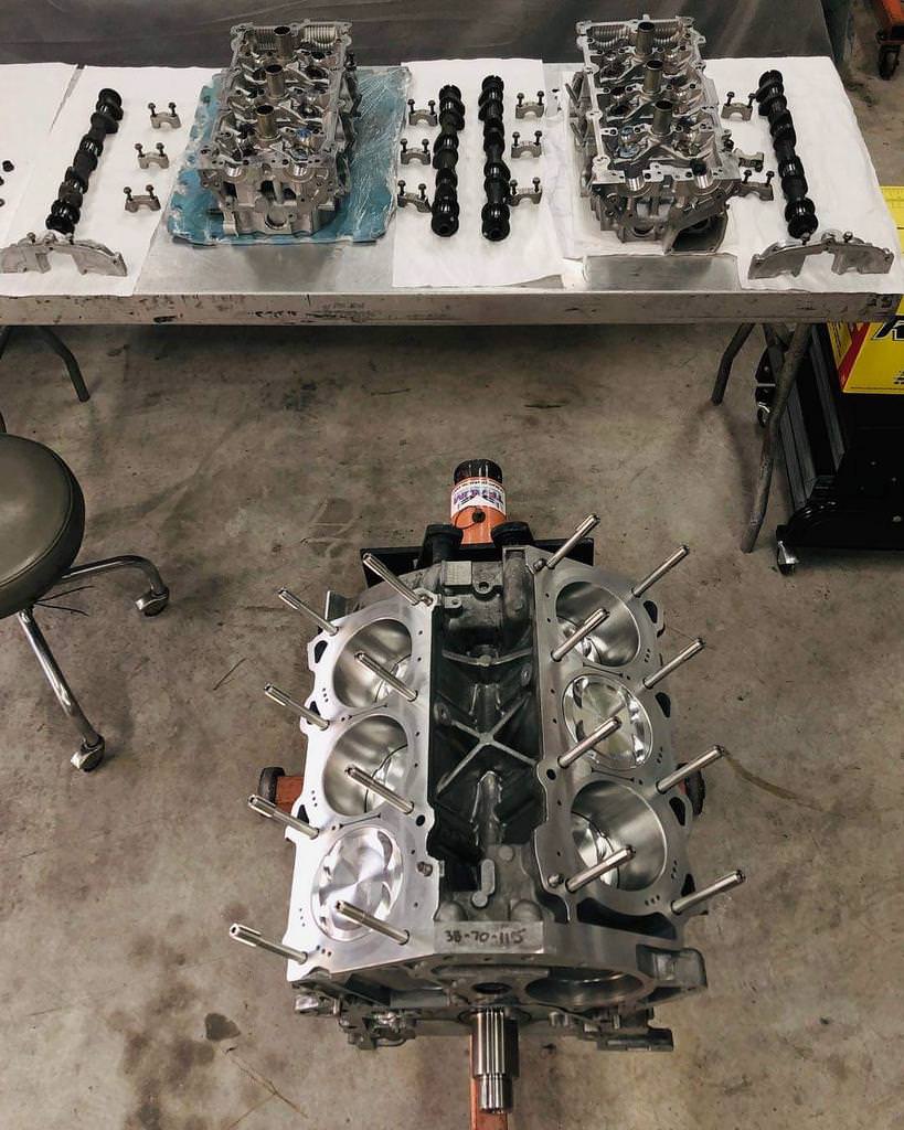

Bump, still not running more info on socials right now, I'll come back to the forum when I have time to sit down and write
Here's some 11:1 compression for you

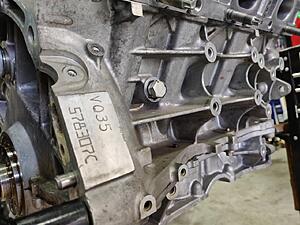

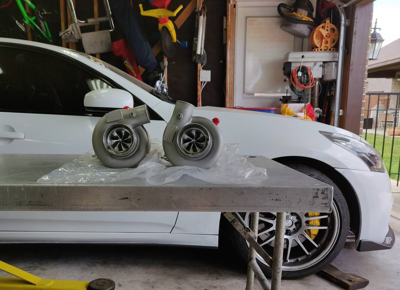

Fast Intentions Stage 3 Xona XR 65•64

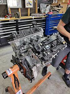

November 2018:

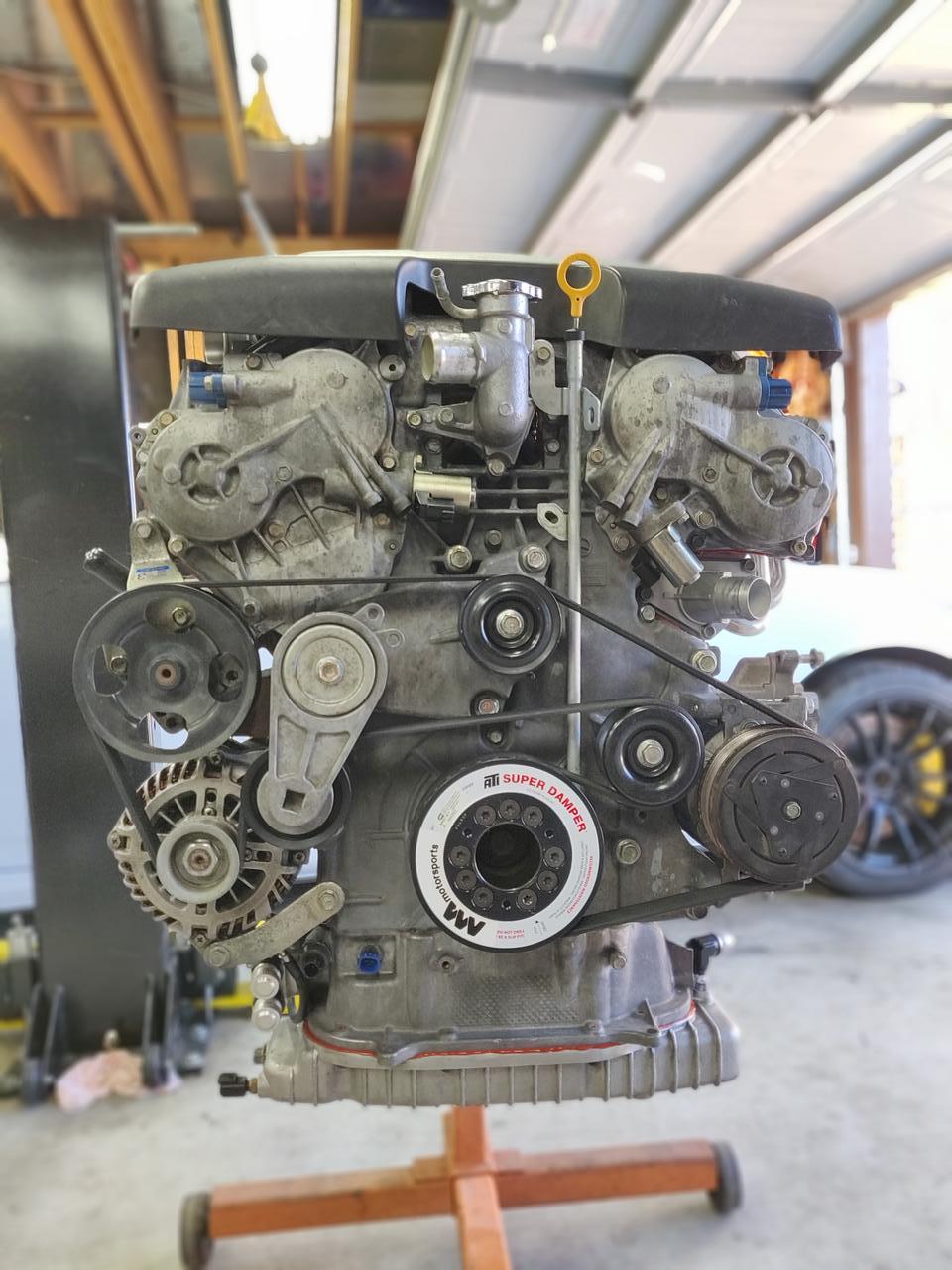

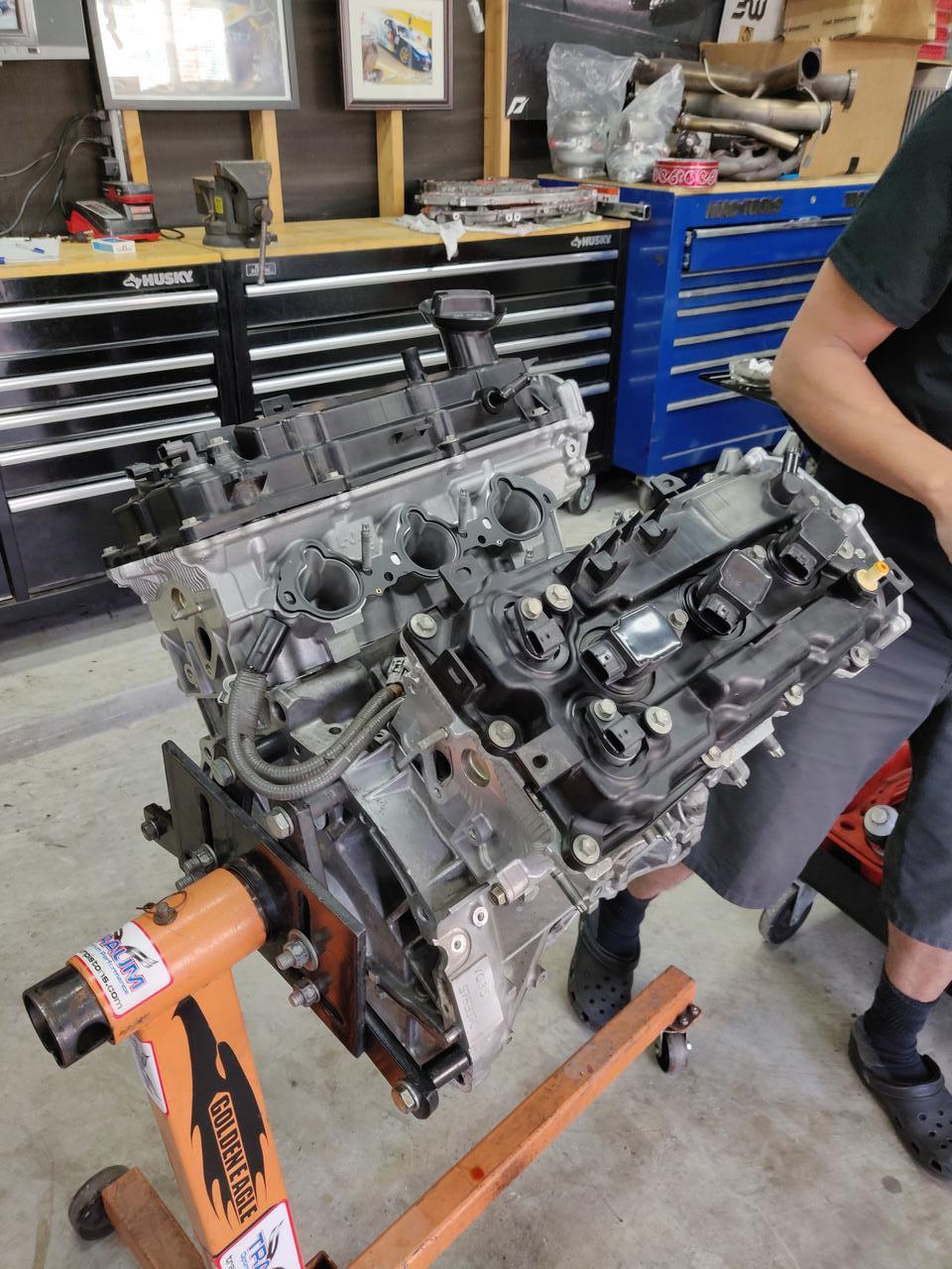

The main goal was to get the motor assembled and sealed up.

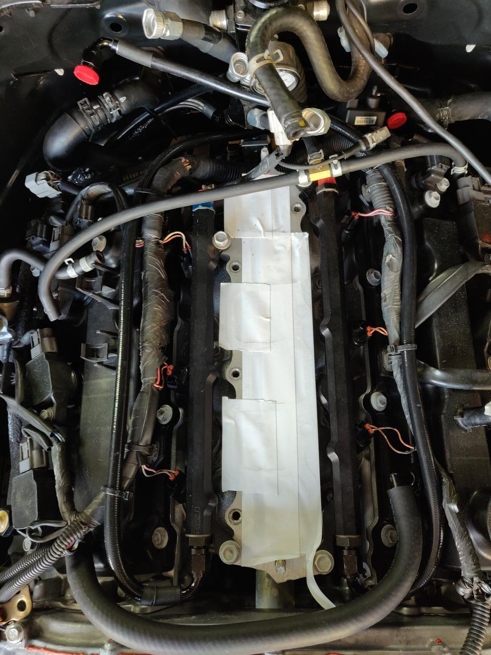

Heads, plugs, etc
Dynosty Head Gaskets

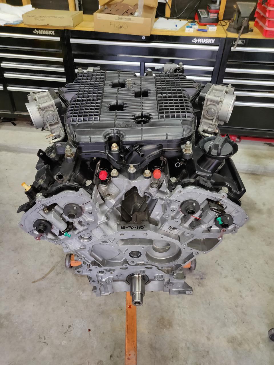

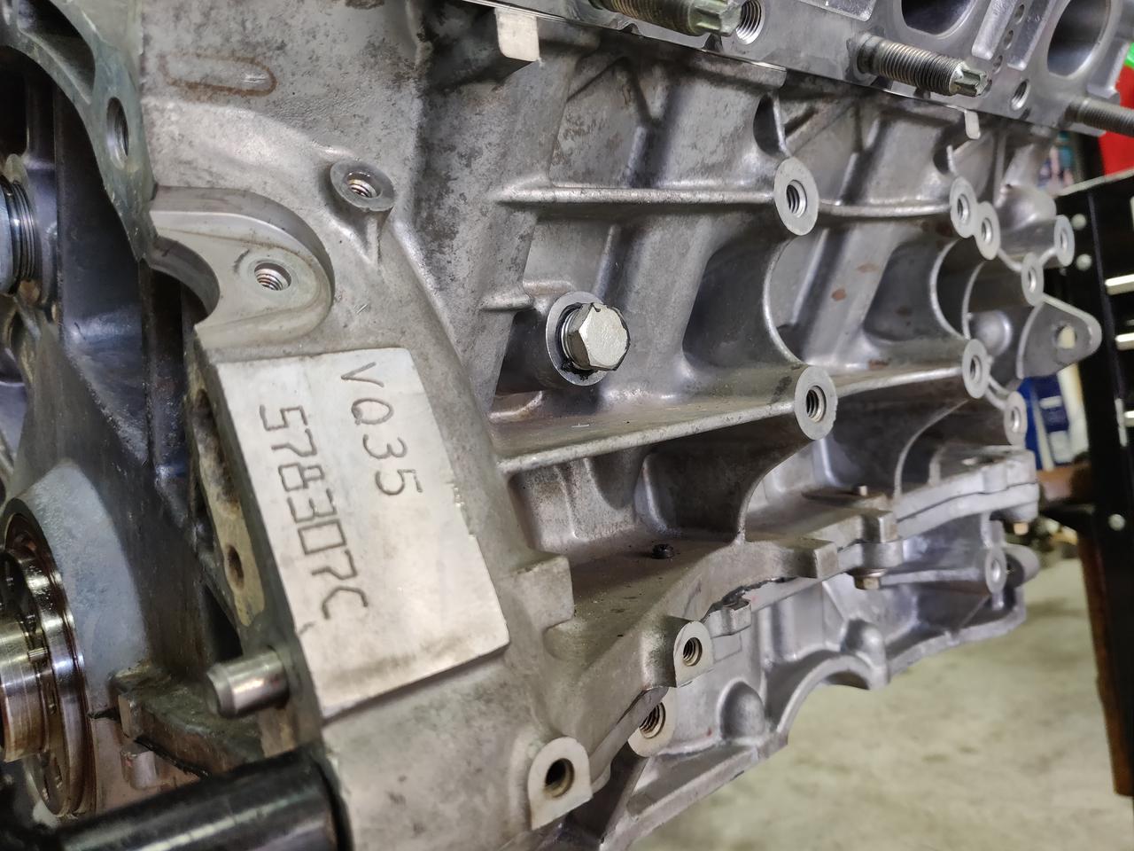

Just a "VQ35"

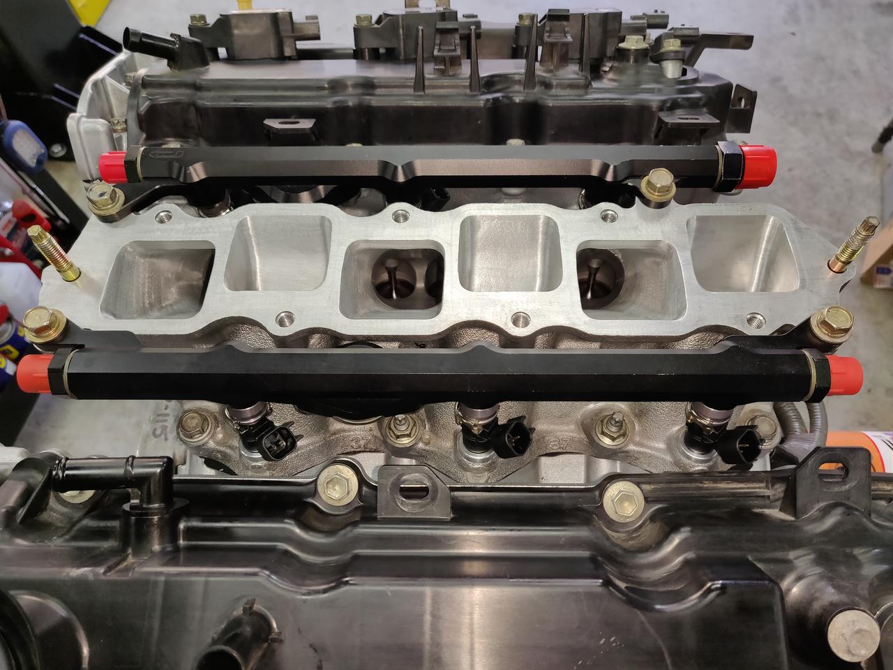

CJM VQ37 FPD Rails, Synolimit Ported VHR Lower Intake Manifold
Synolimit Ported VHR Upper Intake Manifold & 63mm Ported TBs

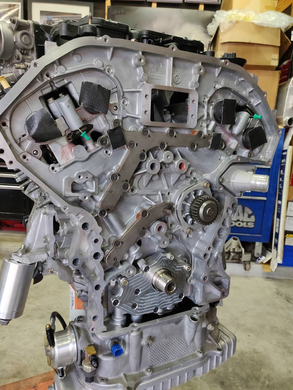

Suckerpunch Motorsports Oil Pump, EPS Oil Gallery Gaskets, Greddy Oil Pan, Fast Intentions Oil Filter Relocation

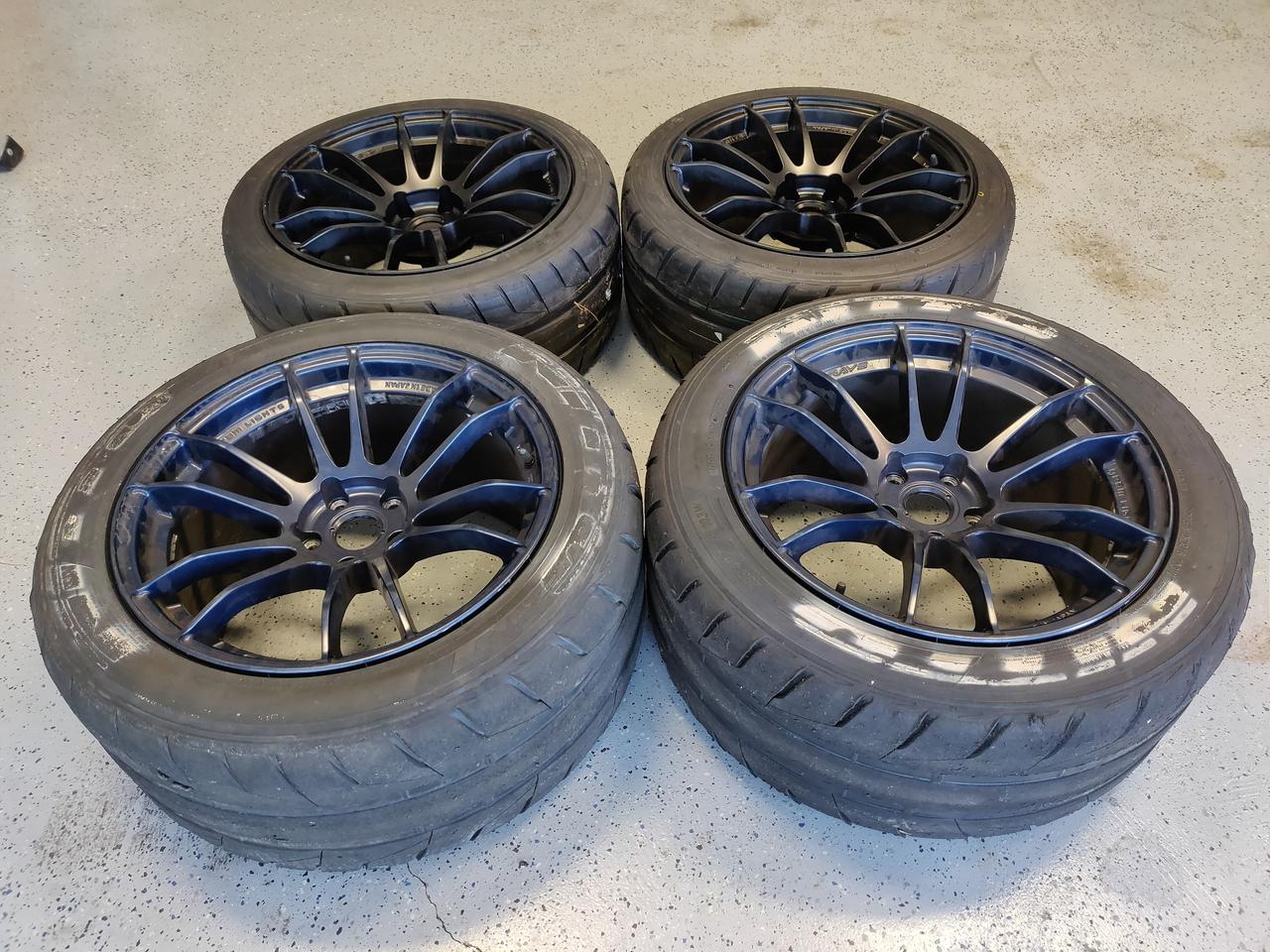

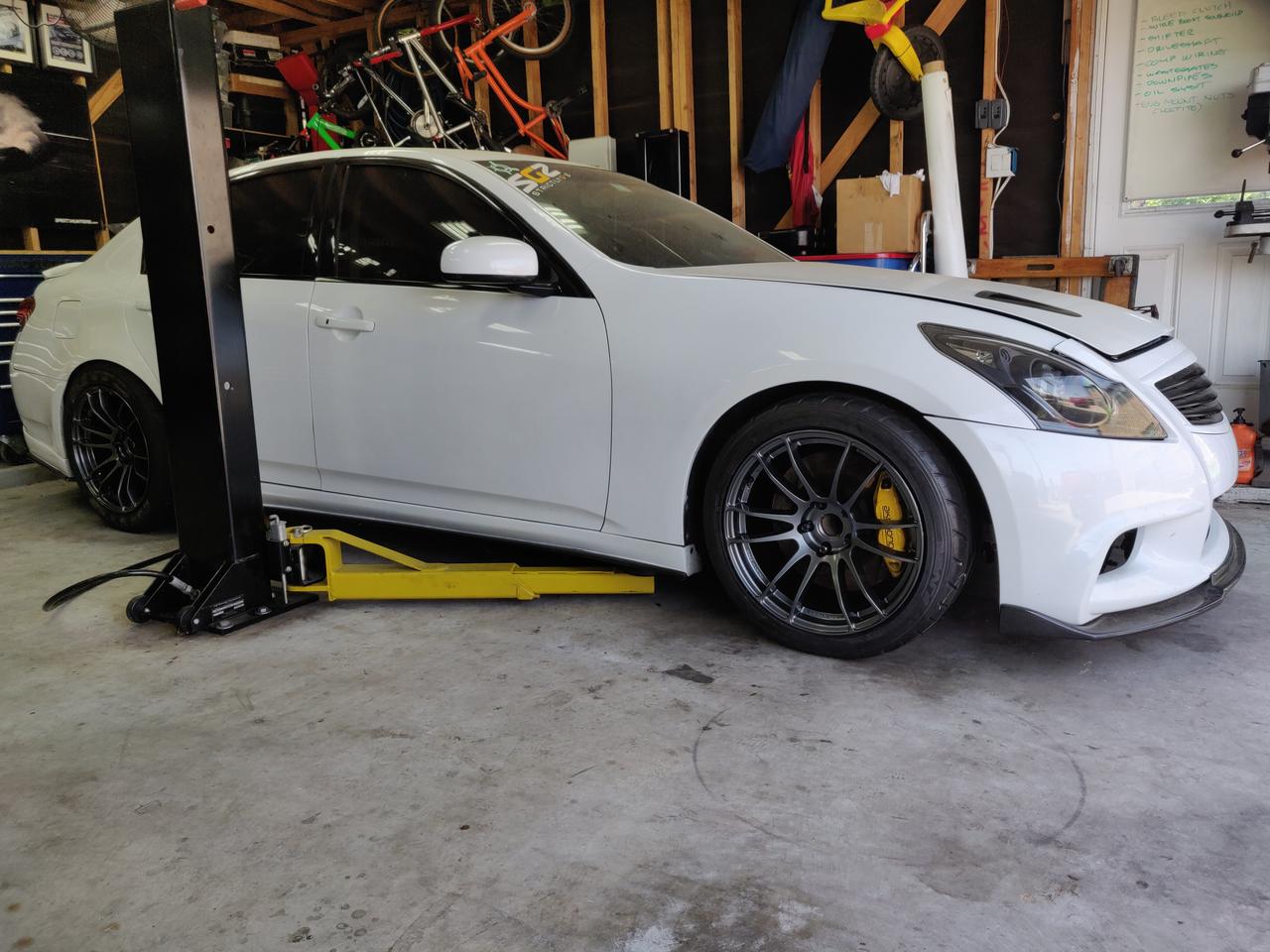

Sold the my 19" RE30s and got another pair of 18s to step down on all corners. I couldn't find winning blue to match the rear so I'll have to fix the color issue..
Gram Lights 57xtreme 275/35/18x9.5 +22f and 295/40/18x10.5 +40r

ATI Super Damper

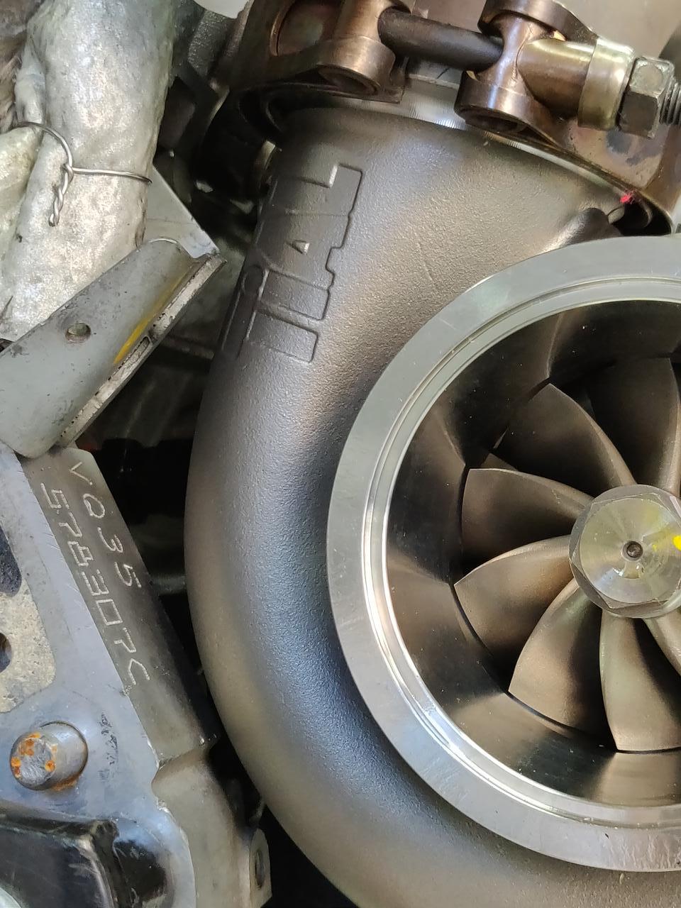

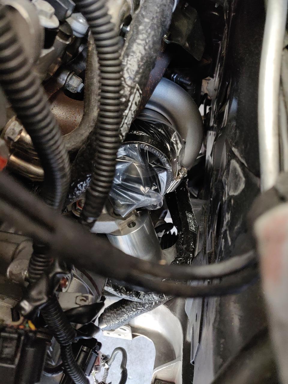

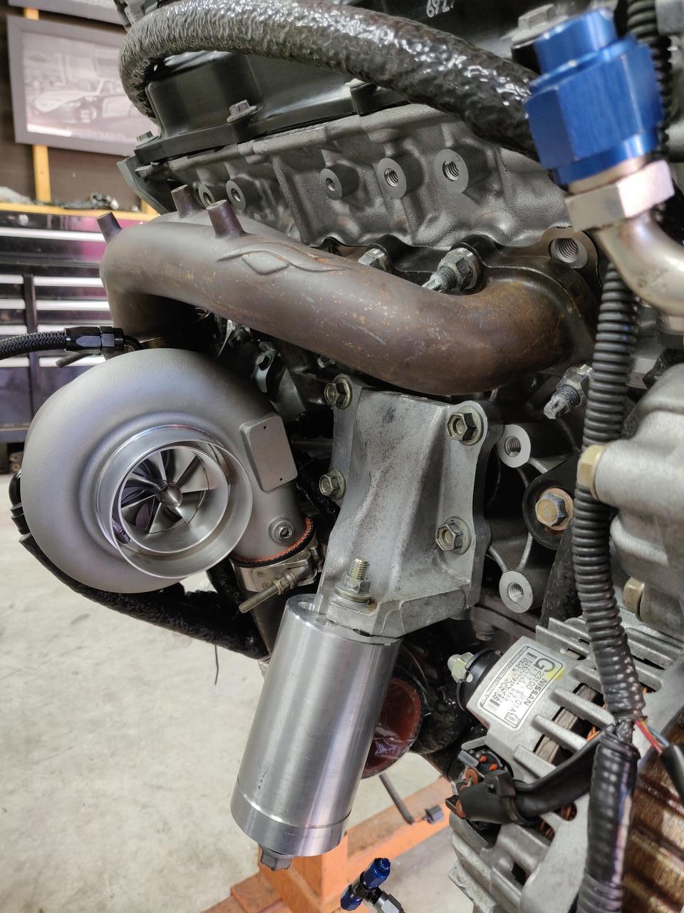

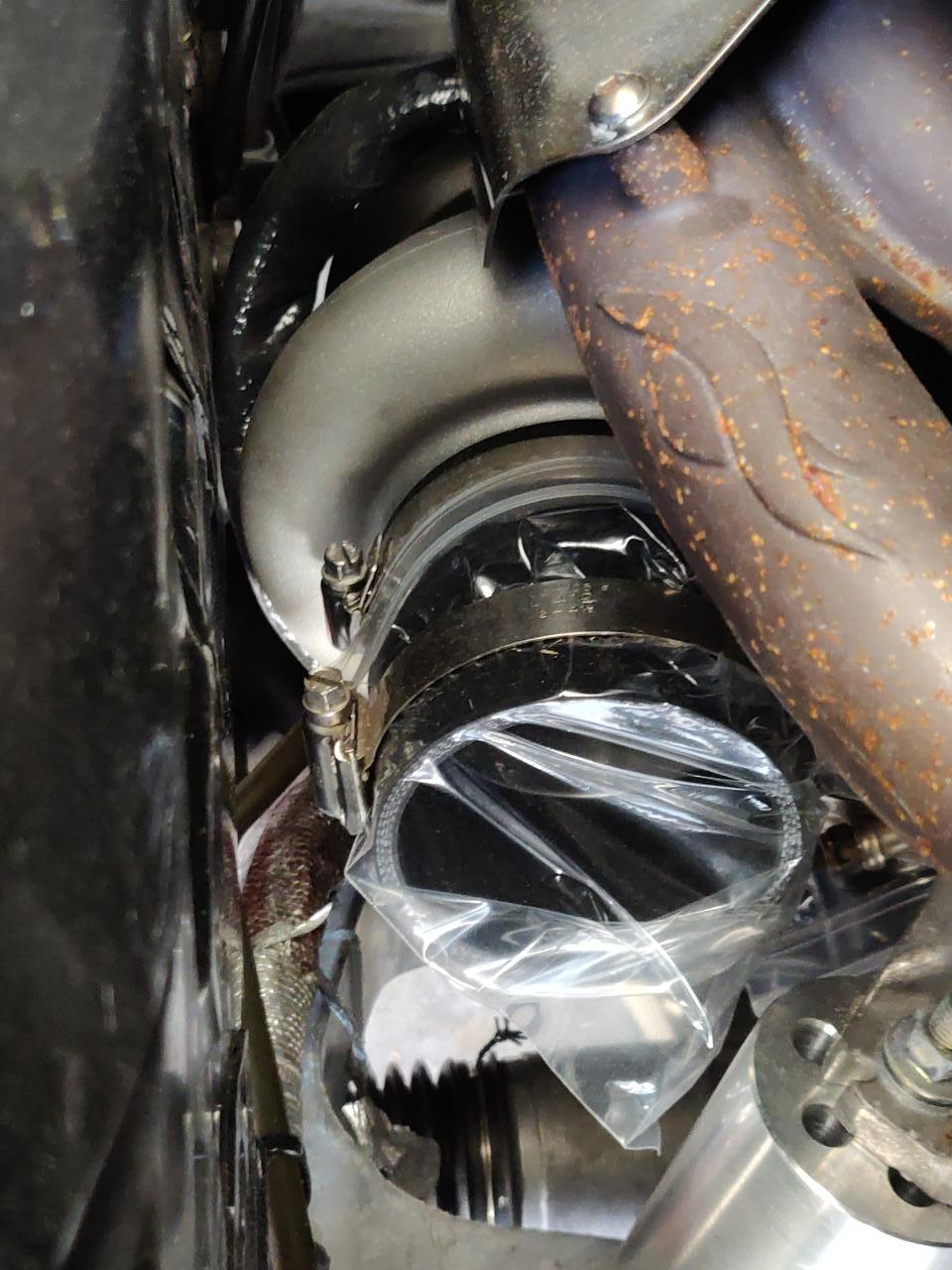

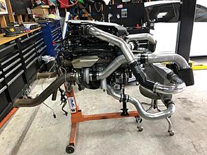

Fast Intentions Stage 3 - Xonarotor XR 65•64
Backside clearance over that "VQ35"

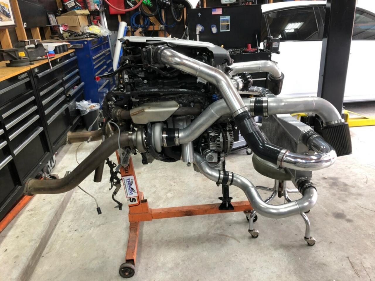

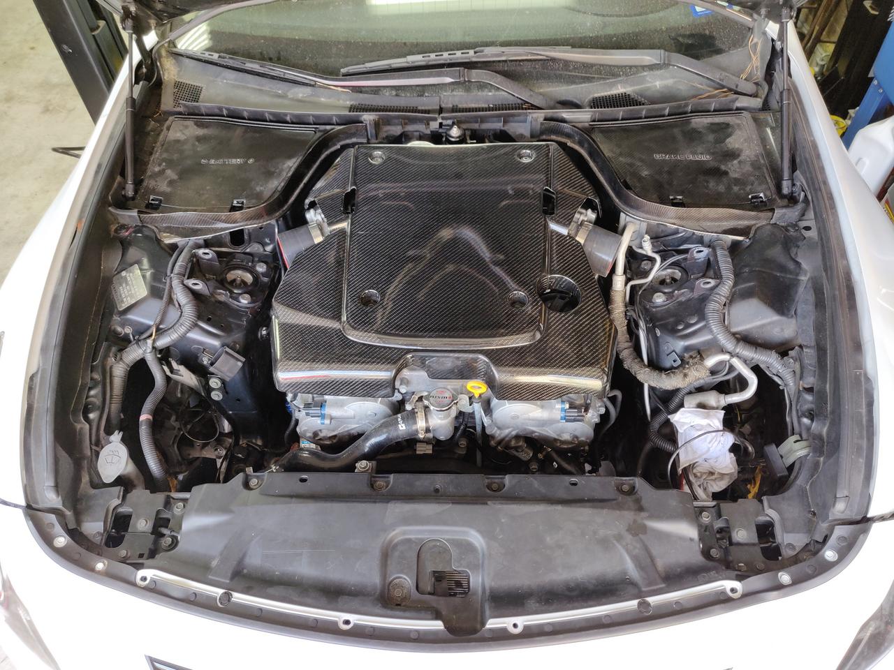

February 2019:

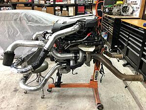

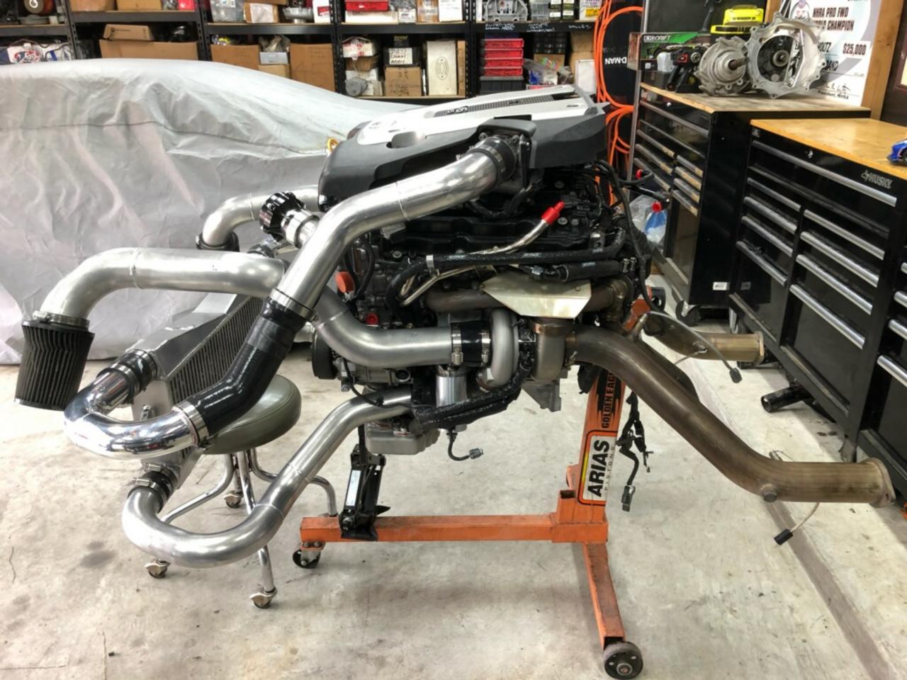

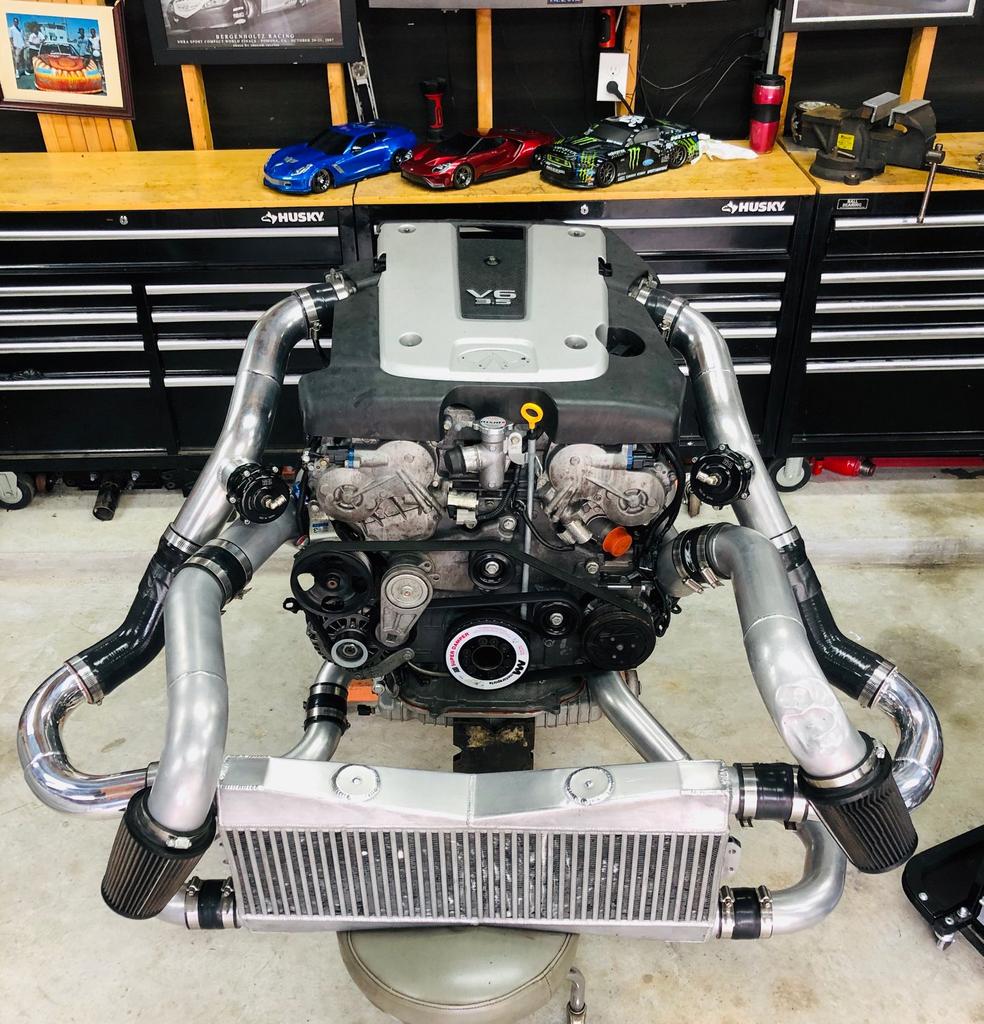

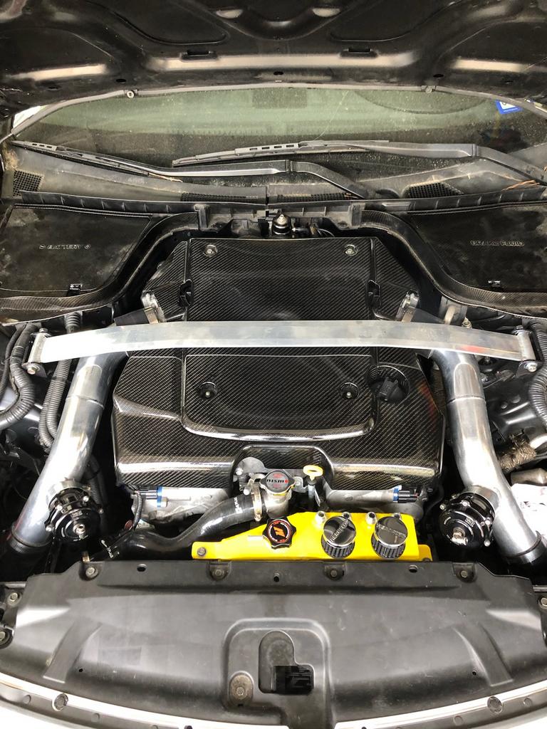

Finished all the lines and "mocked" up the pipes

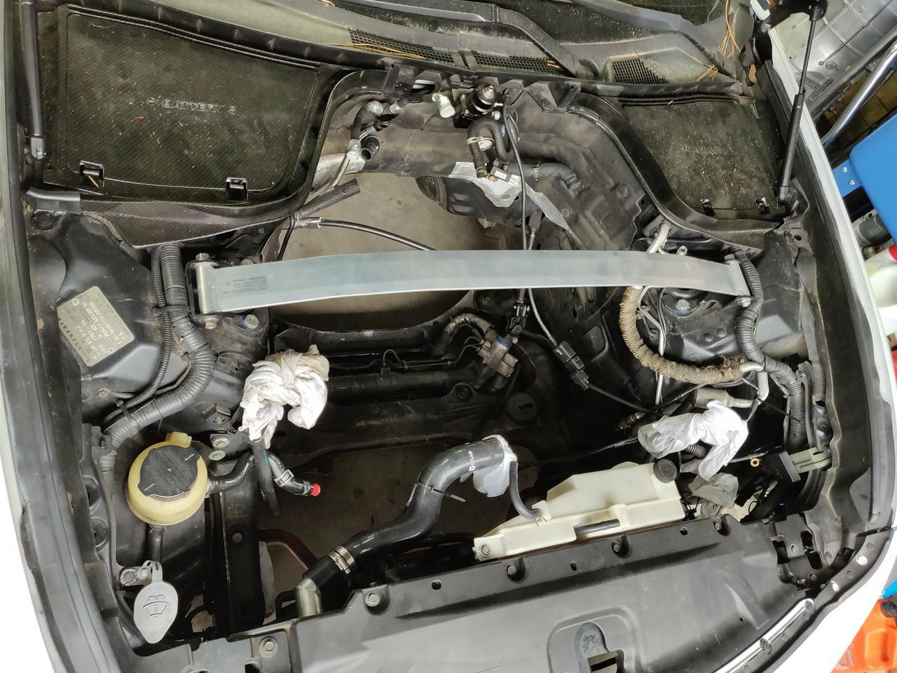

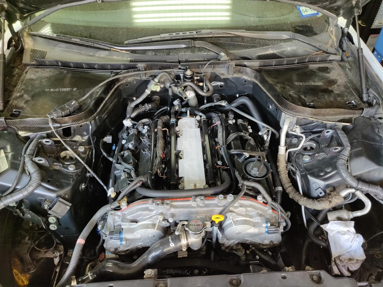

We need clean up the years of neglect and cobwebs...

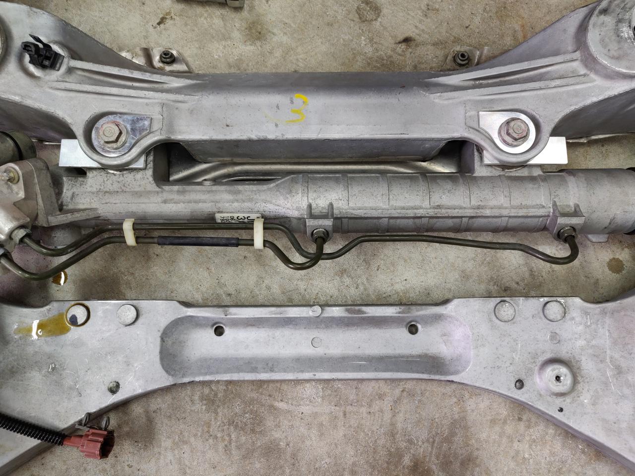

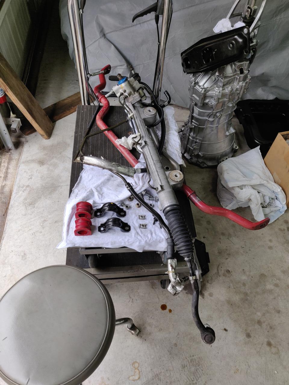

Fast Intentions Steering Rack Spacers - the detail to the design of their kit is amazing!

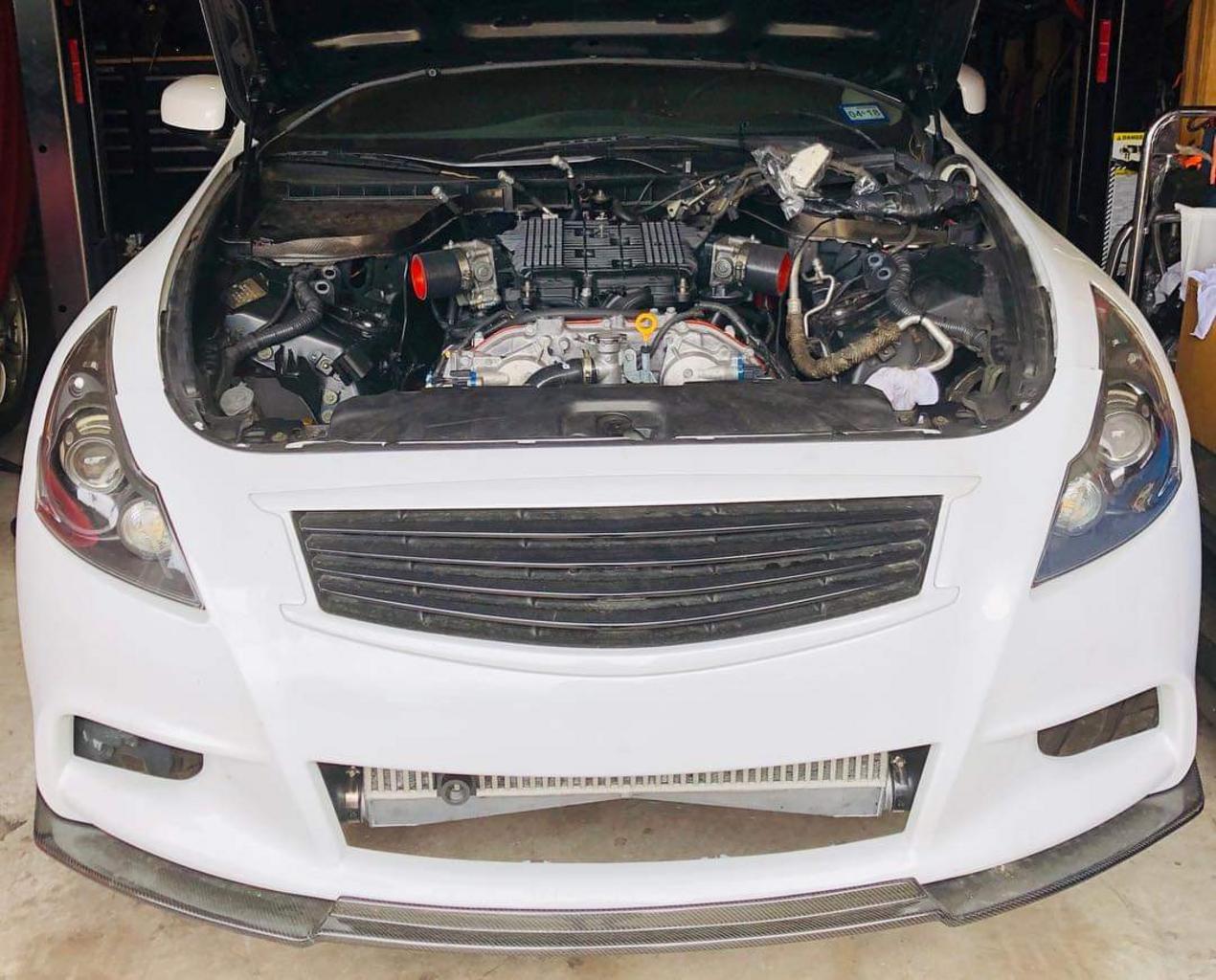

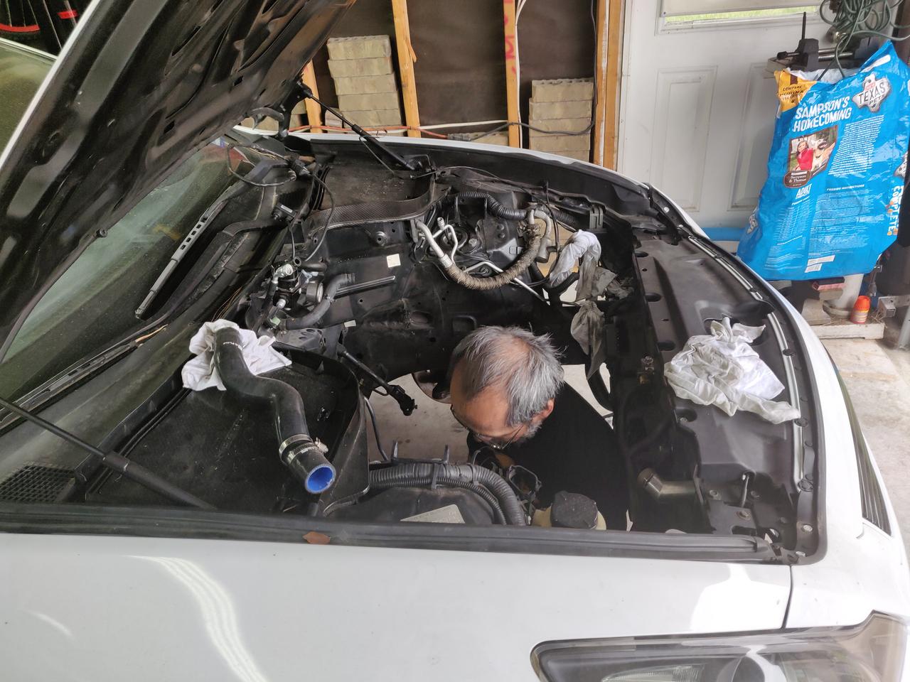

I guess you can say we dropped the car onto the motor instead of "dropped the motor in"
Home is where the heart lies

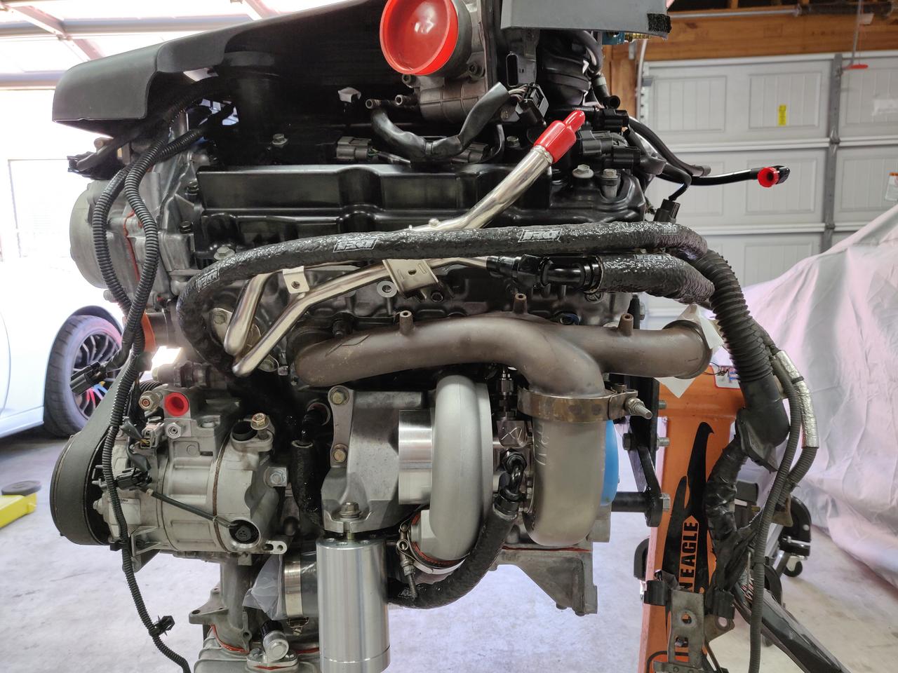

I love the Fast Intentions manifold, look how much clearance there is with these big ol turbskies (they are equivalent to GT35Rs)
My AAM TT kit did not have this good of clearance and it had smaller turbos

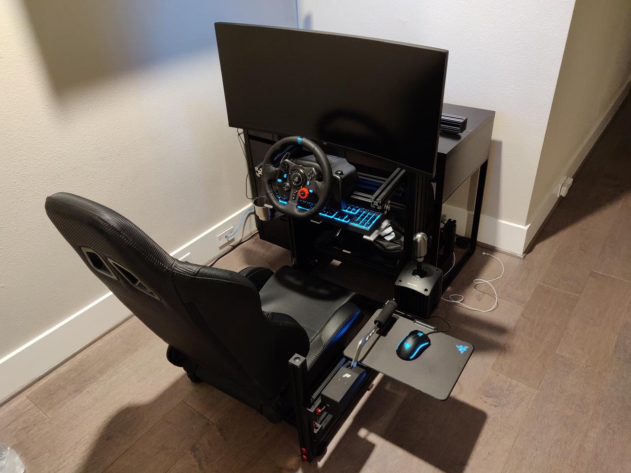

But, the actual car was taking too long to rebuild so I decided to build a car simulator to get my seat time in instead.
And trust me, I really need the seat time..

Since you don't want to.. The cost for the 4Play platform, Fanatec gear, NRG seat, etc so far was ~$3500. That's not including the cost of the PC to run everything on - I upgraded that last year to prep for the simulator build. I'm currently using a Logitech G29 wheel temporarily while I wait for my DD1 to be shipped. Even though I'm using a "lesser" wheel right now driving the simulator is fun as hell!
Pretty much everyone I've spoken to has said the experience directly correlates, a friend who competes in Lone Star Drift calculated out the cost of taking his drift car, tires, brakes, etc + maintenance of running a fairly local track for 5-6 hours and estimated it would cost him $2-3k for a day. At the very least the simulator definitely helps the thirst for speed and hopefully it will help me stay on the course when I take my G to the track again IRL..
My work had one of these laying around so I'm going to try VR out this weekend.

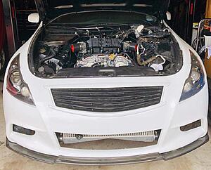

Time is flying by so fast I don't even know where it's gone! I guess I'll just start summarizing through the months of the project at this point.
May 2019:

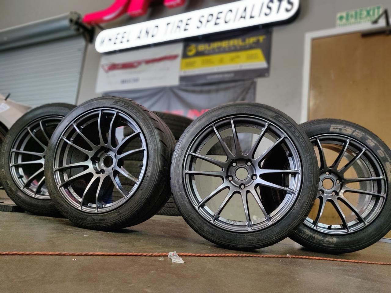

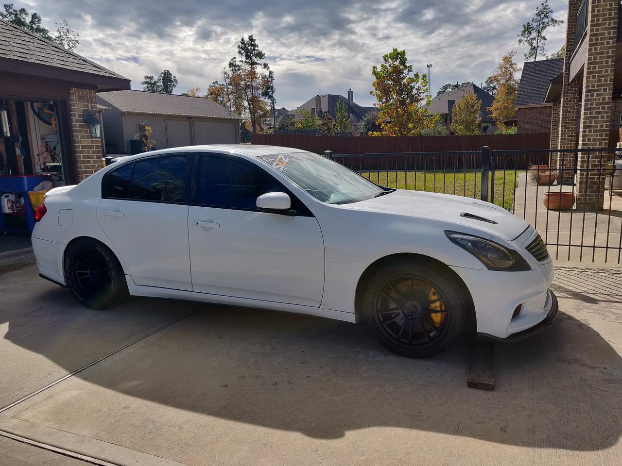

It's been a minute since I got the wheels, but black and blue mismatched wheels was not making me want to look at the car very much.

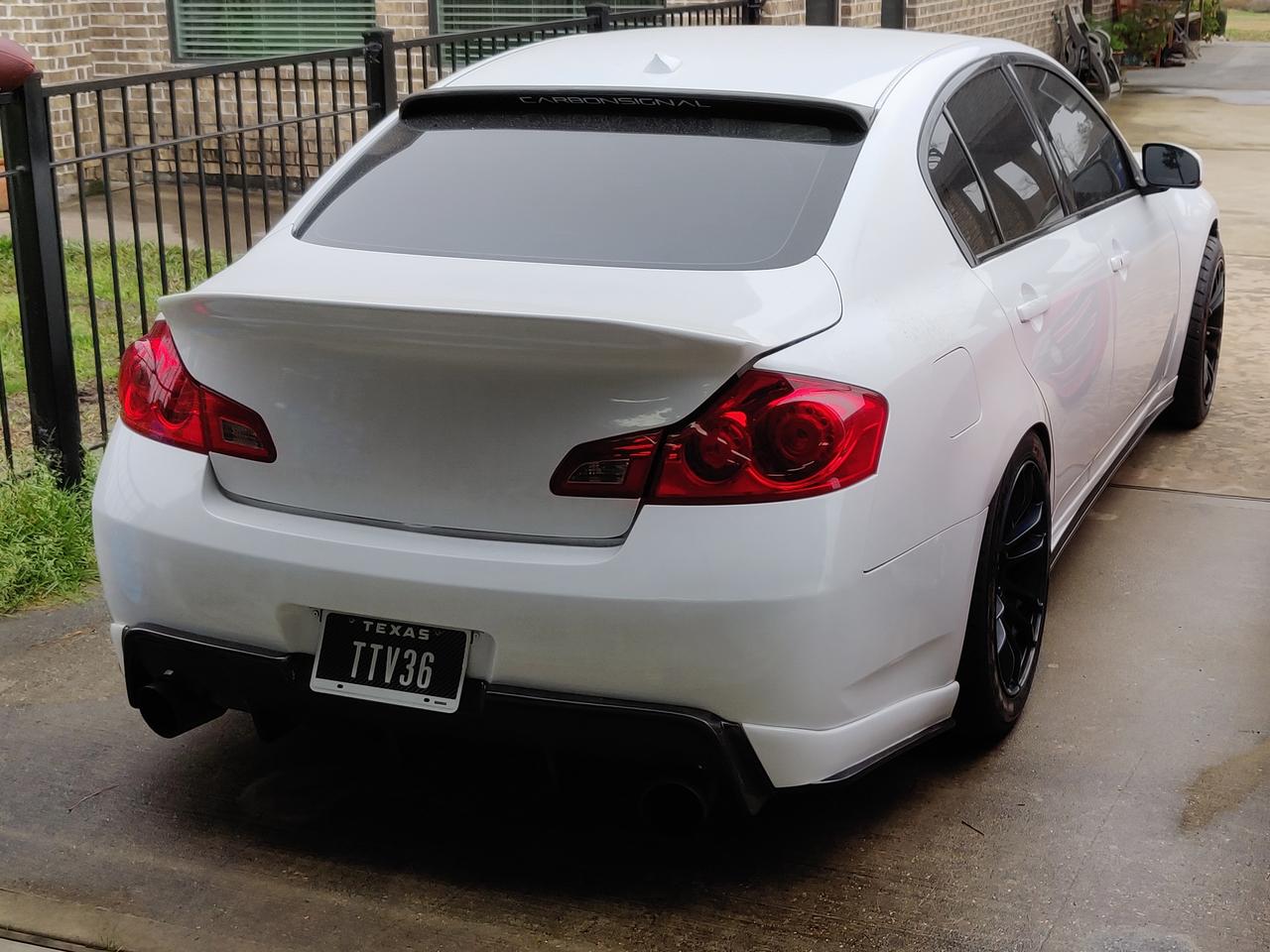

JACE Auto took care of the problem for me:
Now the looks:

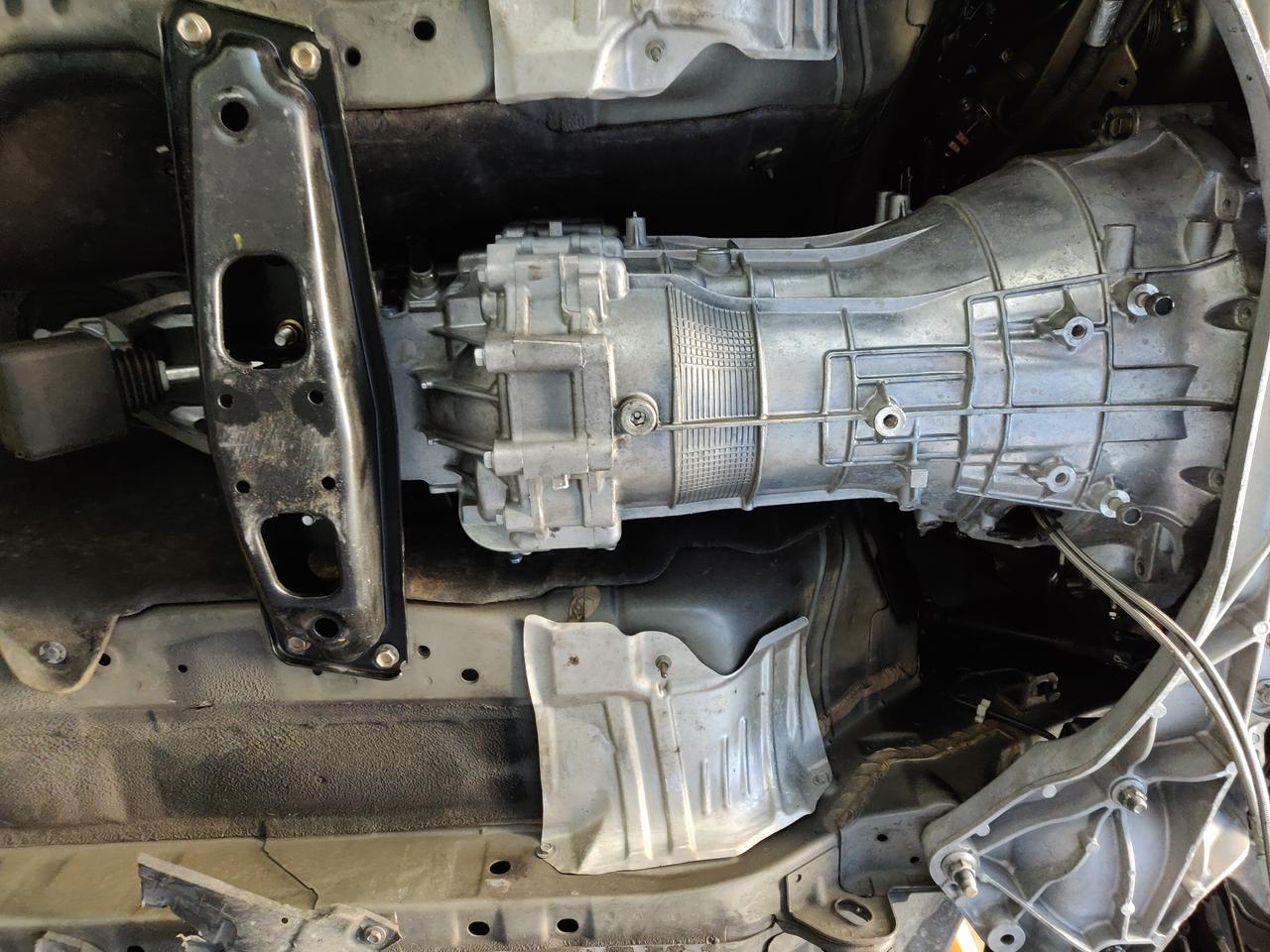

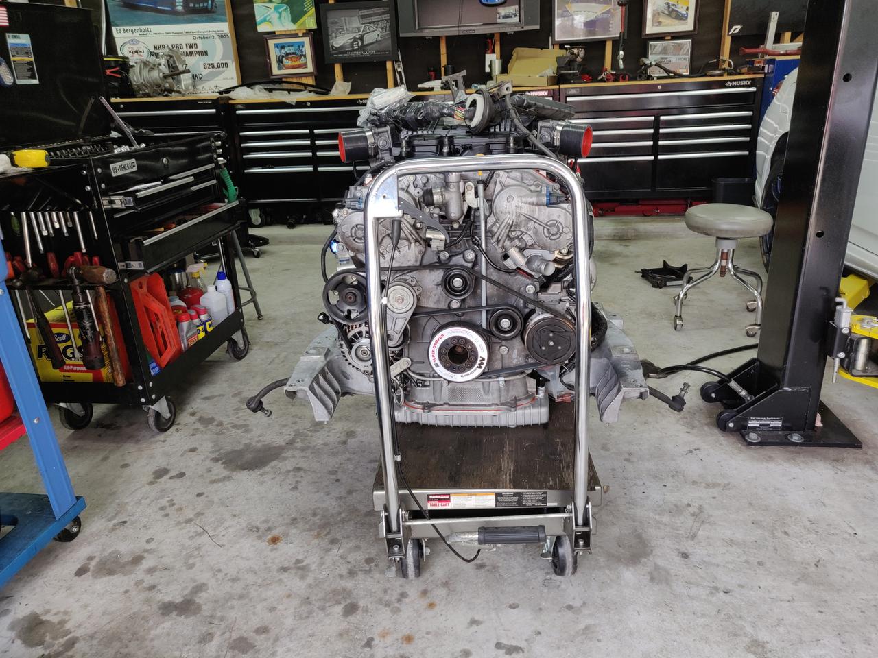

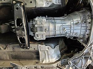

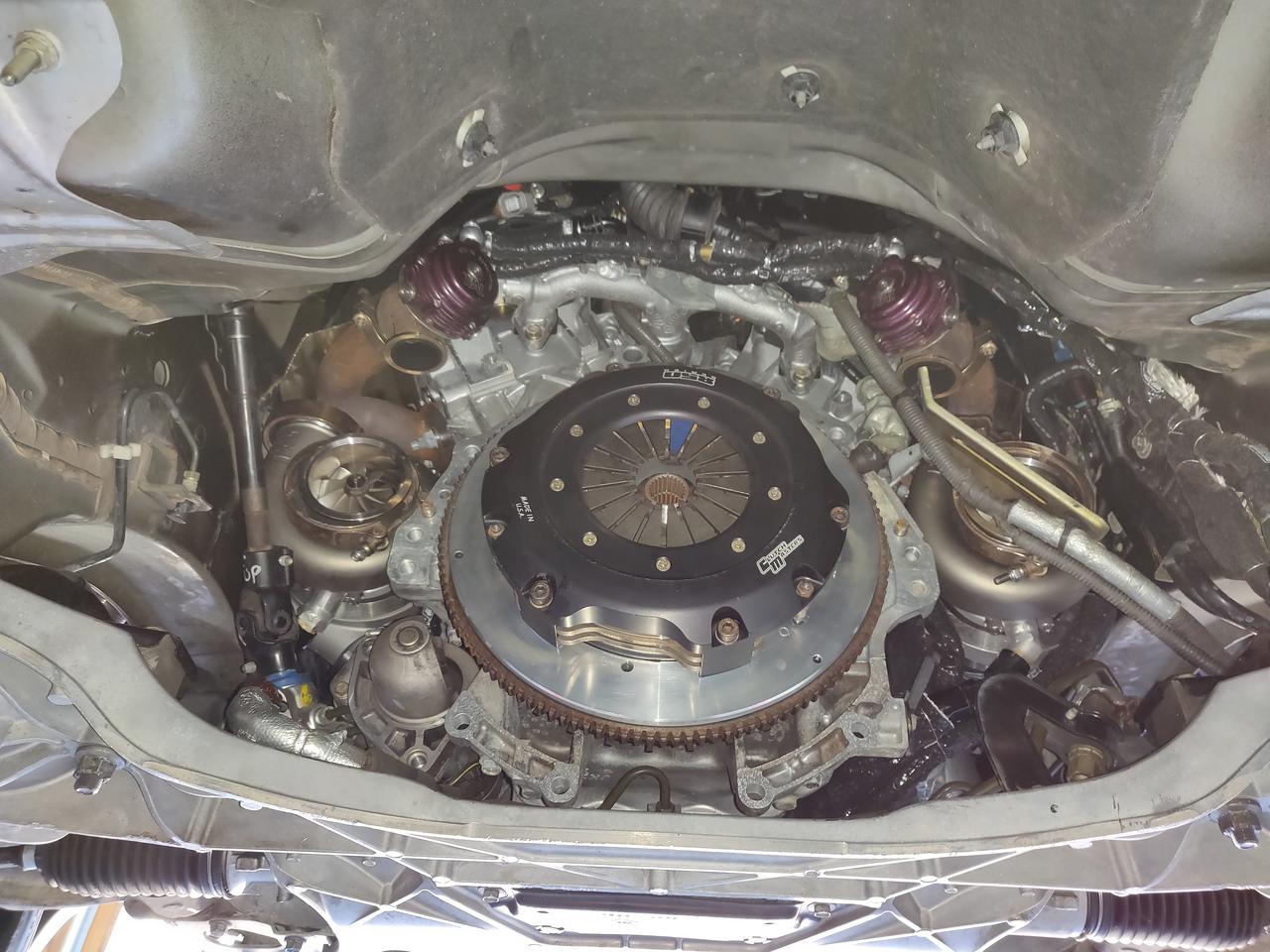

Last time we were in the garage we got the motor in, next up as the clutch/transmission:

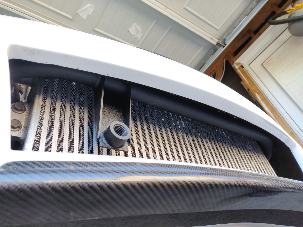

FI Crash bar fits, but the tow hook is a couple inches high - that's ok if you cut the grille out.
