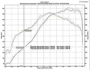

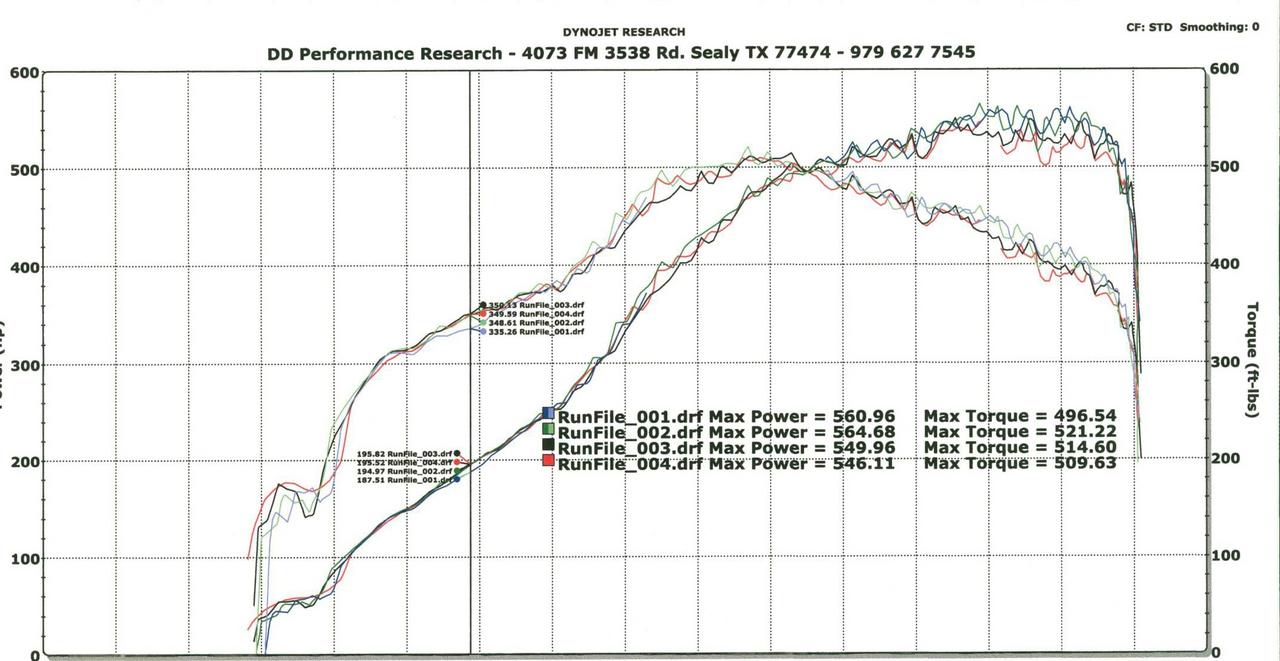

As I've mentioned before I started tuning my car on Uprev by myself since the head lifted back in November and now that I am getting close to the rebuild I wanted to get the car on the dyno to get some numbers for the tune. A friend recently had his car retuned at DD Performance Research which has a 4wd dynojet. I originally intended to hit up both DD and Kozmic on the same day to have comparisons between DD's dynojet and Kozmic's mustang dyno, but another friend went ahead and put his car on DD's dyno first as he originally had his car tuned at Kozmic. His car made 380whp on Kozmic's mustang dyno and 382whp on DD's dynojet. Seeing as how there was only a whopping 2whp difference between the two dynos I decided to not even have my car run at Kozmic.
Here are the results for my self tune on 93 at 14.5psi:

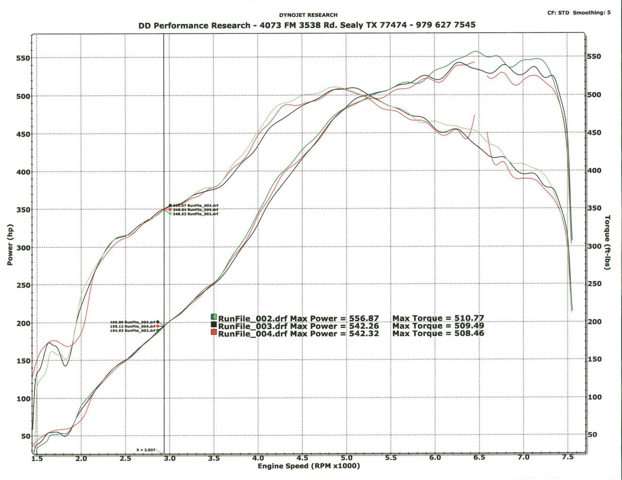

Smoothing 5 applied:
The tune needs a little more work, but at this point I'm calling it good as I will start a new tune from scratch once the new motor is put in. I'm pretty stoked that my tune was pretty much able to match the numbers that the car previously made on 93 and Jtran's tune.

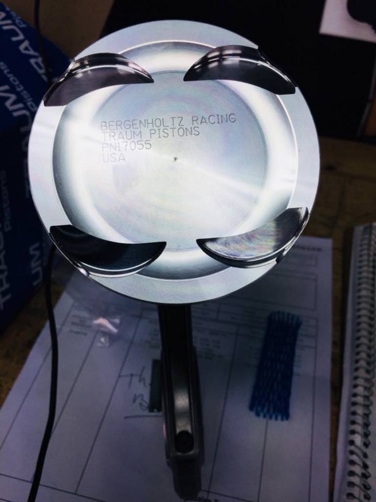

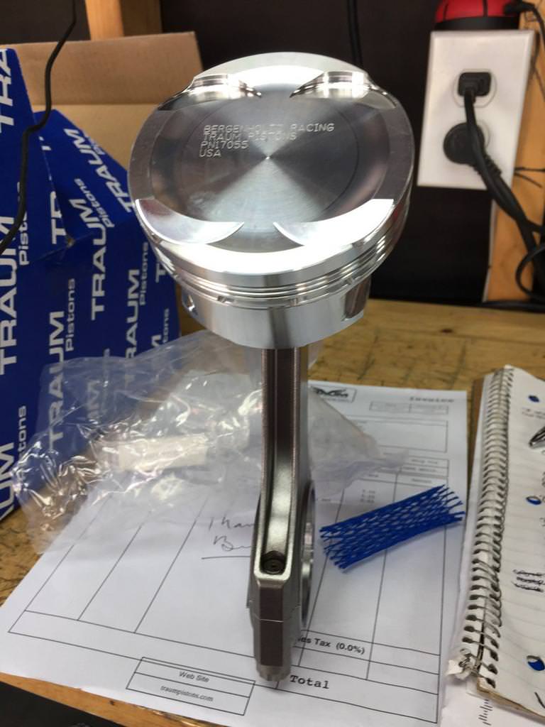

Custom 10:1 pistons have arrived! The previous Main Engineer for Arias pistons formed his own company - Traum Optimum Performance - and took our specs from the 3.7 crank/rods and made us these pieces of art. The closed deck block is going to be sent out for bore and hone at the end of the month and assembly of the new bottom end should start in December. If everything goes well the new heart will be transplanted in January 2018 and the (first?) 2007 G37 will come into existance.

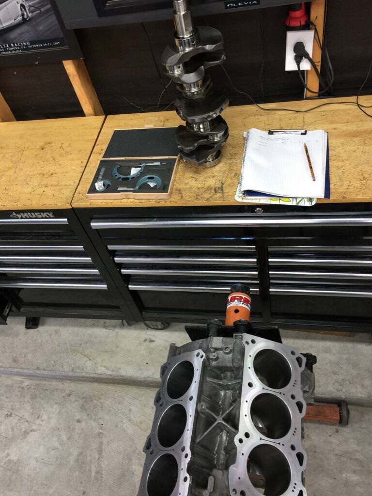

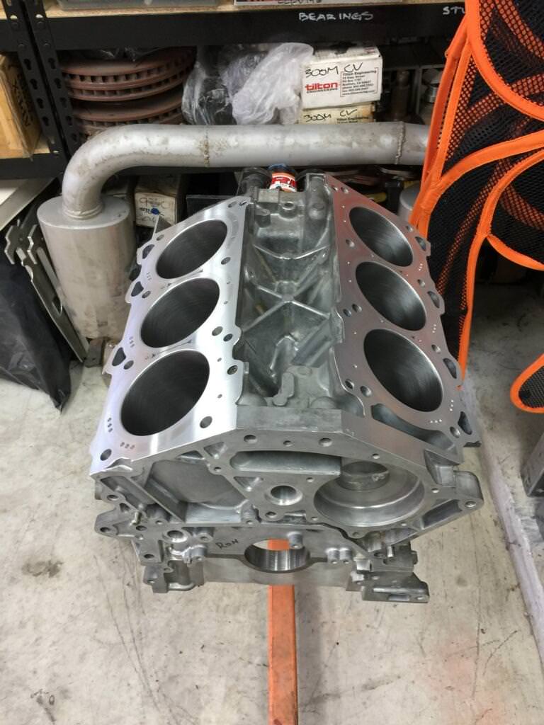

First week of 2018 has started rolling, here are a few updates of where version 2 of the build is.

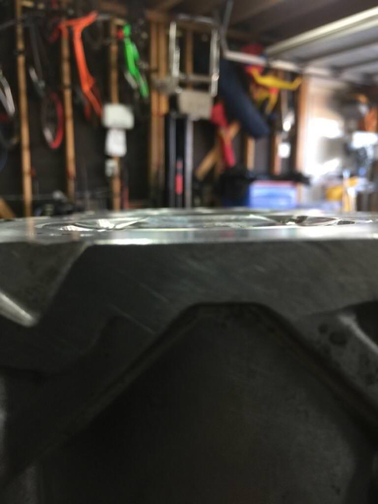

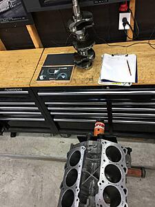

Closed deck block came back from the machine shop after bore & hone
Measured for bearings
Tested piston height

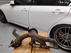

Obtained a used Fast Intentions TT kit to put on the car - order has been placed for Xona Rotor 65.64 (Stage 3) Turbskies and a few misc parts

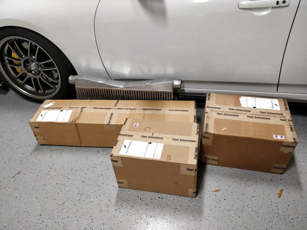

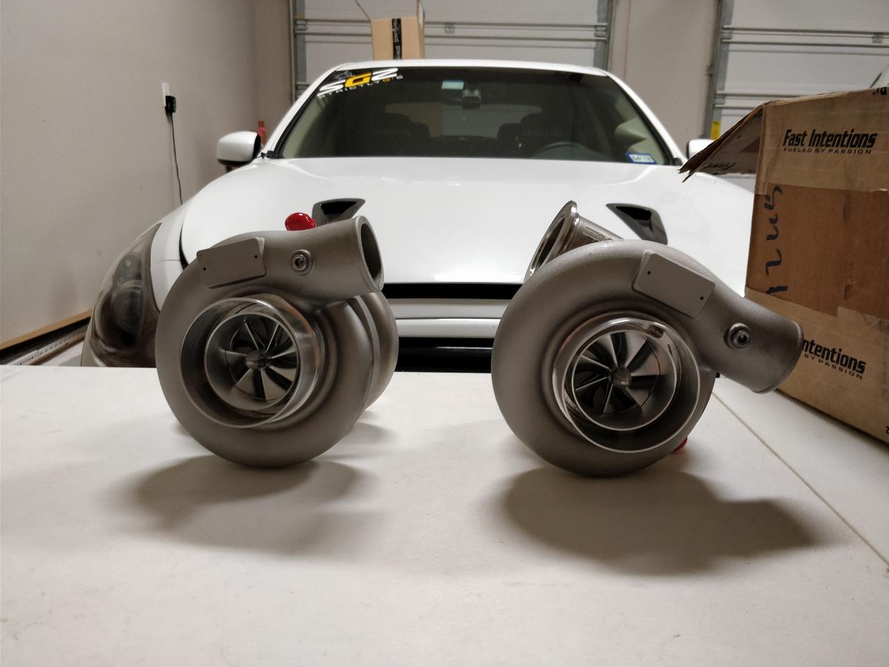

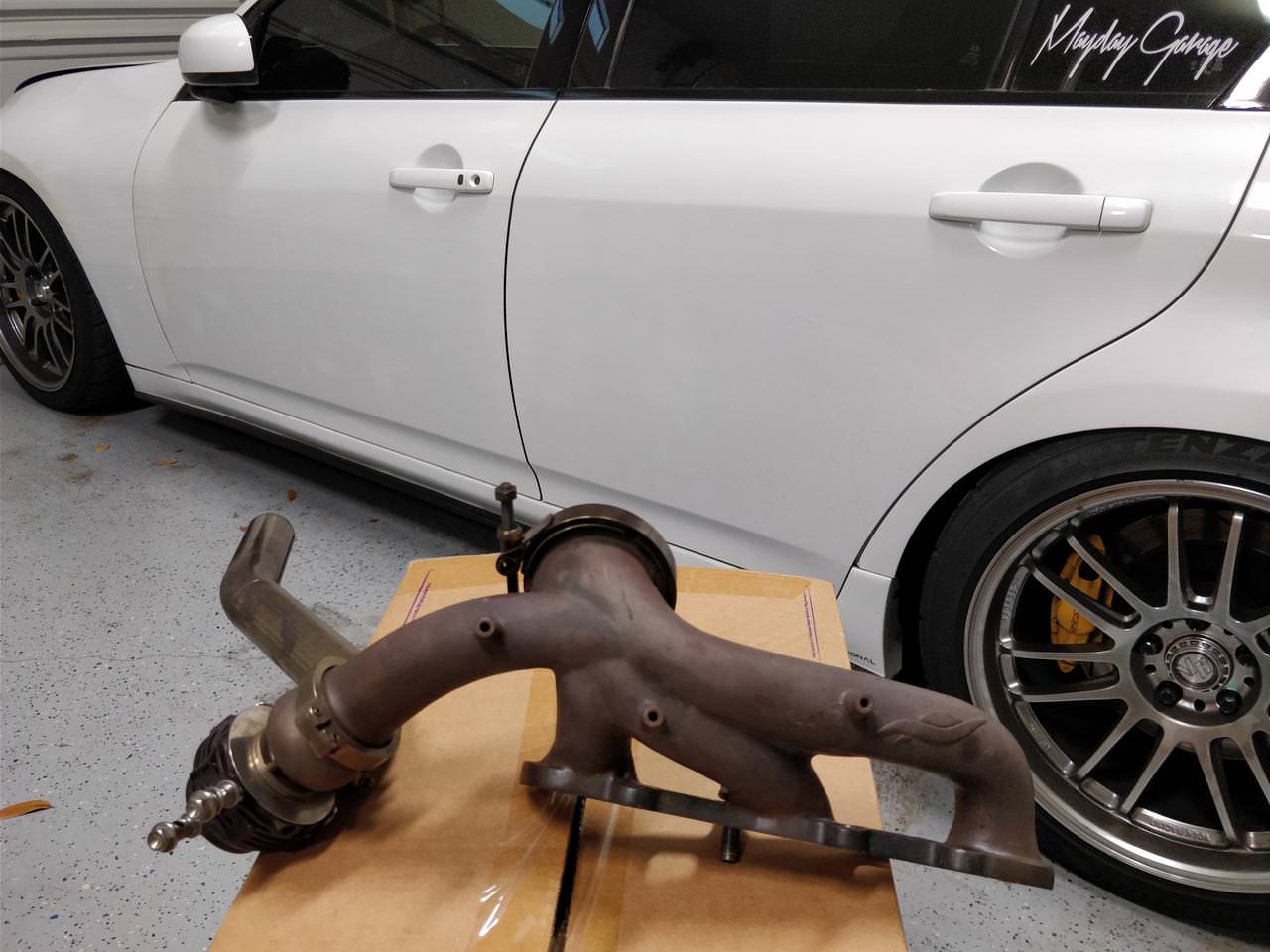

A little behind estimated timeframe, but I finally received the rest of the parts needed for Version 2.0 of the build. Motor should be dropping next week, no solid ETA on when everything will be reassembled yet but things will finally be moving.
Stage 3 - HTZ-3579 (Xona Rotor 65.64)
S/O to Kevin @ Fast Intentions for the remaining pieces, he even threw in a license plate frame!
