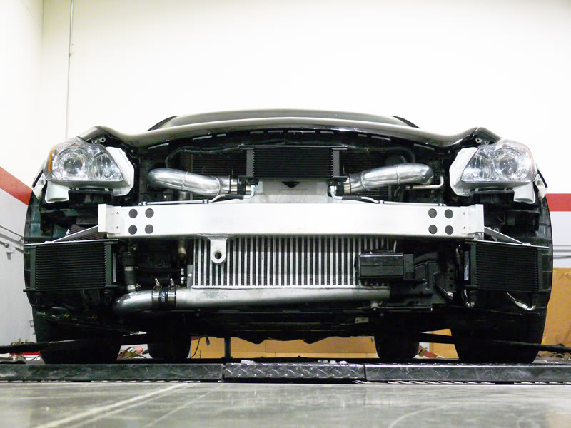

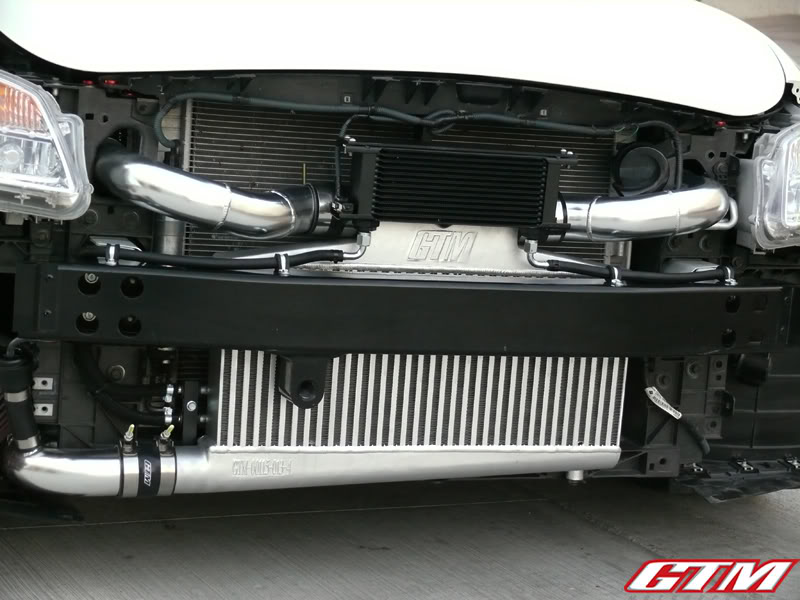

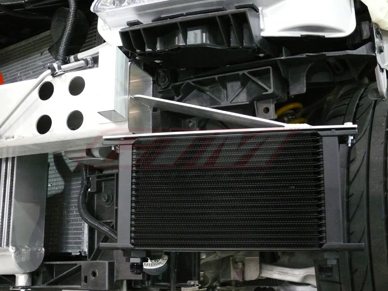

Yeah, it's a really tight fit. We definitely had to "massage" the mounts and bumper on my G to get the oil coolers to fit. Then I ended up using a dremel to open up the mesh so the oil coolers would get some air flow. The now fit perfectly with my stock sport bumper and are flush against the back of the bumper, but this is why I'm reluctant to update to the newer front bumper. Here are a few pics of my oil cooler set-up without the bumper installed. The last pic is of the same set up on a different car, since I can't seem to find a good pic of the entire front of mine without the bumper.

I'm really interested to see how that giant 34 row oil cooler squeezes in behind your bumper... My oil coolers are only 18 row units and they were a VERY tight fit!

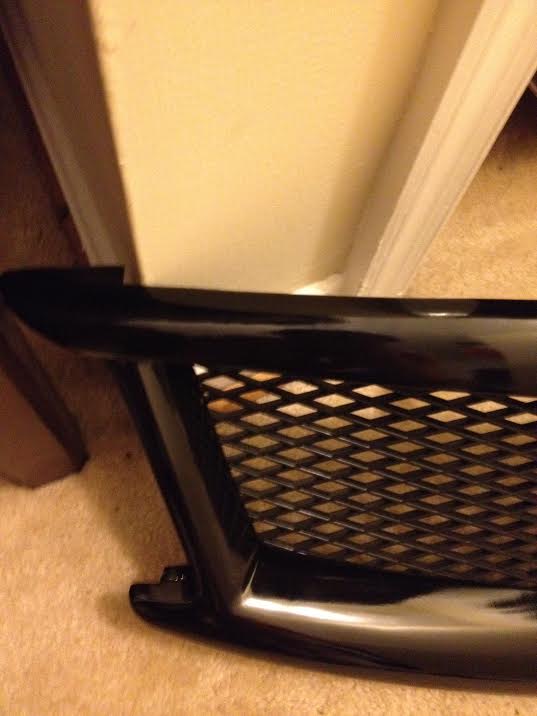

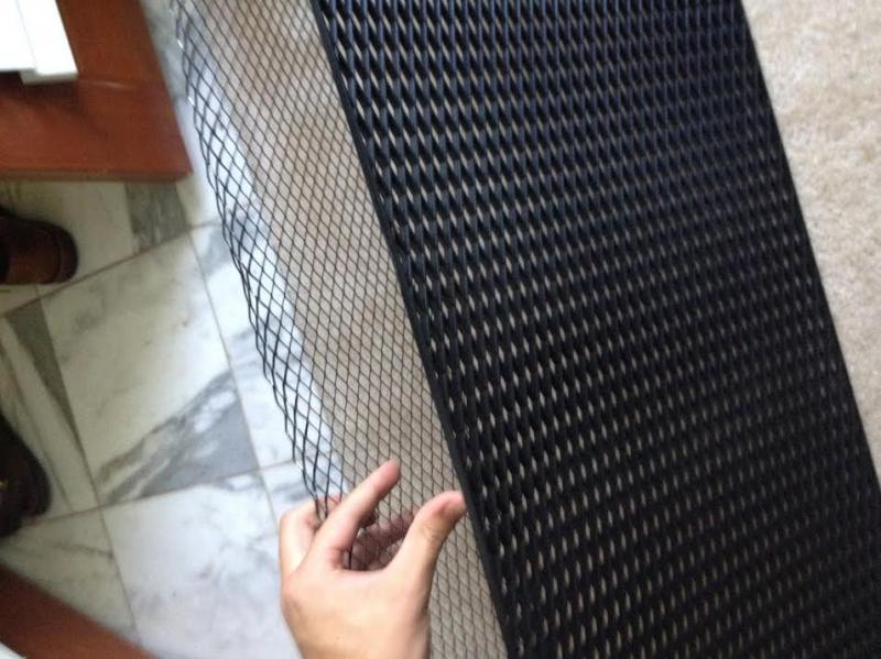

Also, to cover up the lower openings in the bumper, think this material is worthy of consideration. It is a very close match to the diamond-style mesh of the lower bumper grille, and is a grade similar to OEM (IMO)
