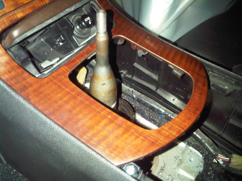

Update 10-12-2012:
Great news! The shop is done with the engine and transmission alignment and I couldn't be happier. The shifter now sits 100% OEM and the best part, I won't even have to modify my center console for it.
Shifter in Neutral

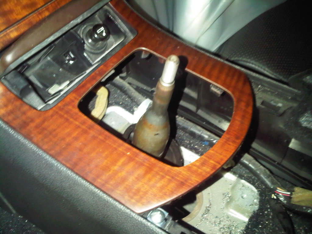

Shifter in Third
Shifter in Reverse! Look at that clearance!

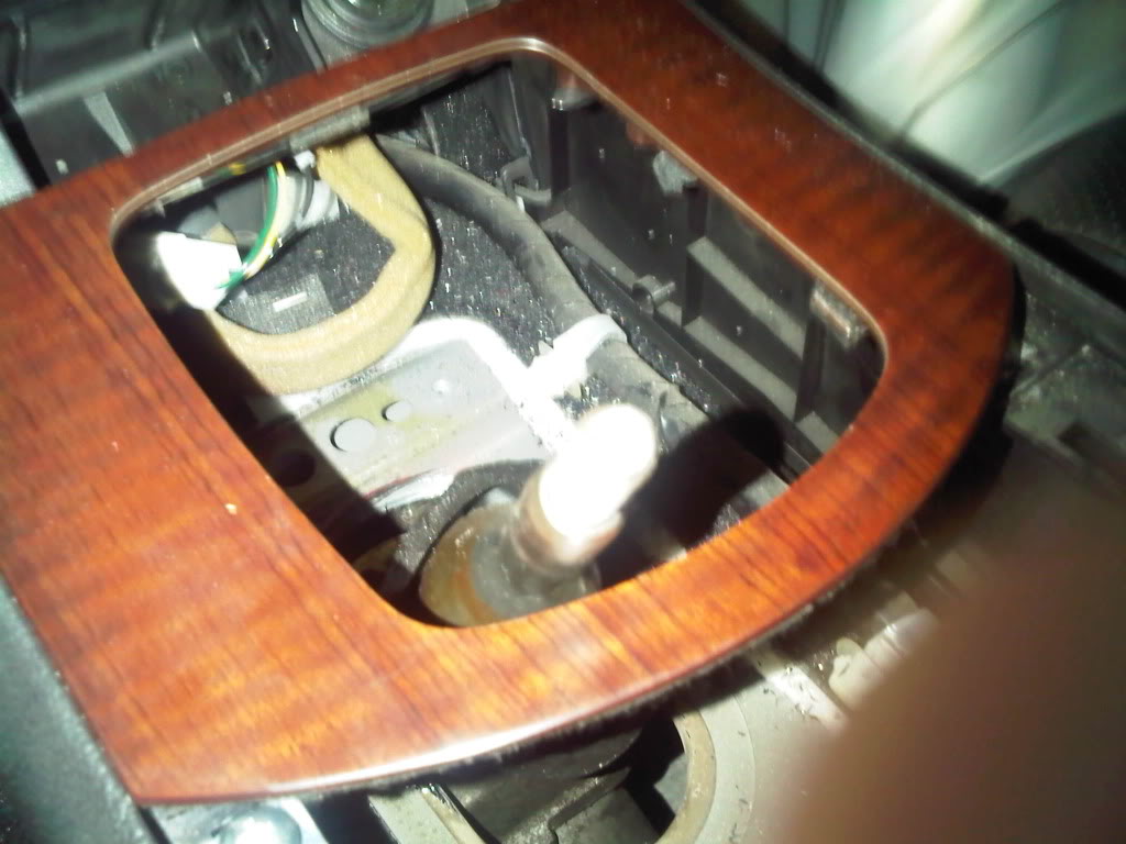

Shifter in Fourth

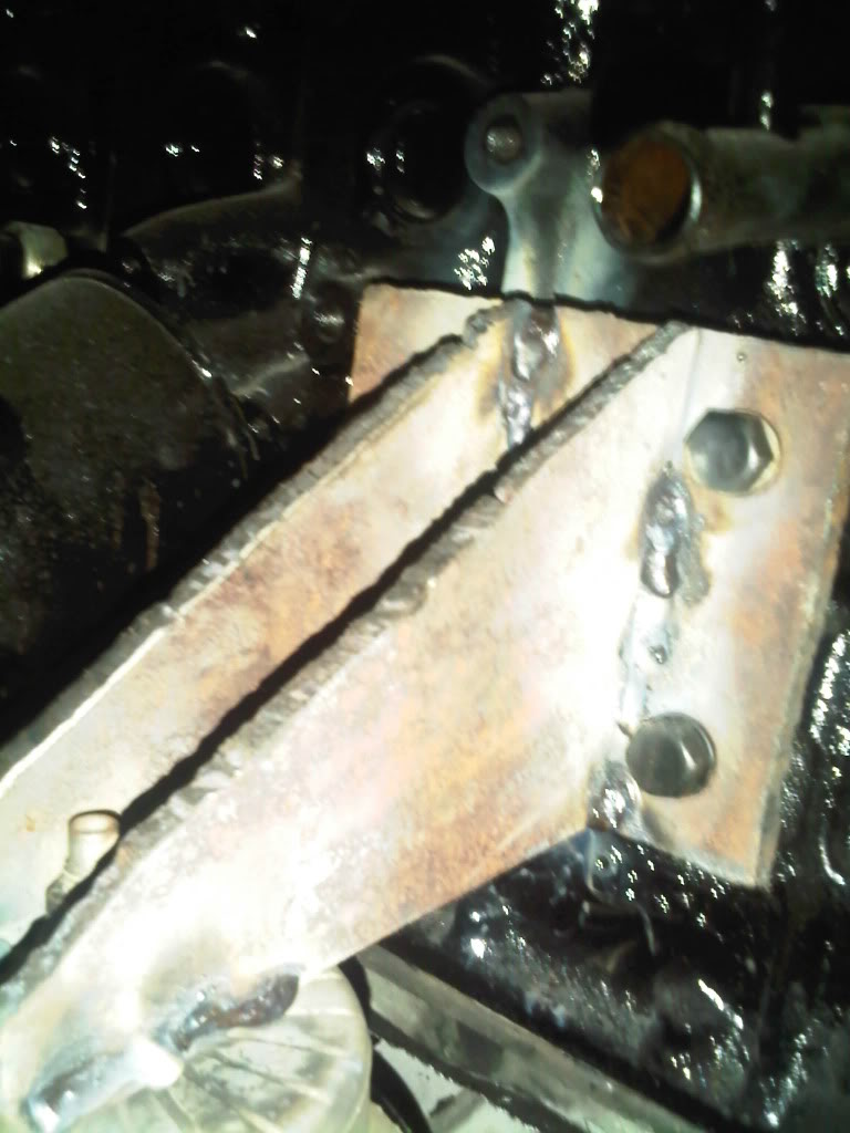

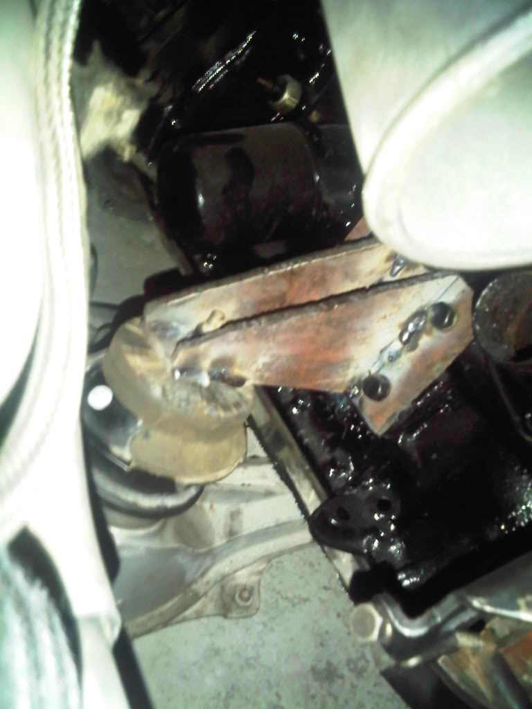

Engine mounts have been spot welded today, everything is looking perfect. Tomorrow they'll get welded and finished to look 100% OEM

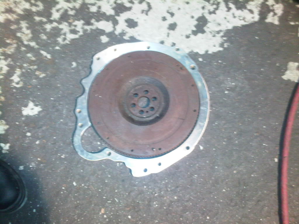

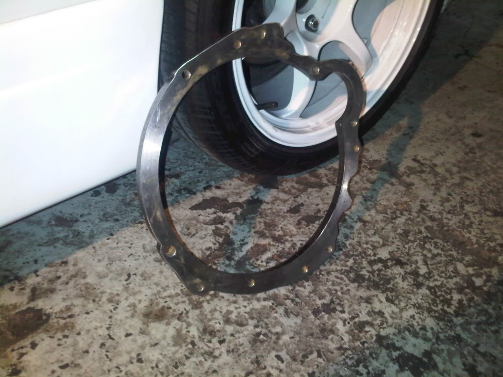

The Transmission spacer is also ready, 26mm thickness
Here it is with the OEM flywheel for your reference

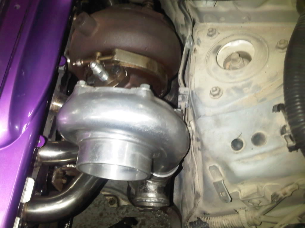

Turbo fitment is still tight especially on the turbine side. That line will have to be relocated for sure.

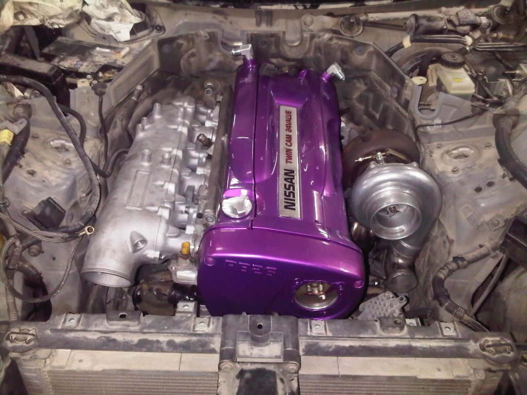

And finally, the finalized engine position. Gotta love that RB tilt!
