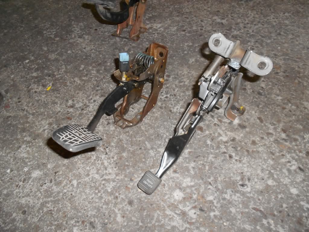

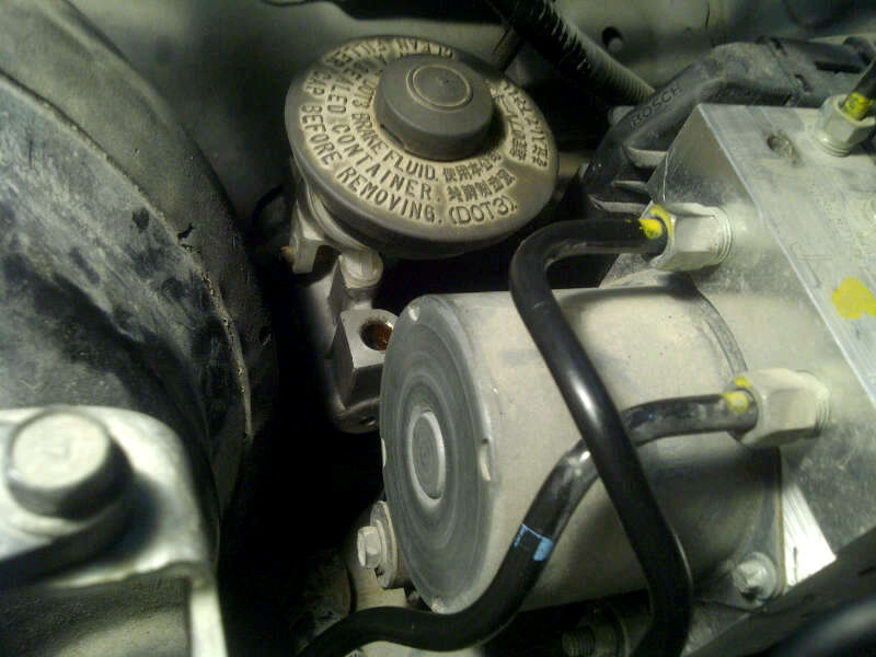

OEM foot e-brake out, R33 clutch pedal to replace it. I'm going to the scrap yard tomorrow to try and find a G37/370Z clutch pedal as it would hopefully be a direct swap.

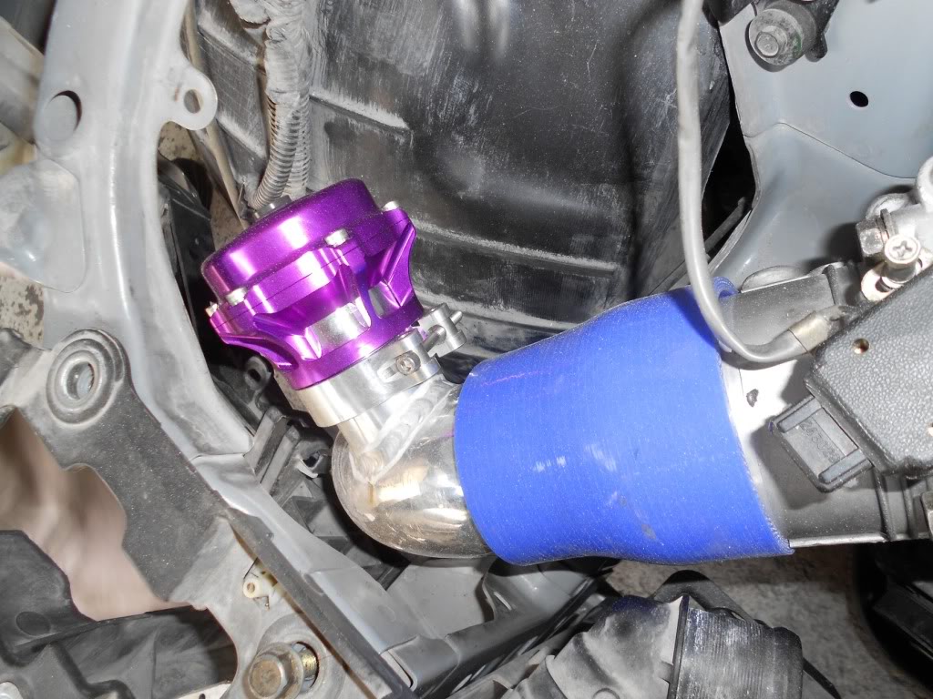

Tial BOV..

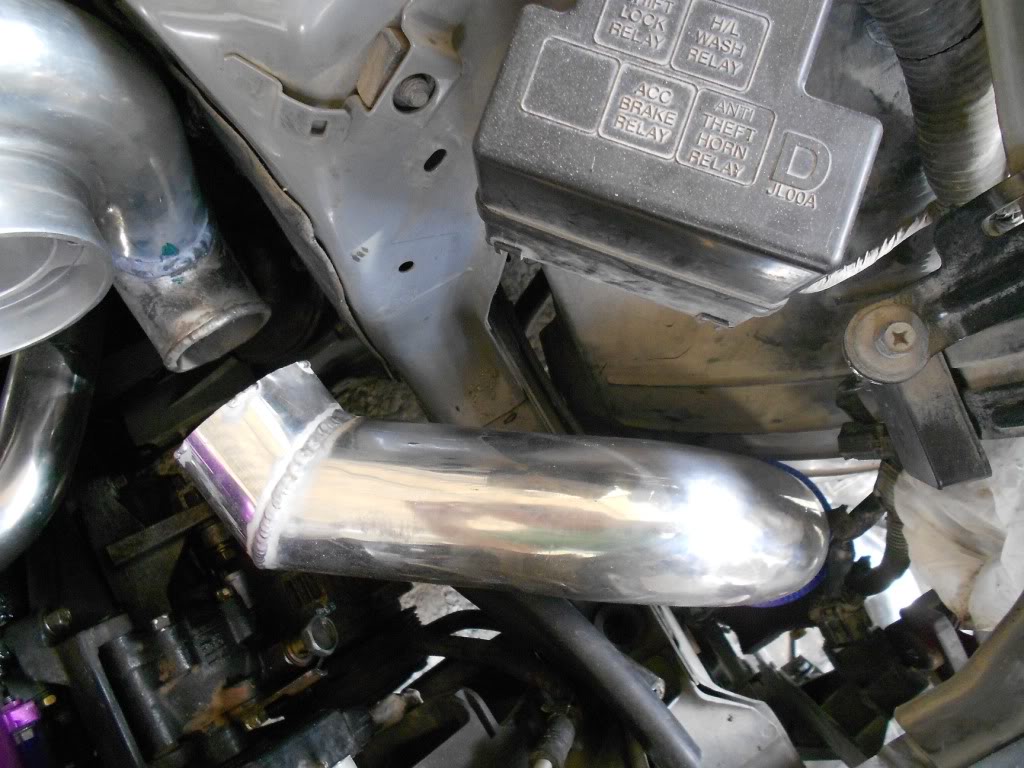

Intercooler piping almost done

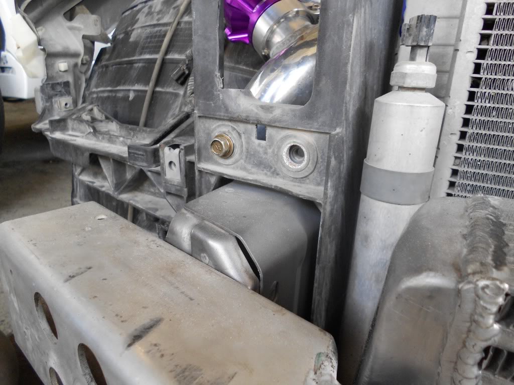

Turbo clearance "slightly" better

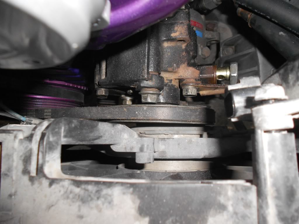

Power steering pump pulley is too close to the radiator fans, the mechanic is thinking of throwing in a small spacer to push it further out

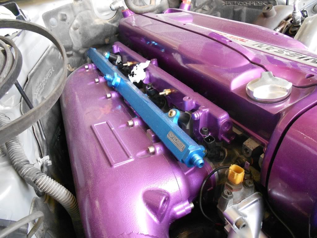

Fuel rail with the injectors in

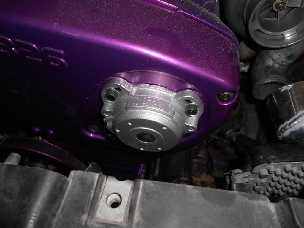

Cam angle sensor

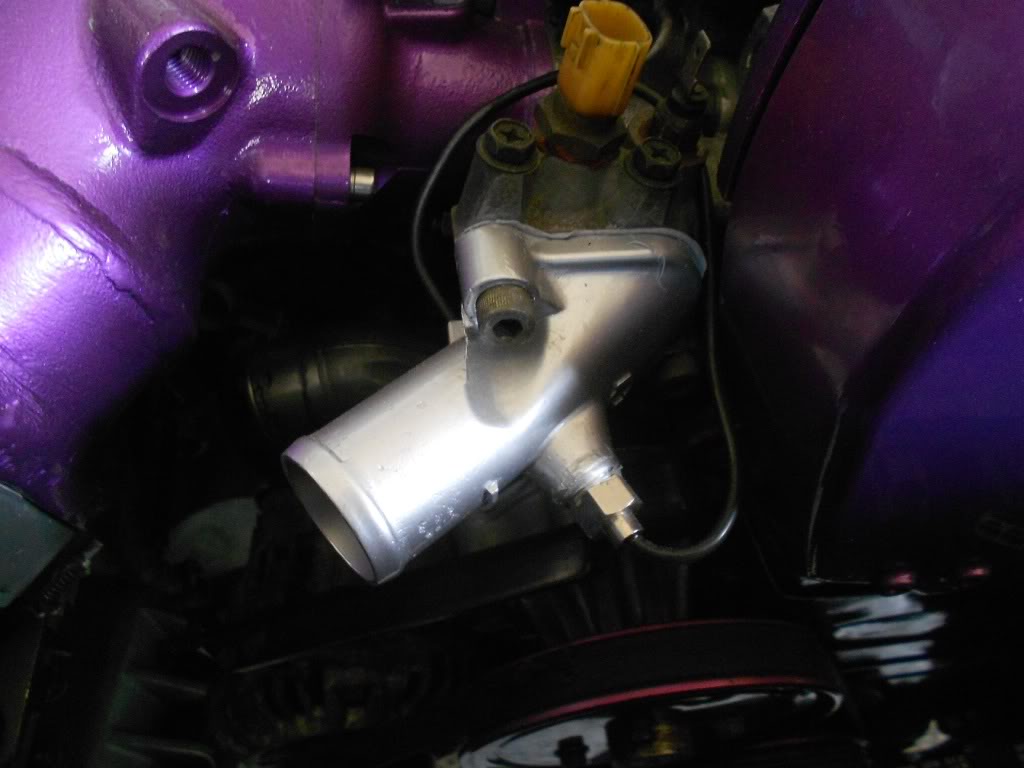

Thread made for water temp sensor

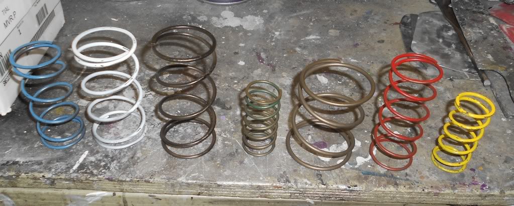

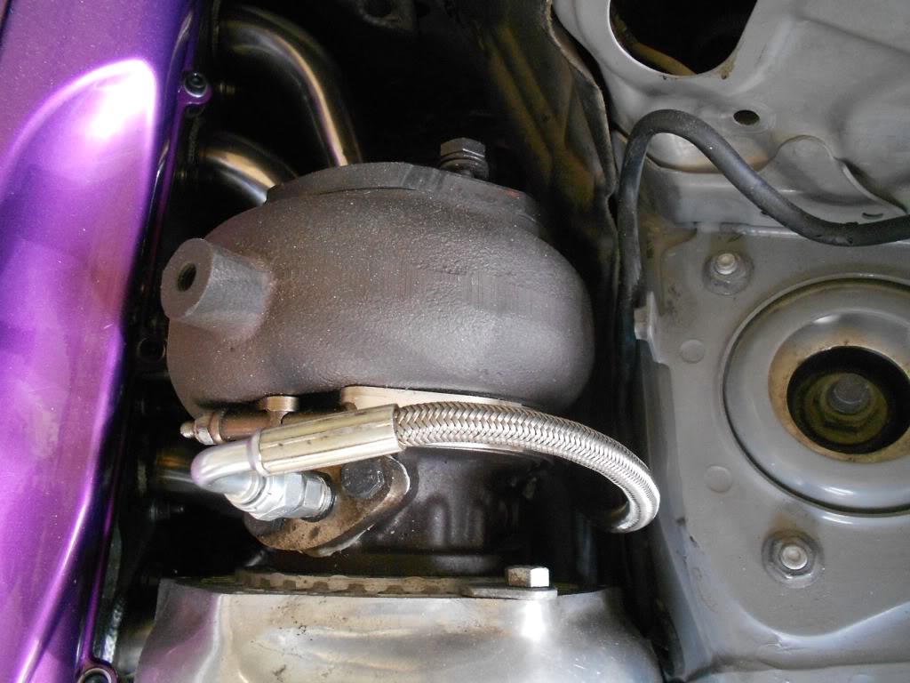

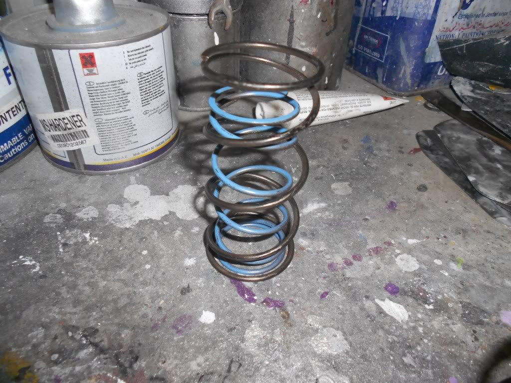

Hmmm... which wastegate spring to go for..

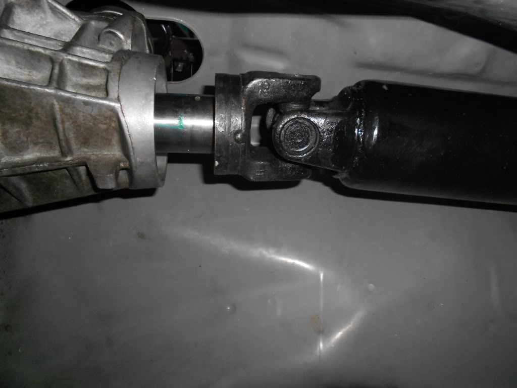

Driveshaft customization done!

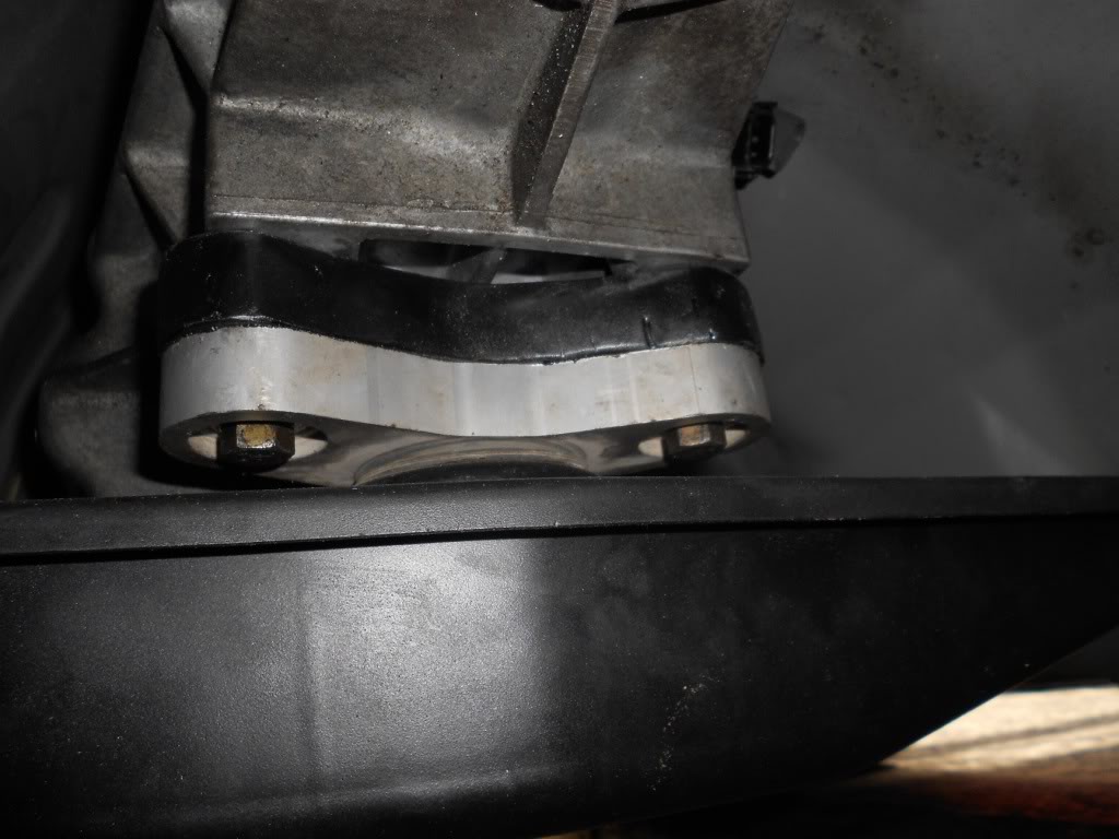

Transmission spacer

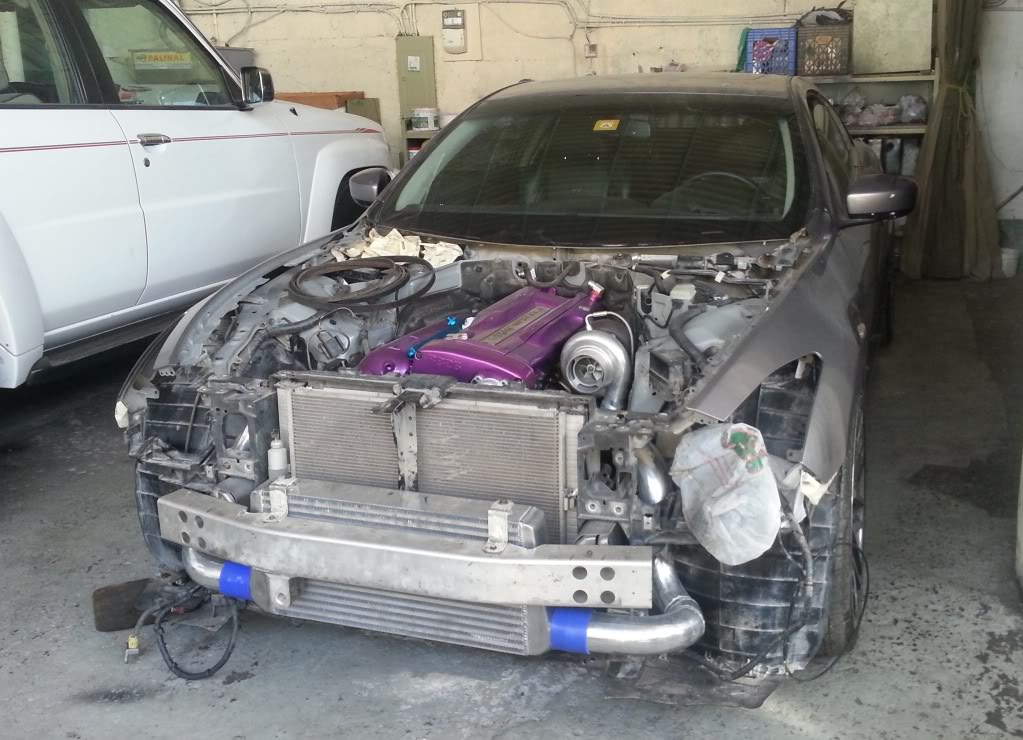

We're getting somewhere!

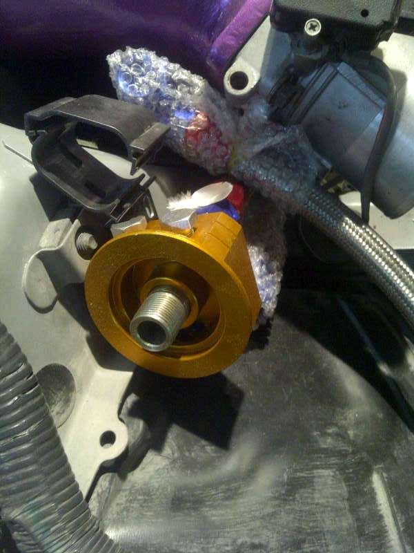

Oil filter relocator, check!

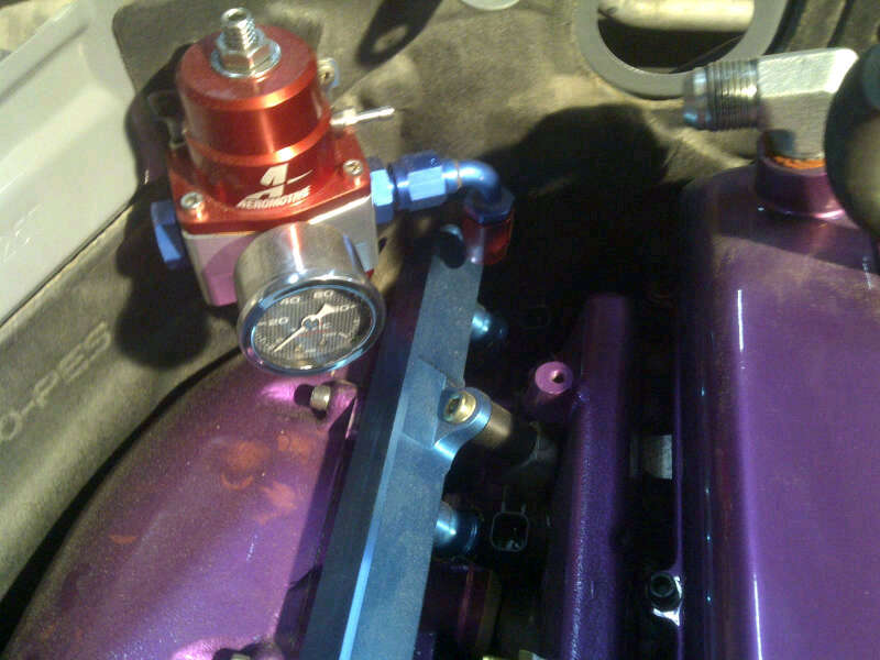

Aeromotive Fuel Regulator.. check!

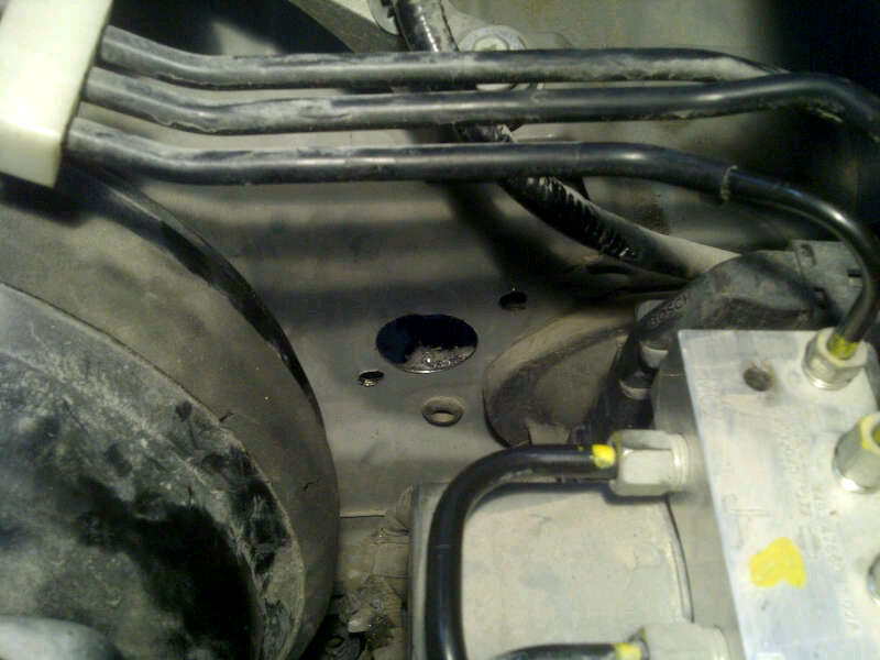

Some more holes had to be made..
For the clutch master cylinder, can't get more JDM yo!

Favorite shot so far. I'm impressed by how fast this is moving along.
