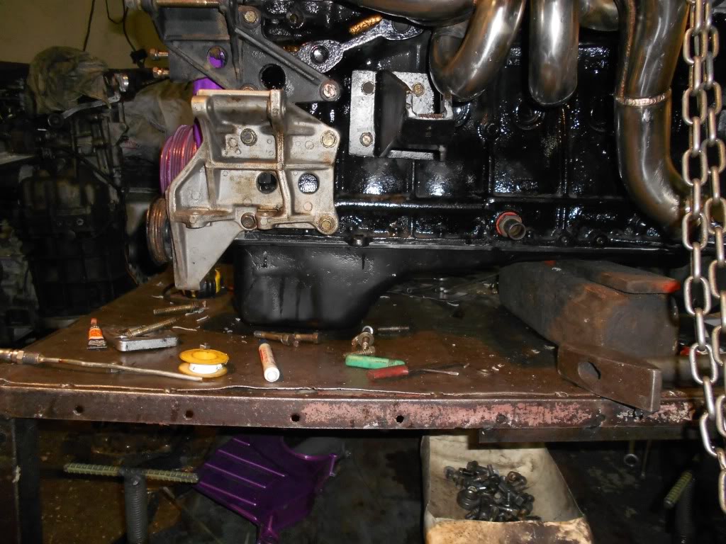

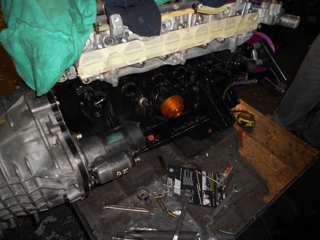

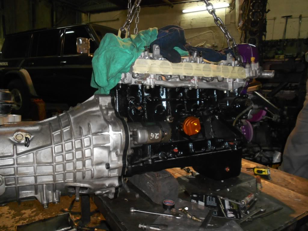

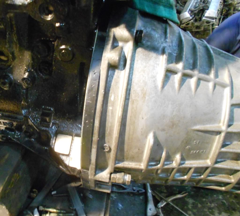

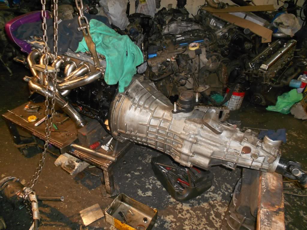

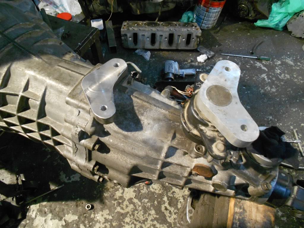

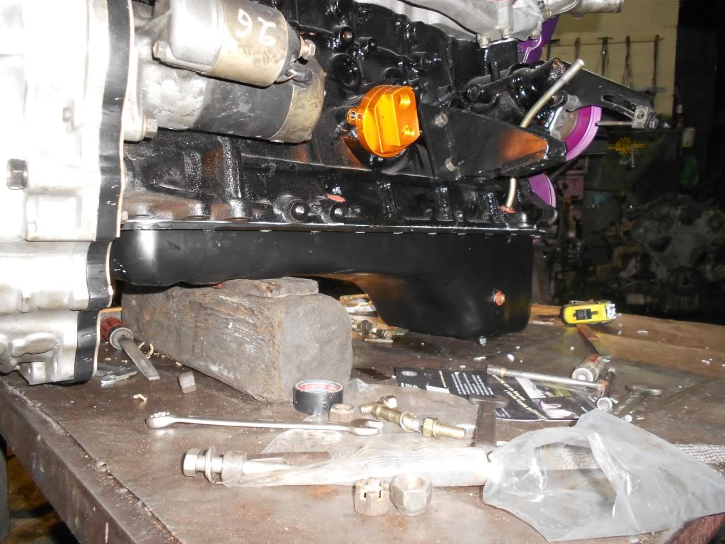

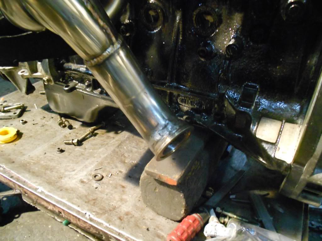

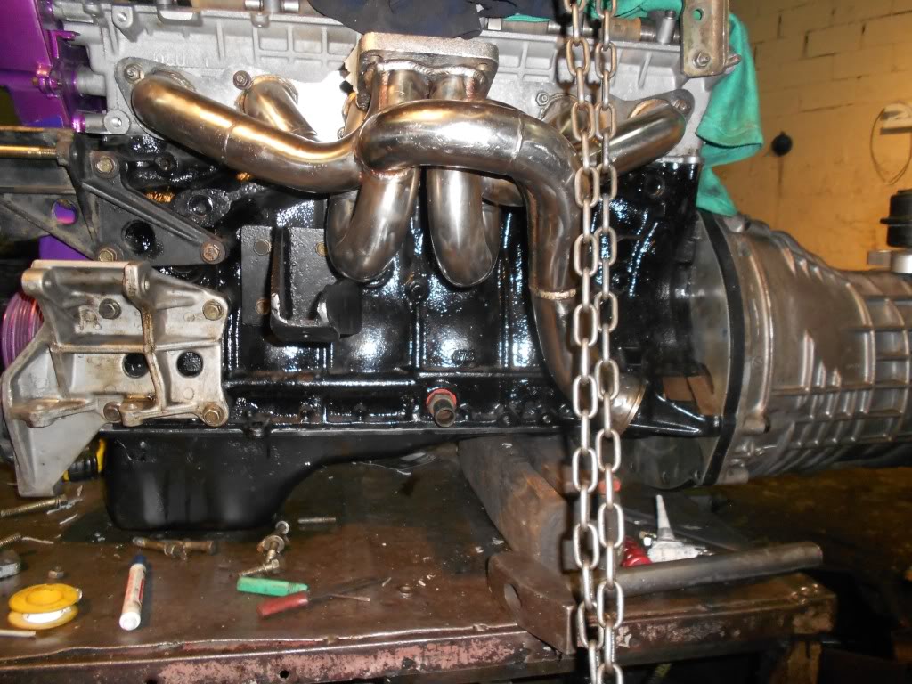

Update 23-12-2012:
Everything has been bolted together and should be going in today!
Transmission spacer installed, clutch and flywheel are in too!
Wastegate flange welded
Transmission mount spacer, OEM style baby!
Pics of the crankcase
Crank case painted, oil cooler/filter relocation in place
